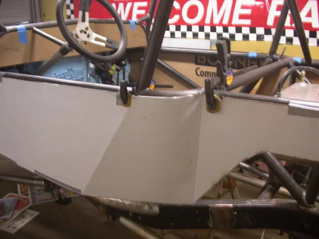

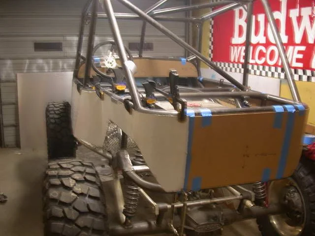

A few of the progress today, one side is fit for the .040 aluminum skins, other side is laid out with cardboard templates. Final cleanup on the panels is tomorrow.
