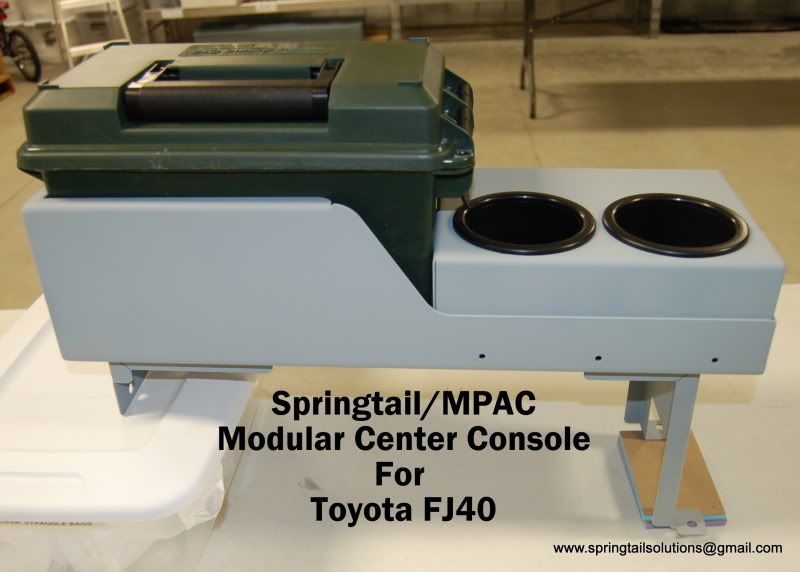

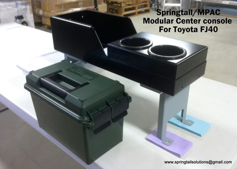

Hey Doc, is your new tank going to work with your new console?
Yeah, I think that it will work out fine...I probably need to rework the lateral most drivers side mount. I am guessing that the rest of the mounts are going to work fine or my need some spacers to elevate them a bit. I will need to read up on this...I can't be the first person to run to install this tank and want to keep the stock seat mounts.
