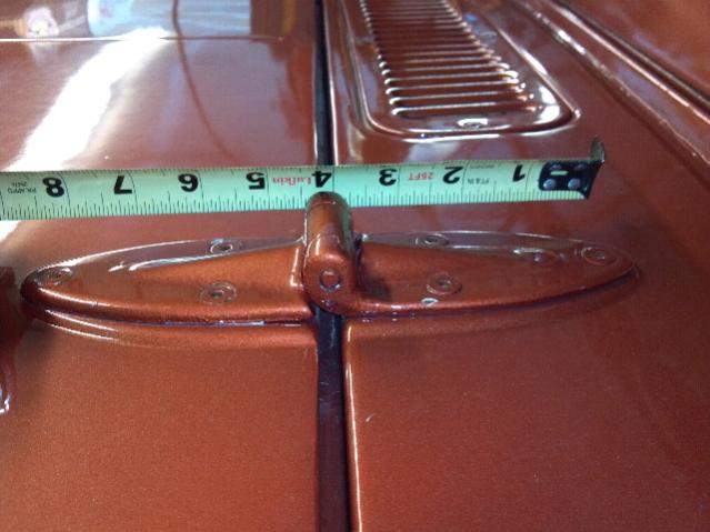

The hood seems to fit OK on the vehicle until the hinges are bolted on. Then the hood is moved forward about 5/8 of an inch (see pictures)
Pictures of the old Firewall hinge mounts
Is there some variation in the hinges between the years that I am unaware of????

I had the same problem with my truck - i was using all different parts from different trucks.. the only way I could get everything to fit was to heat up the hinges and bend them backwards a little bit to shorten the gap.
my hood before... and the hinge as it sits now

Fixing the issue with the hood pretty much required using a bit of advice from everyone on MUD. It was not just one thing but instead a lot of little things that added up.
Before I start with the rundown....for the record.
Old hinges vs new hinges....exactly the same.
First step was to make sure that the hood was aligned with the cowl. This required some dremelling of the rear portion of the hinge (really not much though). Once bolted in place we had a decent reference point from which to align the front "clip". The hood did need to be cut on the side as pictured to clear the bumper pad.
I had already put the rubber spacers in the gap for the apron which allowed me 1/4 inch.
Next, I loosened up all of the bolts at the base of the bib and where it attaches to the front fenders. This allowed me to "twist the front end to a position where the front clip lined up pretty well with the hood.
There was still some overhang on the drivers side...this was corrected with some dremel work to the forward portion of the hood hinge.
It is not exactly perfect....but I think that it is as close as I will be able to get.
