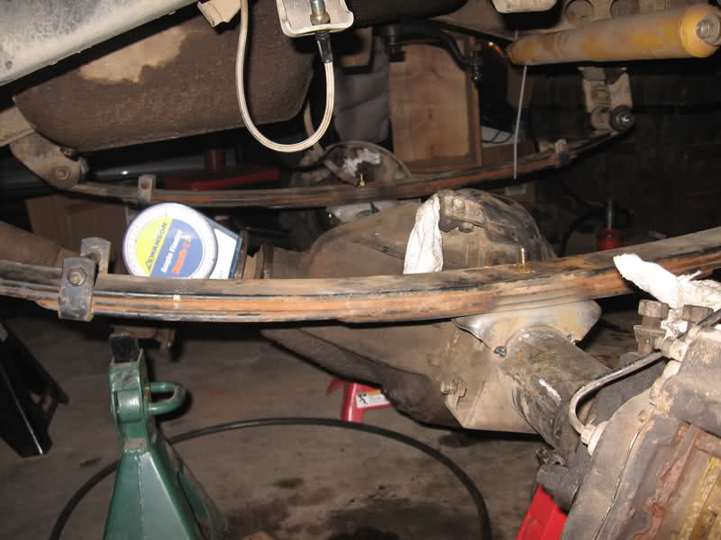

Here are the perches tacked in. With the full weight of the vehicle resting on the springs I measured a pinion angle of 20 degrees. This is with 2.5 inch lift springs with a leaf removed and a 1.5 inch extended shackle. This step took the longest because I had to get that passenger side perch sitting level and square and I didn't want to overgrind it.

Looking good. I think the 2 1/2 springs will be nice. Mine is now stock springs with add a leafs which puts it 1.25 over what it was with stock springs and on top of that I have a 2" body lift on 35s and it still feels pretty stable. I used 1.5" spacers on all four wheels and negative backspaced wheels so Its probably about 6 inches or more wider than stock and it feels pretty good even at 80 on the freeway and on the ramps down downtown doing 65-70. My pinion is 5 degrees off as I couldn't do a cut and turn and I bumped it to 2-3degrees of castor,and i've done 60 mph in 4wd with no vibes with a high angle single cv so you'll defiantly be fine, looks great.
That's kind of how I feel about the lift springs. My stock ones were sooo worn out that I figured I would rather have a little taller rig with stiffer springs than the saggy POSs that were the stock ones.
As for the pinion angle, I checked that thing so many times to make sure I was going to get it right and in the end I think it came out near perfect.

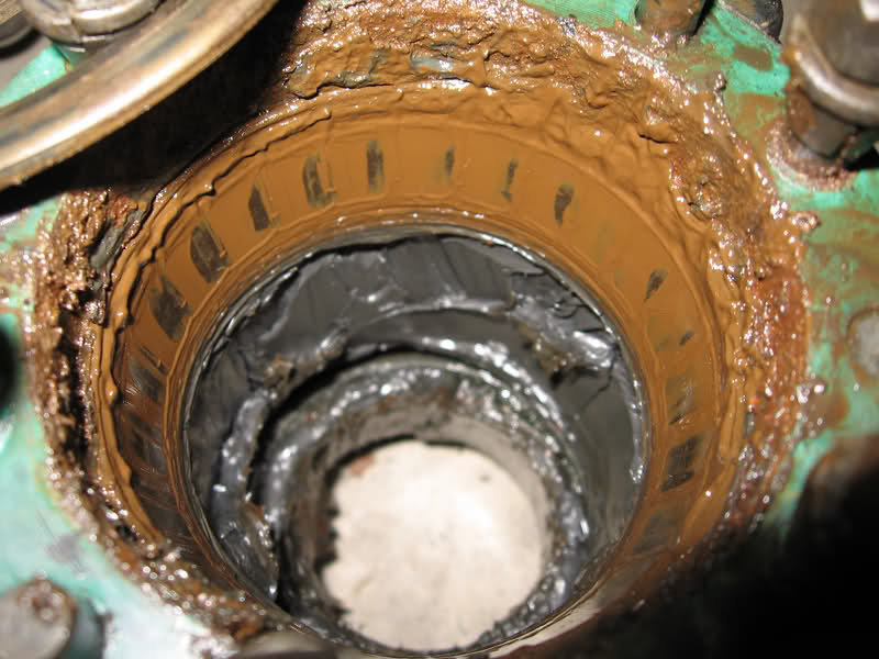

Ok after getting in there and seeing what 2 years of sitting with water in the gear oil did to my bearings I decided I am going to redo everything. Hopefully I will be worry free... until I break one of my worn out birfields, but I'll cross that bridge when I come to it.
Check out these gnarly piiics!!
One of the wheel bearings:
And inside the rotor where both bearings ride on the spindle.

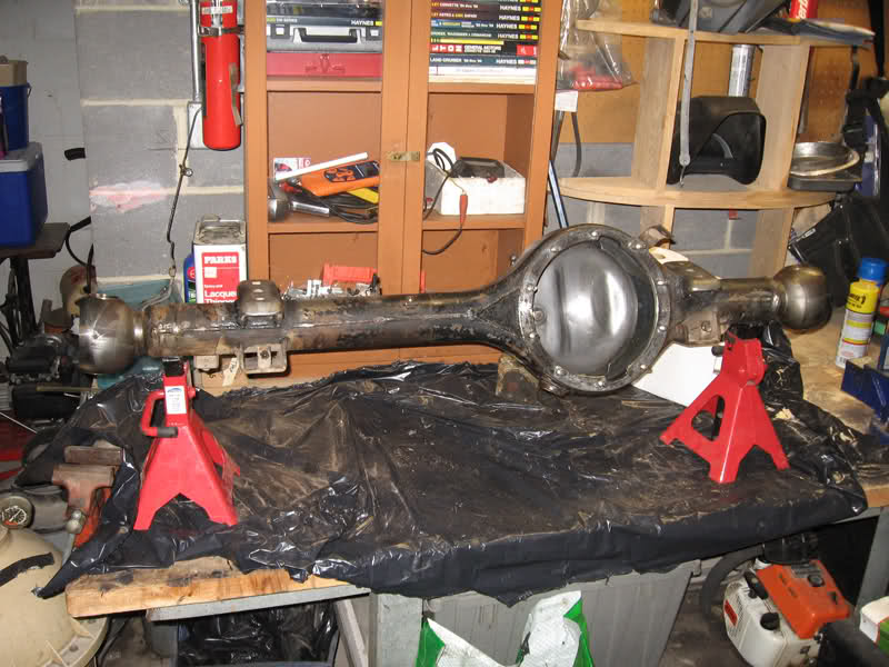

Here is what I got done today. Doesn't look like much but pulling those knuckles and CLEANING everything took forever and I'm still not done. The housing is ready for the cut 'n' turn.

Here is a shot of the cleaned housing:
