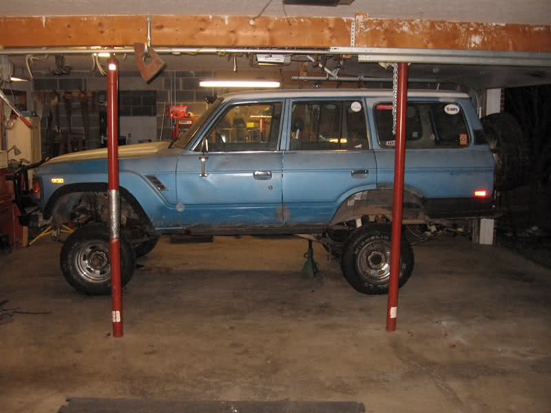

Got her back on the ground!!!!!!!! and damn she looks good. My frame measurements with 27 inch tires:
Driver Front: 24.5"
Passenger Front: 25.25"
Driver Rear: 27.5"
Passenger Rear: 28"

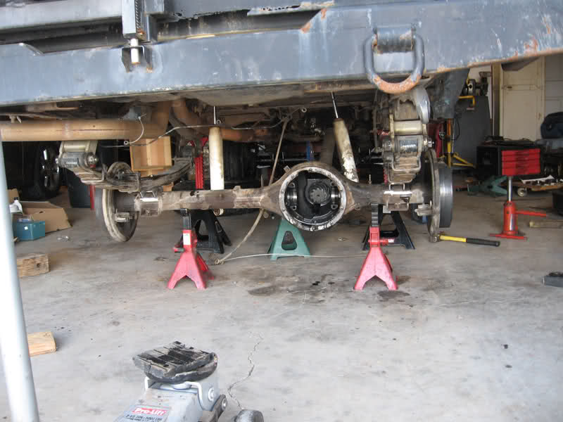

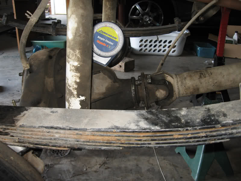

I pulled the rear axle apart down to the pinion because the third member that was in there was toast. One of the carrier bearings fell apart in my hands and both side adjusting nuts were chewed up. Here is a picture of setting the perches and getting the pinion angle figured out.
I set the pinion angle pointed directly at the Tcase then used the angle finder to point it down 2 degrees.
Pulled the axle back out, burned the perches in solid, and installed the new third member.
I slid the axle back under, after grinding off the old spring plates, and bolted it back in..... Now the moment we (but mostly just me) have all been waiting for....!!!!!!
That's all I've got for now. Until I get longer brake lines, which should hopefully be Monday, she will sit right there. Don't want to risk having to chase her down the driveway.... again ;)

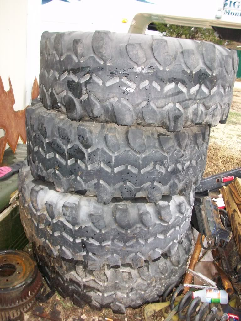

But i keep finding things like this where the person saiys they still have 6/32nds left but are obviously at and below the wear bar all the way across the tire... just cause the side lugs have some rubber does not mean they are good... oh and he wants 300.... they arnt worth 10...
what i have is 4 39.5X14X16.5 super swamper tsl tires. still 6/32nds of tread, will pass an inspection and good for wheeling for a bit.
