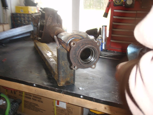

hell even a broom handle might have enough oompf to knock the bearings out from the back, if you stick something in there to catch the edges of the race.
or you can do the crusty trick.
smash out the bearings, then run a weld on the inside of the race, apparently shrinks it so it pulls out pretty easy.

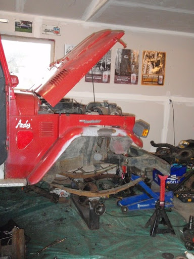

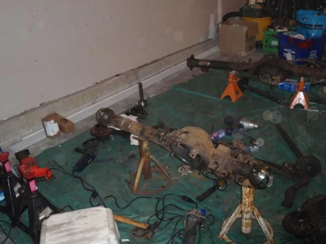

Well I got a new cantire special grinder... and back at it... all the bits are removed from the front axle and I will get the rear done tomorrow morning then its time to grind it all nicely !
I have a few pics from today:
Grinding/cutting begins:

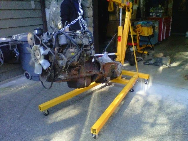

These were parked out back of the house that I got the 3b from... And ones for sale!
attachment.php
nice , your 3b has power steering on it !

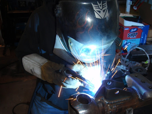

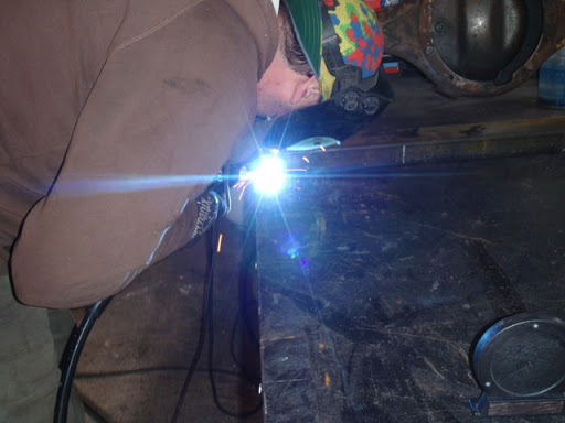

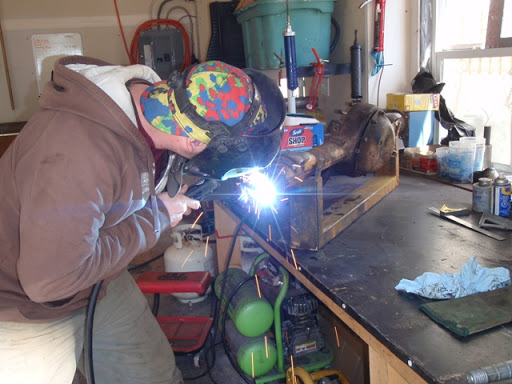

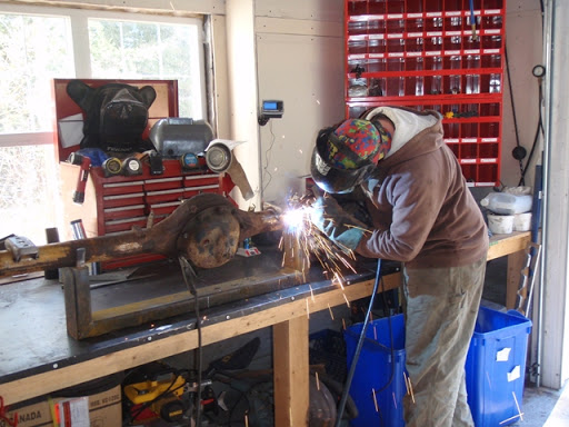

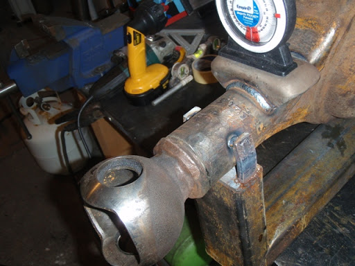

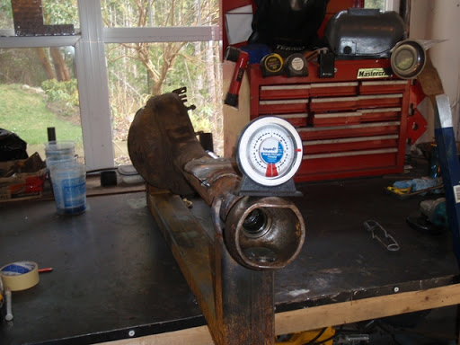

Well thanks to Cam I got the axles mocked up and welded up with the cut and turn done between yesterday and today. Tomorrow I'm going up to Courtenay so if you want anything from anywhere between here and there give me a call asap as I'll have the truck so lots of room!
Pictures of the last two days:

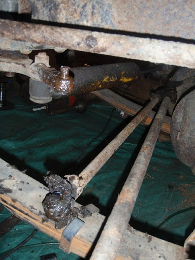

TRE was stuck in there good so I cut it out:

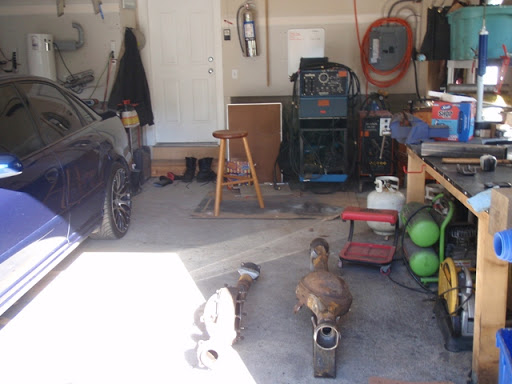

Mock Up:
Axles at Cam's House:

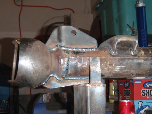

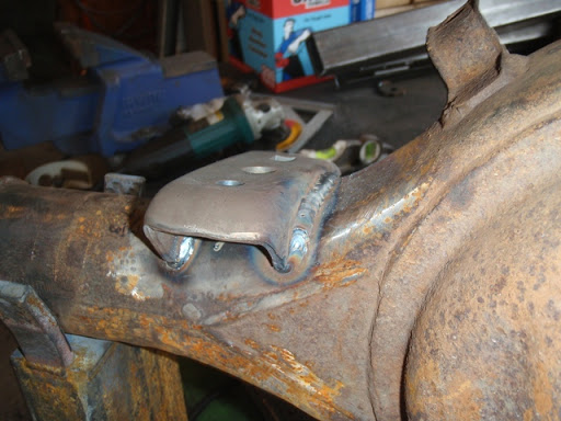

Welding in rear perches:
Rear Perch Burned In:
Removing Bearing Races:
Tricky Perch Done:

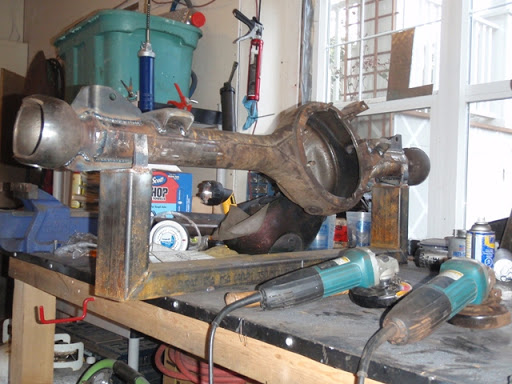

Marked for cut and turn:
Cutting:
Heating up to do the turn:
Measuring:

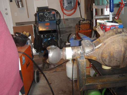

Welding the cut and turn jig to the table:
Turning:
More Measuring:

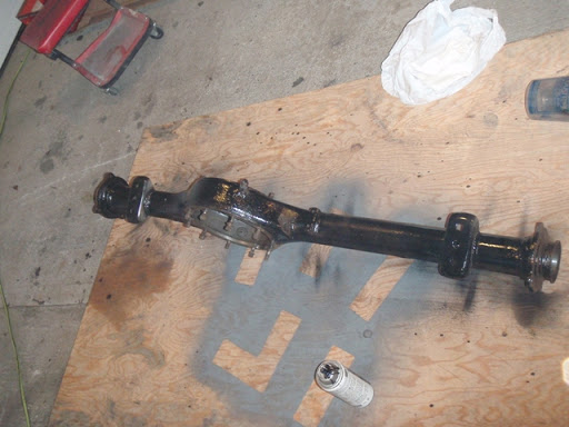

Rear Axle Painted:

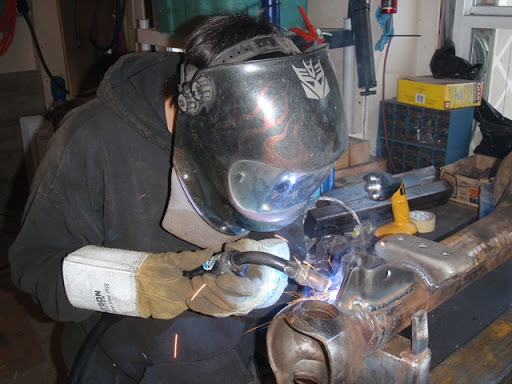

Welding in the turned axle:
I get a bit of practice by welding in the ball gussets/shock mounts
More of me welding kind of ugly but it's not going anywhere...
