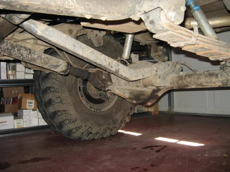

Anti Wrap Bars
Opinions on anti-wrap bars?
I like the design of this one because its simple and doesn't have any low points... but no idea how effective/strong it is (It definitely doesn't look as beefy as some of the other ones)

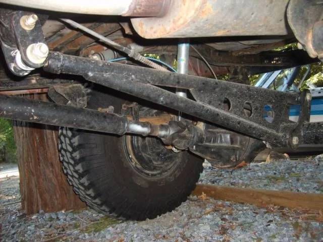

FJ40 Traction Bar
I also like the look of this one... looks beefier and also doesn't hang down too low below the axles... as that's just one more thing to get stuck up on...
FJ40 Traction Bar
Absolutely not, its completely useless.
https://forum.ih8mud.com/attachment.php?attachmentid=373713&stc=1&d=1258765133
Thats my second choice, don't know why I don't like it but I don't.
This one. Make sure its somewhat "level", if it points up too much you will get lots of antisquat and it'll hop. Mount the lower part a little lower though, its close enough to the diff that it won't grab that many rocks, mine doesn't.
