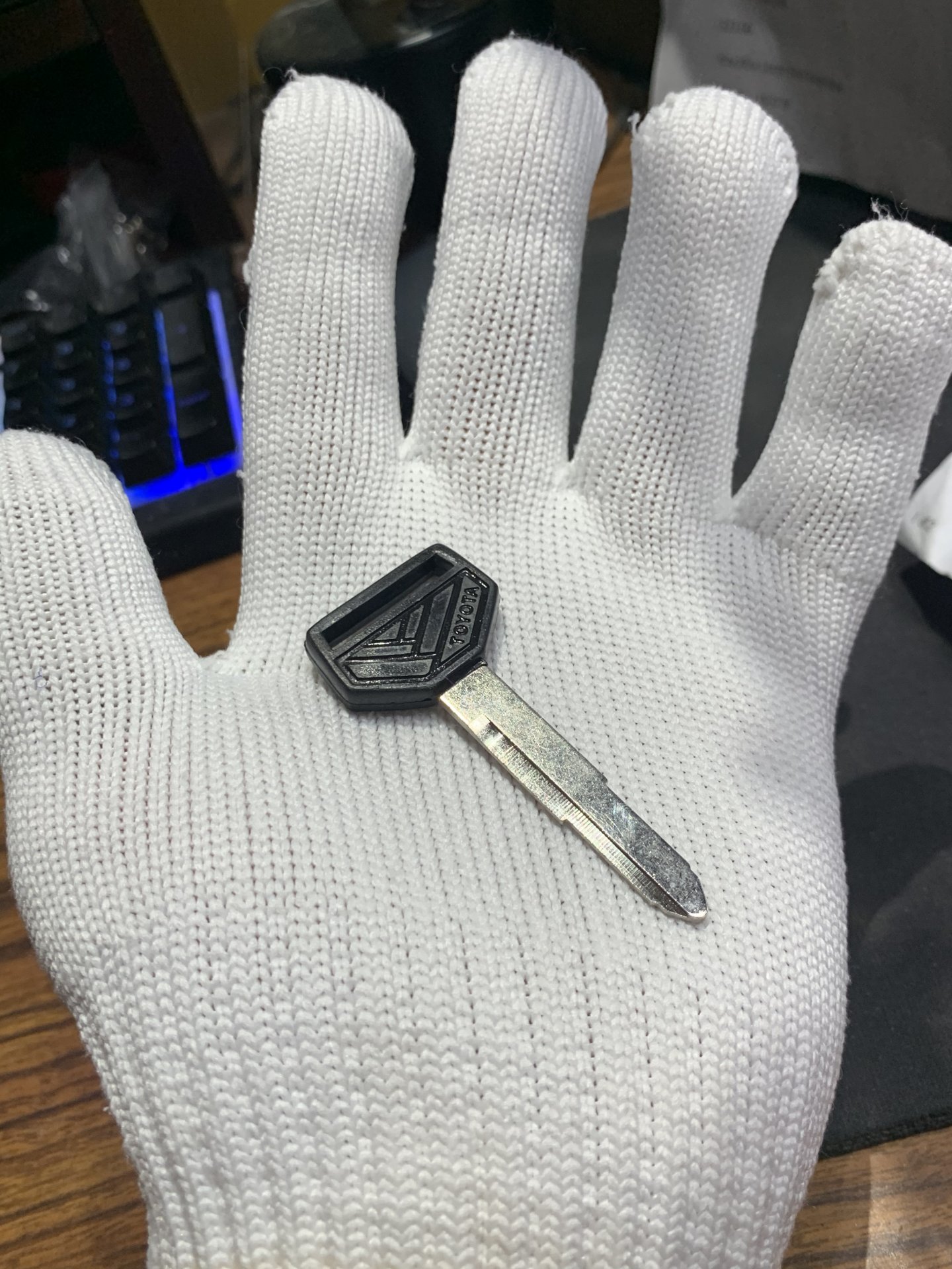

This seems to happen most frequently with a replacement all-metal key. When I use the one with the black plastic head, it virtually never does.
If I keep playing with it (turning, removing the key, rinse, repeat), eventually it works. Sometimes it seems like making a minor adjustment to the way I put in or turn the key helps.

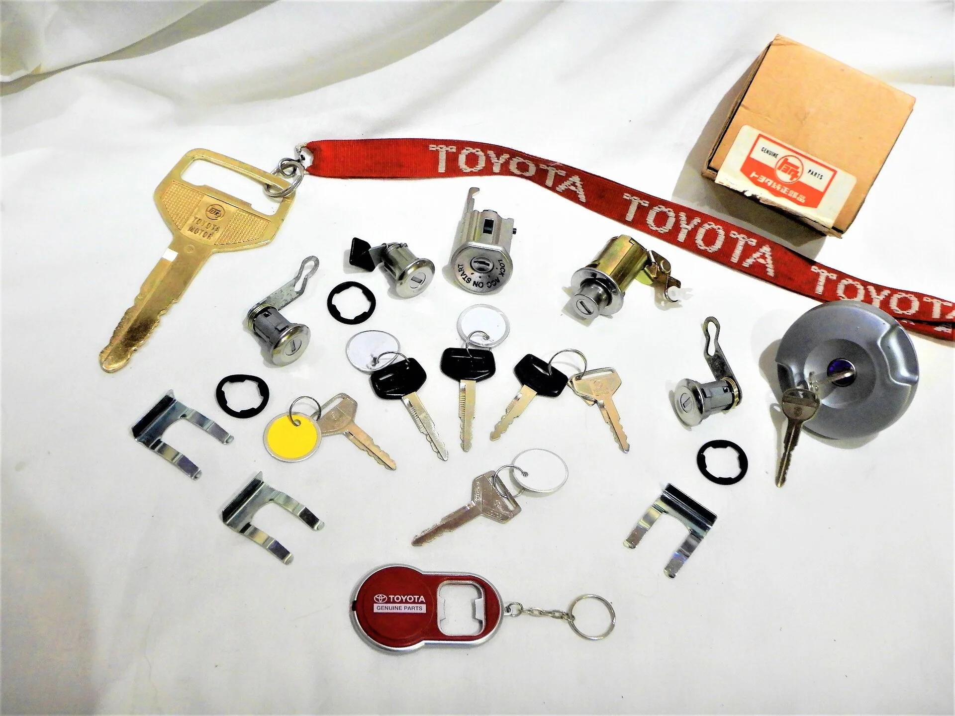

- a FJ62 has 6 key cylinder locks ....
- in what order are they used , and which ones will inturn wear out and fail first in a methodical order and why :
- # 1 Ignition Lock cylinder , its used each time the truck goes somewhere , you may lock and unlock the driver front door ,. but not every time you stop and go places , like a gas station , key off and out of column but who locks there door at a gas station pumping gas ?
69057-90A08
- #2 drivers door lock cylinder , you use it to gain access initially , NOBODY uses the passenger side door lock to get in to drive do they ....? parts # 69052-90A06
- #3 rear push button hatch , you go to it vai a oem code cut key , for many reasons first , like loading grocery's after shopping , if u open the drivers door first , you take your hands off the cart packed with Carrots and Corn and SNOW Crab legs , and nobody walks more then a step or 2 away from a cart with no hands on it , so back hatch it is first ..Part # 69055-90A14
- #4 the pass door , used for loading up stuff of gaining access in tight areas , its limited but there ..Part # 69051-90A06
- #5 fuel door lid , well after TOYOTA upgraded the FJ62 fuel door release cable PULL T handle feature , who the hell ever stuck a key in that key hole ever again and why ? this creates a long term slow and painful death for my little guys there , so Part # 69058-90A02 dies on the vine turning into white powder as the decades roll buy , but does see plenty of use on a FJ60 , no release cable .. it.s a good DAM thing that fellow out there with the PET Black Squirrel has our backs on this with his.
Part # 69058-90A04 , :D
- #6 lastly , . if anyone has ever put there JAPAN Spec. NIKON in a FJ62 Glove Box , then used the key to LOCK it correctly please raise your hand ?

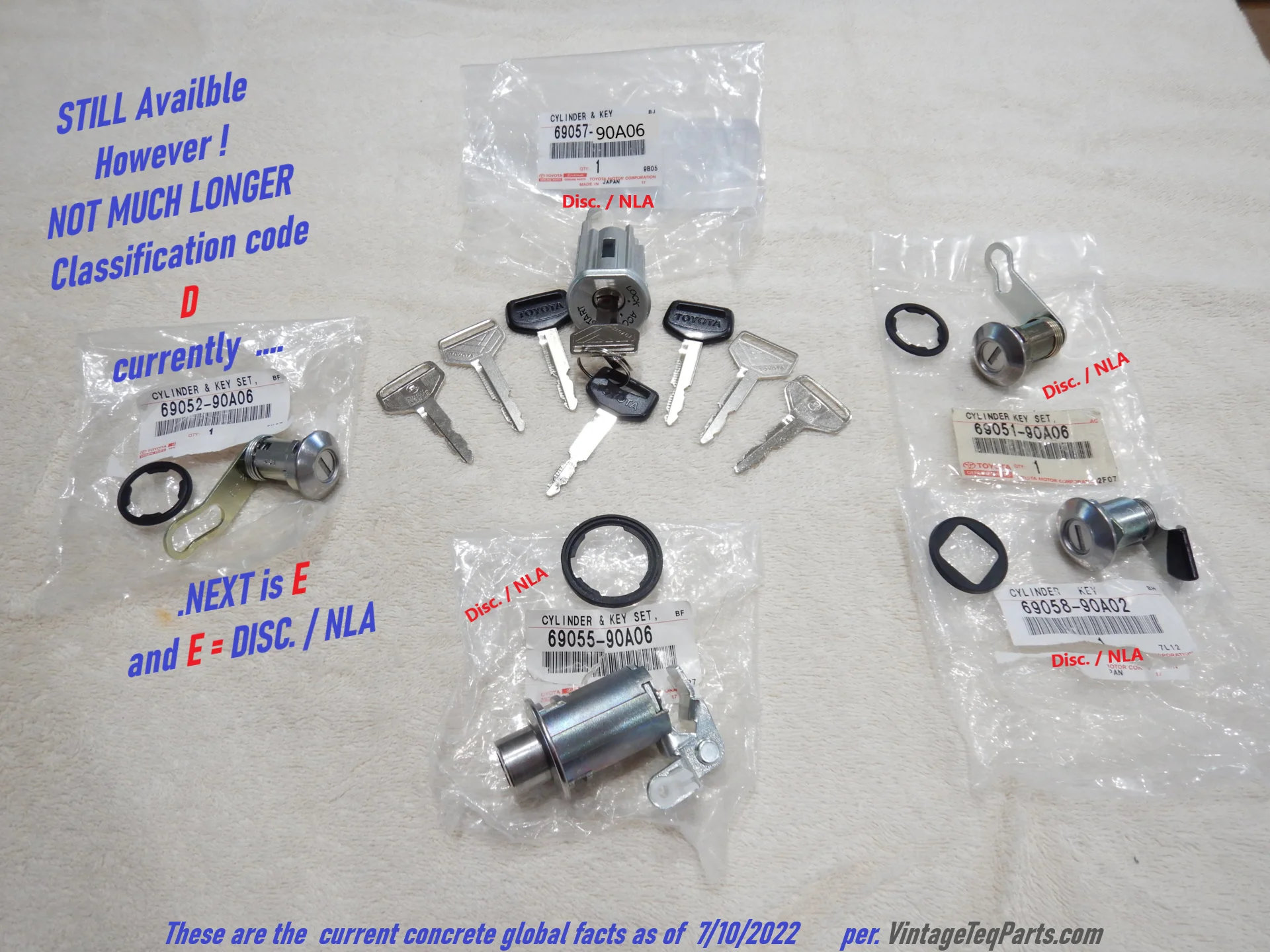

- the last very few short years i have seen , ONLY the FJ62 power actuated lock , was Disc. / NLA many many years ago , maybe even close to 20ish ...
- i recall clearly all others including the FJ62 manual push button lock was a healthy classification code global price tape ..... Part # 69055-90A06
- well , in a almost un-natural rapid motion one by one ALL the other locks for both 60 and 62 were and are being AXED globally , in the last 2 2 1/2 solid years ...
- the only lone survivors were the FJ62 ignition lock and the Drivers door lock ....
- about 2 weeks ago the drivers door lock on Japan price tape was NLA / Disc. this happens first to stated production has ended , its disc. now in japan and Saidi Spec . markets , here in the usa it's NOT , only due it having a small amount of good stock still floating around , and perhaps a trickle few in transit still from JAPAN ....
- the FJ62 Ignition lock remains HEALTHY part # for now
- if you like HOARDING FJ62 NEW parts , well game on , Part # 69052-90A06 , if you have not heard of this " thing " well good time to learn on the fly too ....
