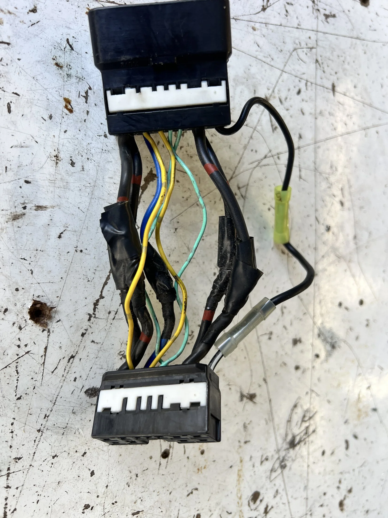

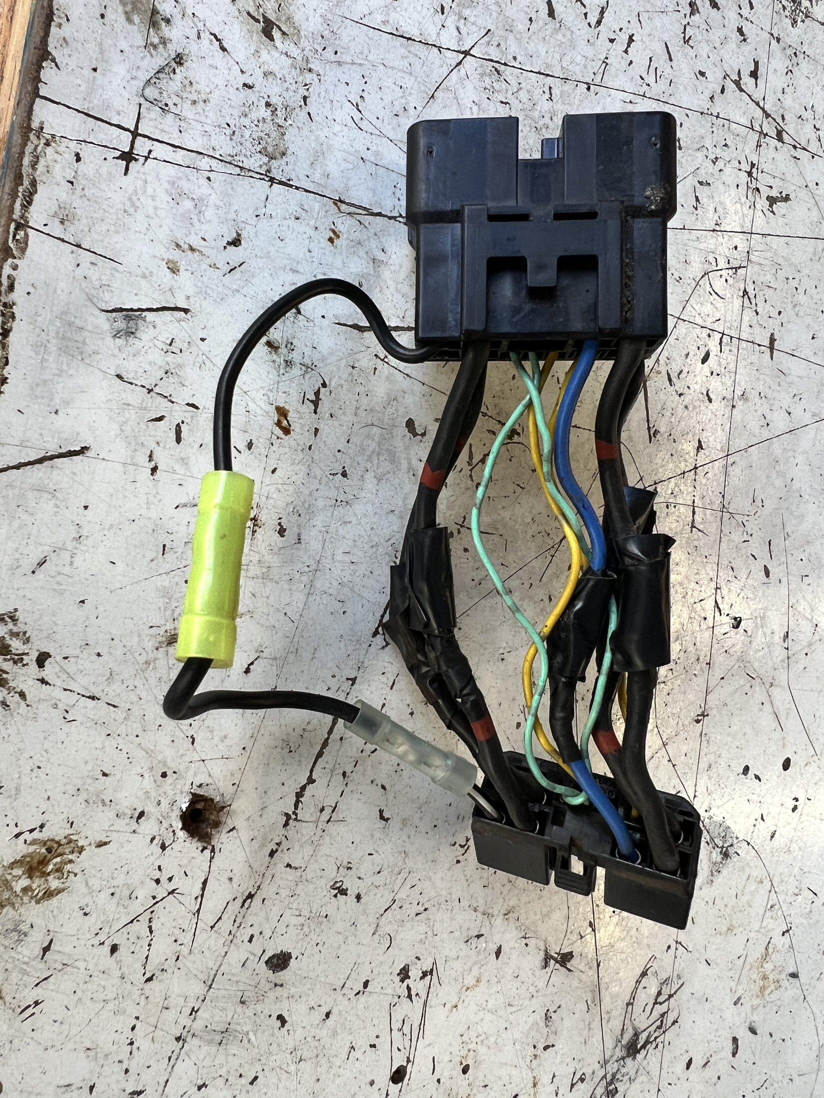

Here's your update. Spent some time this weekend trying to tackle this project. First off, I think many years ago I had already removed much of the alarm. I did not find any alarm module under the driver seat, or anywhere under the dash below the steering wheel or in the DS kick panel. However I did find this plug harness in line. So I removed it and plugged the connections directly into themselves (think that makes sense).
Keep in mind, before doing this my truck would not start. I tried it at least 5 times.
Removed this connection and the truck started up immediately. Actually felt like the start signal was stronger, not sure how to calculate that but it immediately fired up. Turned it off and tried it several times. Started every time.
Drove it around town and it started every time quickly.
Finger crossed this might have solved the issue.

Right on. Here's to hoping that the issue is solved. Yes, plugging the connections back together is exactly the way to do it... don't ask me how I know... lol.

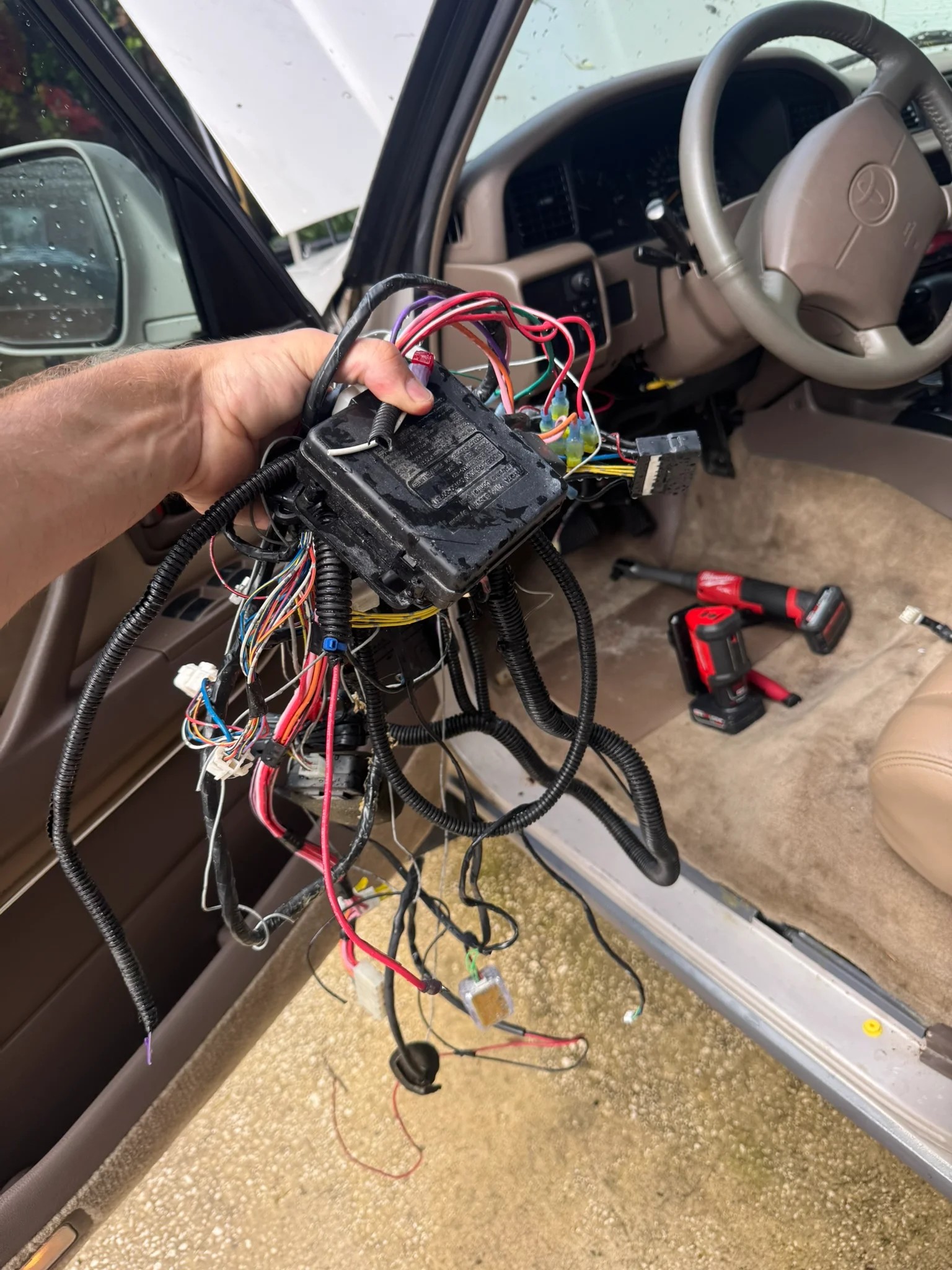

Wanted to drop a note in here for others searching for resolution on an intermittent no-start issue. I've been chasing this thing for literally years - I would get an intermittent (and sometimes weak) start that came and went. It always would eventually start - so while inconvenient, it wasn't the end of the world. Over time I replaced:
  • Starter
  • Relay
  • Ignition switch
  • Ignition switch bracket
  • New ground and battery wires everywhere
I realized that the no-start was more likely to happen the longer it had been since I had disconnected/reconnected the battery. I've been putting it off, but I finally decided to tackle pulling out the RS3000. I dug in, immediately found it under the seat and tried to trace it all out. That's when I found it - the motherlode of rats nests, the big chungus of wiring monstrosities. Someone had daisy chained another security system into my port-installed RS3000 wiring. It was like untangling a web of lies - one wire just led to the next and the next. By the time I finished, I had pulled out maybe 5 lbs of wires and boxes.
Thank god it started back up once I finished surgery - and you can immediately tell that (1) it's making better contact (2) no delay/finicky start (3) all the no-start symptoms are gone.
