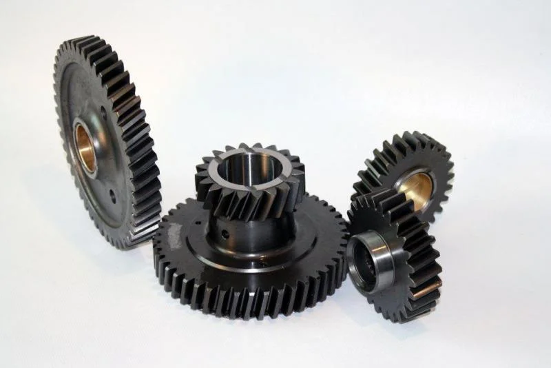

split case 4:1 gear sets!!!!!
How are these in the beef department? Durability behind 300+hp V8's? Available in both idler shaft sizes? Machining effect the case strength?
they're "bigger" than the gear sets in the orions. i have not seen any chipped or broken gear teeth in any orions, and i've worked on a few. i've also never seen a split case break due to the case failing. if have seen a few crack due to neglect; owners not rebuilding the case when the idler shaft went bad eventually leadiung to enough gear mis-alignment to cause the idler gears to break. they in turn then get wedged between the gears and case and something has to go.........

that's a tough call. right now i could'nt answer that question in confidence since nobody has run the split case gears. on paper the split case would be the way to go. i have probably built 40 or more orions by now and i have three more sitting at the shop waiting to be built. i've also built quite a few stock early cases and a lot of split cases so i'm pretty familiar with all of them.
i guess we'll see what happens when i start putting some miles on my new gear set. it will be in my DD vortecd 80.

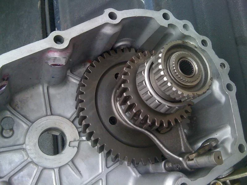

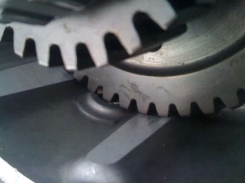

alright, some mock-up pics.

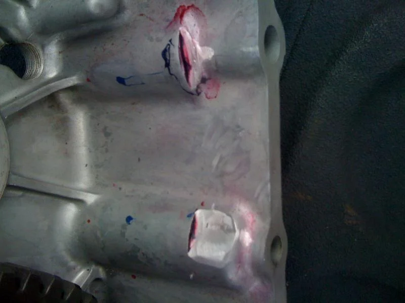

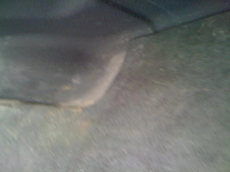

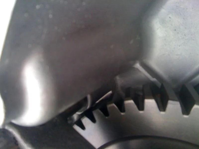

the rear half needs to be clearanced for the larger idler and the larger low speed gears. realistically it'll take a fly-cutter with the case half bolted to a jig. i'll probably end up building a jig. i do have a bridgeport mill and whatever tools needed for the job so that won't be an issue.
the front case half requires no mods.
sorry about the crappy pics, digi needs a charge so the iphone had to do.
hth
georg @ valley hybrids

Just a little "shave job"? Nice!
That is not as much as I would have thought.
Very nice.
If it aint tight, it aint right.
Looks good.
It looks like the main shaft gears use the 60 type bushing not the 62 needles, correct? Either way it looks perfect for a 80 axled buggy.

Wow, that's tight, but it seems to fit. Looking forward to the rest of the pictures!
Only if you change to a main-shaft from a 40 or 60 split case. Everything else should be the same.
No sweat on that clearance job. Most could do that themselves.

not so sure about the "do-it'yourself" job on the case. it's gonna get pretty close in the ribbed area. i might try to find a junk case and punch all the way thru it so see how much meat we're left with when then job is done. well, done "properly" anyways.
