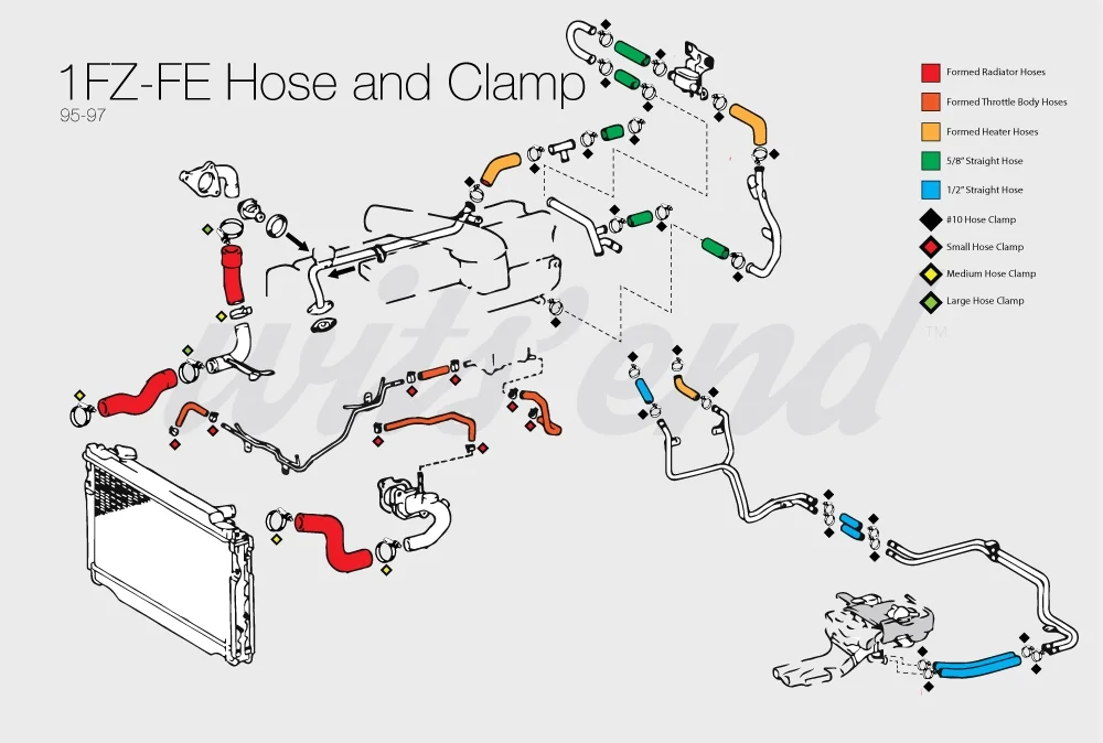

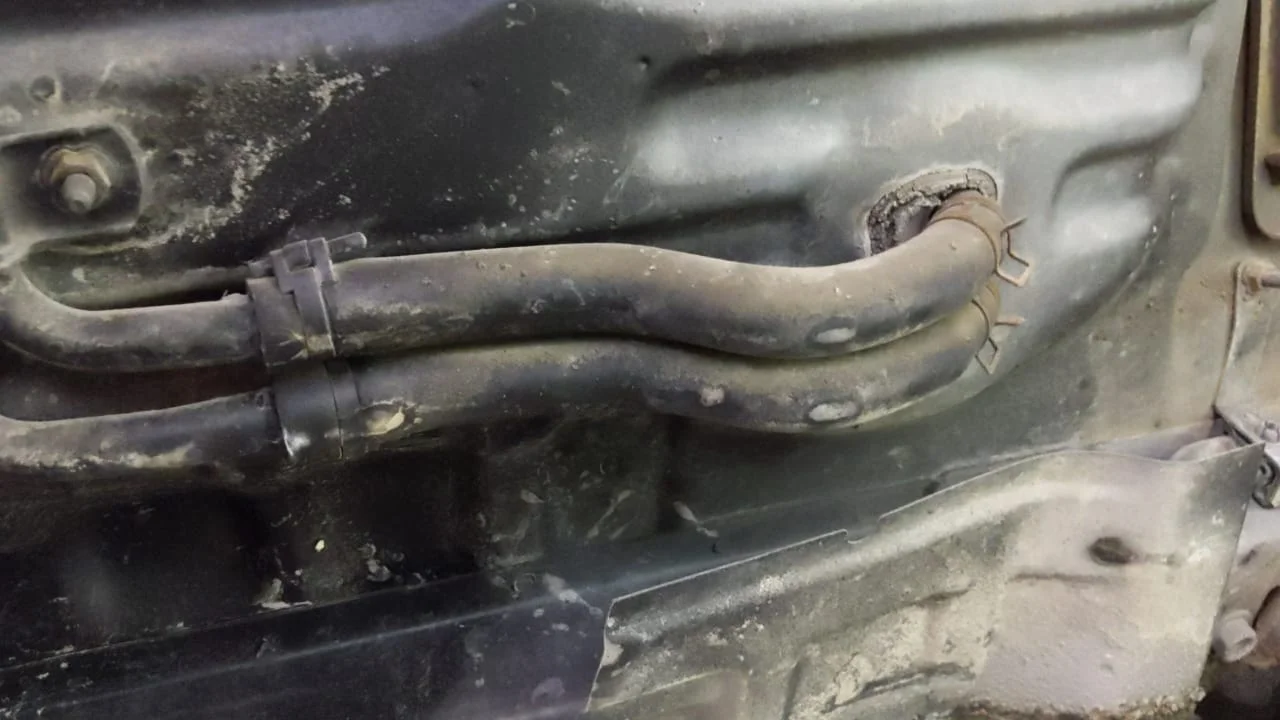

Yes you will be fine with gates green stripe. Keep those clamps as those are the “constant torque” and superior

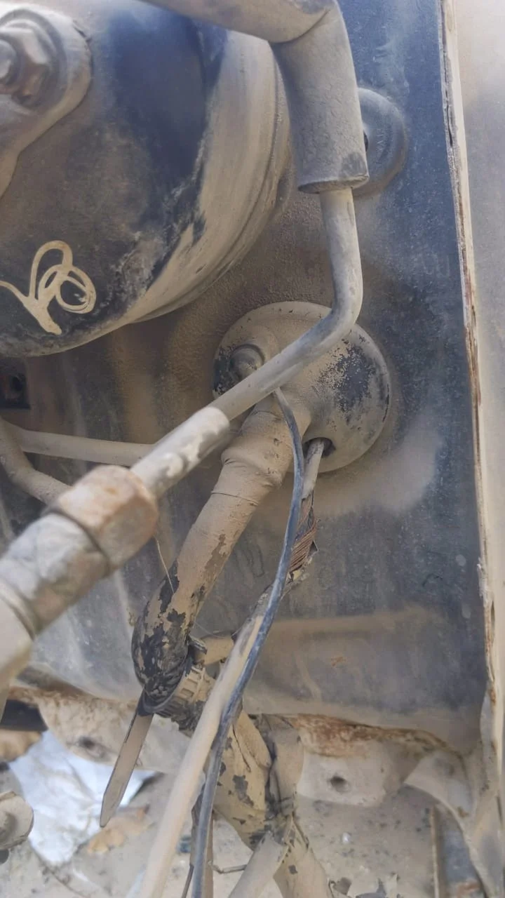

here is a pic from Joey website, green and blue is typically just a straight hose cut to length

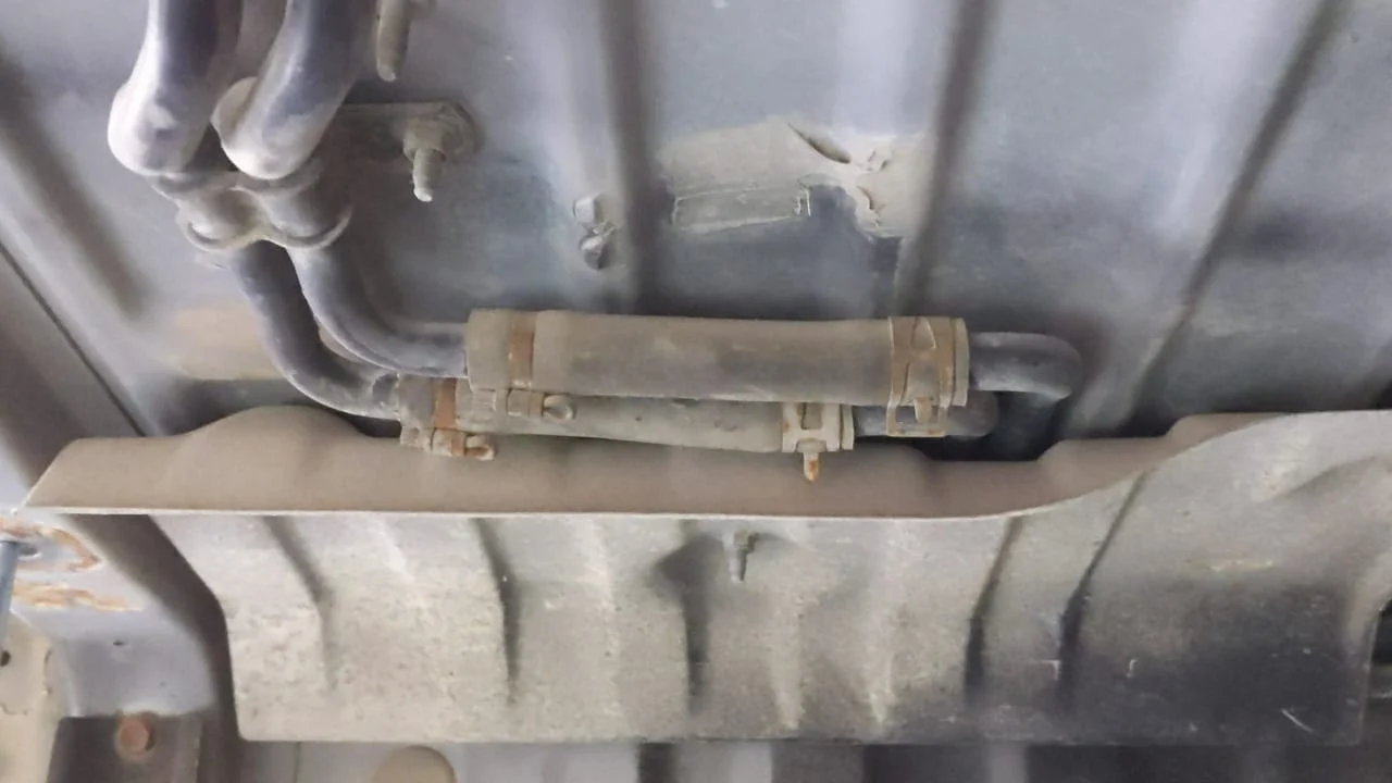

These rubber hoses are pretty hard and have to go.
So do these.

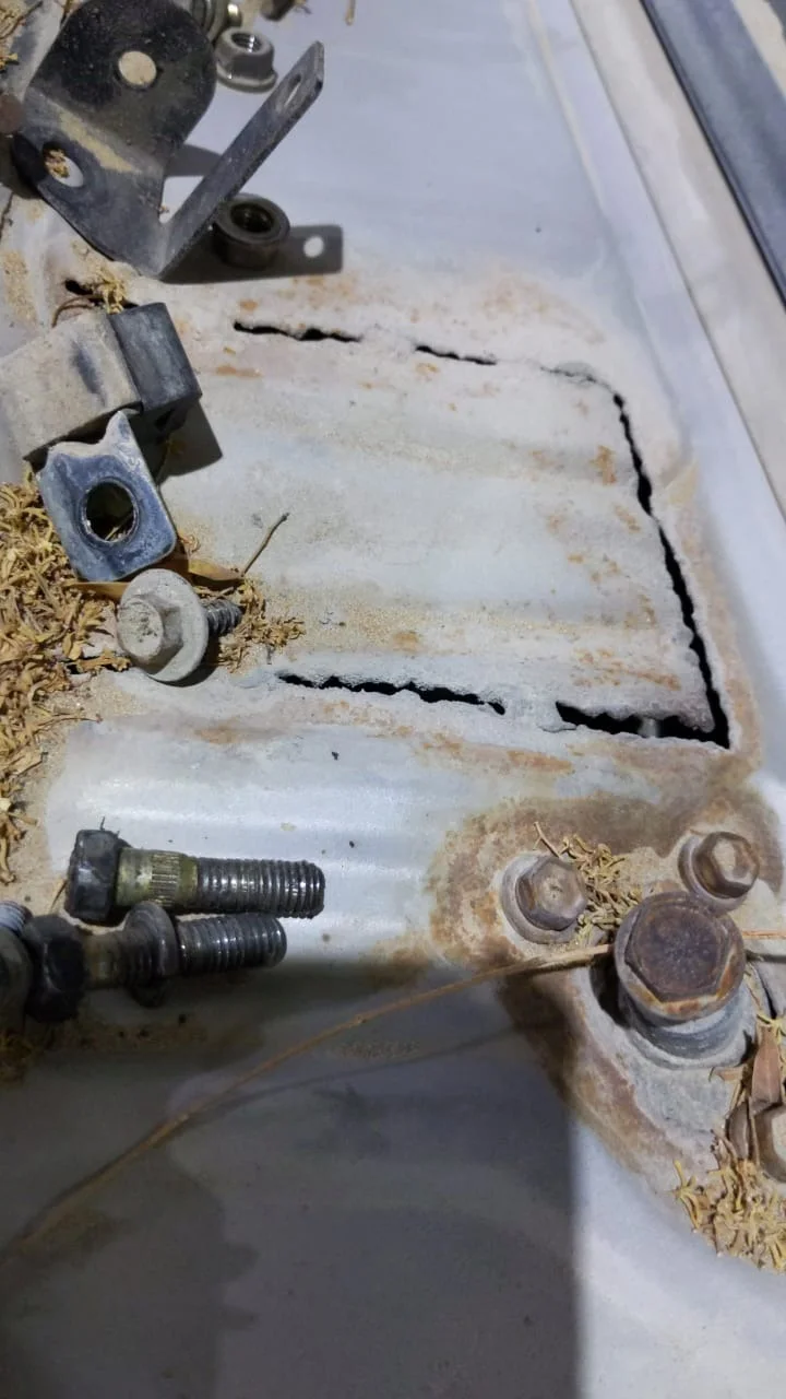

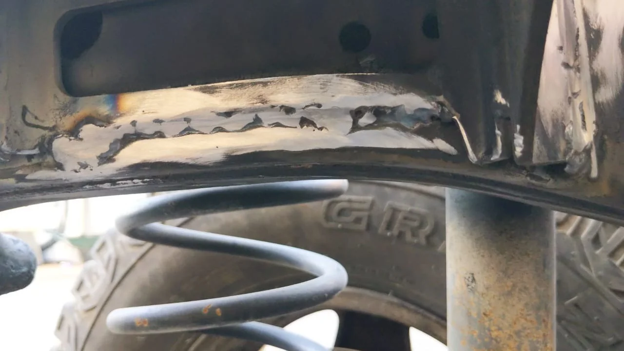

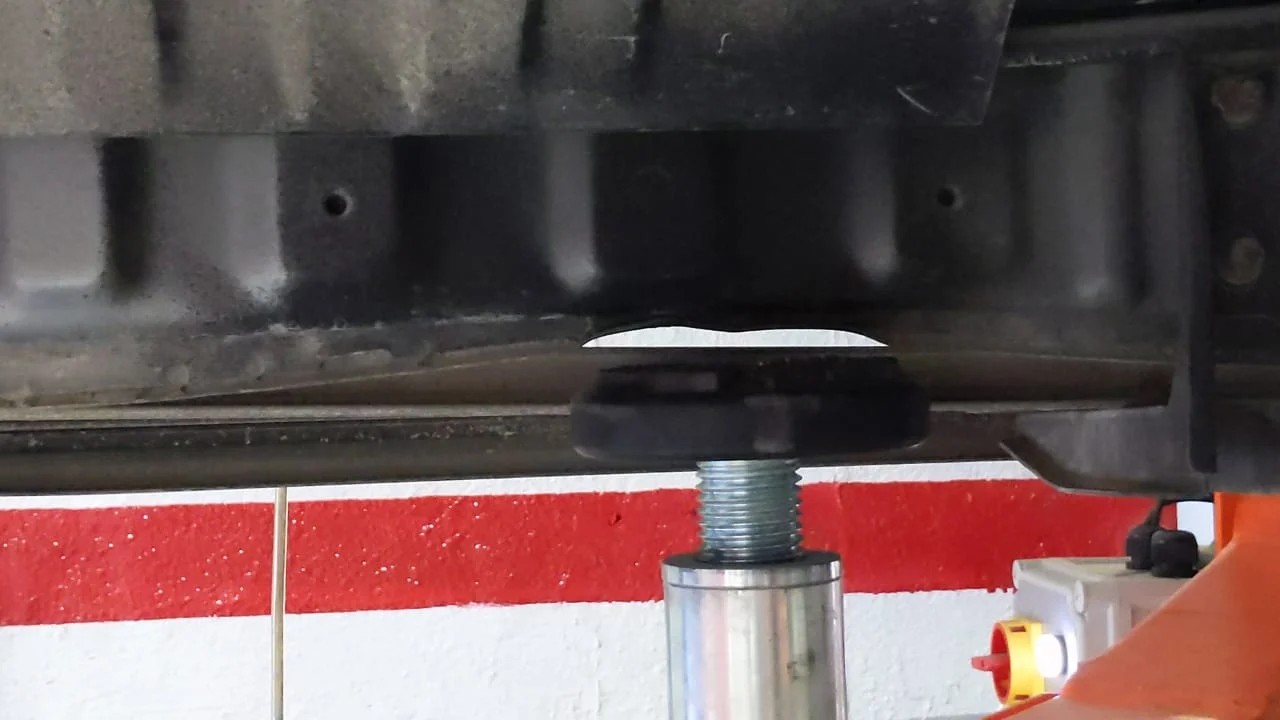

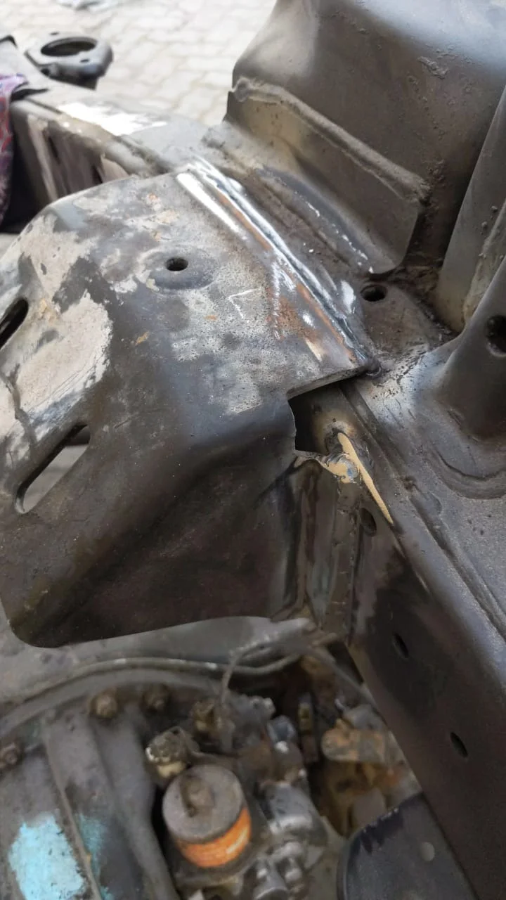

The only issue I saw was that the truck had been jacked up on the body rather than on the hard points and it has bent the body itself a little. Nothing serious and I'm inclined to let it be. I think the repair would be hard. You can't really see it when the car is on the ground. I wish it had not happened but it is heavy truck and it has been through a lot by now.
View attachment 2692321View attachment 2692315
It just looks like you've been rock Crawling, Really that's a shame that happened and you're correct it would be really hard to fix that.
It not going to help resale value in the future either.
This is a pretty freakin' big deal John. I'd be pissed. And I'd let the foreman know you're pissed. This, on top of the guys not doing sealant after you told them to.

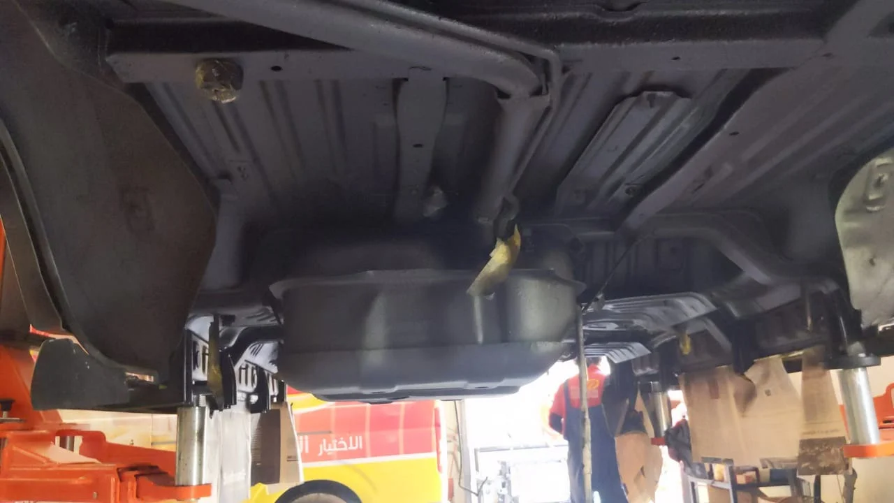

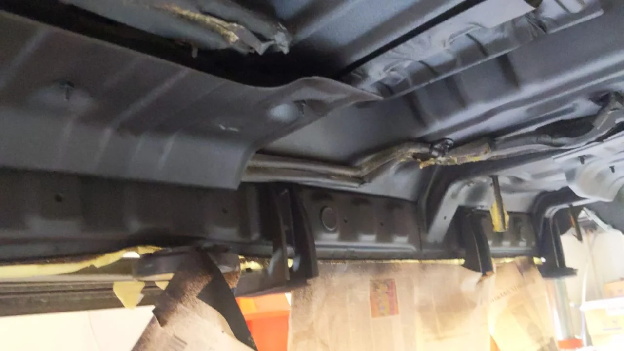

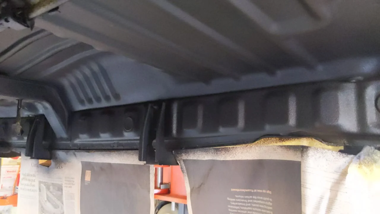

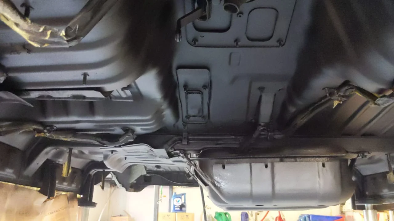

I made it up to the warehouse today (focusing on the 70 series), but I did stop in and see how things were looking. The guys have been working on the body mostly. Putting on some fresh undercoat while everything is open. This is the patch where at some point in the past the truck was converted from RHD to LHD. This is on the passenger side firewall just below the aircon pass-through.
As you can see, they have not done anything about the damage from improper lifting. The owner said he will make it right. I will give them time.

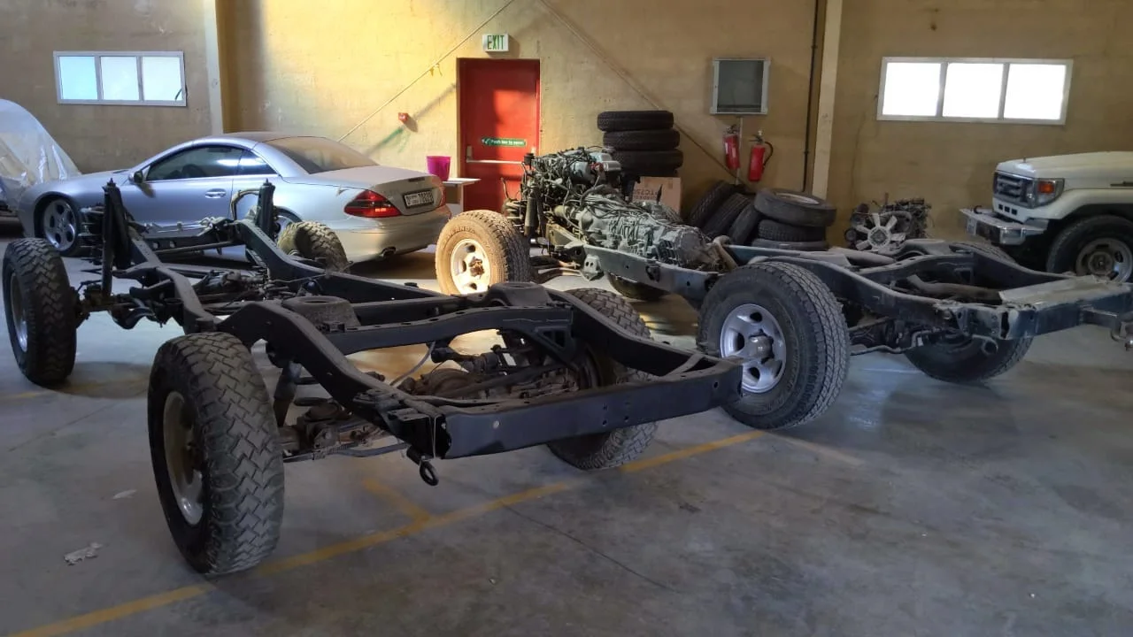

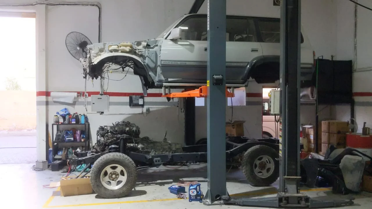

Finally, here are a couple of photos of what greeted me when I opened up the warehouse today. I thought it was pretty cool.
This is the first time both rolling chassis have been side by side.
That's the Omani diesel 80 in the back there. I got some German non-RTV sealant that I'm going to try on the windshield rubber when I have a buddy there to help with an extra pair of hands.

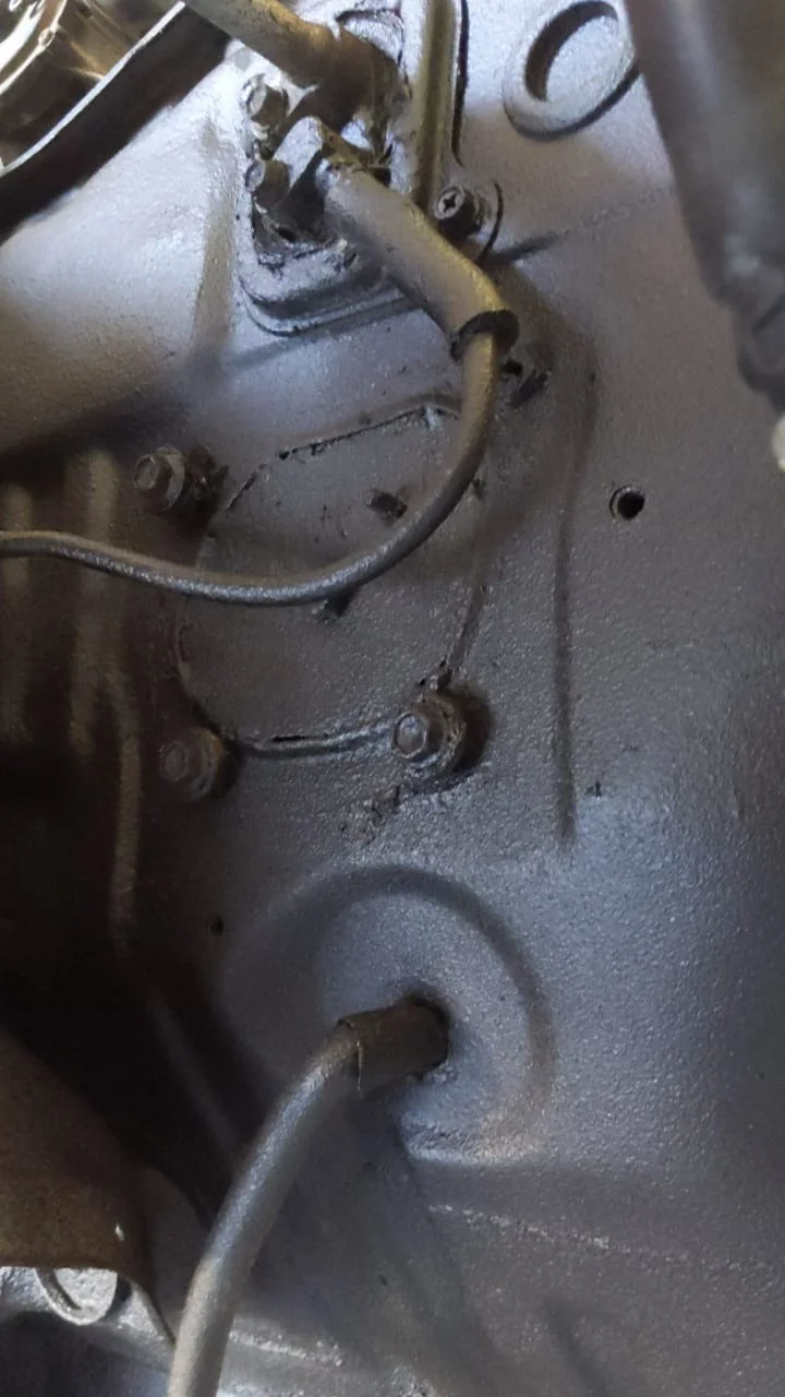

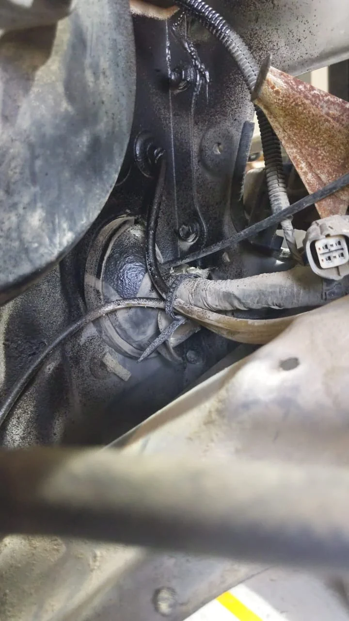

One thing I did notice on the body was that the rubber grommet for the wiring harness was out or damaged or something.
Fortunately the donor truck has an intact grommet that seems flexible and in good shape.
Maybe I can split it and then glue it in with the fancy German non-RTV adhesive sealant....

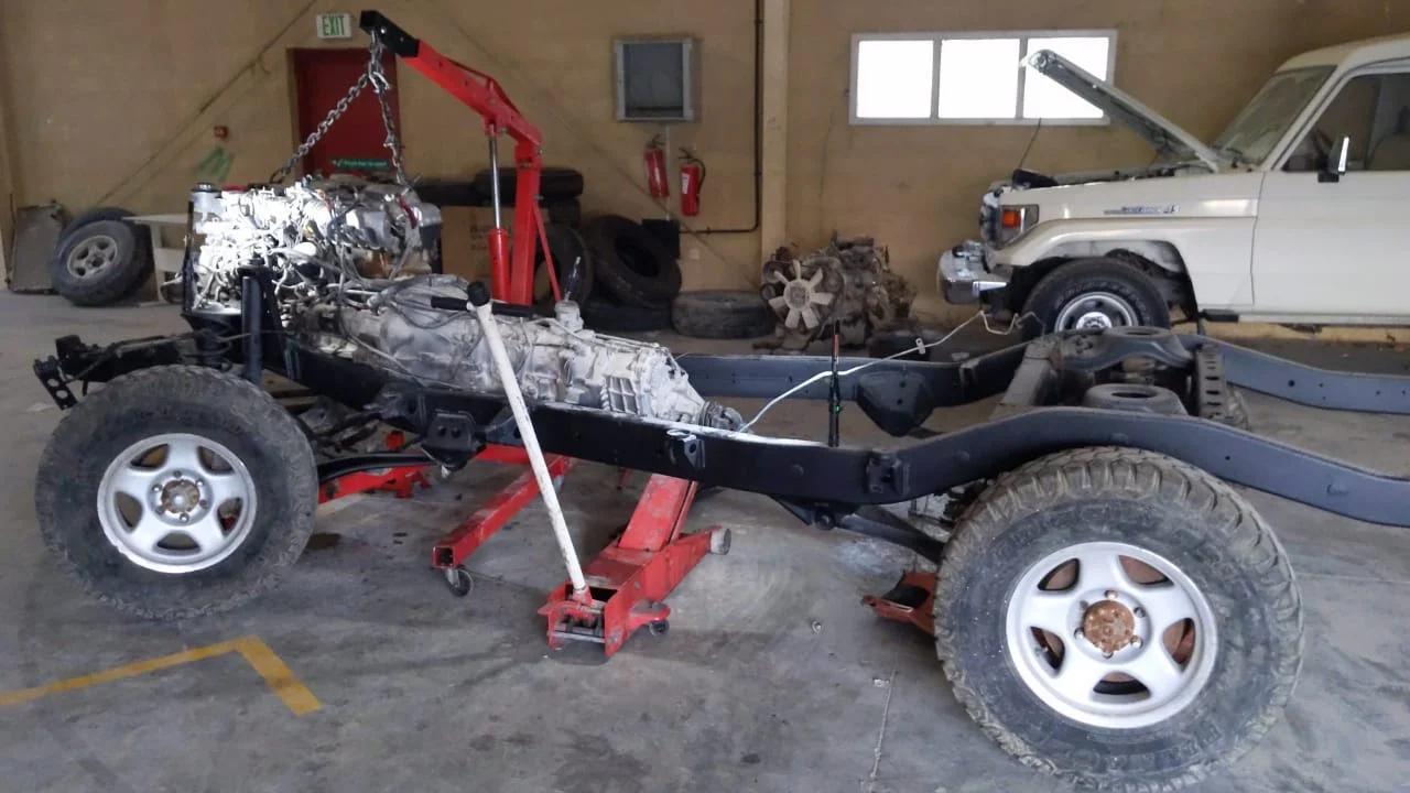

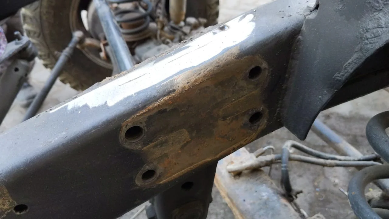

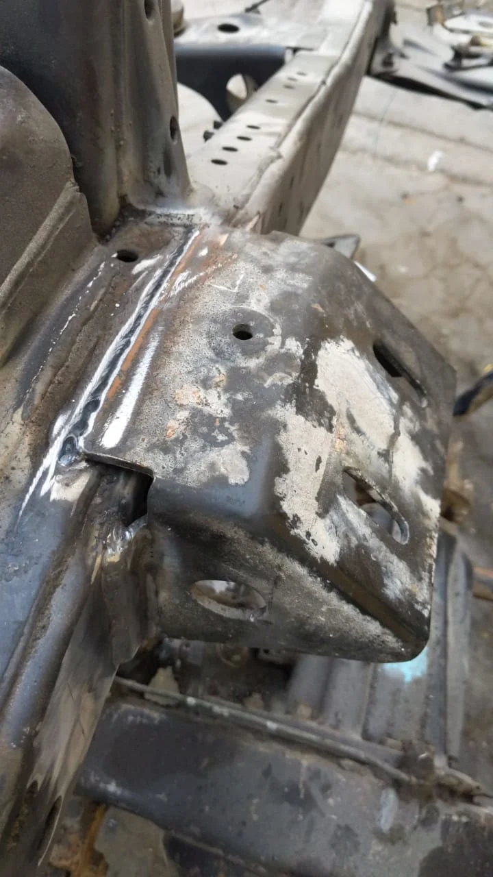

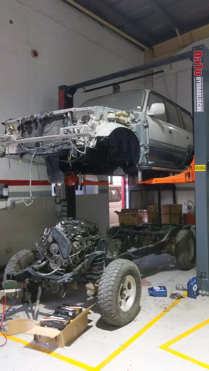

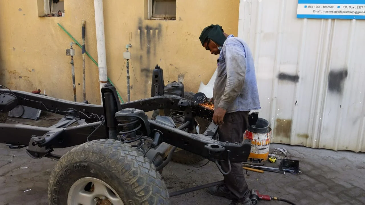

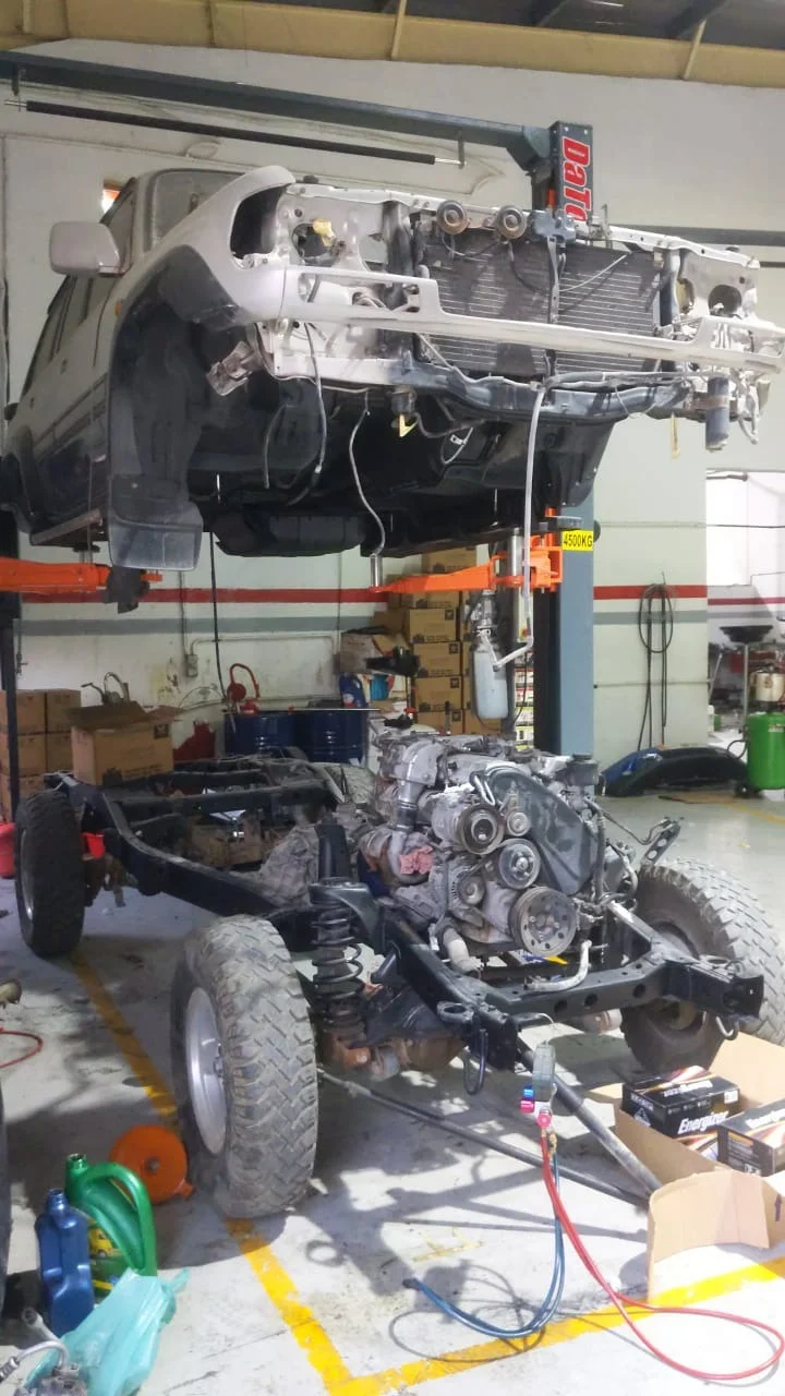

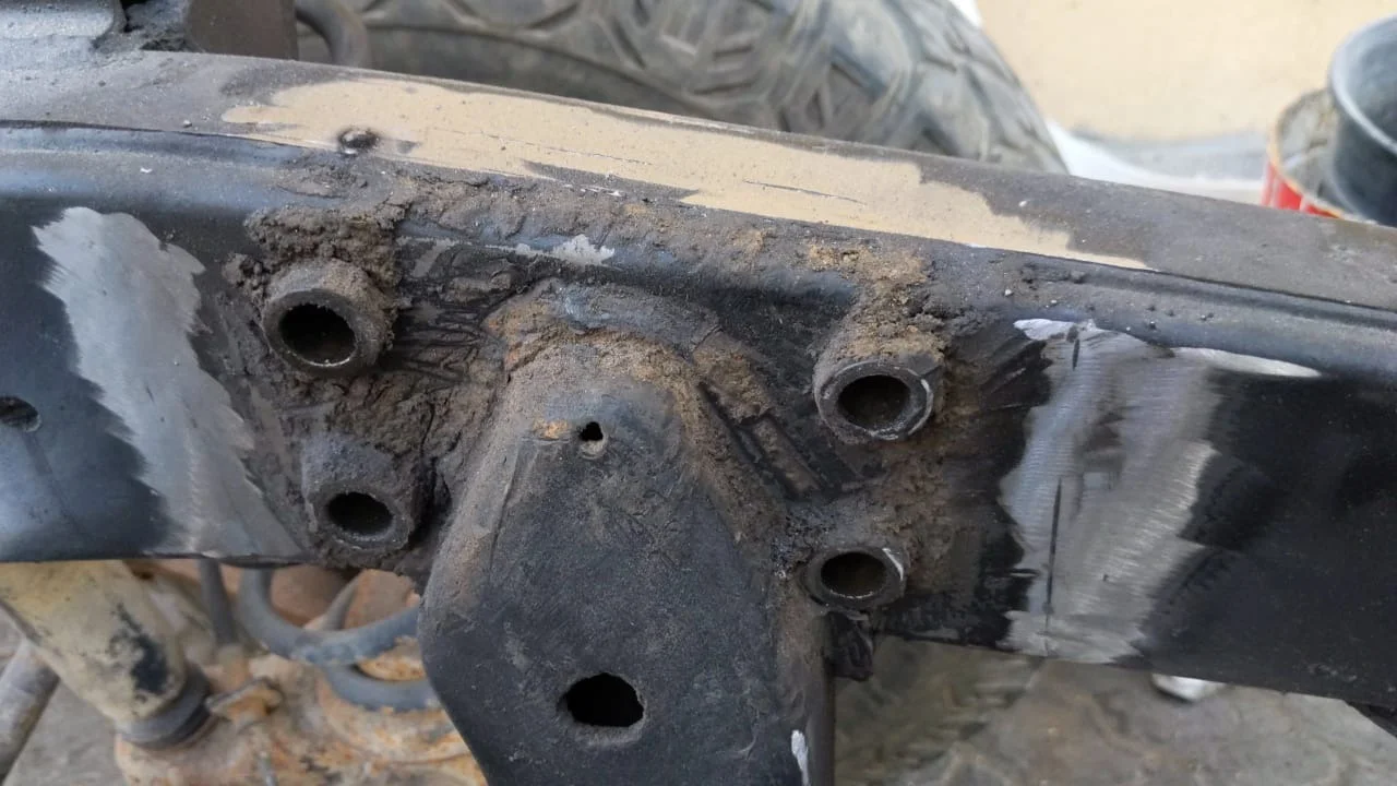

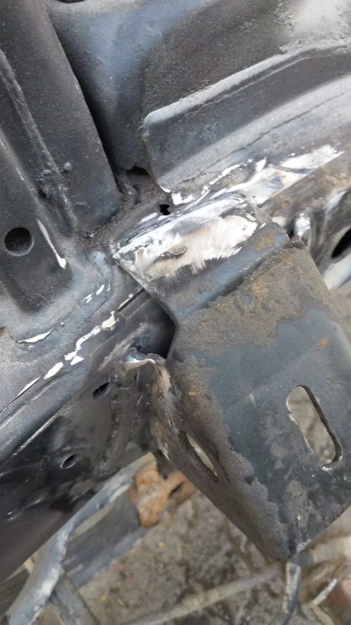

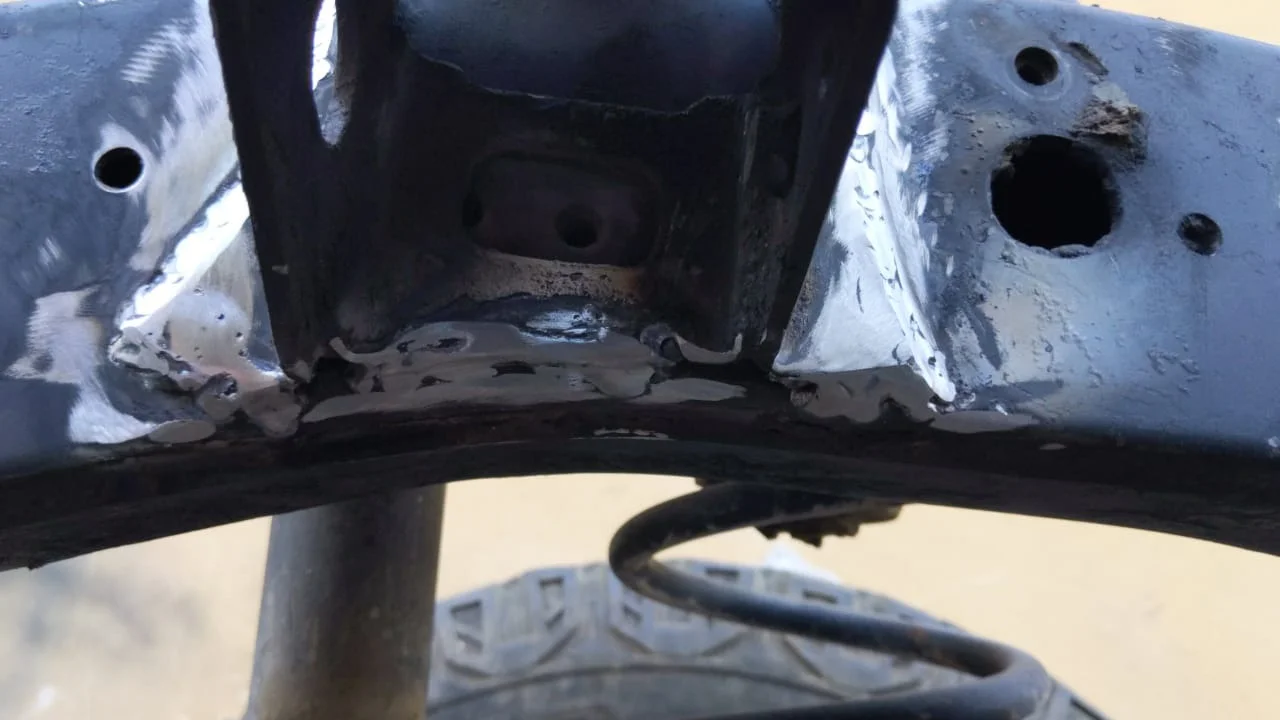

I suppose I could have seen it if I had looked, but the motor mounts are in different places on the 1991 petrol frame vs the later turbo diesel frame. The guys have dismounted the engine and tranny from the old frame and had to address the motor mount issue.

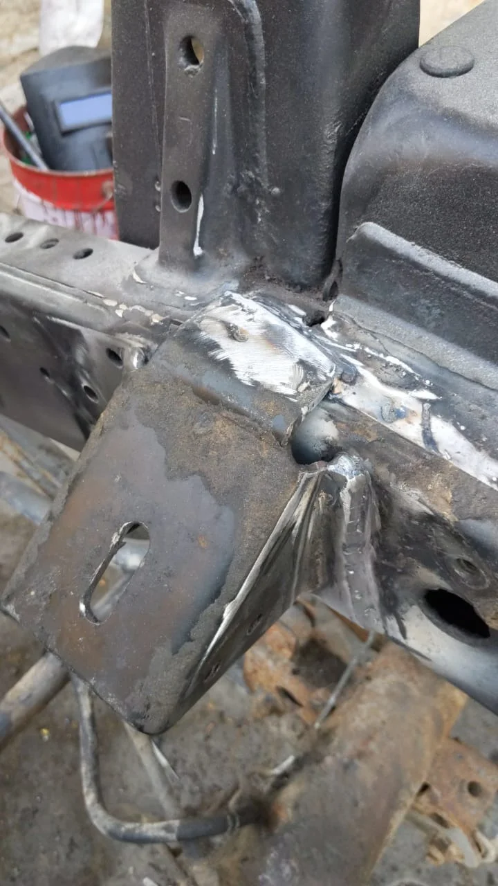

Cutting the old off:
And the new ones welded on
More photos:
And this is where the old ones came off the new (91) frame:

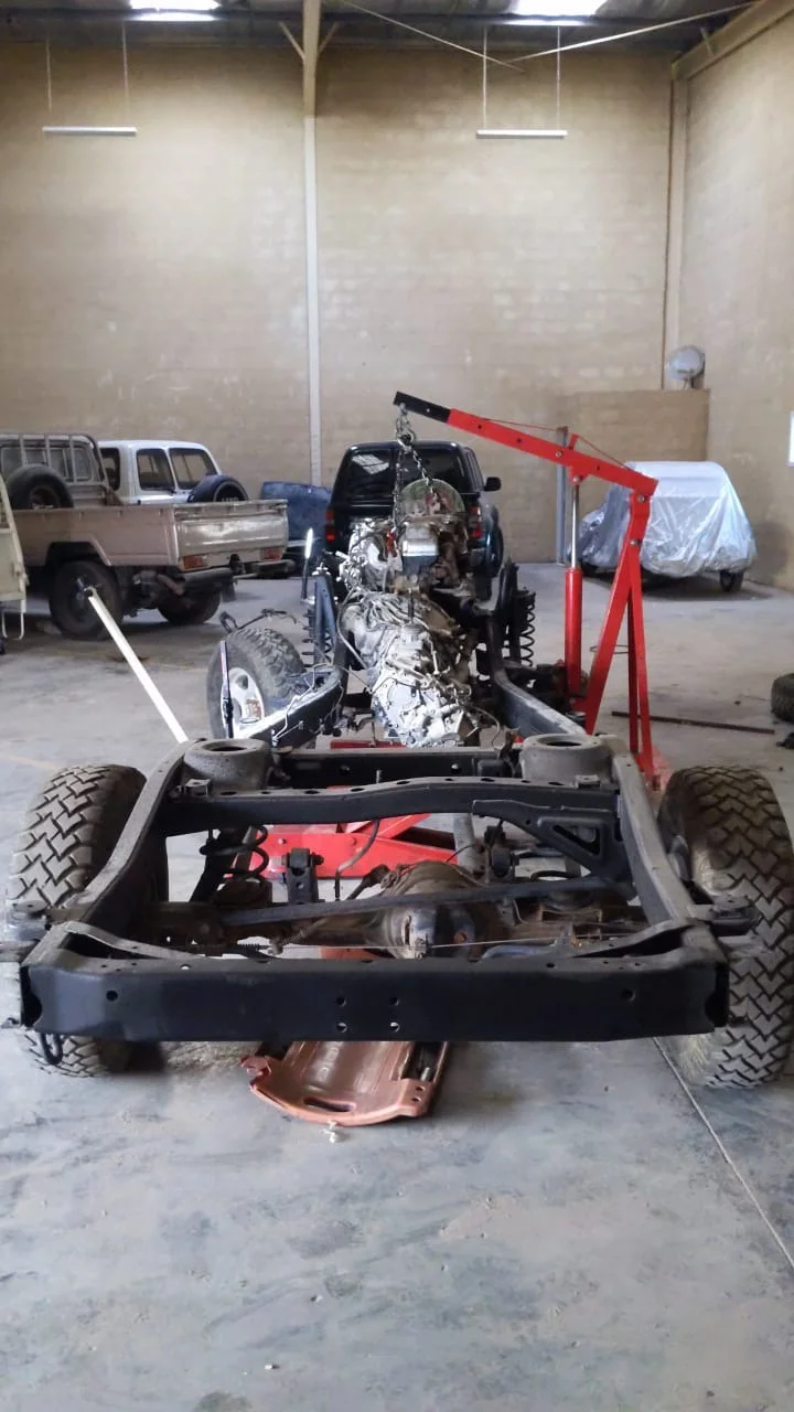

So, ok, we've made some more incremental progress. They test fit the engine onto the new frame:
I went ahead and got new motor and trans mount rubber bit. The old ones were fine, but I figured, why not do this now.
Then the next day after the test fit they moved the chassis back over under the body.

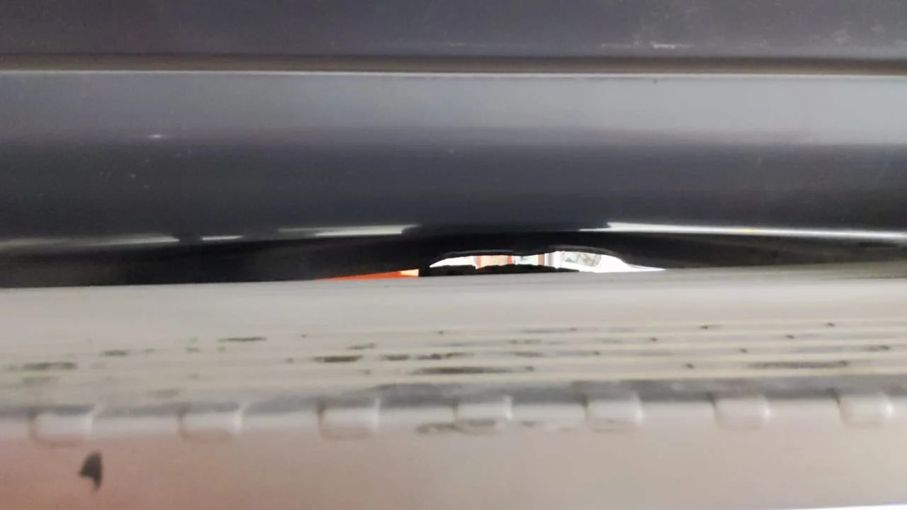

I continue to see little things as this job progresses that I probably never would have noticed before. Like this area just below the windshield where they must have cut something out during the RHD to LHD conversion but never properly fixed.
That's the wiper arm shaft at the bottom there.

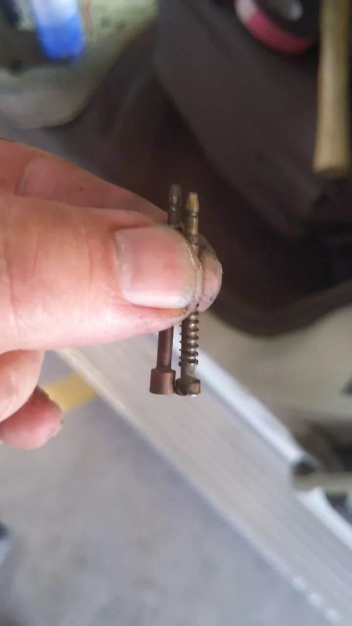

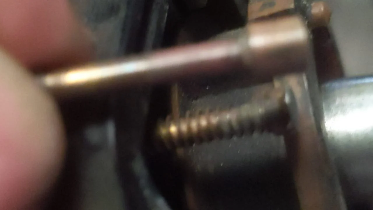

The last thing on the list was a non-working horn. I checked the fuse and swapped in a known-good relay and neither of those were the problem. I was getting exhausted in the heat (we still have no electricity) and I asked the foreman to send an electrician over to lend a hand. Benu came by and within 10 minutes had identified the problem: the wiper for the horn ring had worn down to the point where it no longer contacted the ring. Fortunately I had a spare from the parts truck.
You can see that the head is about half the size it should be. I never would have thought a contact would wear like that. And I certainly think it would have taken me a long time to find this. Benu just knew rightaway.

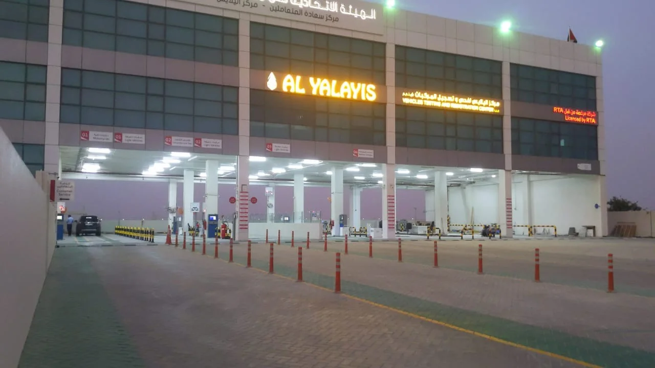

There is a Roads and Transport Authority testing office only two roundabouts away from the warehouse. I could have driven over but I'd heard tails of 2000 AED fines for driving without proper plates. With Oman export plates you are allowed to drive for 30 days I believe but because of COVID this truck had sat since June 2020, so I decided not to chance it and flatbeded it to the RTA.
This RTA testing center is amazingly empty and the staff are very friendly.

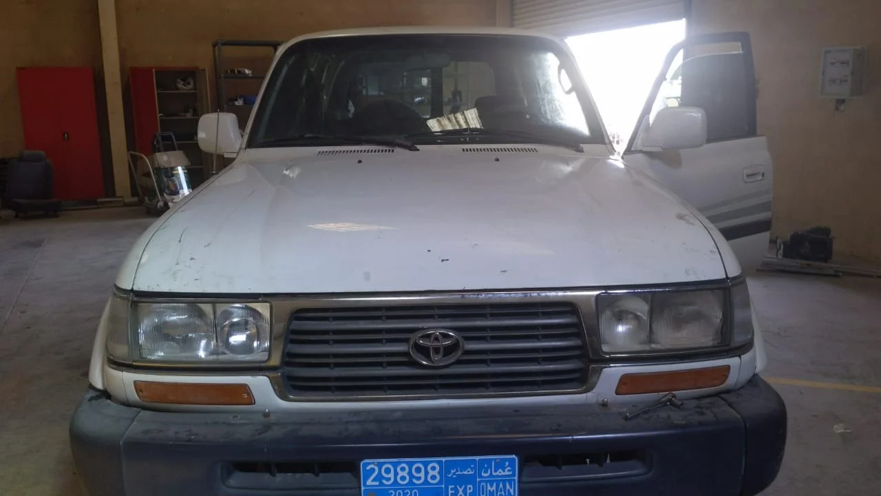

And I'm pleased to share that, somewhat surprisingly to me, the darned truck passed inspection! I've sorted out the insurance for it today and will be getting plates this evening.
I need to come up with a name for this truck. The inside is pretty tatty. Cracked dash, door cards trashed, rear barn door a bit dented, but the basics are all there. I think this is going to be a great truck. I'm planning to swap out the seats for something a bit more comfortable. And maybe even get an aftermarket cruise control for the old beast.

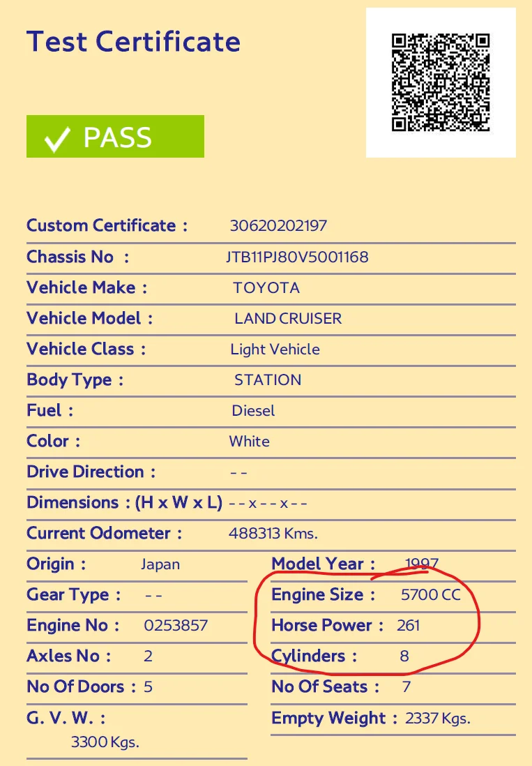

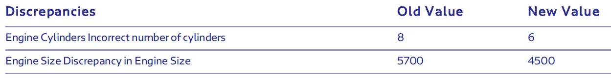

It amused me to look at the details of the inspection passing report:
If only it had 261hp! Wikipedia says my 1HZ has 129hp and 4.2 liters displacement, not to mention two less cylinders. To RTA's credit they did try to correct.

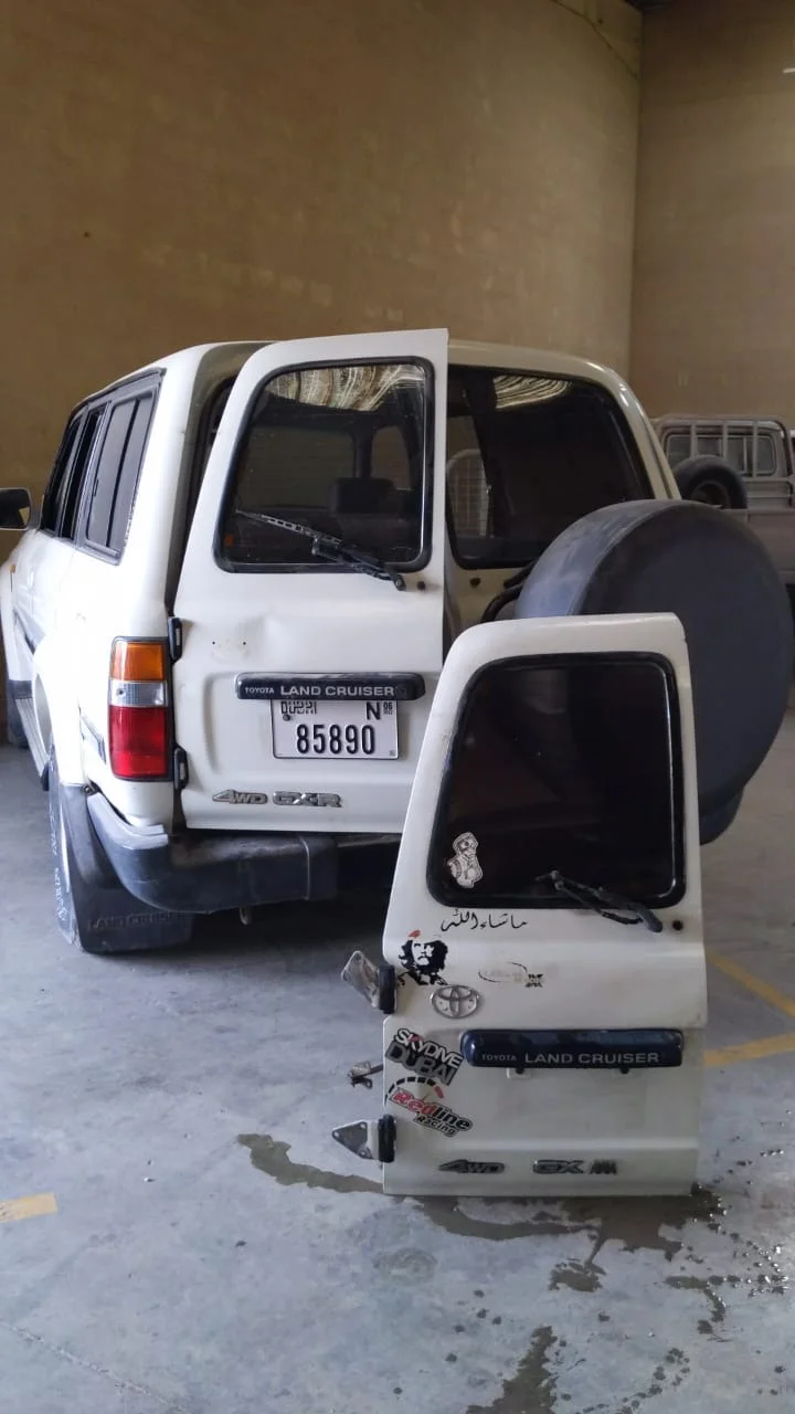

I have a replacement rear door for the Omani truck but I have not looked to see what trim level it might have. I will take a look tonight.
So it turns out that the replacement rear door is also a GX, but a GXM.
My friend Zane thinks the M might be from a Saudi dealership. I've never seen it before.

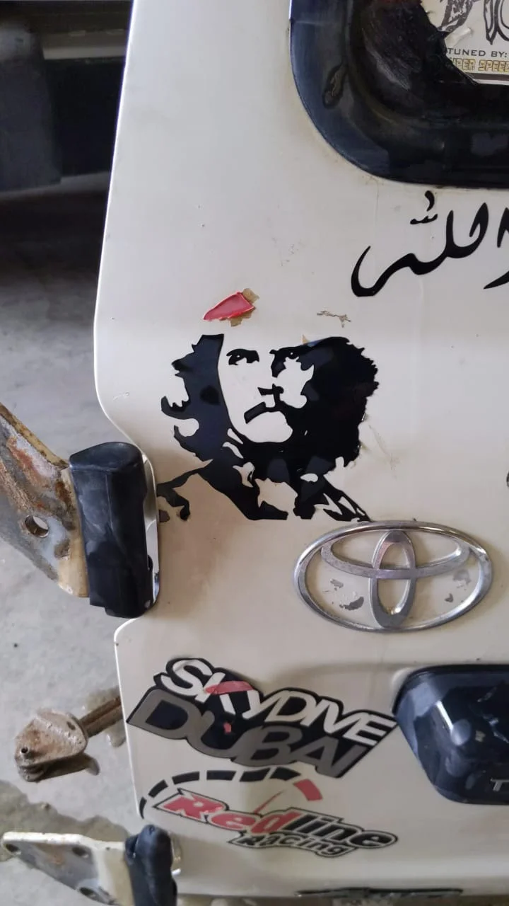

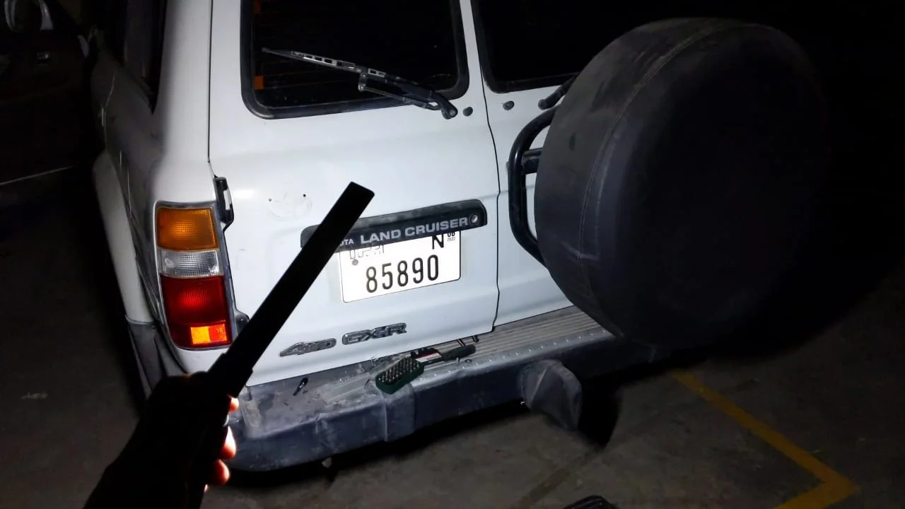

Got to love the stickers:

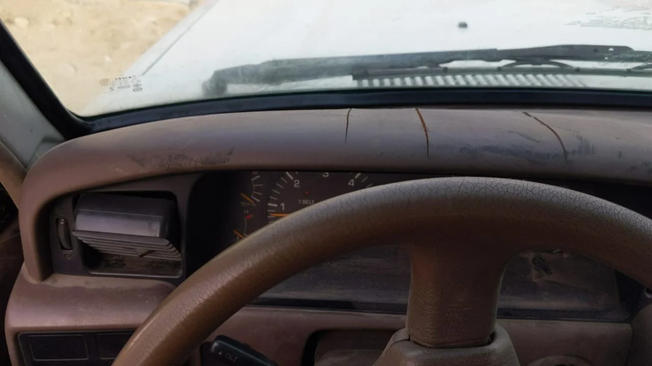

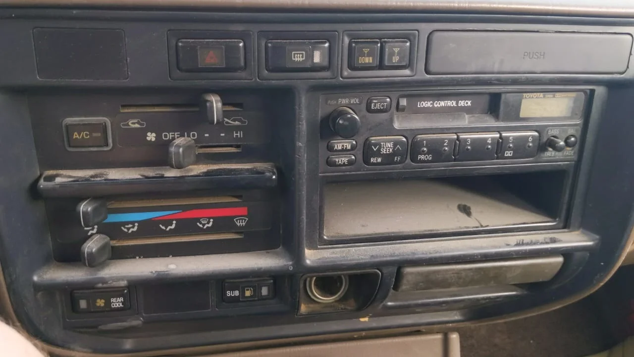

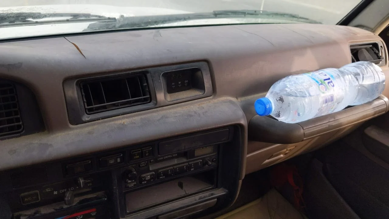

Here is what the dash looks like in detail:
I think what I am going to do is pull the dash, fill the cracks with perhaps silicone sealant and then cover just the upper part with brown or black camel leather. I have a bunch on-hand. Maybe just to be different I will use some camel leather with the fur still on it. That would be different and very resistant to the sun.

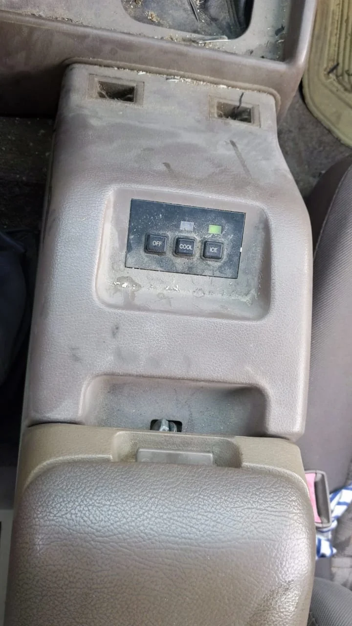

I love the simple AC controls. So easy to deal with. And so foolproof!
And it has the little fridge between the front seats too.
