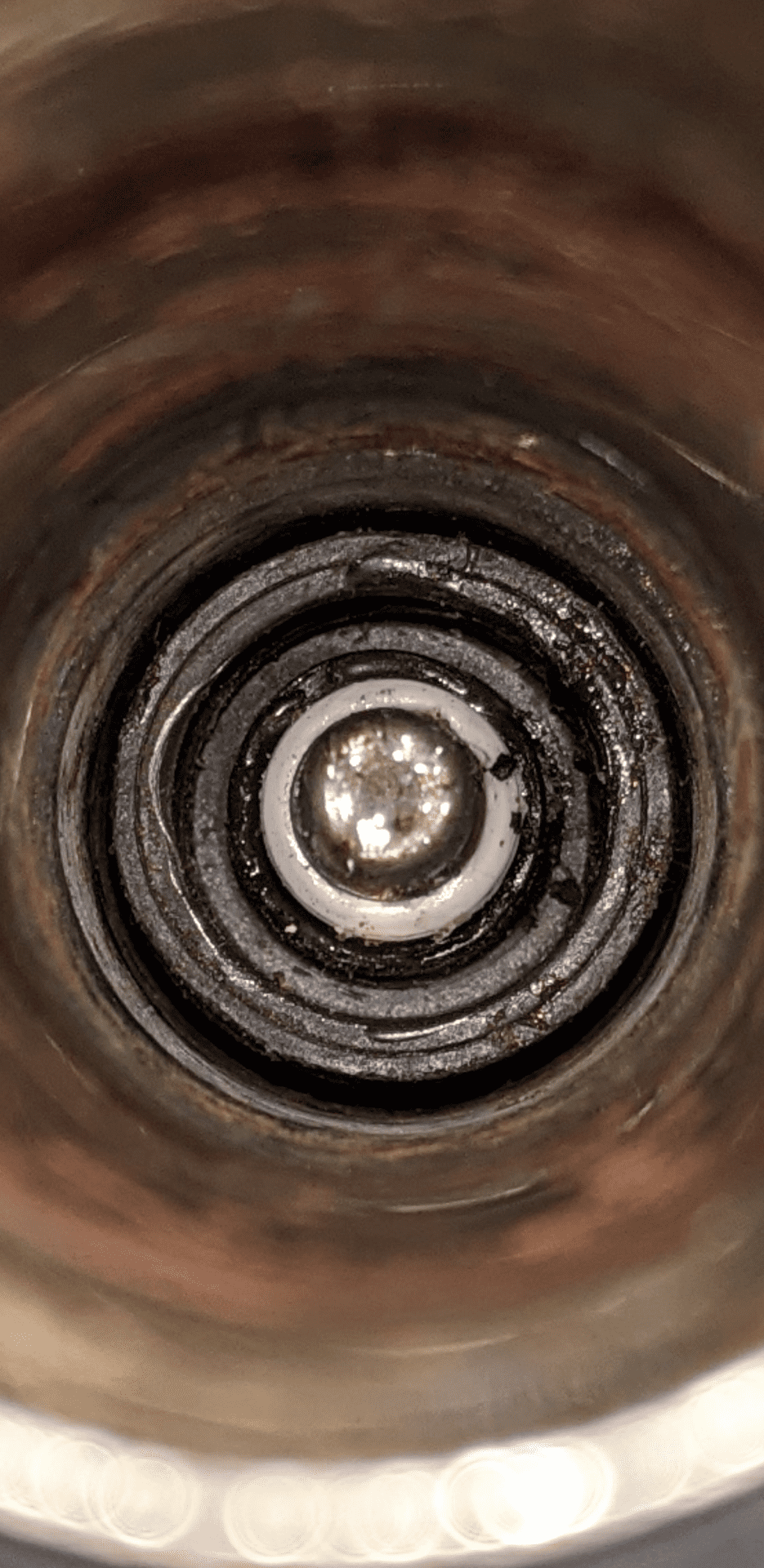

#3 wasn't coming out and it looks like some sort of insert in there - any idea how to get this plug out or what I should do?
So your socket won’t go all the way down on the plug so you can turn it? Remove the rubber piece from your plug socket and try.
Right, it won't turn at all - that rubber is blocking the socket from the plug, I just tried to use a normal deep socket as well.

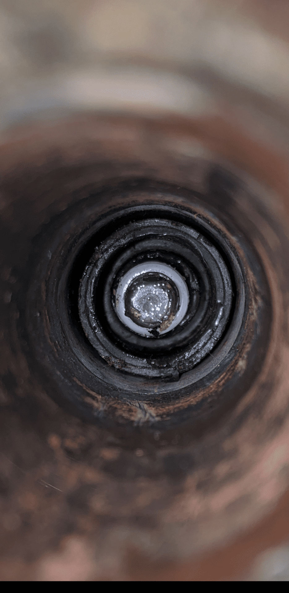

That rubber or gunk out whatever it was is gone, here is a better pick now.. Can't seat the socket against anything though currently.
It's an old broken off spark plug wire grommet.

It's definitely not from my spark plug socket, I'm wondering if that rubber is part of the metal insert..or maybe a previous owner/mechanic.
So to be clear, you pulled your wires off, including this one, and there's nothing missing? I don't see how the socket could have been connected unless this is part of it. Just curious.
I did not notice anything missing, I might have thrown away the old wires so I can't gaurentee some of the boot didn't tear off. So this might be part of that boot and not some rubber grommet part of the insert then.

Awesome, I will give this a try..I think I pushed the rubber down or something when I used a non spark plug socket, but I still see some of the rubber so should be able to get at it. Have compressed air so should be able to shoot it out if I can't pull it out. Hoping there's not more issues getting it out with that metal insert it is in, it almost looks like the insert is above the hex part of the plug, but hard to tell from top down.
