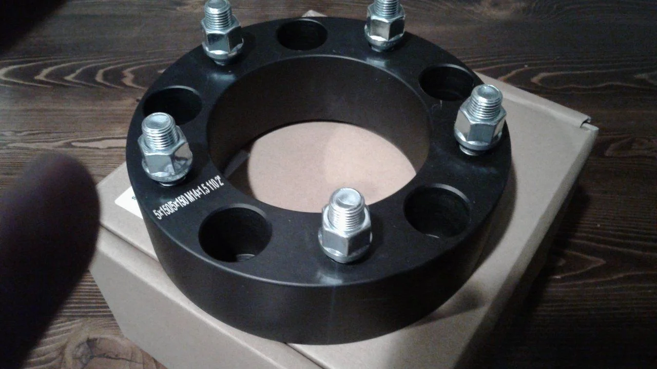

If any one is interested, I have a hub centric land cruiser set. They are 2" . I was ordering a 1.25" set, but these came.
Those spacers are lug centric, not hub centric.
A true hub centric spacer would have a raised hub on the outside for the wheel as well.
Hopfully who ever sold them to you did not advertise them as hub centric.

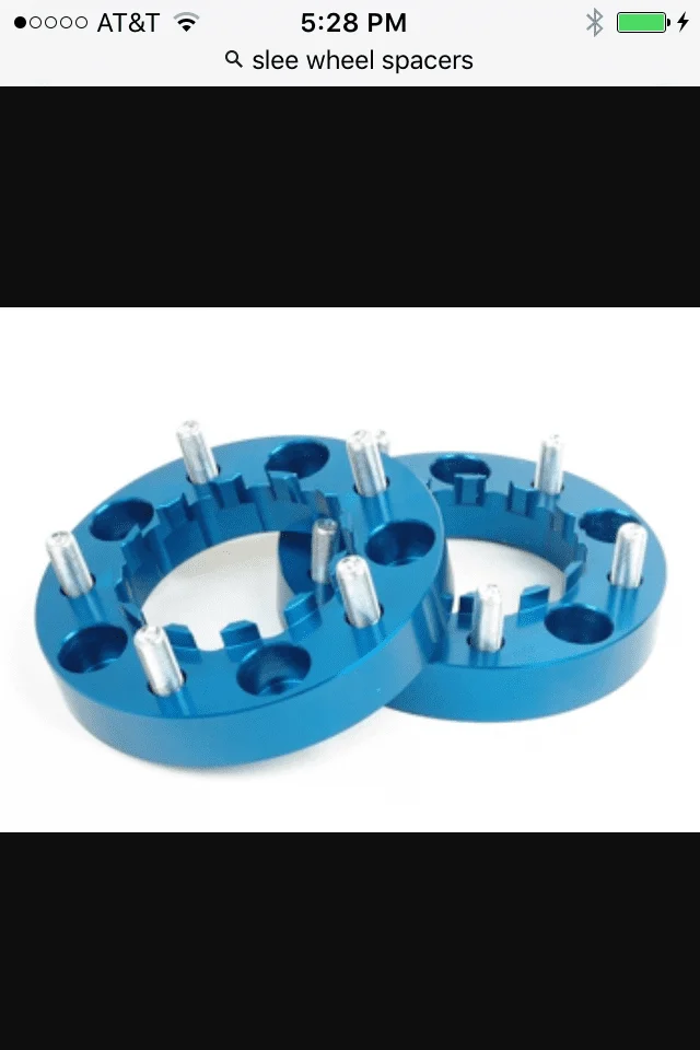

Slee's + spidertrax 1.25 are the t!ts ;) no problems after lots of wheeling. just use threadlock and torque them
When you say slee + spidertrax, do you mean they are both quality products, or you run them both?
This may be a beginner question, but what is the difference?
