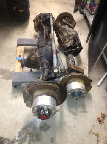

After a long drawn out process and a lot of help from our Louisiana friends+ 1200 miles and 16 hours I picked up some axles. I do believe I am going to go back to SUA. With a 4" hell creek lift.
Going to cut off the trusses and rebuild these with new seals.
Specs
4:88
Aussie locker front and rear
Aisin hubs with long field chromo gears
ARP studs
60 series knuckles
Long fields
High steer
Disc breaks all around.
3 " spacers( a little to big to use but maybe Lenny will trade for some 1.5:)
Might have a cut&turn SOA set up with disc brakes x4 and anti warp bar + high steer for sale soon.
