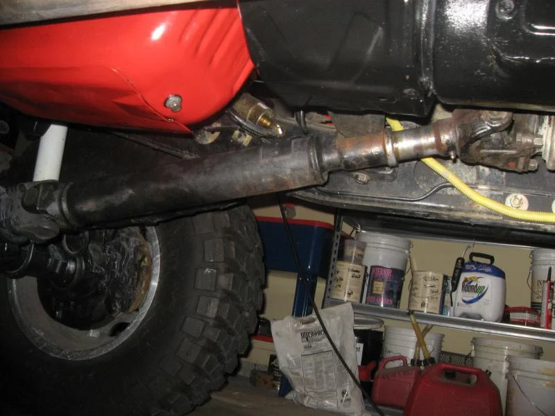

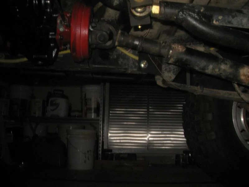

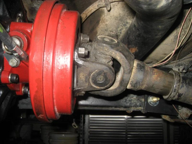

Drive line question? Need some input on my drive shaft angles, does it look like I need a CV joint? Or will It be alright the way it is.

Hard to tell, but looks like front may need a CV, especially since the pinion is pointed at the transfer case output. Or, I believe that the single u-joint ends on certain mini-truck drive-shafts have more angularity. I think it's the slip-side found on front IFS shafts from 89+ truck / 90+ 4Runner. I'll try to double check that. Do mini-truck shafts have the same bolt pattern, or is Cruiser stuff a larger bolt pattern?
Sorry to answer a question with more questions... :o
You really need to lift the truck by the frame untill both wheels arre off the groung and support it with jackstands. Then, with the transmission/t-case in neutral, rotate the shaft and look/feel for binding.
As Jordan said, if your third is pointed to your t-case output you will probably benefit from a cv on the t-case end of the shaft.
Jordan I have no idea about the drive shaft bolt pattern. I will try bossman's test tomorrow and will post results. If I should need driveshafts who do y'all recommend.
carolina driveshaft. half the price of others..
