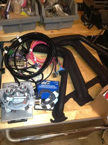

Got the AFI kit today. Going to take the distributor to performance in Memphis in the morning to get 7 pin done. Have to get gasket to mount to intake. Have to source a four barrel air cleaner. That's the short list. Also putting a header on, so the exhaust is going to need some attention.
Started with taking manifold off to address exhaust leak and to put header on. Distributor out. Wiring ran through fire wall. It's going to take a little while because garage time will be limited for the next couple of weeks. I am sure I will be axin some questions along the way so Gurus stand by:)
