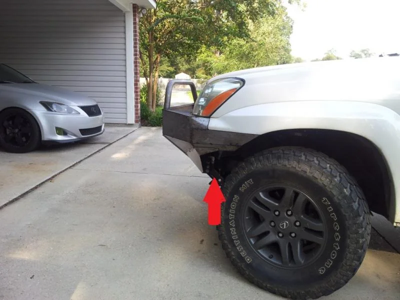

Finished up designing the lower support brackets. I'm pleased with the design, but they still need final welding. It makes installation a breeze and will make that section of the frame solid, especially so for winching. I used 1/4" plate and 3/16" support and turned it into an angled u-beam. It provides support on the actual bumper itself by those three bolts and also on the back of the 1/8" plate that has the stock frame bolts through it.
Dont mind those rusted out bolts, it was the only thing I could find in my bolt/nut bin. All hardware will be grade 8.

got the "splash" guards designed and bolted up
Forgot to show you guys the changes I made for flex clearance. It just flexes right past the oem fender now, but still looks like it matches up nicely.
ALMOST DONE!!! All I need to do now is design a box for the washer bin, then its off to be finished out! My wife will be SOOO happy to get her truck back.

well, I brought it close to the existing structure there to keep it out of the way of the tire track. Are you suggesting that I include a bottom plate there as part of the splash guard? to cover the bracket area from the side view?
I'm picking up some more sheet metal today. I think I'll give it one more go.
I would think you'd want that for tire clearance when you compress the front suspension.
I get what he's saying about a pie shape, but I don't think it's too bad and once it's painted (assuming its black) it will likely blend right in. If you were going to "extend" that section, maybe it should be removable for larger tires?

I dont see your possible fix in yellow, Bonner
