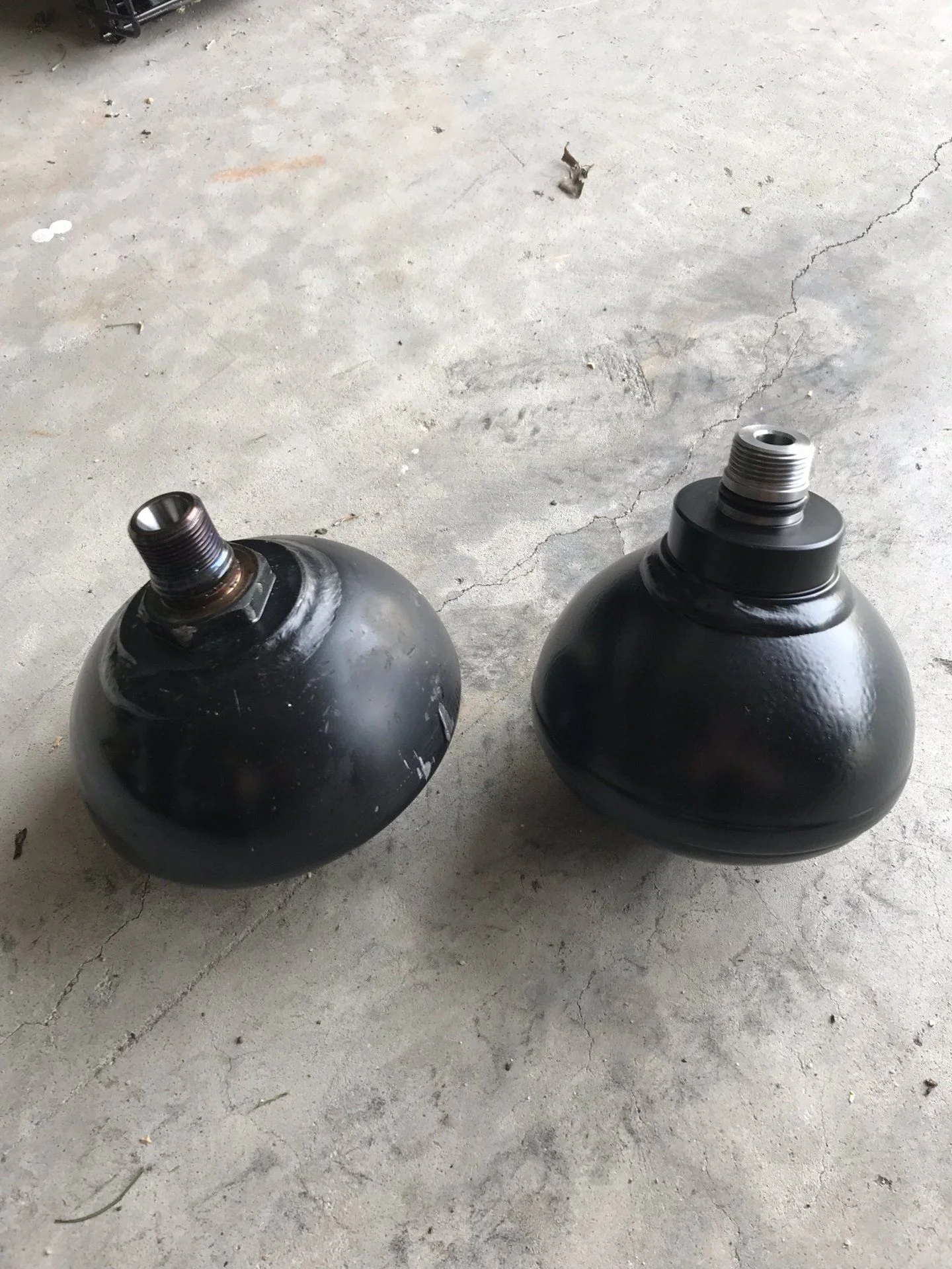

I'm not sure but it seems to me that the diameter of the Pleiades spheres looks a little smaller then the OEM Sphere
Do the Pleiades and the OEM have the same diameter on the widest point ?

Here’s a comparison between my OEM and Pleiades. I think these were rear spheres
Pleiades suspension spheres

The Pleiades are smaller, at 385cc, than both the front and rear OEM globes, at 400cc and 500cc respectively. The lower gas volume paired with a higher nitrogen charge makes for an increase in spring rate over factory.
So they are smaller and with a higher charge they make up to balance out the spring rate in difference to OEM and even better. :hmm:
