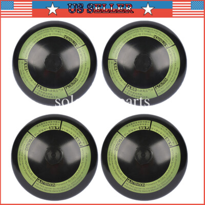

"241" sold. Surely somebody here must've tried these
Any idea if they're at all serviceable?
They're for 200 series. They may or may not work.....

Well I may have just committed one of the most blasphemous acts known to planet Mud. But because I am doing this for ALL mudders' benefit, so you don't have to, hopefully it is not worthy of a Mud Excommunication. 😂🙏🏼😎
The sin---- > I now have four Amazonian Chinese made globes in my '01 LX. ($379)
And as of today, with very aggressive big lug Prinx mudders, the ride is absolutely mint...mint I tell you. I mean perfect. Can't imagine it could be better even with stock Michelins.
Because of this sacrificial mudder research project, I will let you know when any or all globes fail.
Mud update, as promised.....it appears the front DS Amazonian globe is not retaining pressure as it should. I can tell the NW corner of LX is lacking a bit in suspension damping. I will continue on until.....
