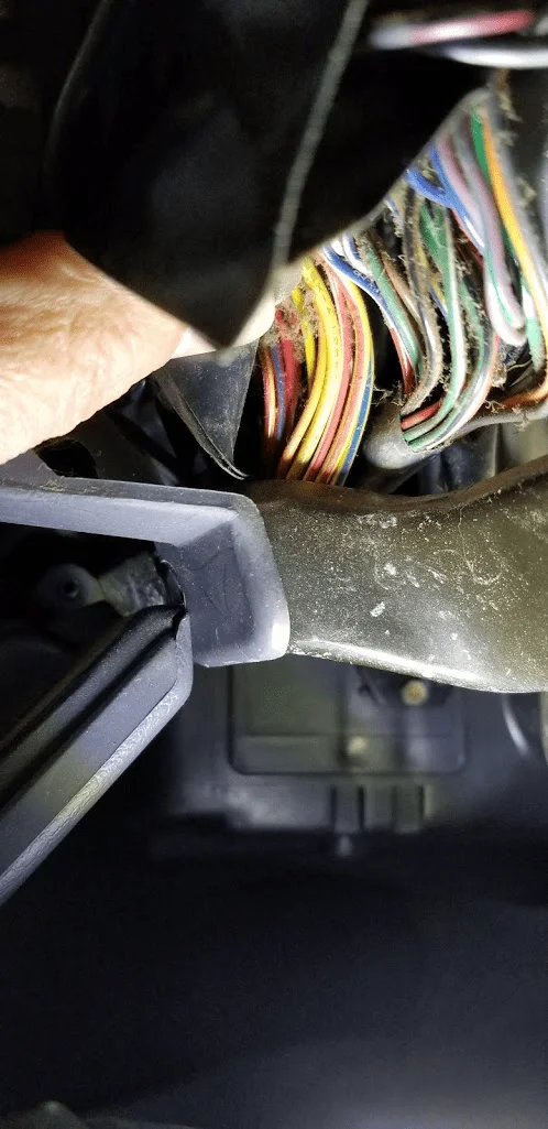

You’ll receive several good suggestions. A quick one to check is the wiring harness that exits the ecu and then rubs against the metal support near the bottom of glovebox opening, eventually wearing through the insulation.

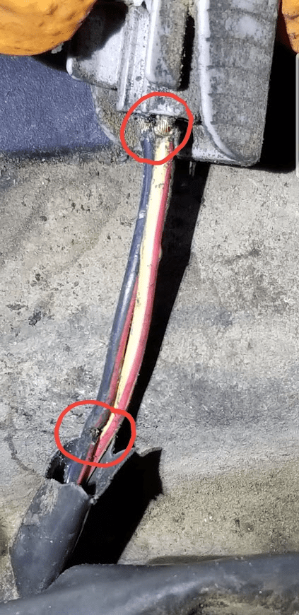

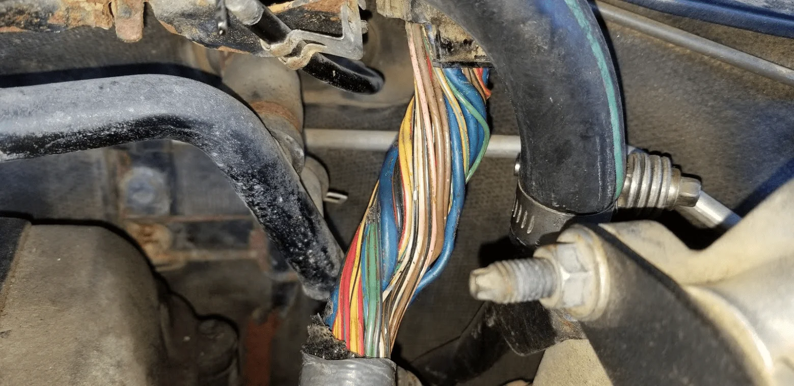

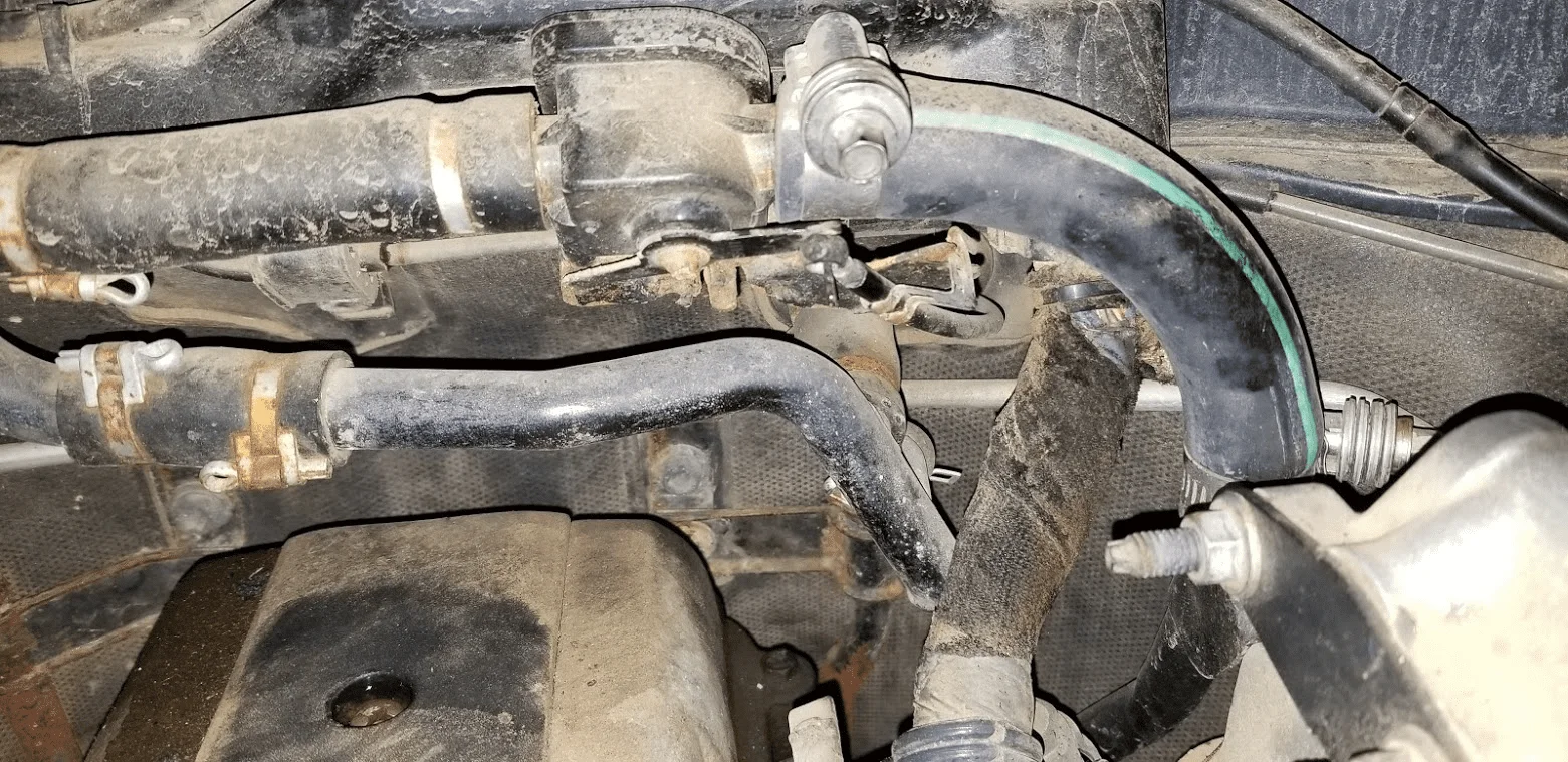

I'm all about pictures. The thick covering over the wires was still intact. Underneath I had to push the same black covering out of the way to view the wires.
1933664
1933665
With no EGR pipe, I have lots of room around the engine harness.
1933666
The tear in the wrap around the harness was done by me earlier. The wrap was intact but I pulled on it just to examine the wires. The wrap is very fragile and tore easily.

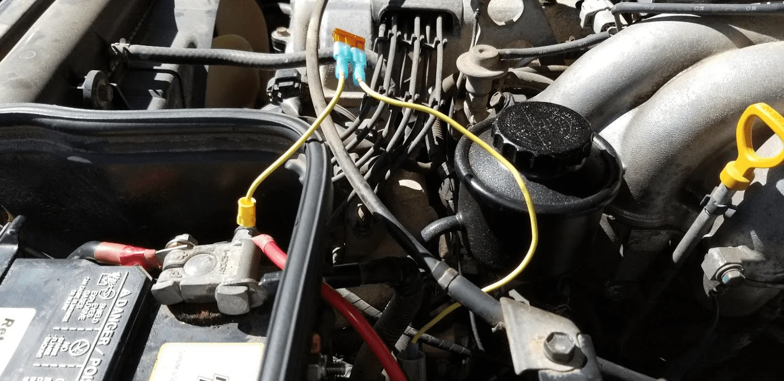

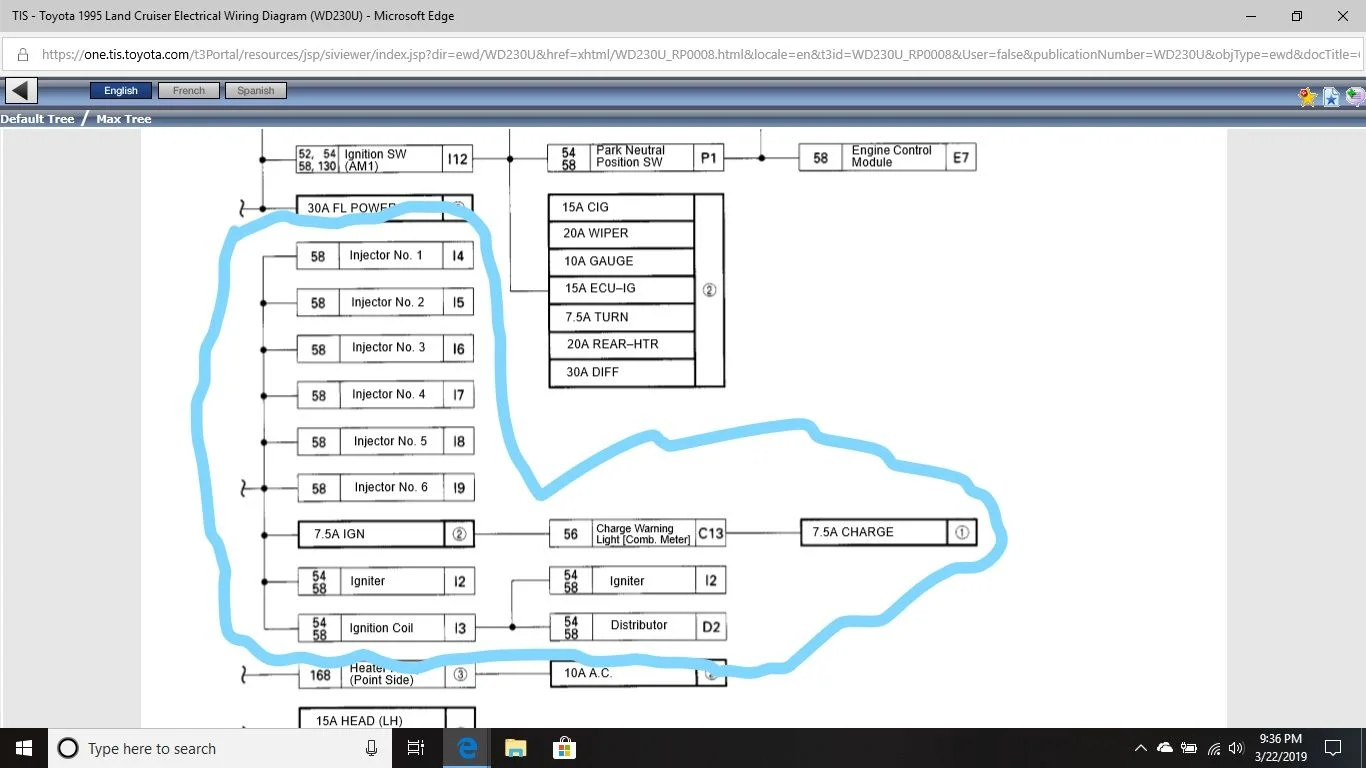

I made a jumper wire with spade connectors and a 15A fuse attached to AM2 connector. With the key in, ACC is fine but turn once more to On and my fuse pops. I will check the EWD to see what gets energized with key at On.
I'm closing in on the issue. Blade fuses are cheap so I built this little guy.

I removed the harness tape and setup my jumper. With the key in the ignition, the wife turned it to the ON position. My blade fuse didn't pop. Success. When I grabbed the harness and moved it, the blade fuse popped indicating the short is in the wire bundle.
The black residue on the wires is the tape. I need a solvent to clean the wires but not melt the jackets. Any ideas?
1934644
Well, things have not progressed well. I did not find the short and and now cannot recreate the issue with my jumper and fuse. I've tried shaking the harness and pushing the wire bundle around. Nothing seems to work. While this might seen good news, it also means the Cruiser will run but could short the fusible link and die at any second.
