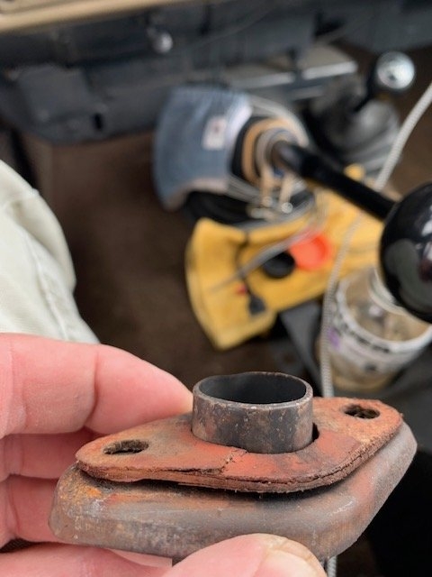

My journey was supposed to start today, but it starts tomorrow. Casey and Patrick/Bowfin know i’ve been struggling up here in Northern MI w/ a radiator and a head gasket. We finally got a radiator in yesterday from SOR, ran to dealership and grabbed some Toyota Red, did the install and fired her up. We had a weird oscillating noise when the gas pedal got past about 25%. Silent at idle. My buddy Mark looked at me and said, “I think you’re fine”...... I was having second thoughts yesterday and called Casey to give him the potential bad news re: my 60. I didn’t know what the noise was but had visions of a breakdown somewhere in Nebraska. I was bummed. Not as bummed as a vulture coming through my windshield 30 minutes into the trip, but bummed.
So this am, we tackled it again. I wasn’t optimistic.
But, we had Mark’s pet pig “Kevin” helping, which I think eventually tipped the karma scales in my favor.
I’m serious. ...... he has a pet pig. Named Kevin. But that’s Northern MI. So Mark pulls the valve cover. Lifters.... Valves... Nothing. Casey even suggested looking down the side cover since we had the head off in case some trash fell down there. Nothing..... Mark finally crawls under with the stethoscope and hears the slightest noise near that pipe that come off the exhaust manifold that you cut and pinch weld during a de-smog. Which Mark did about 60 days ago. He pulls it and this is what we see.
Fire up the welder. Seal it up. Fire up the 60. Jump on the gas in gear and sweet silence. No noise. I’ve been packing ever since including something for the auction. I figured everyone likes broubon, so:
