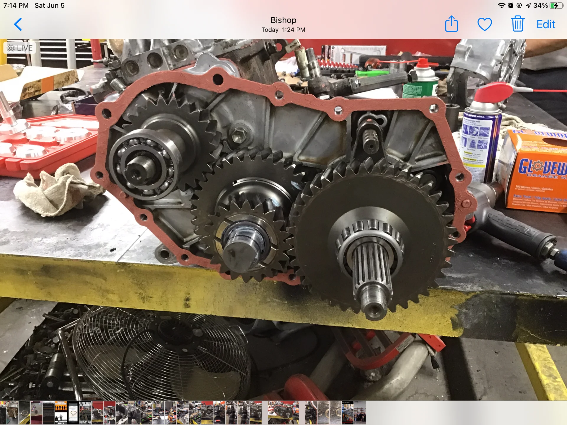

Slight delay with the T-Case rebuild. Buttoned up & ready to stab in when we took one more measurement.

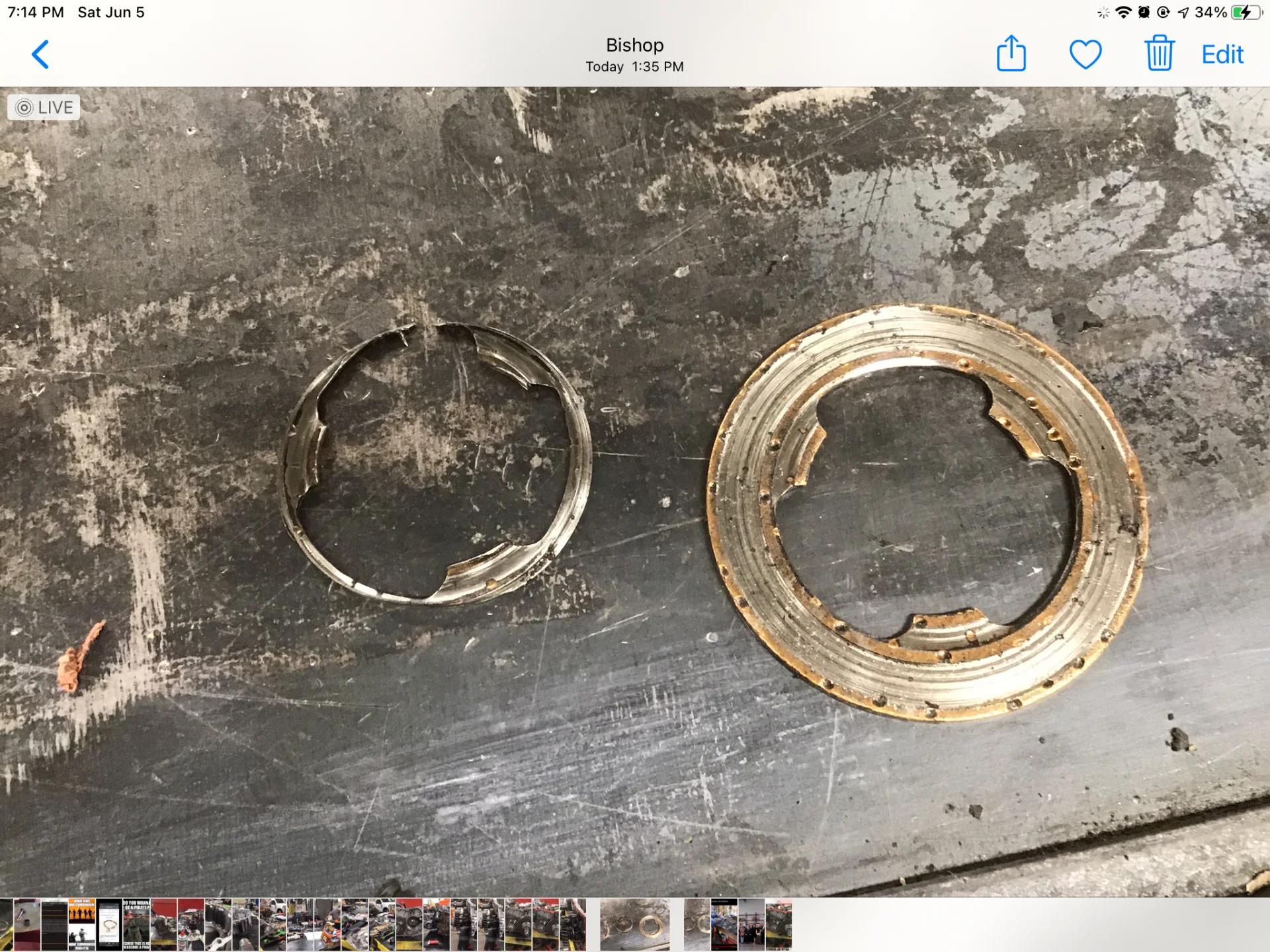

One of the Thrust Washers on the idler shaft was extremely worn and caused excessive wear on the case itself. And even with a brand new Thrust Washer, the tolerance is way out of spec.
Will call around Monday to see if this is something to worry about or maybe a workaround…maybe a thicker Thrust Washer…don’t know.
These aren’t the ones in question but take a look at these 2 worn out ones.
SUNDAY UPDATE: Georg is the man…no surprise. He left a text yesterday and said I could give him a call on Sunday for some tech help if needed.👍
Georg says to slap it together & stab it back in. Said this was not a uncommon issue and he has searched hi/lo for thicker Thrust Washers etc. None available so dance with who ya brung.
