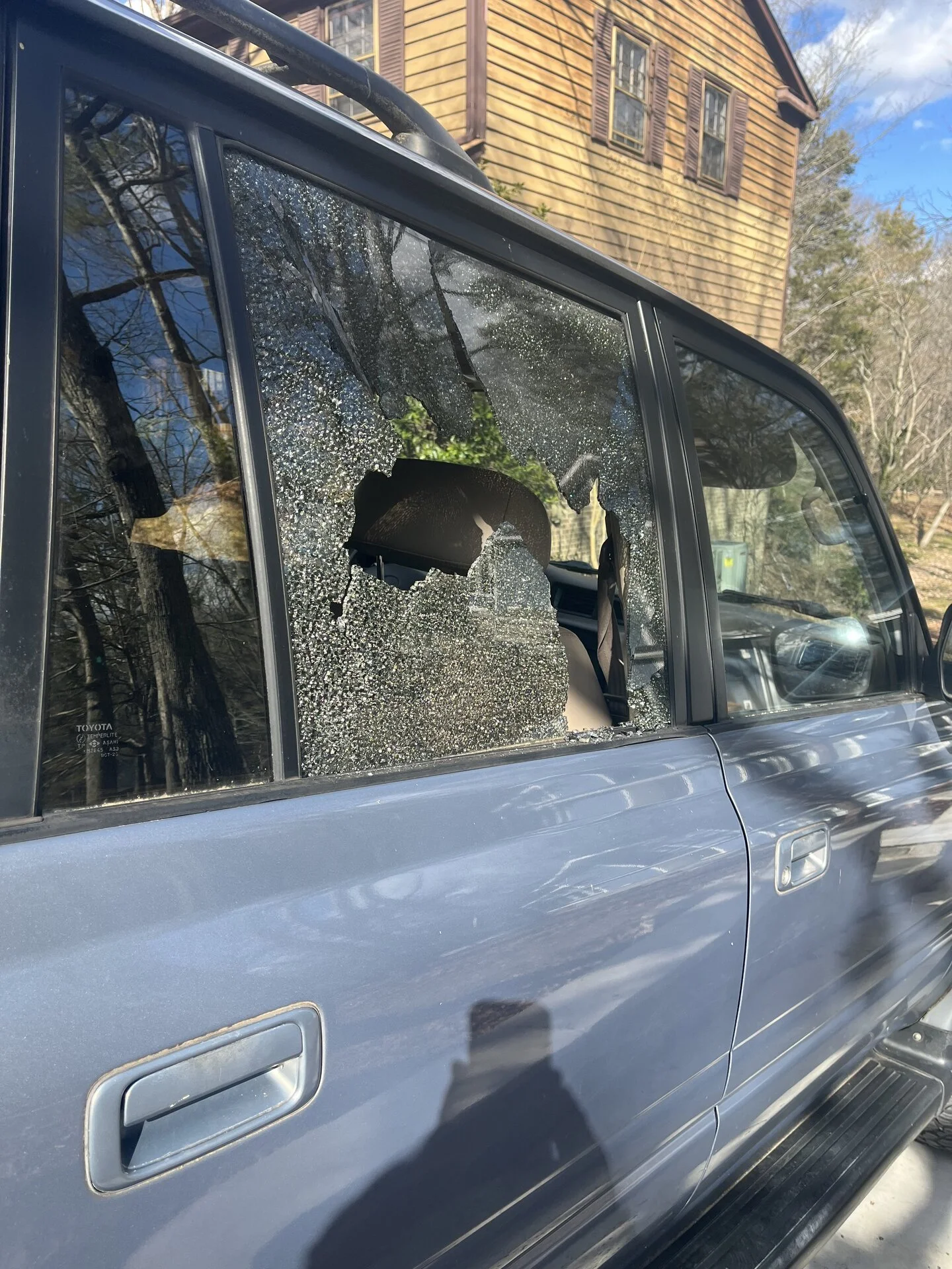

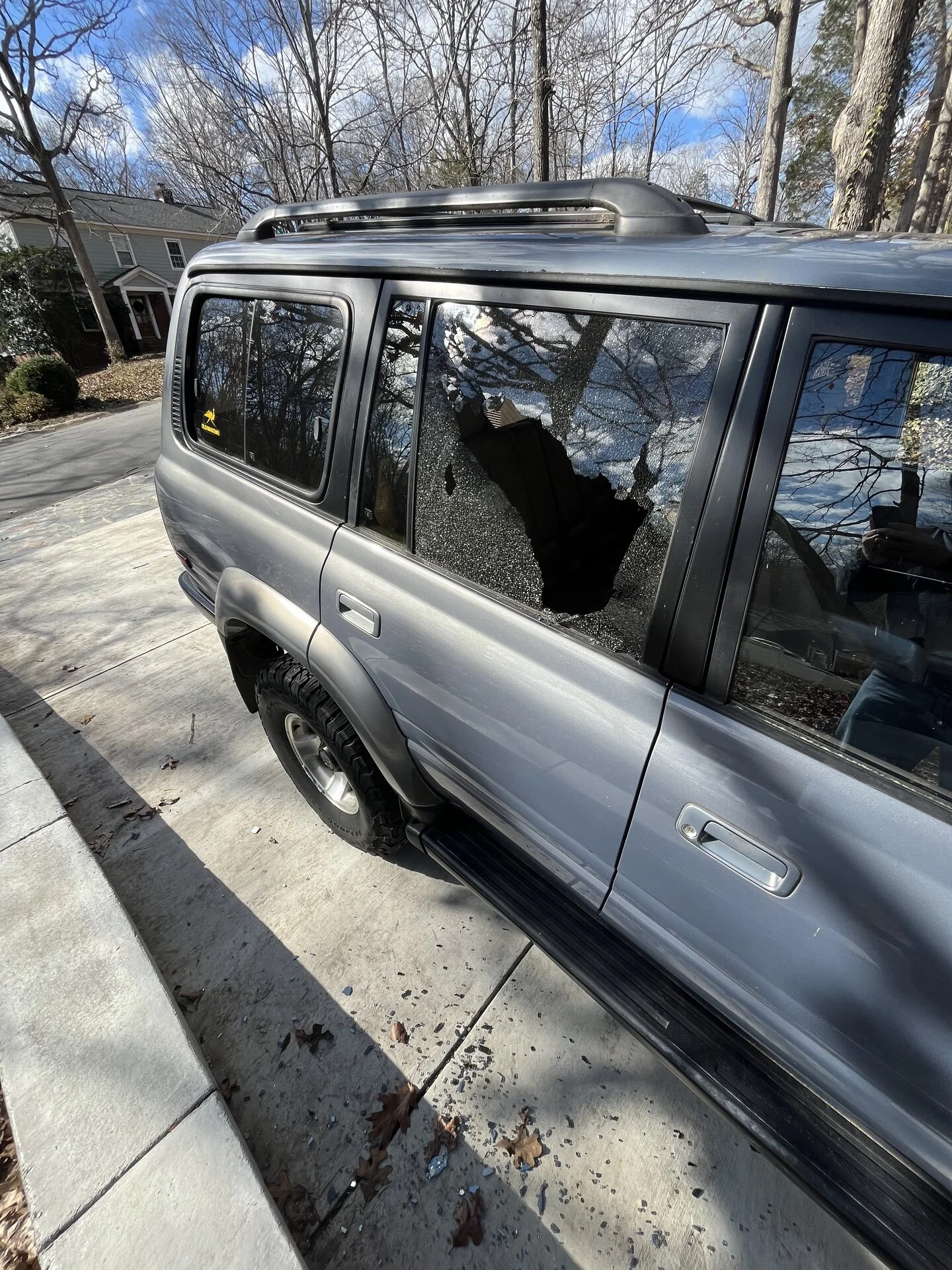

My right rear passenger glass is broken. The wrecking yard is asking if it is solar or not. It appears to be factory tinted and darker than the fronts, but I don't know how to tell if it is 'solar'. Generic search says the solar ones have a purplish tint. Any suggestions how I can tell definitively? Thanks for the help, Craig

AFAIK the majority of 80 series that came into the US had a factory tint on the rear door window glass, so if the wreck in a US salvage yard is a US spec FZJ80 the rear door glass will likely match what you had in there before (unless you or the PO put something over the original glass).

You usually have great input, but you’re way off base here.
OP, buy a piece of glass from a 93-97 year 80 from someone parting a truck in the classifieds and you’ll be fine. I’m sure what this place your’re dealing with is referring to “factory tint” as “solar”. You have factory tint… A chemically applied substance, not a film. There’s no “tinting to match”

The rear windows are factory tinted light brown like jatree said. You can see it in your last photo. The front windows and windshield are clear.

Appreciate it. I just didn’t know if factory tint and what they called solar were the same thing. I did end up finding the glass at a wrecker which was identical and what they called solar.

Yes, it turns out that their factory tint is also called solar. When I started this post I wasn’t sure they were the same thing.

I did just that, and it matched perfectly, thanks.
