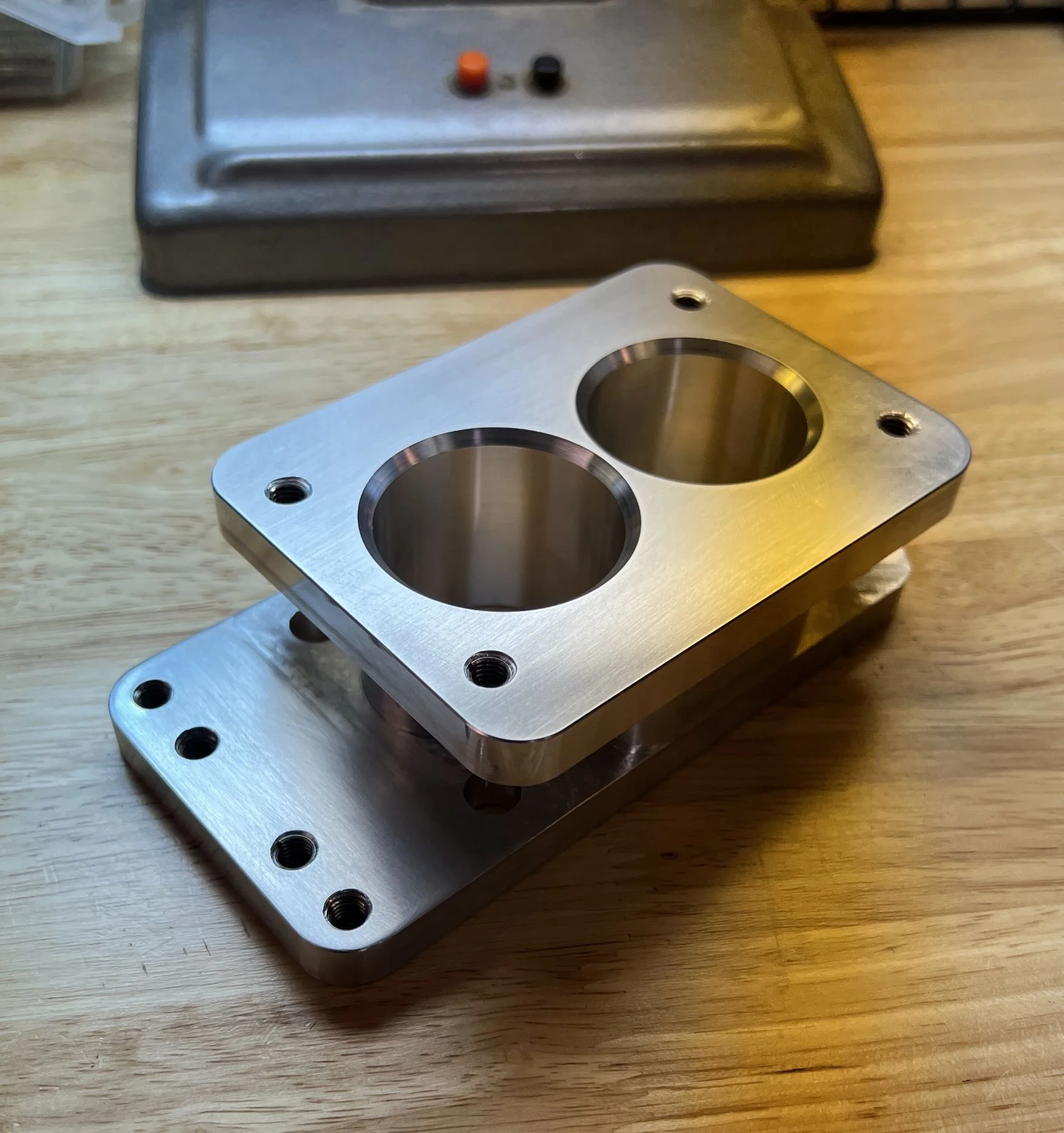

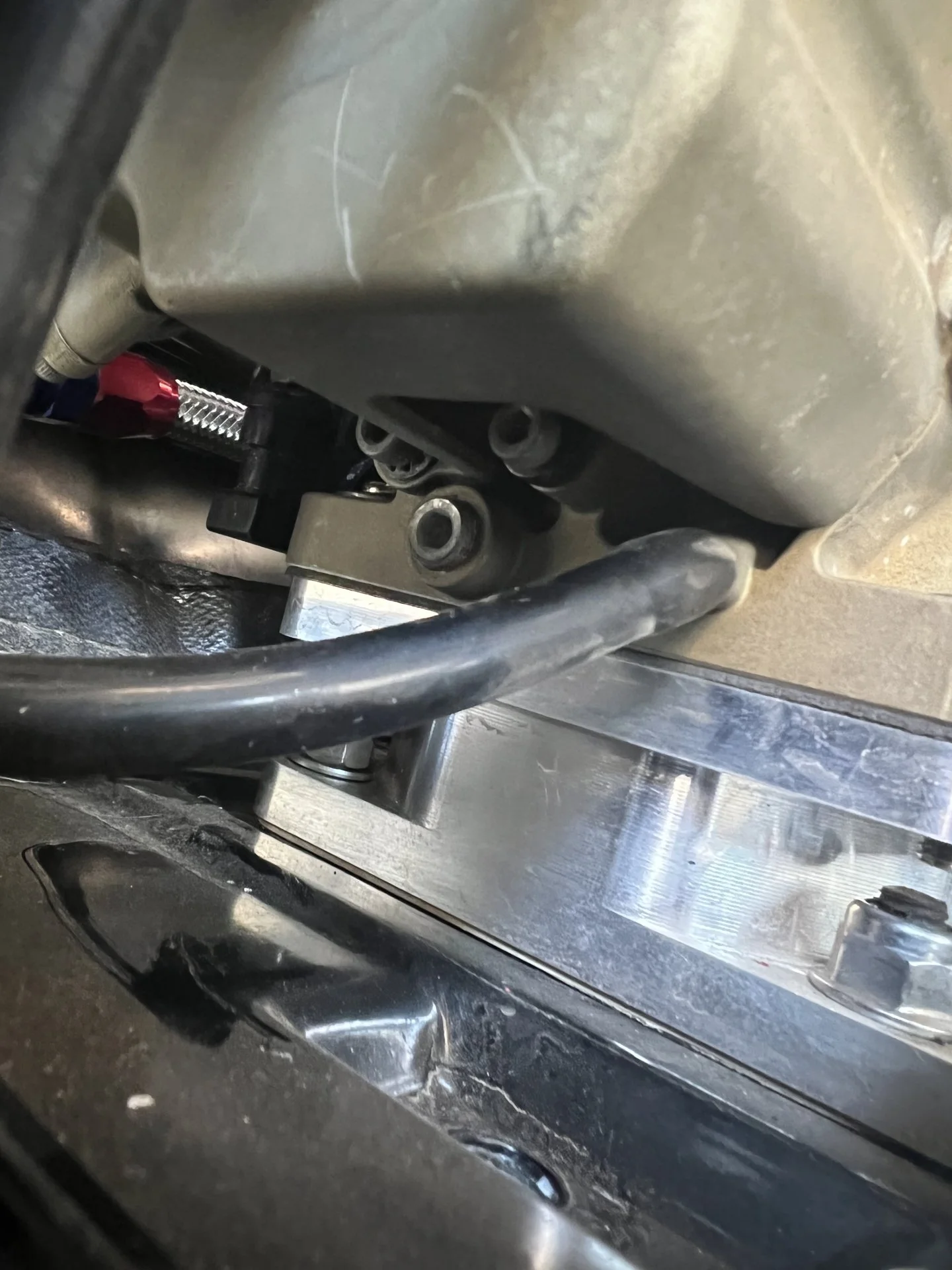

Lots of Sniper builds, but haven't seen many 2GC large bore snipers so here is what I did. Advantage of the 2GC is it looks better than the 2300 in this situation and it fits directly to the stock air cleaner assembly. I designed and machined an adapter between the manifold and 2GC. I still used the carb insulator to try to keep the heat down. Used a RobbMc performance powersurge pump being fed by stock pump. Stock air cleaner assembly. AN braided lines. Stock distributor, but basic recurve springs installed.

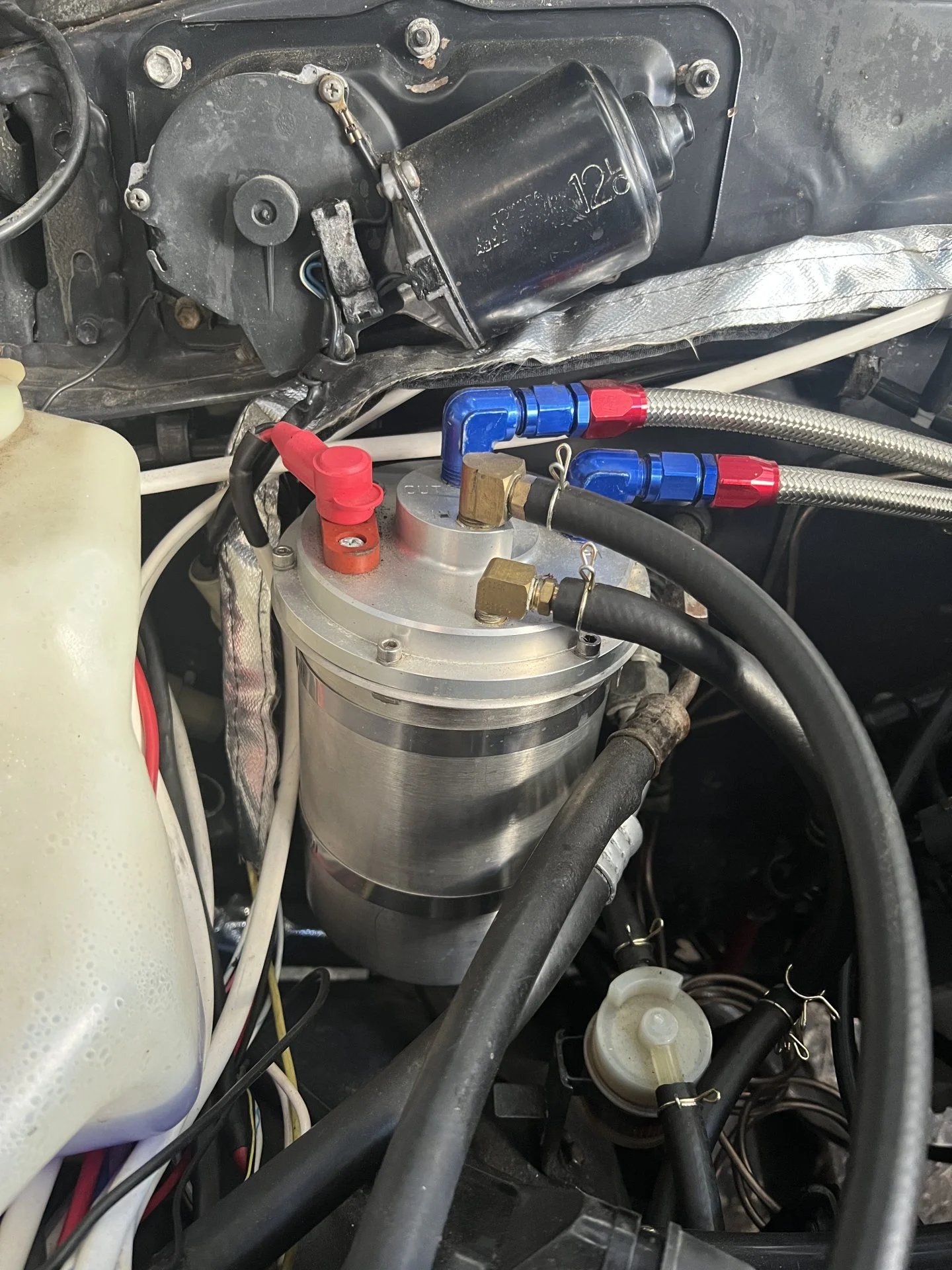

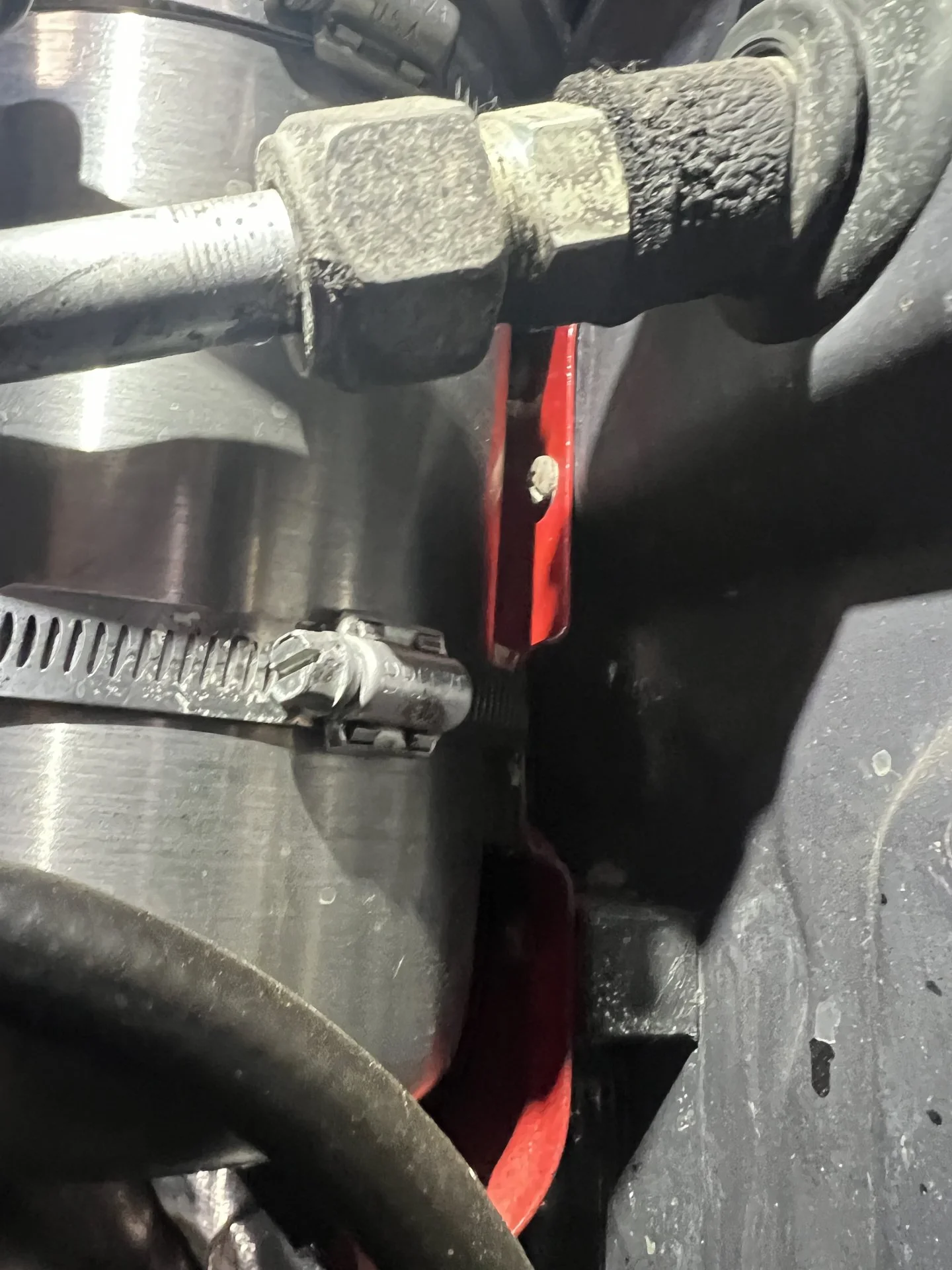

Looks great. How did you mount the surge tank?
thanks! I mounted it to the firewall kinda nestled under the wiper motor and between the AC lines/washer fluid tank. its pretty close, but worked out fine. I put a small block under the lower screws because the firewall isnt flat there, top screw was on a protrusion.
Do you have a cap on the 3/8” bung in the center front of the 2GC?

I have a cap on the vac nipple on the side nearest the firewall, and am using the vac nipple on the radiator side for the distributor advance. Not sure if these are the ones you mean, I don't see any others. I agree it is acting like a vacuum leak, I can't find one though. Yeah I did the IAC initial setup in the manual. Your setups look gorgeous!

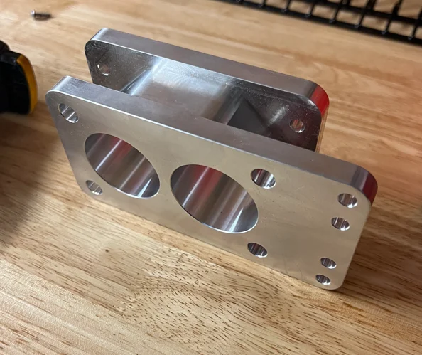

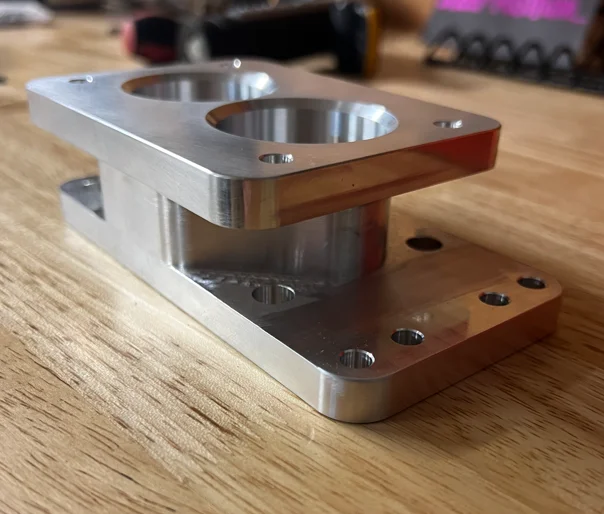

The 2GC Large Bore fits to the stock air cleaner directly up at the right height, just takes changing the center screw thread to be the M6 of the wingnut. All the tapped holes I did with helicoils to be more durable than just aluminum threads as the wear surface of screws being installed/removed over the years.
I had 8 of these 2GC Large Bore adapters made because I didn't see anything I could buy except the 2300 adapters and didn't like that look or design to the air cleaner. I am using one so have 7 left. There was someone else on mud working on a 3d printed version, and I 3d printed my own with high temp filament / CF filament / oven bake filament / all different fill % and they all failed on the engine. they softened and relaxed under the bolt wide washers but they all started leaking air. not worth your time. Maybe a resin type might work, but in my opinion it isn't worth the effort, aluminum works great, its just tough doing the overhang of the machining.
If anyone wants one of these adapters, let me know, I'm thinking $300 $150 since I did all the work and its a single piece with overhang and helicoils. Redline is selling theirs for $305 now FYI.
