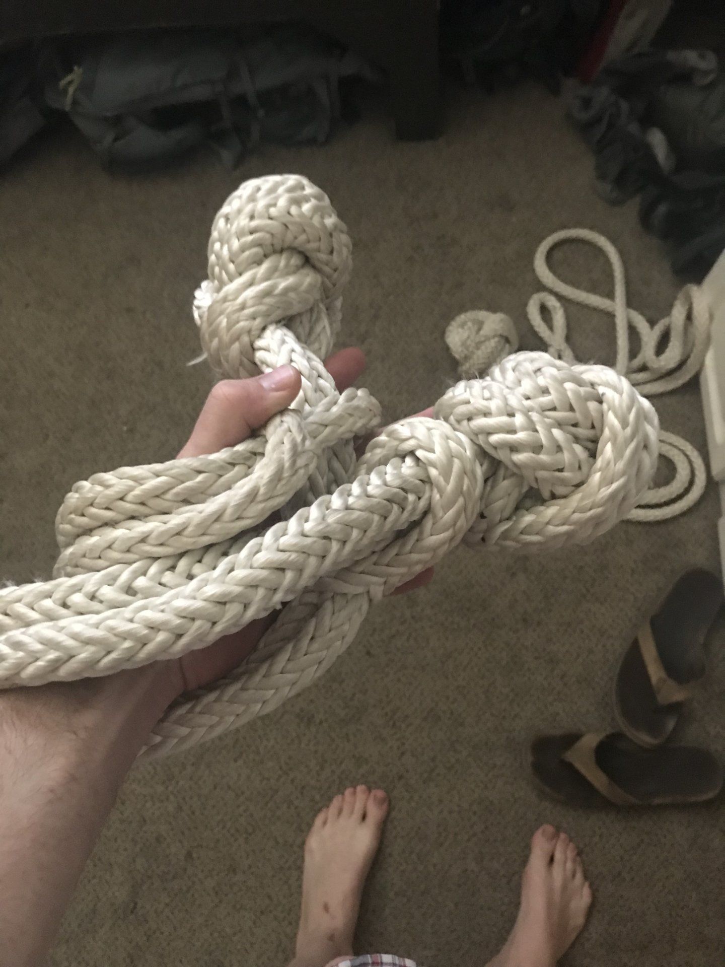

I dabble in splicing. Made some soft shackles as well.

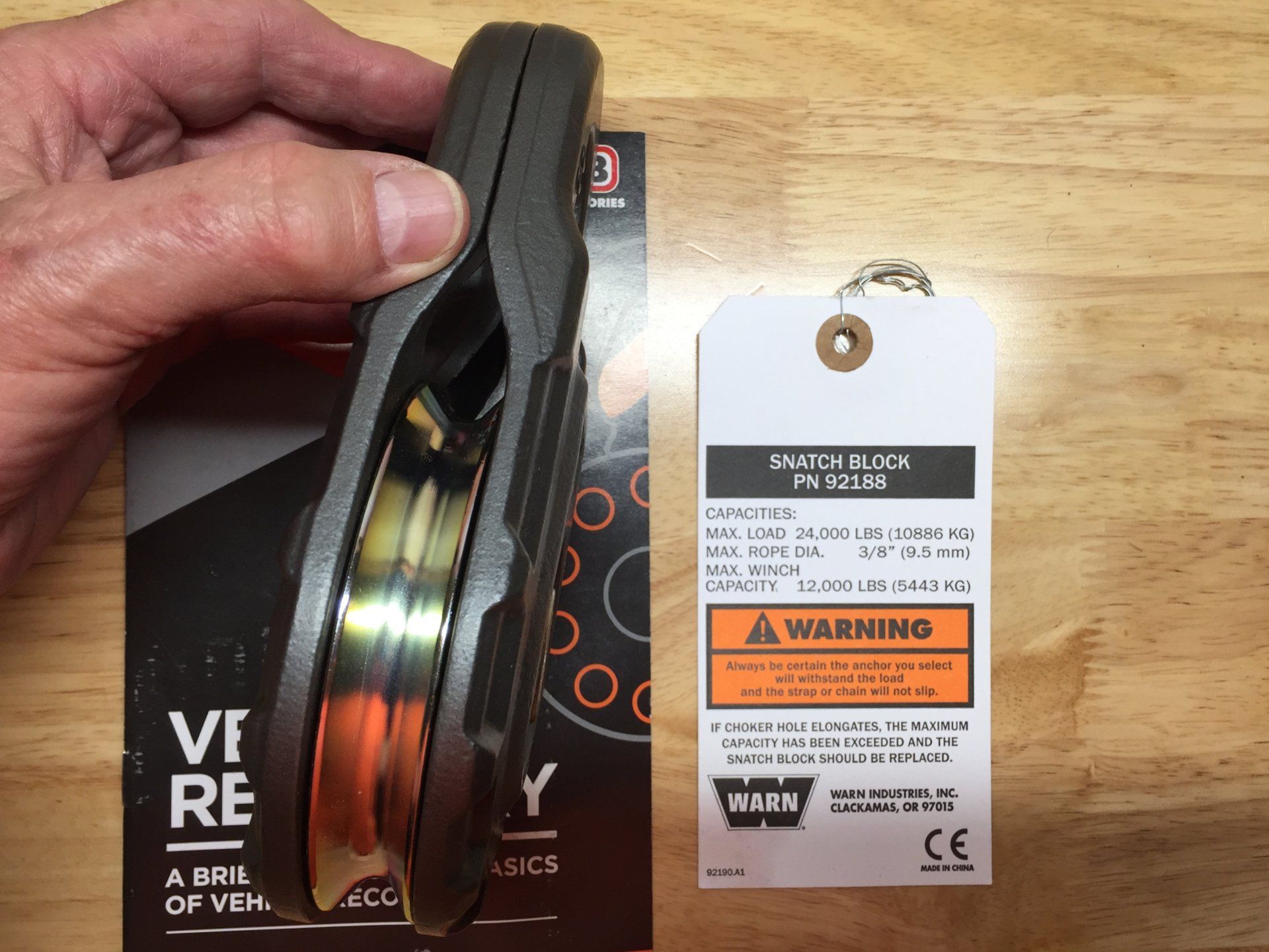

I have the epic 12K Warn snatch block, its 24K rated...used it as a redirect for skidding some oak logs..worked great and well made.....
Thanks for posting and also the pics! Didn't see a WLL stamped rating. Is there any other rating stamped on the other side of the snatch block that's not shown in your pics? Just curious because there's a interesting statement on the specs tag in the pics: "If choker hole elongates, the maximum capacity has been exceeded and the snatch block should be replaced." Funny they say should be replaced and not must be replaced. Also interesting is this link that discusses SWL, WLL & MRC.
