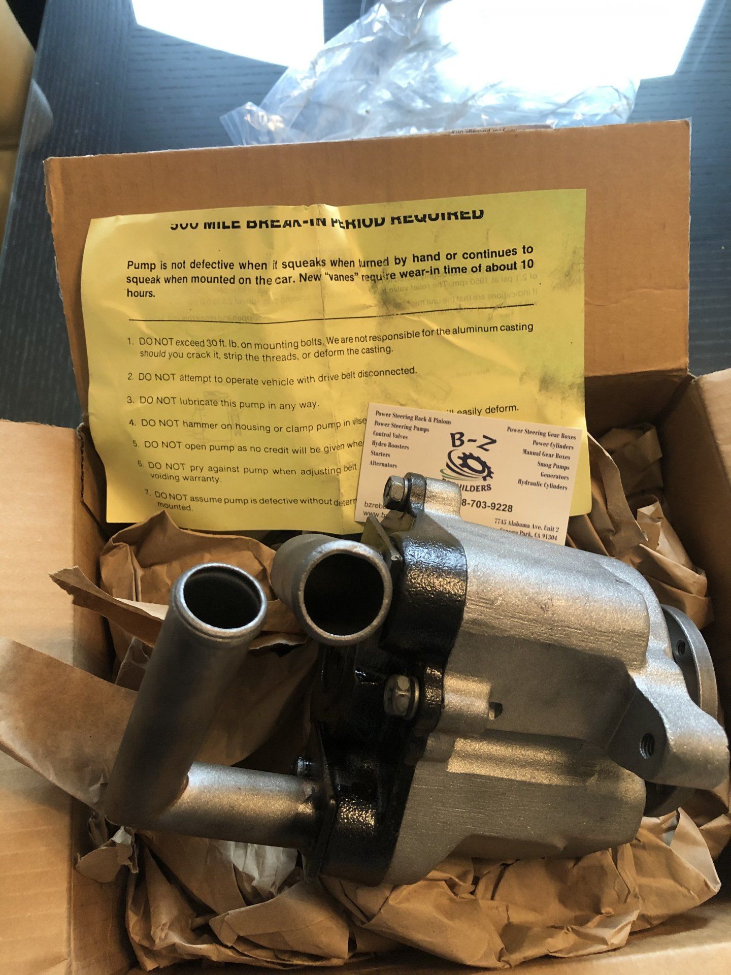

So my Smog Pump shot craps and locked up just recently. I purchased one from O'Reilly the Cardone Remanufactured #33-768 and the one I received looked nothing like my OEM one so I sent it back and sent my OEM to B-Z Rebuilders. These guys rock, turn around time was fast and the rebuild cost me $225. Will install it at some point when I have time, at the moment I'm running TLC pulley which by the way is a nice alternative! My truck has not been de-smogged so will re-install the smog pump soon but wanted to share my experience with B-Z Rebuilders thus far. Here is a pic of the remanufactured pump as well.
Is it possible you got the ford pump from O’Reilly? I think there’s a ford pump that fits but looks different. My memory is foggy on this one.
I suppose so, the take offs of the two pipes where shorter and at slightly different angles. It may have worked with some retro fitting but after reading a few positive things about B-Z Rebuilders and for less $$ than the one from O'Reilly I sent it back and shipped mine to B-Z.
