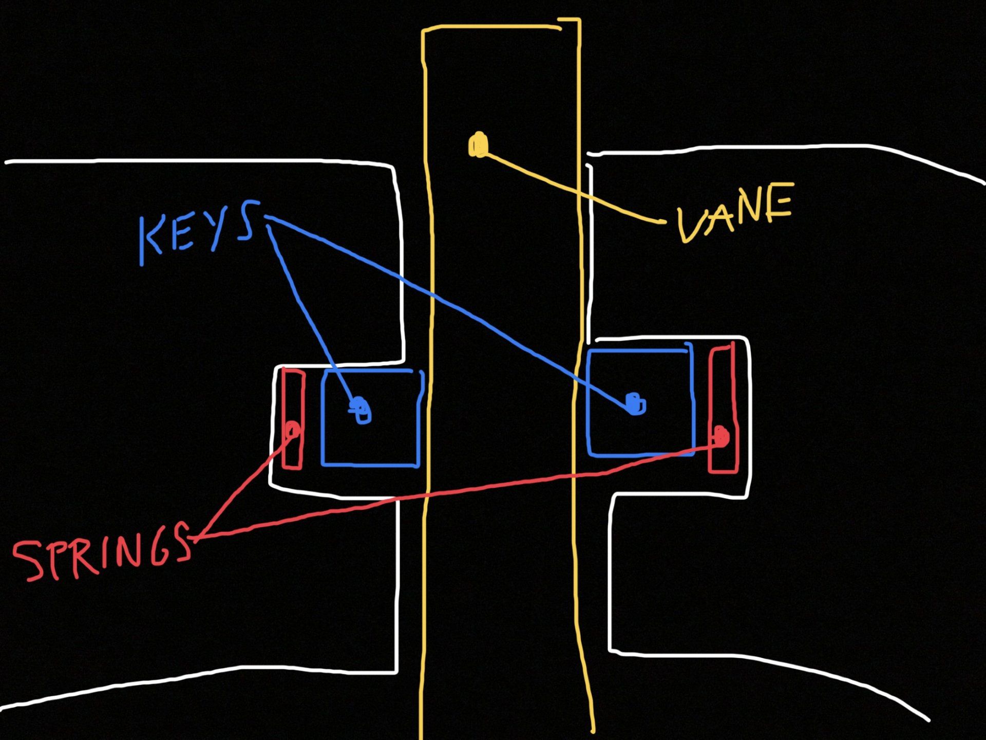

Thank you. So just to be totally clear, do the springs go in front of or behind the “keys”? Put another way, do the “keys” rest directly against the carbon vanes and the springs keep them tight against the vanes? Sorta like this?
in FJ60 they are like this only on one side, your looks like on both
