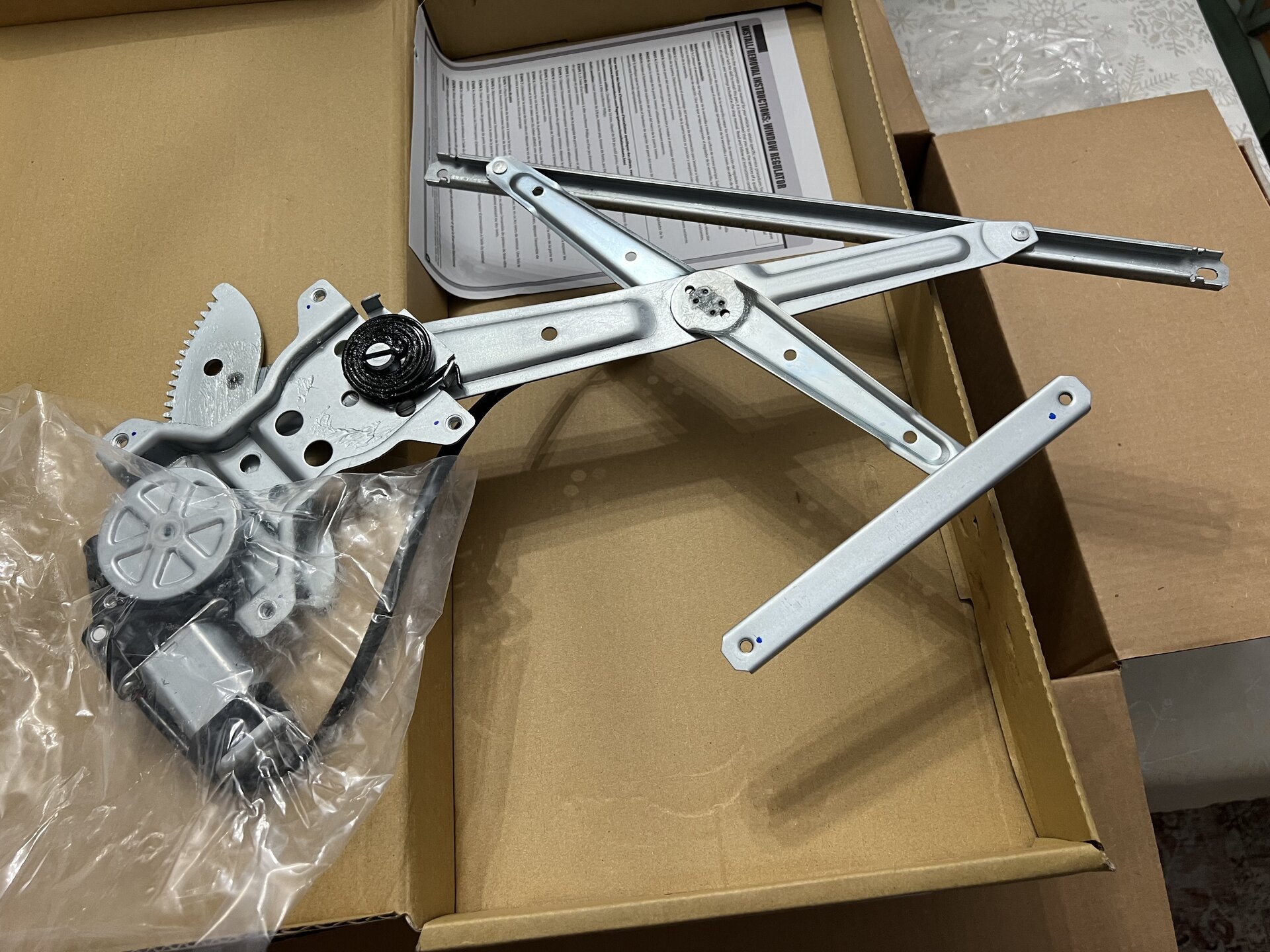

Got the rears in today, no springs.
I’ve had good luck with the Dormans but you can’t go wrong with OEM if you can afford the freight.
That said the best bet is to get DRY silicone spray. It doesn’t attract gunk and grit but let’s things slide EZ.
I read a few posts online saying the same thing about dry silicone, I'll definitely look it up

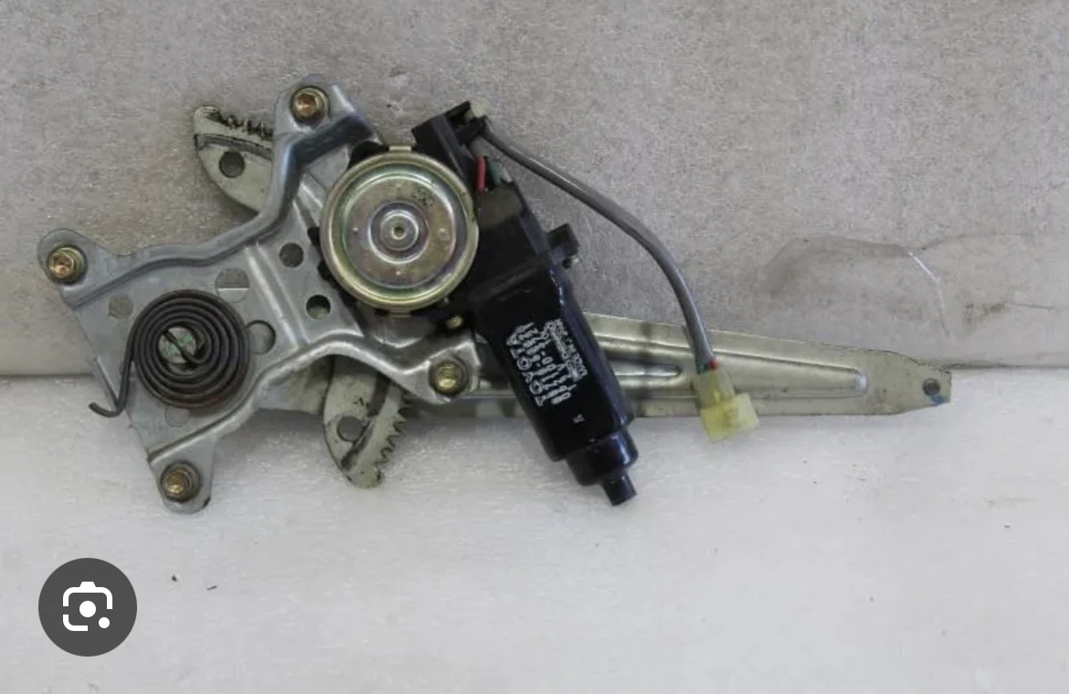

Does it look like you could retrofit the springs from the worn out regulator?
With a bit of work you might be able to fashion something up. From my googling, the OEM regulator has a channel in the rotating pin of the arm. See here
Here’s the Dorman. No spring, no channel. Though I bet you could tack something in if you really wanted.

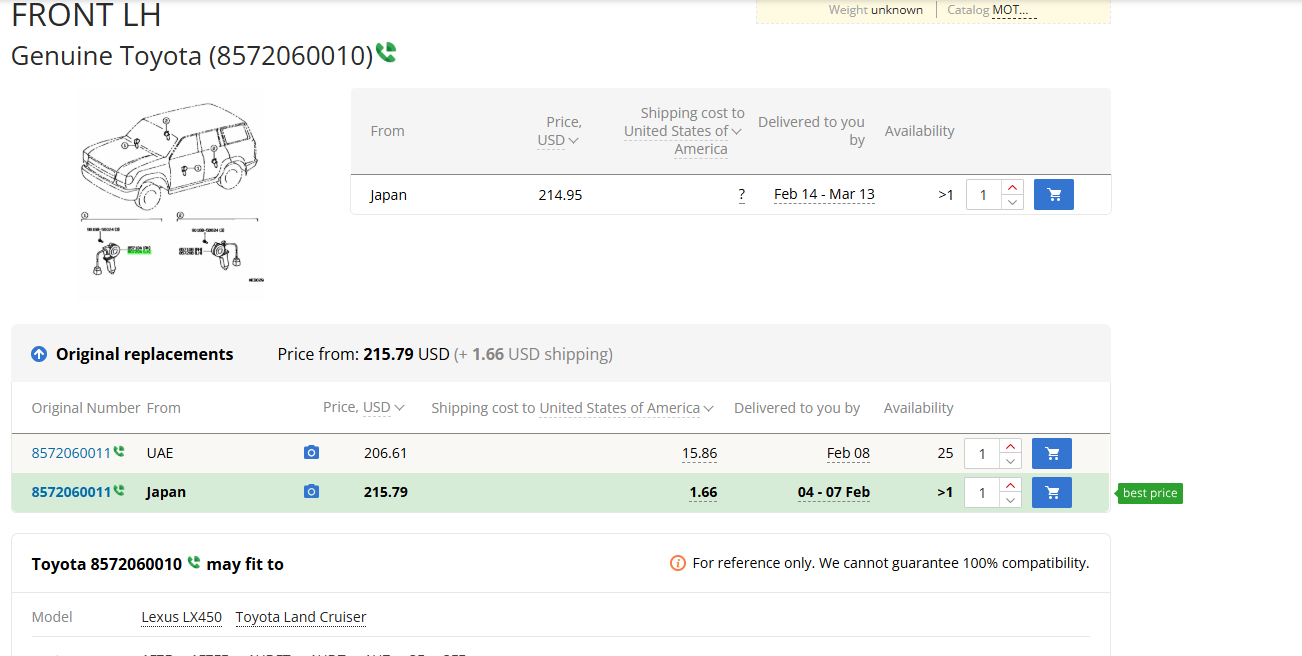

Impex or amayama have the OEM for the same price as the dorman on Amazon. No reason not to go OEM on this part.
Now I'm intrigued, let me price out one at Amayama.
edit: no, not even close to the same price anymore.
