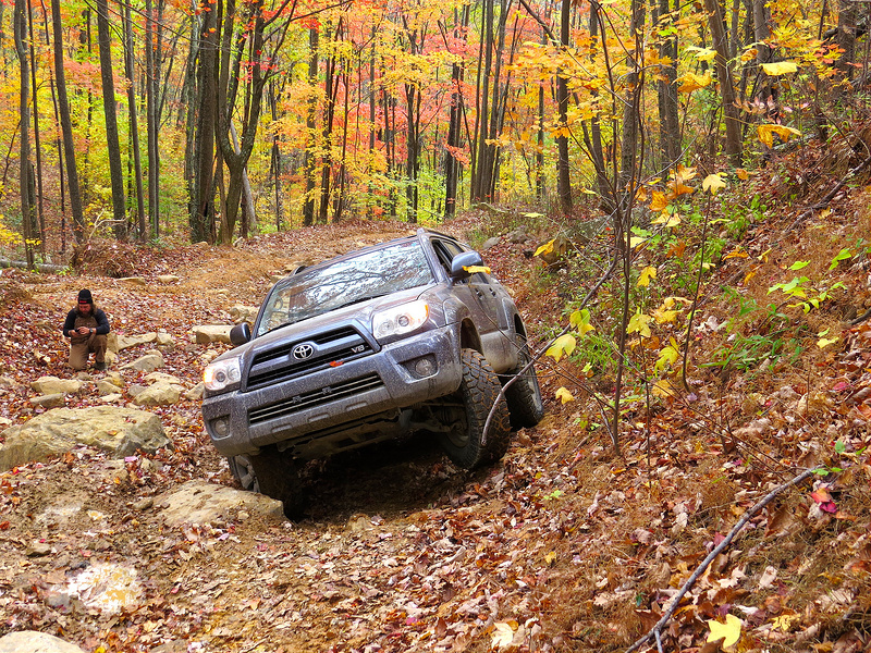

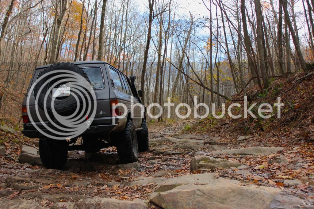

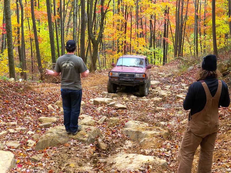

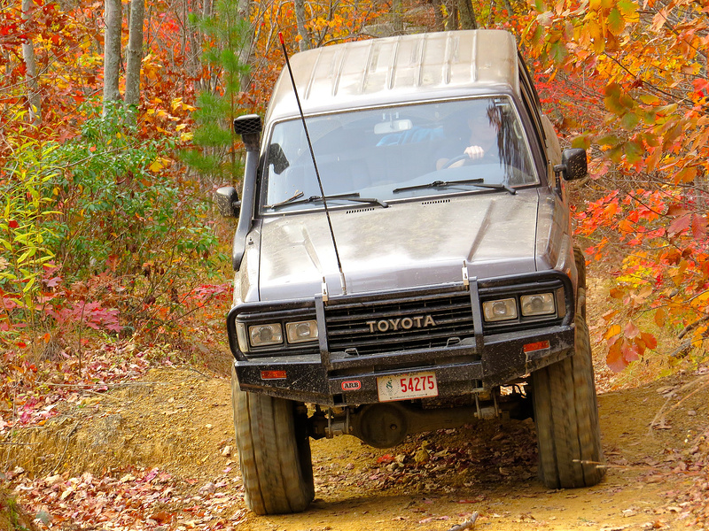

Cant remember this trail but it was pretty "fun" for some. Front and rear lockers and 37s make everything a walk in the park now now (gotta just go open/open or just rear from now on to make things more exciting).

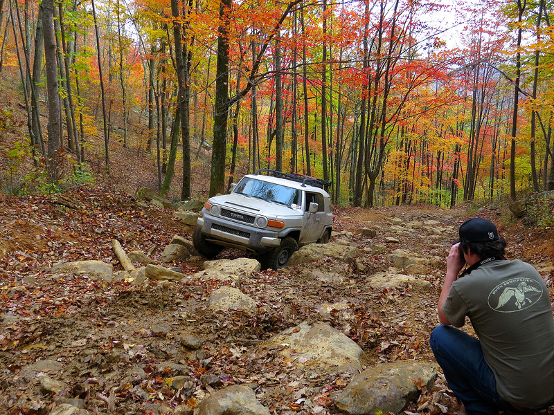

Will took the slippery, off camber left line
As did Sam
Aidan (pandathrust), my little brother, did really well too. He's been my passenger enough time to learn what he is and isn't supposed to do and i really didn't feel like i needed to worry about him destroying his truck too much lol.

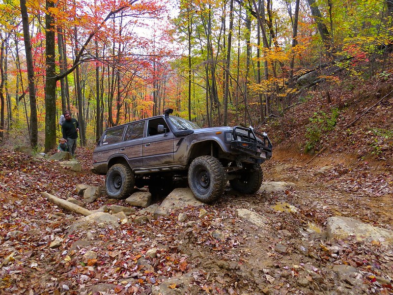

"Big Bitch" chugging on up

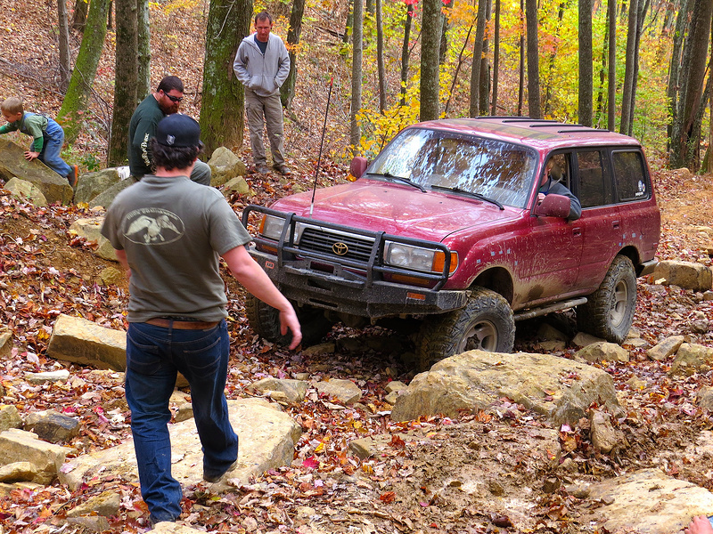

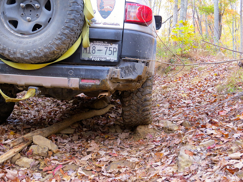

Jordan took the rockier line and didn't pay any mind to dragging and 4 wheel burnouts,
Bumper end caps are for sissies anyway...

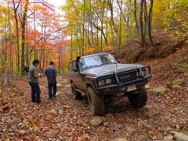

Dana had the most fun over here. Definitely different that what he was used to, but I'm sure he'll get there. Just gotta listen to your spotter and realize all that scraping aint gonna hurt anything haha. That took me a LONG time to figure out!

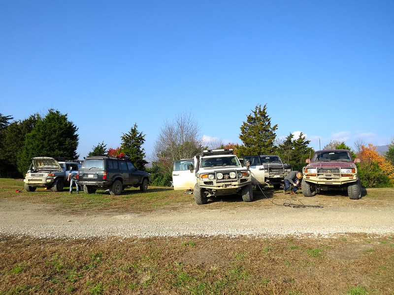

Sunday morning...
We all looked over our trucks making sure no one had anything that would stop them from making it home.
I believe the worst of it was a leaky seal between the rear third and axle housing on Jordan's cruiser, but that wasn't really an issue. Aidan also decided to break my air compressor as well while airing up... not quite sure what happened, I've probably aired up fewer that 20 tires with that thing... Keep forgetting to call ARB, gotta do that today.

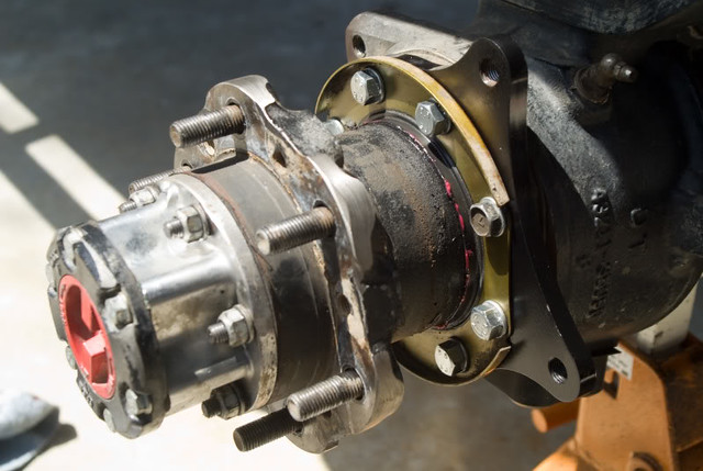

Recently, I've decided the FROR brake kit to add some track width. Basically swaps the solid axle hubs for IFS hubs. I can use larger rotors so that'll help a lot!
One main question to anyone who may know, will i need to use IFS locking hubs with this IFS Hubs or will my SA locking hubs still work? The ones in the picture below look to be the longer solid axle variety...

I got off the phone with Hutchinson the other day and unfortunately they only come with a 4.51" BS, with is the Toyota IFS norm, so IFS hubs are the way to go and i get to get rid of the spacer up front (or i could add a spacer to the rear for some more stable wider stance goodness... Ill probably do that haha).

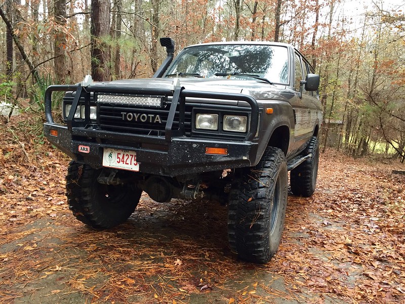

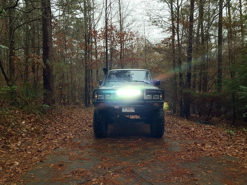

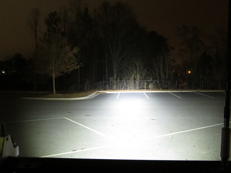

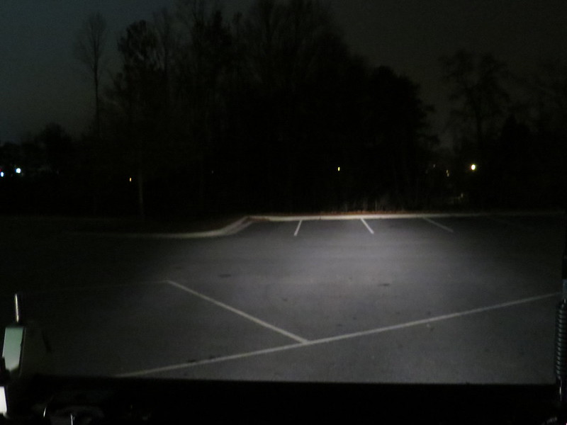

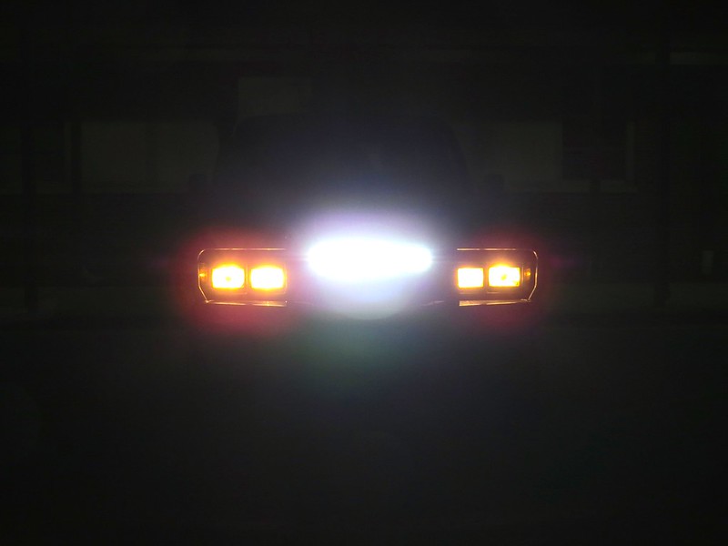

And because i finally wired up the front LED bar, some pictures!
Its not my favorite location, but i wasn't going to cover up the "TOYOTA", thats for sure.
"Token phantom bar daylight shot"

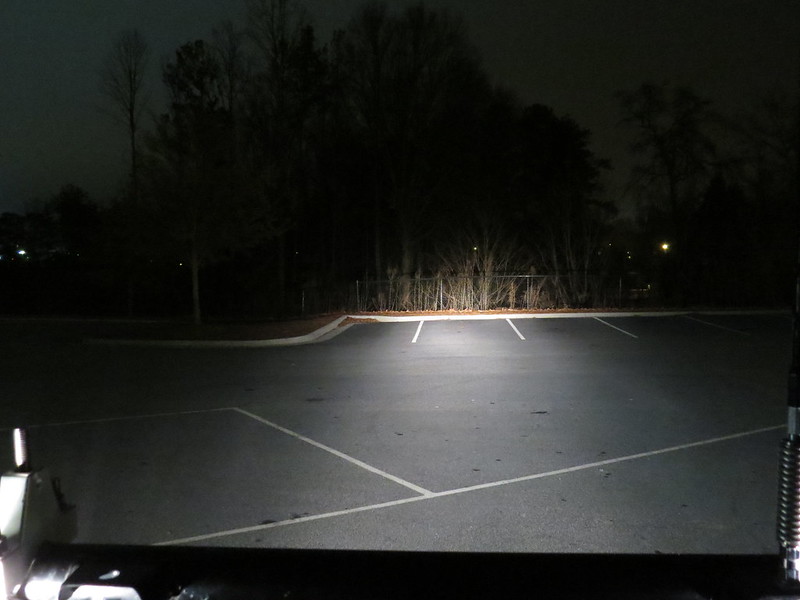

Low beams
High beams
Light bar
And just in case y'all forgot what it looks like at night... Its dark lol
Its bright
