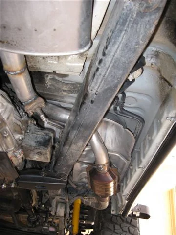

Where did you get your kit for $300 from?
I got it from Adam at 4X Innovations a few years ago IIRC it was $280-300 to my door
I believe it was the kit for the double cab taco which is about the same length as the bolt on 80 sliders he makes
These are what Adam recommended to me
It is the basic DOM tubing weld on kit w/o cat protection which is not something I am concerned about
I did have to make different legs for the front but it was all good
Dont get me wrong it was quite a bit of work but it was fun so it does not matter
Looks like they offer a kit for just the legs/cat protection for $200 plus freight. 4x Innovations: FJ80 Rock Slider Mounting Kit with Legs
This doesn't do me much good as I have plans for high clearance cats so that custom piece would be useless. The price is not bad though.
If you are moving the cats then you dont really need the protection
I plan on removing my cats sometime in the near future unless the trail does it for me first
