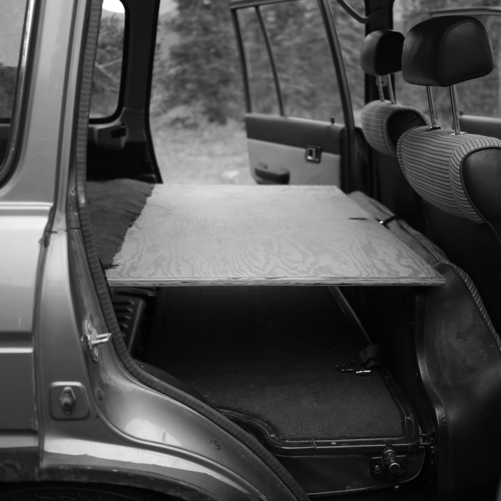

That is correct, however the wheel wells reduce the available area considerably. To maximize the sleeping area you need to make a platform above the wheel wells.
There's still plenty of width between the wheel wells to sleep comfortably, IMO, so you don't really need to make any modifications. I'm 6'5" and have to go diagonally, so if you're taller it might be a problem.

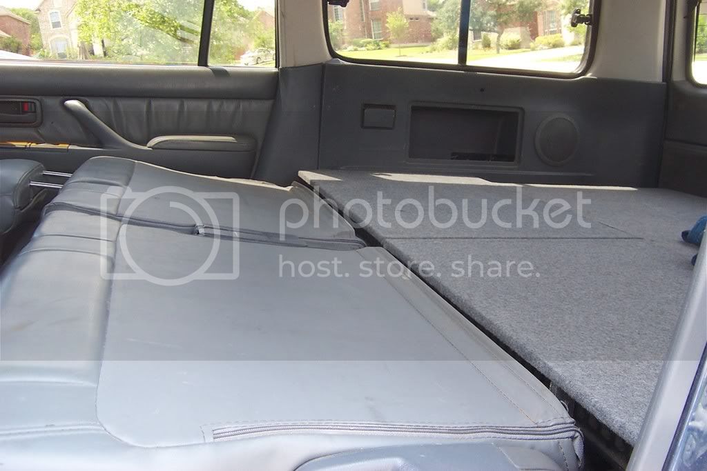

I still use (and sleep like a baby on) the simmons beautyrest futon mattress, but I have a couple of ideas for something nearly as comfortable at half the thickness. Even though head room isn't an issue the bed roll takes up more space than I like. The storage platform weighs 42 pounds and can be removed in about 5 minutes, but is secured in case of inprobable rollover. The front flip hinges on the 2nd row were cut out to lower the leading 2nd row seat edge by 2 inches creating a nearly flat surface on the same plane as the storage deck. I use a mildew proof cover that goes over the the top section of the truck to keep it dark inside, but no photos. Maybe I'll remember to take more pics next time I use it though it's been a couple of years since I camped last.
I went with the board over the second row seats the first couple of times but it was just a total pain in the ass setting up. So now I just use those foam mats that go together like puzzle pieces and then I put the camping air mattress on top of those.
