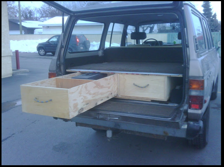

My solution for the sleeping extension (that goes over the folded down rear seat) was to raise the storage box enough to fit the sleeping shelf under the box.
Now it doesn't get in the way, and I don't have to have the rear clear of gear before I can set the bed up.
If you look closely at the pic you can see the sleeping extension under the box.
