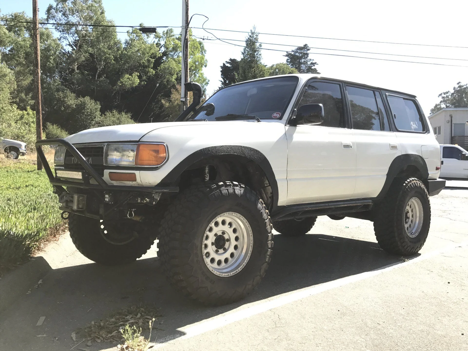

I have 850j with a 1 inch spacer up front 4.5 inch, rear 864 5 inches and 37's fit fine (loaded it goes down about an inch or so). You Can put a 1 inch body lift if you don't want to cut. I cut though because I wheel pretty knarly for an 80 and want a low center of gravity.
Also lower your rear bumpstop 3 inches for the rubbing, but it all depends on your rim width and backspacing.

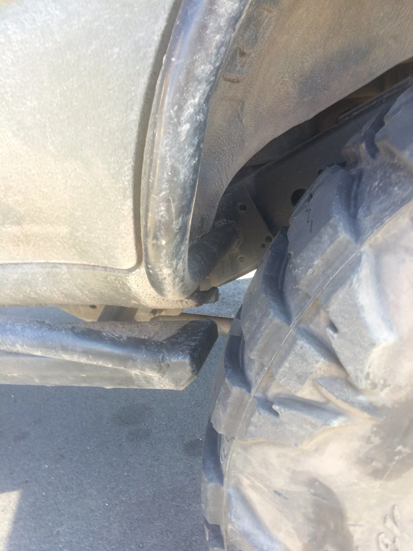

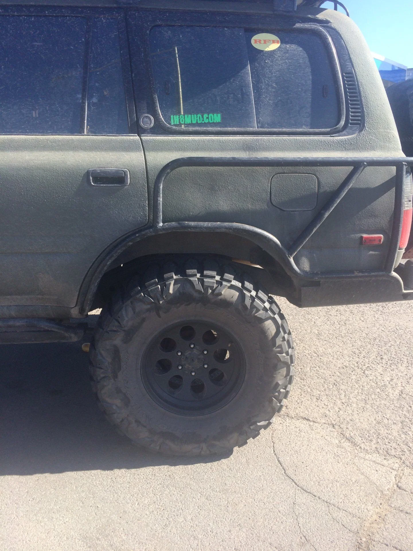

What do you mean not enough room for 37’s? I now you’re running a more aggressive offset then I am but where are you experiencing your rubbing?
With a 4.5” backspaced wheel with the lower control arms stretched 9/16”, 3” bumpstops with 37’s, my driver rear wheel just touches the plastic shield for the fuel filler.
View attachment 1545715 I have 850j with a 1 inch spacer up front 4.5 inch, rear 864 5 inches and 37's fit fine (loaded it goes down about an inch or so). You Can put a 1 inch body lift if you don't want to cut. I cut though because I wheel pretty knarly for an 80 and want a low center of gravity.
I want to cut the wheel wells just would like to see it done before i do it, Im talking the method to cut, Ive never done it, but I never built a rear drawer or roof rack etc.

That’s what I figured. You can shave the fender lips and shorten your sliders or lengthen the lower control arms ~ 3/8-1/2” to recenter the axle in the wheel well.
I have a few pictures in my build thread of how I did mine.
