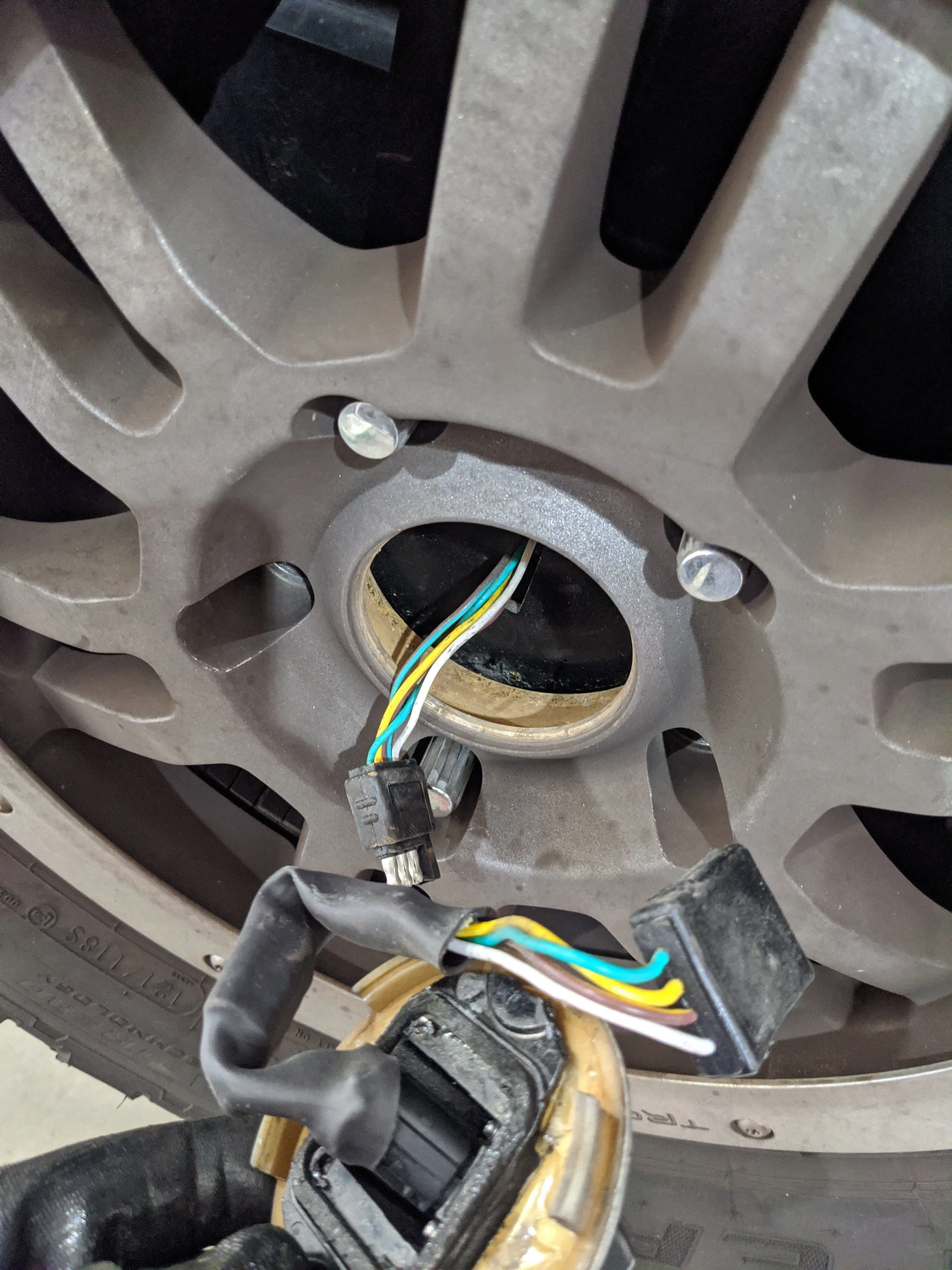

About to do this. What wiring harness or guage wires is needed and once you relocated what is your suggestion for covering original location of camera?
I used a 4 wire trailer harness and disconnect for the wiring extension. I covered the hole with 3M vinyl.
