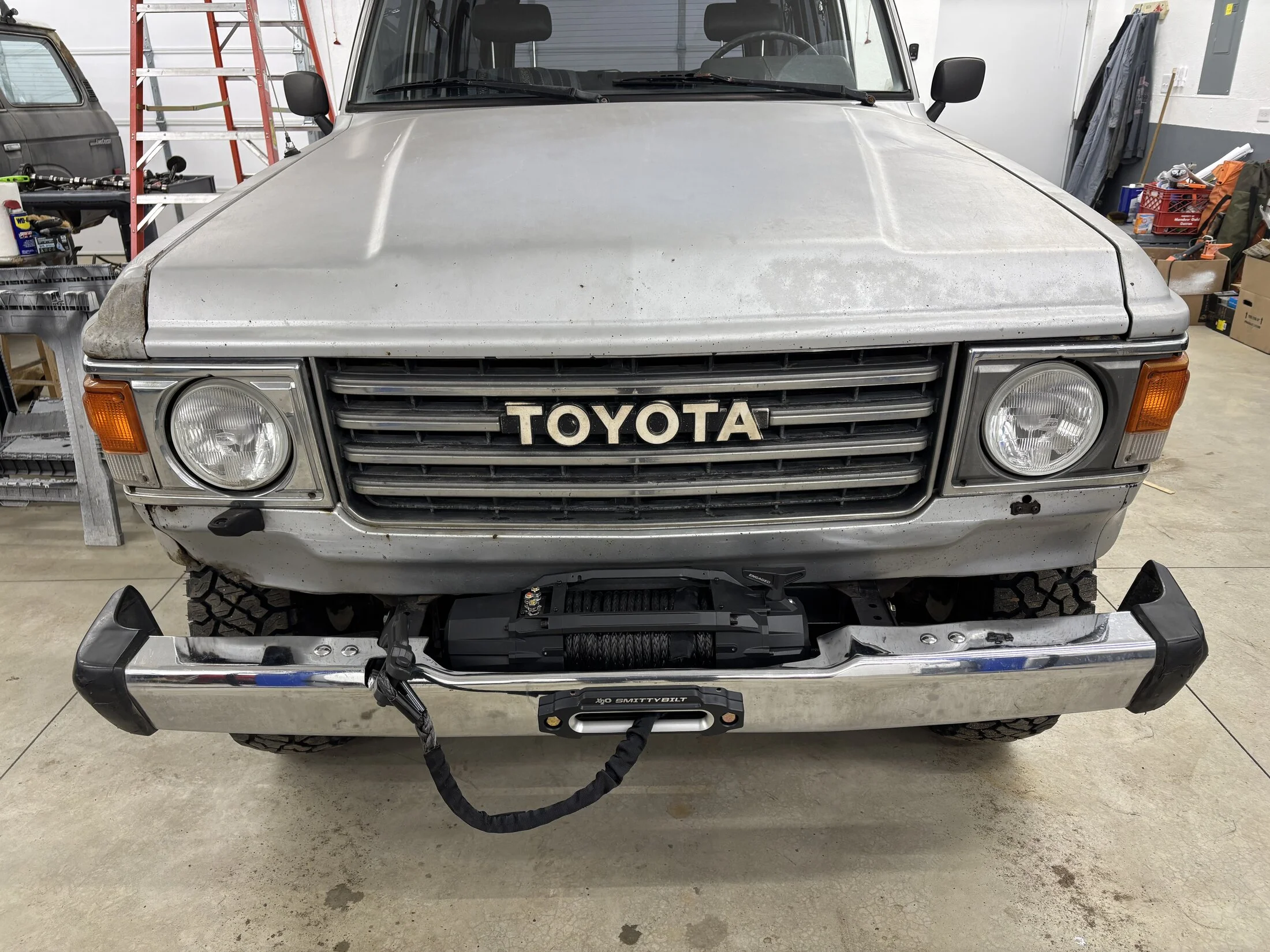

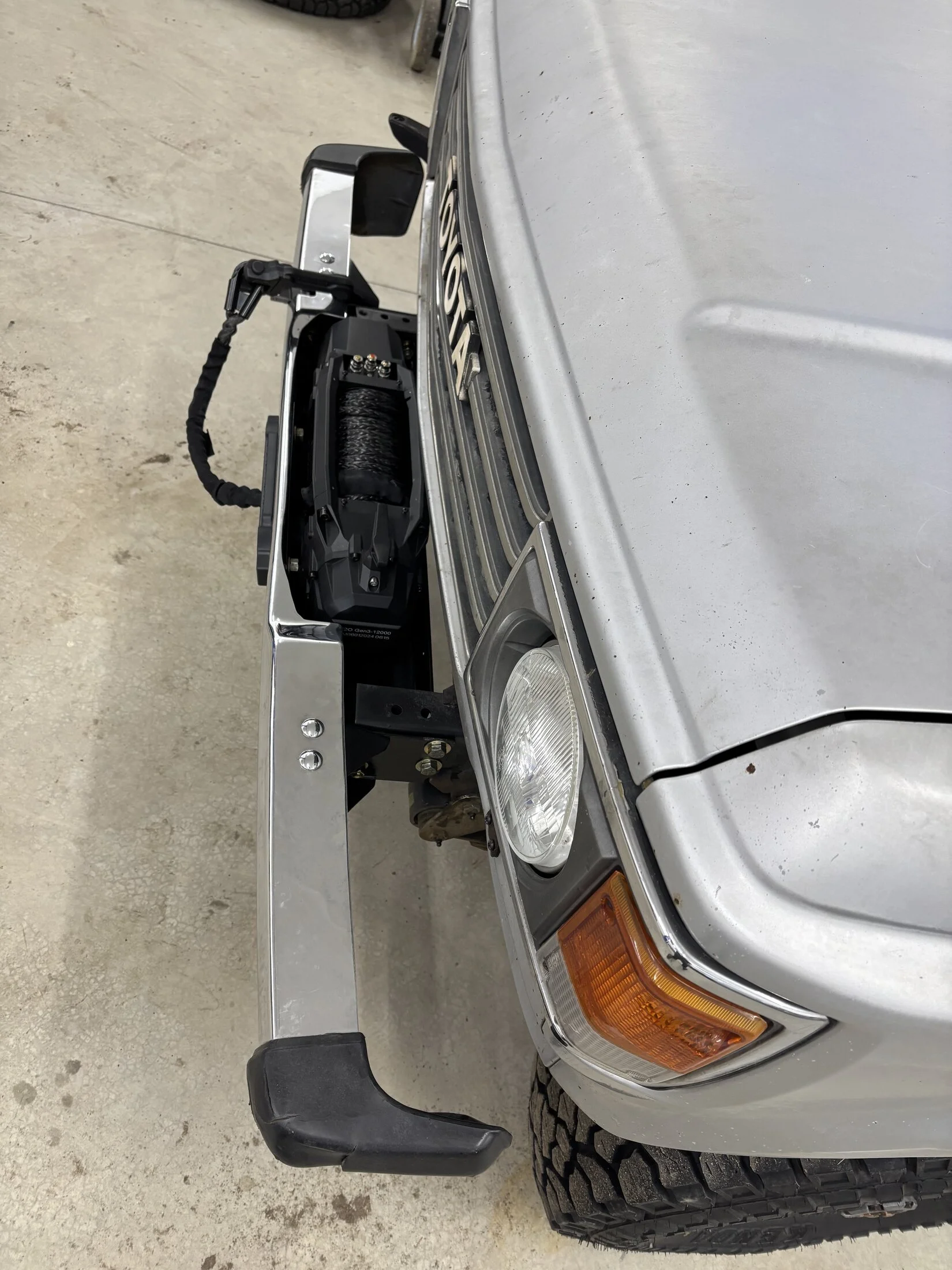

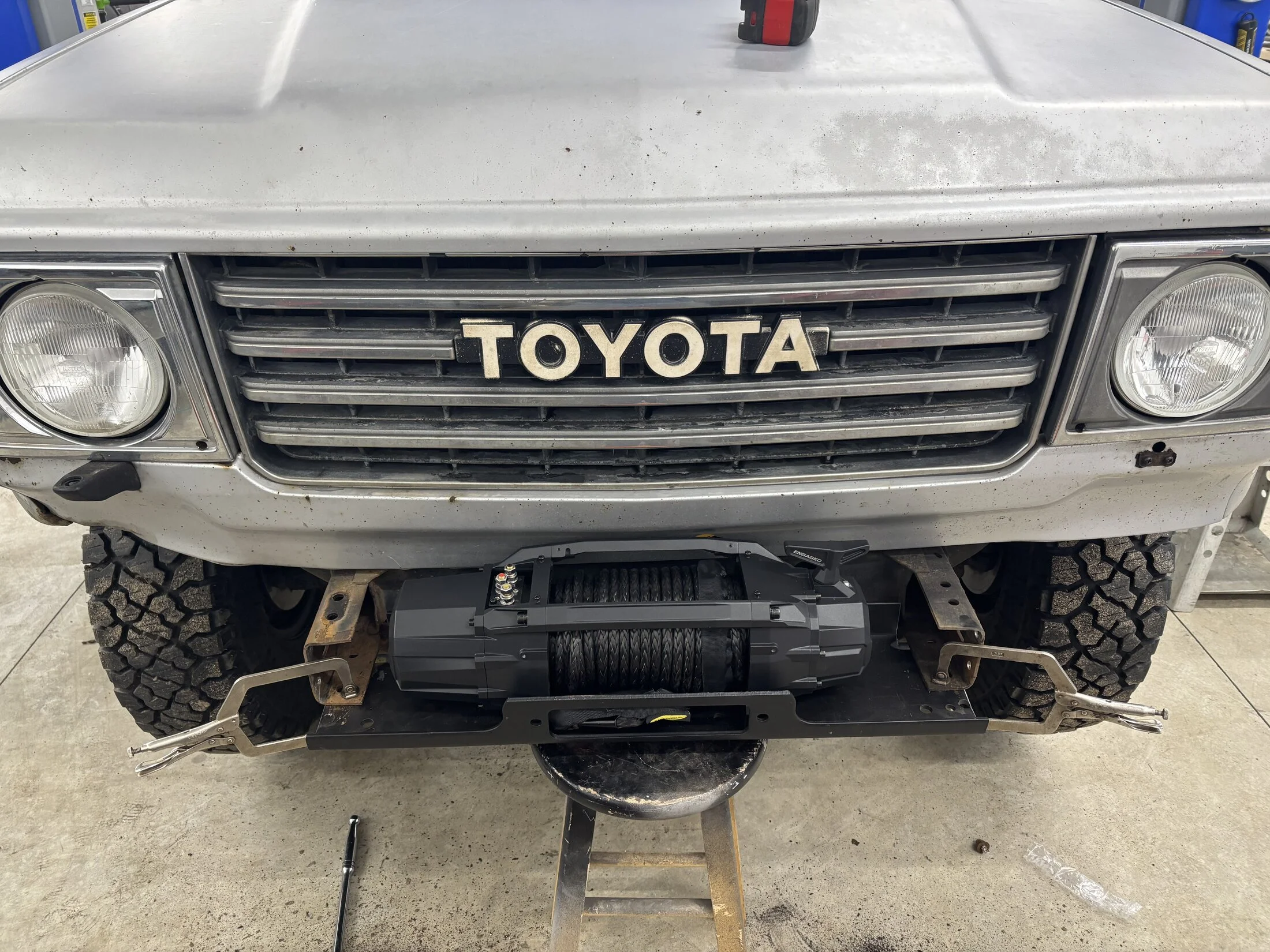

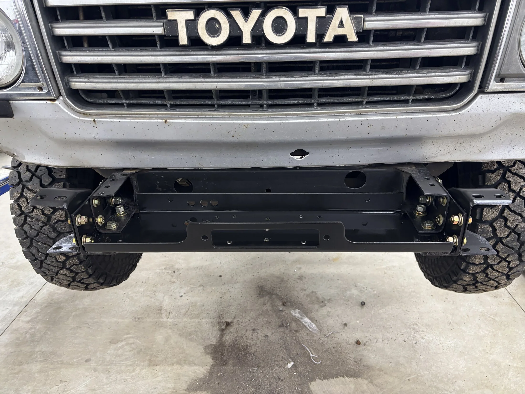

The last couple days I built a winch cradle to mount a winch in the stock bumper. It pushes the bumper out about 2” from stock. Using a Smittybilt 12k X2O winch with synthetic line. Relocating the solenoid box under the hood for a cleaner winch look. This winch comes with plastic “armor” with writing. I won’t be using that. I also changed the top bars front to back so the Smittybilt logo is hidden. Need to paint the writing on the fairlead too. Still need to wire it up but should finish that in the next few days.
I used a the Harbor Freight winch mount, for $40 on sale, I couldn’t build it that cheap. It’s 1/4” thick and I cut it down to fit the frame rails and added some 1/4” angle so it bolts to the frame in 6 places each side and incorporates pushing the bumper mounts out.
Cutting the bumper was a little nerve wracking.

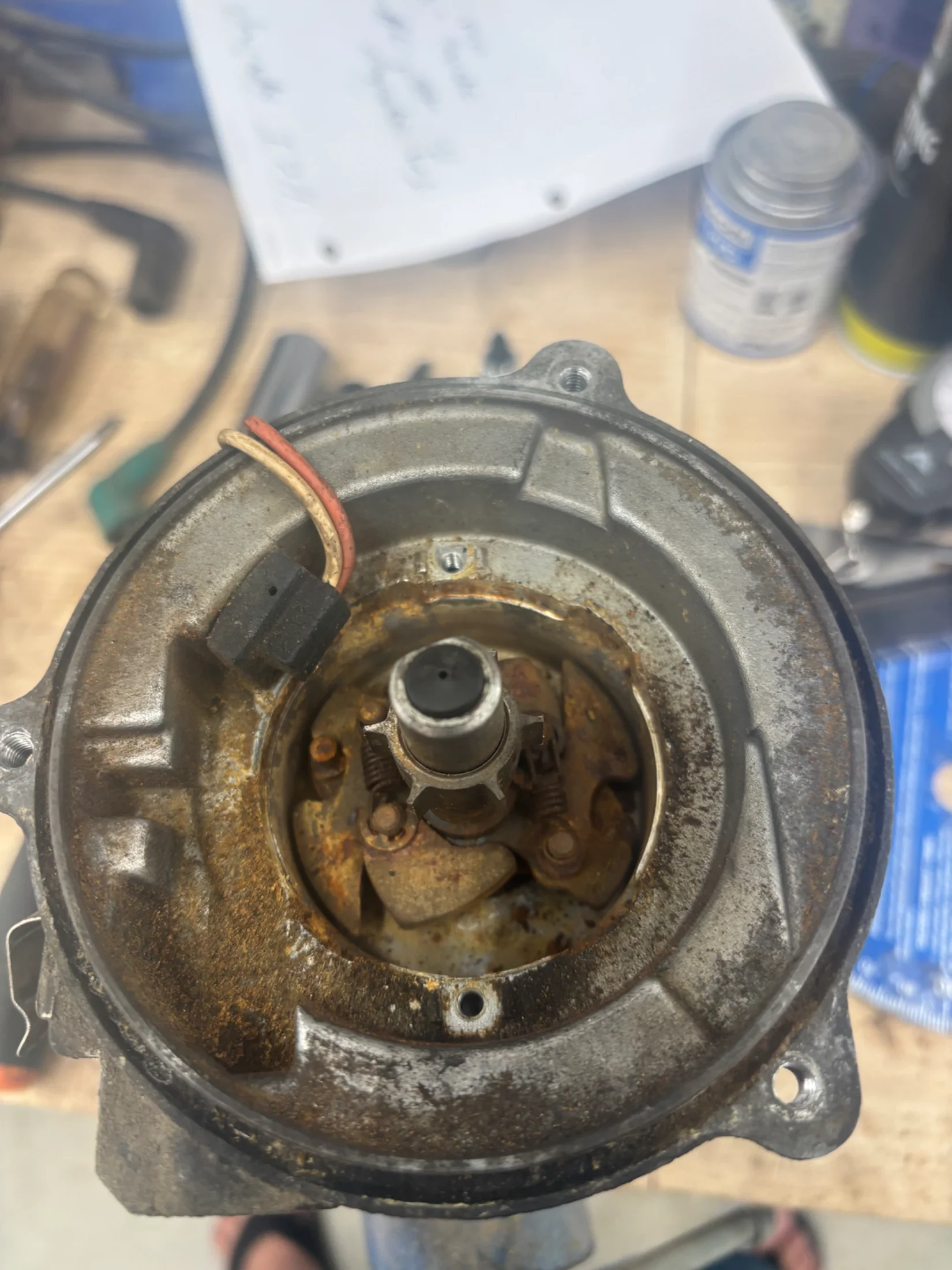

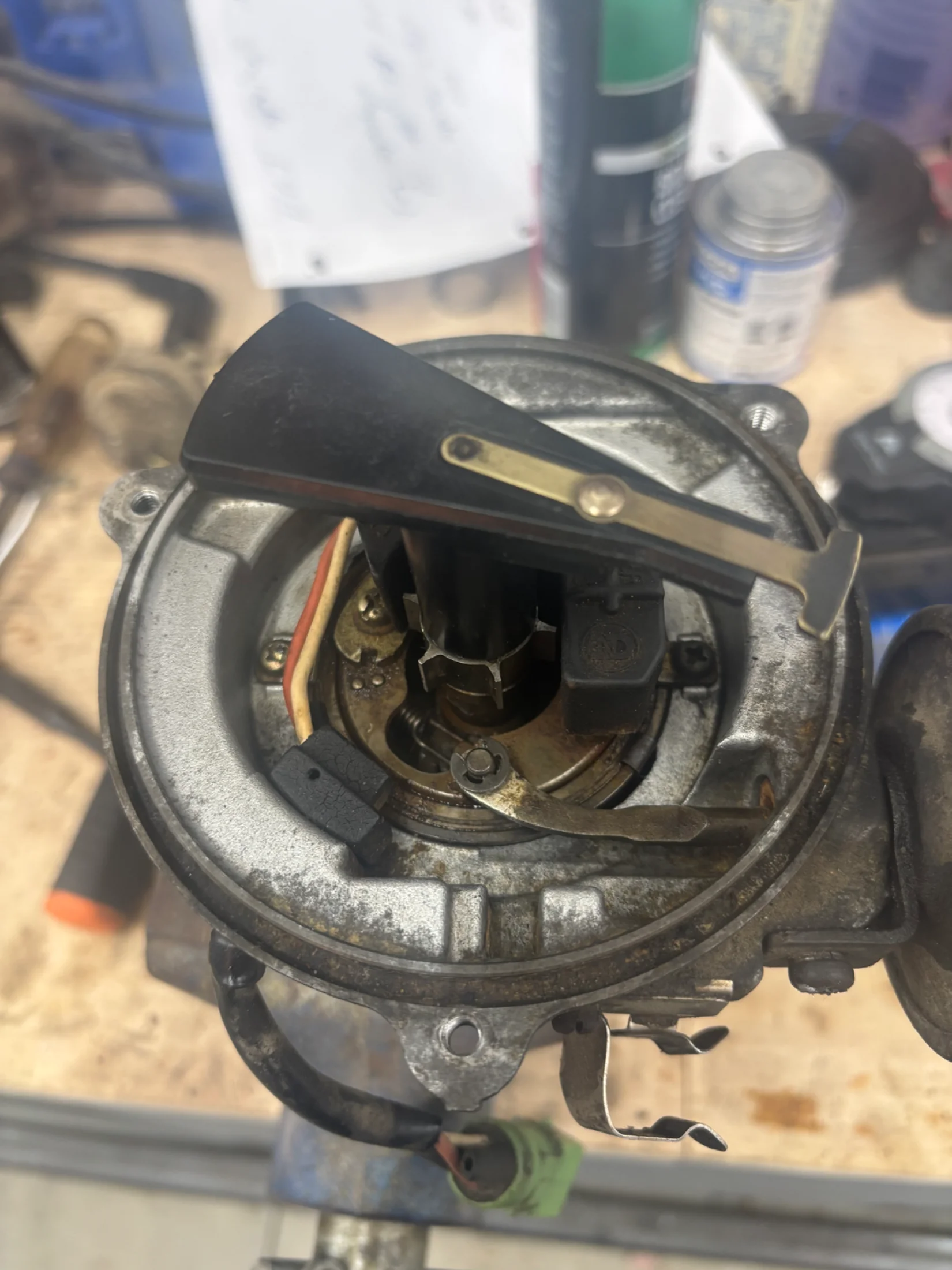

Anyhow, advance curve plotted, I waited for it to cool and pulled the distributor. It was in worse shape inside than I expected! Besides being really dirty inside, there were 3 main issues I found.
1: The bearing plate the vacuum advance moves was super gummed up and “notchy”. I pulled some vacuum and it would slowly and not smoothly move it, then releasing vacuum; it would stay put for up to 10 seconds then twitch back to rest.
2: The advance weights were equally gummed up and would stick at different points that I put them at and need some input to get them to move further.

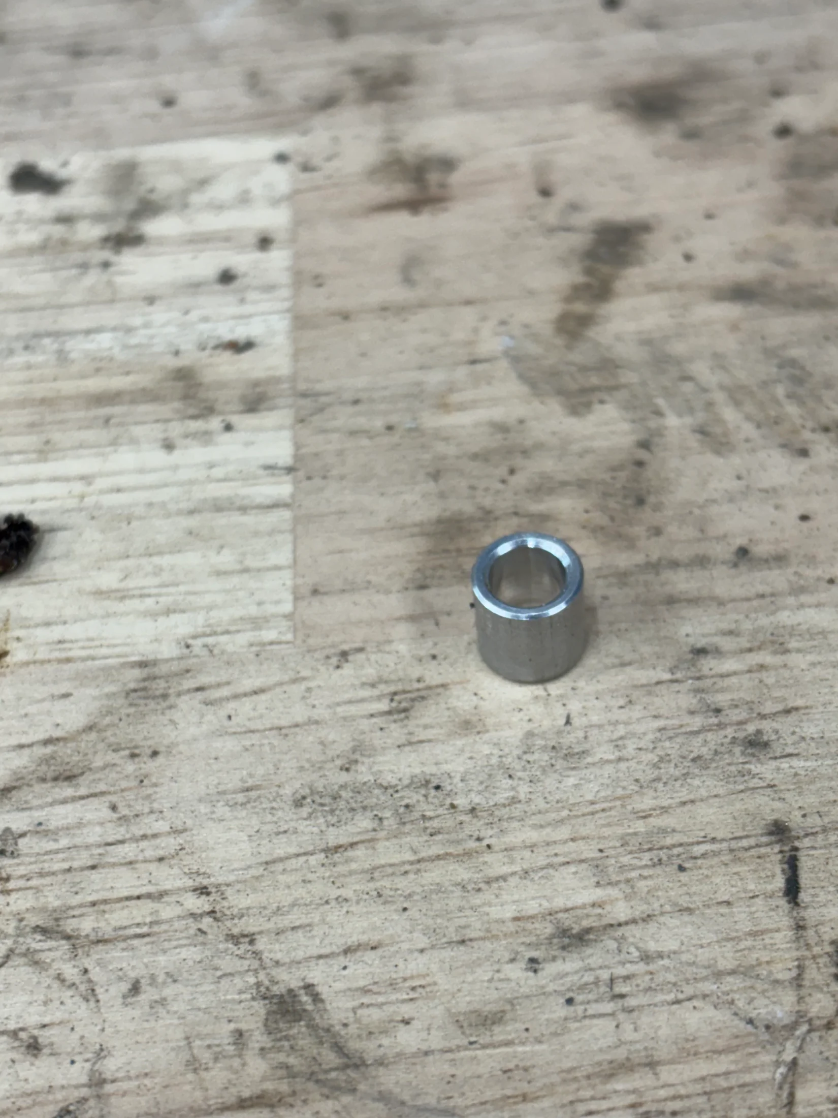

3: As expected, the bushing was disintegrated, allowing (if the weights moved freely) too much advance.
With these things, I think I found my bad spark knock. Mechanical advance staying wherever it felt, too much total advance and the vacuum advance staying all in well after it should’ve released.
So I cleaned and lubed the bearing plate the vacuum advance moves until it spun very freely, cleaned and lubed all the weights and springs and then installed the aluminum bushing.

What I found when I pulled distributor.
Gummed up mechanical advance.

Bushing added for mechanical advance.

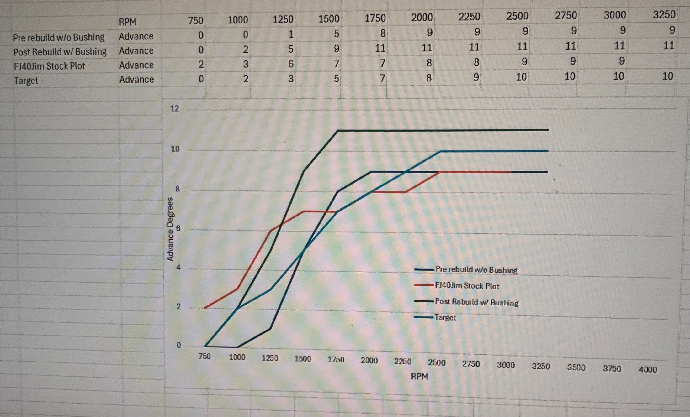

Green line is where I’m hoping I get my mechanical advance when I’m all done. Blue is supposed to be stockish advance curve.

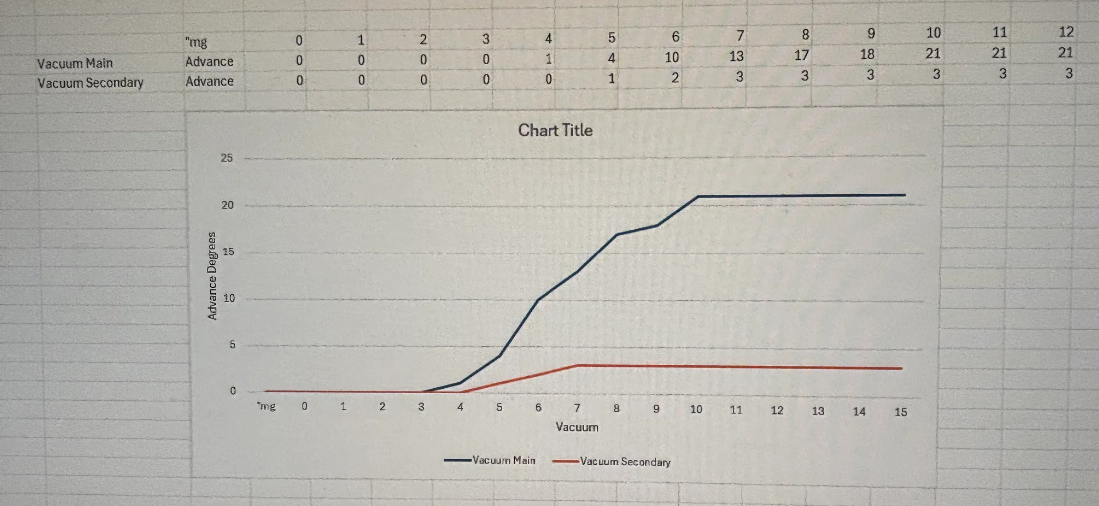

Had some time today to map out where I am post-clean and lube. Also mapped the 2 sides of the vacuum advance can by using a mighty vac and dial back timing light.
Changed my target timing in the graph a little (light blue line) but we will see when I start playing with springs what it does performance wise. Driven it to work the last 6 days and it revs so much smoother than before and can gain or at minimum hold rpm on hills I used to downshift.
Poor pic of computer screen… Dark green line is where I am now; timing comes in a little sooner than I think I’d like and reaches max mechanical advance sooner than I’d like but again, it’s driving pretty smooth. Going to try a heavier spring to delay the advance a few hundred rpm and a longer ramp up to max advance. I typically don’t cruise below 2200 rpm so that’s about where I want my max mechanical advance to be all in at.
Vacuum advance at idle using the mighty vac. Idk where I want this yet, I need to tape my vacuum gauge to my windshield and drive around a few days and make notes of what my vacuum is doing before I decide.
What I think I know is that it is coming in at too low of a vacuum and all in lower than ideal? I’d rather see vac advance start coming in after 6-7” and be all in around 12-15” but again, I need to drive it and observe what it’s doing.
I also think I’m not getting as much as I should get from the secondary side as I’ve read about 4 degrees of vac from that one is stock. Could be some gunk or corrosion in there.

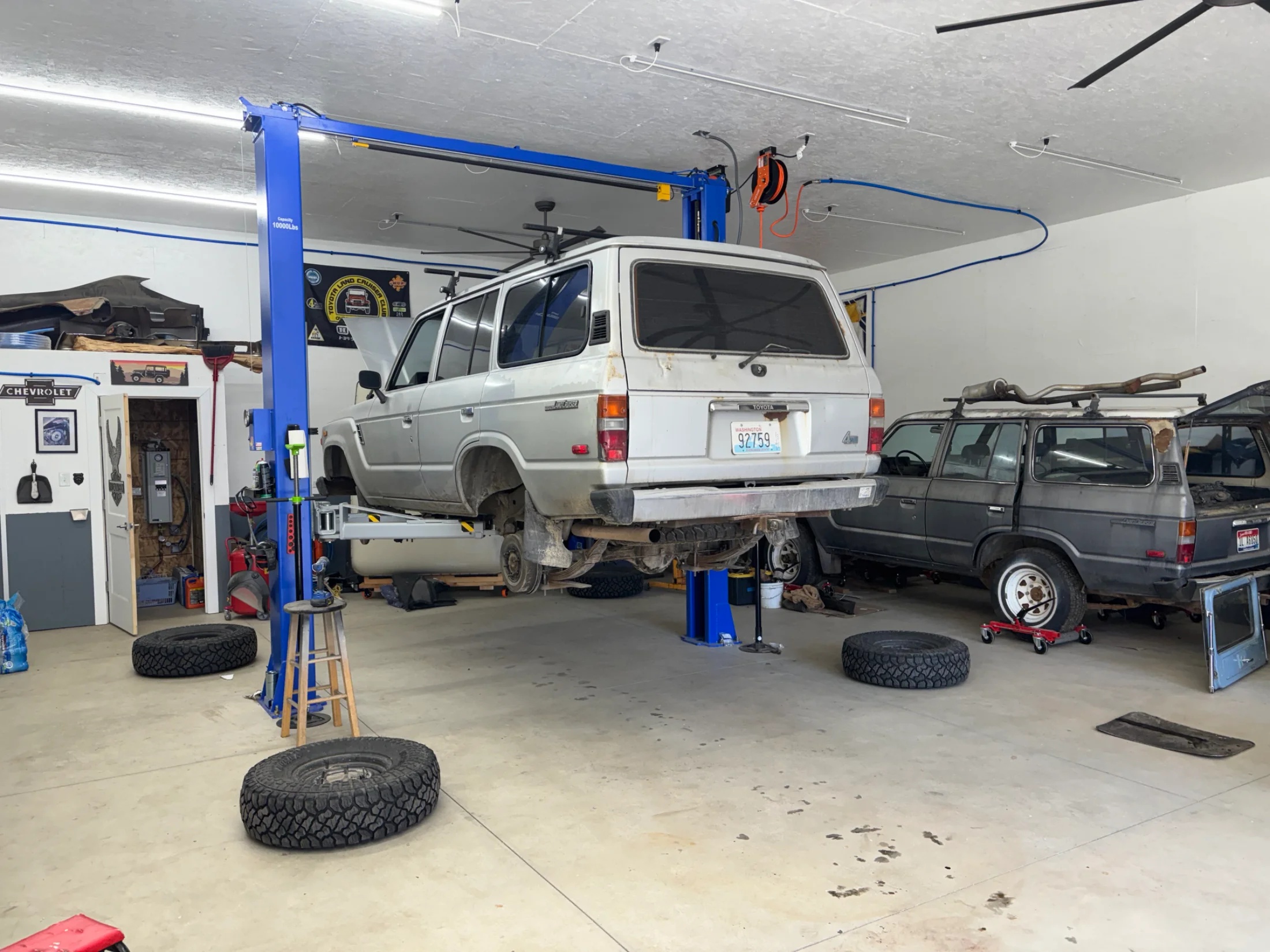

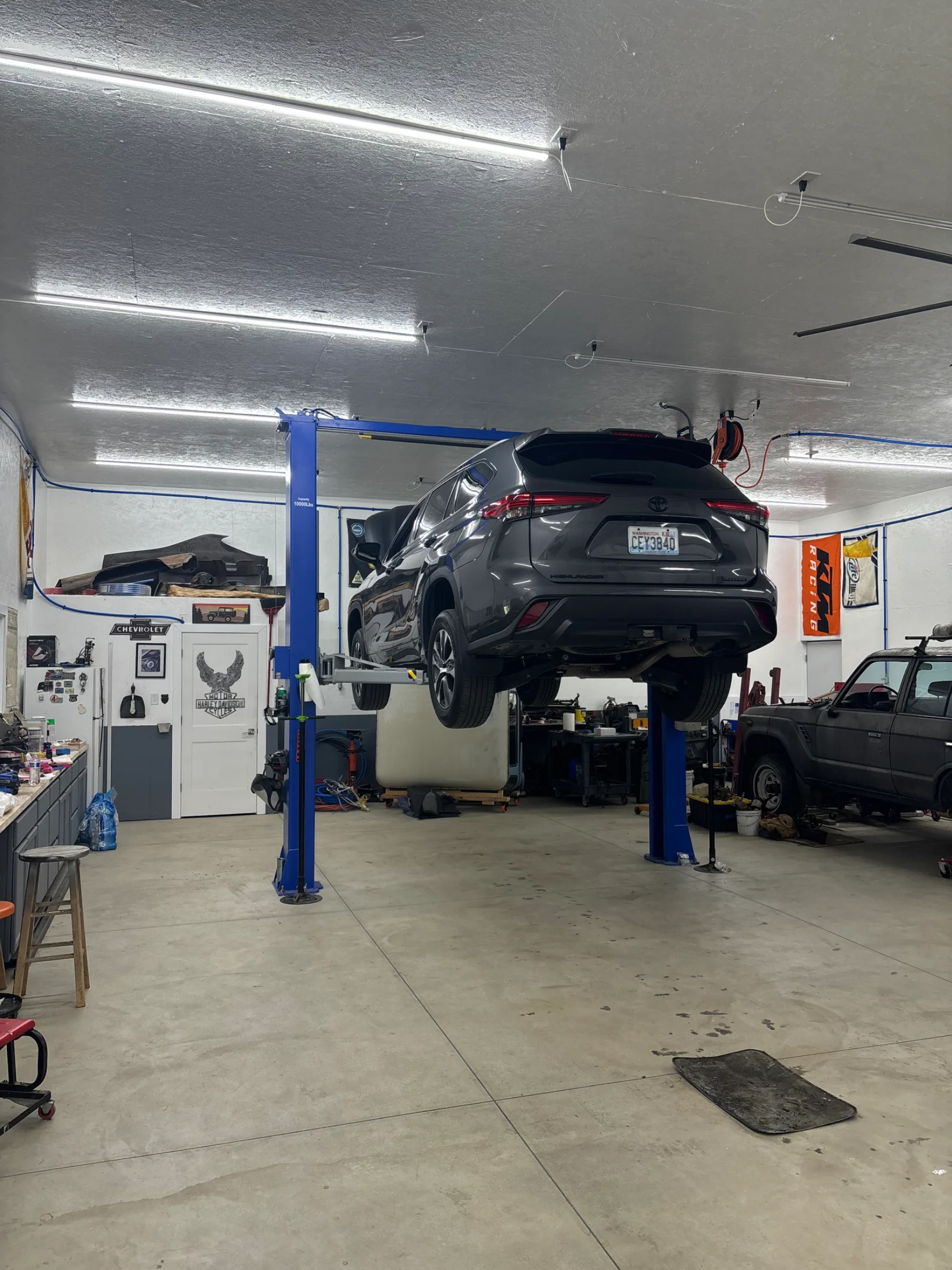

Oil and filter change, new fuel filter, chassis lube and tire rotation day. Wife’s Highlander even got its service.

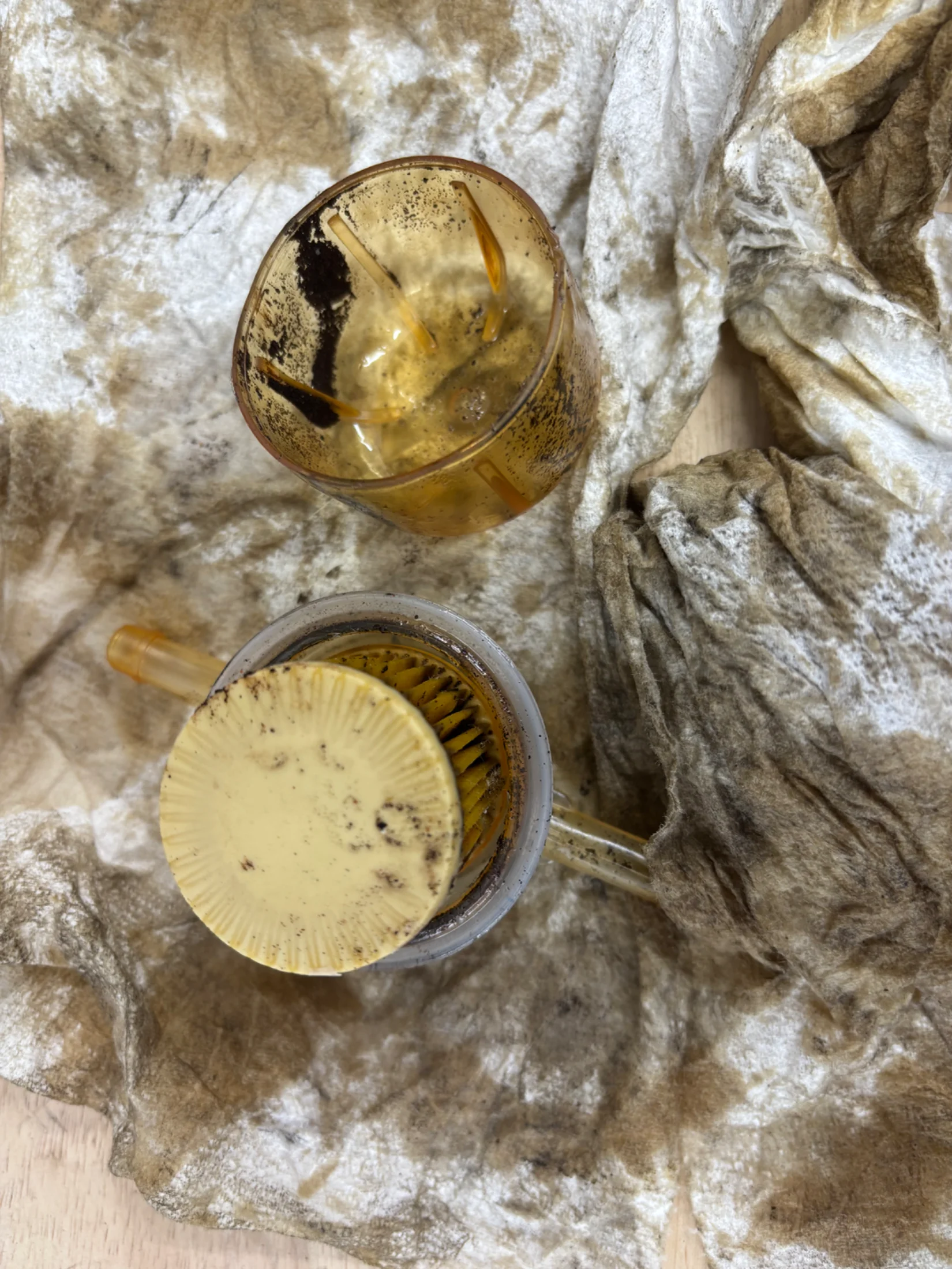

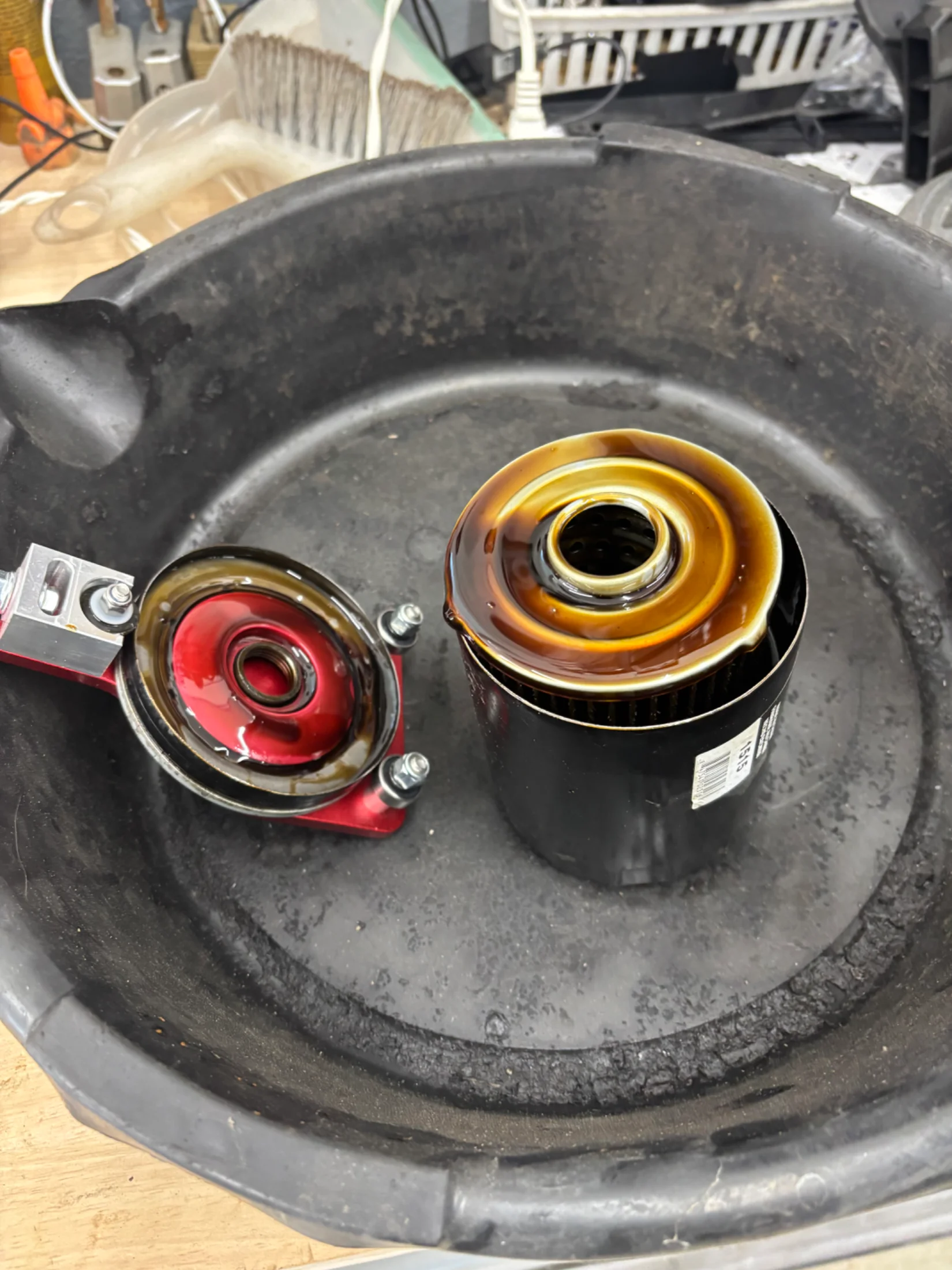

Cut my fuel and oil filters open and much cleaner fuel filter since sealing the tank. Oil filter has no worrying metals so that’s nice.
