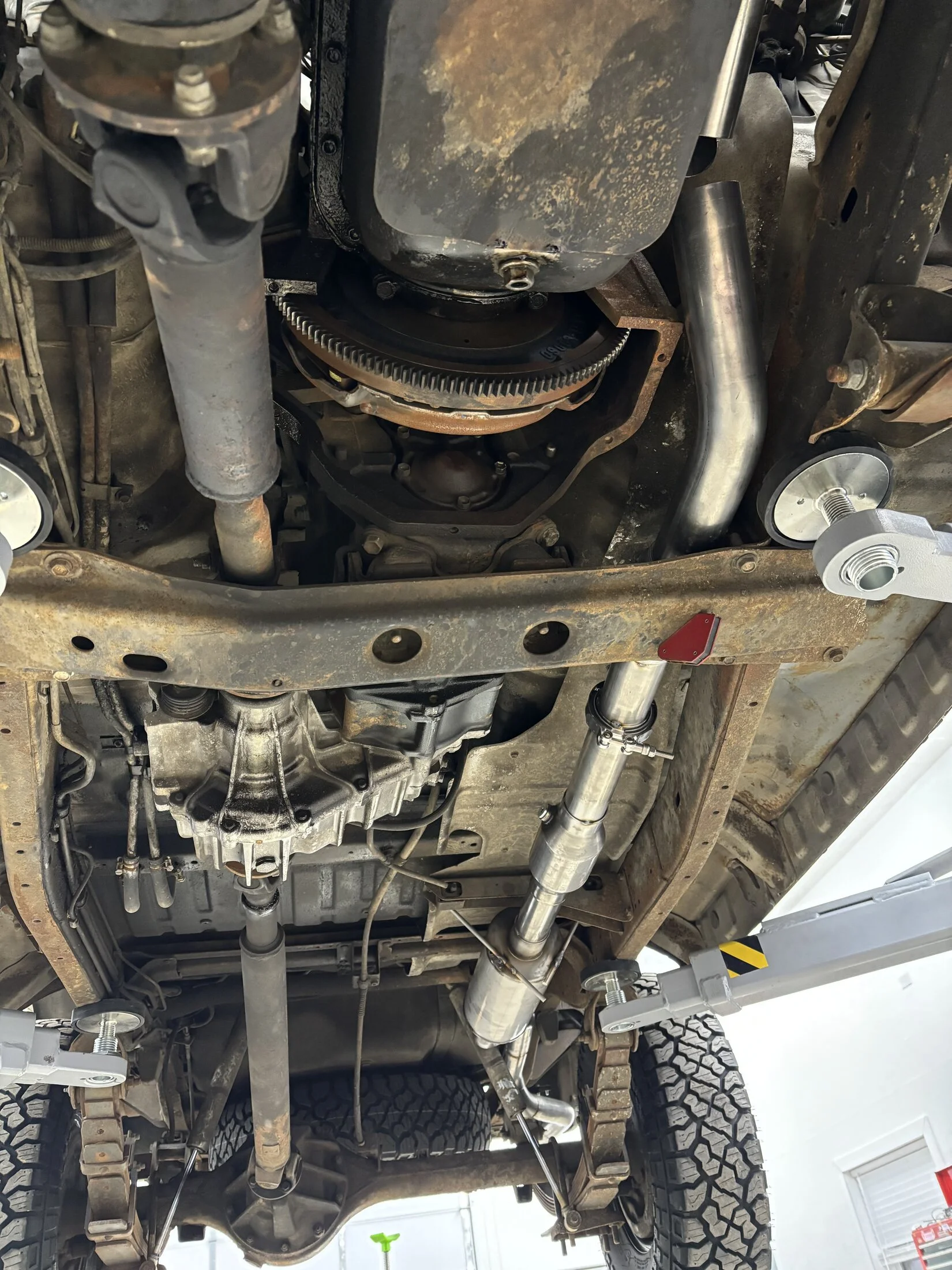

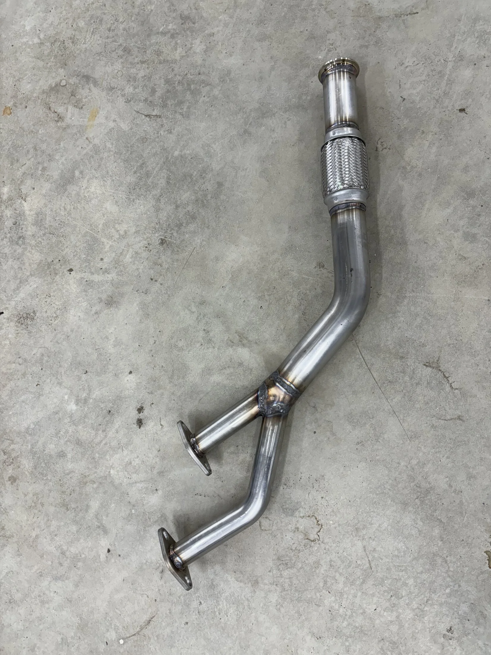

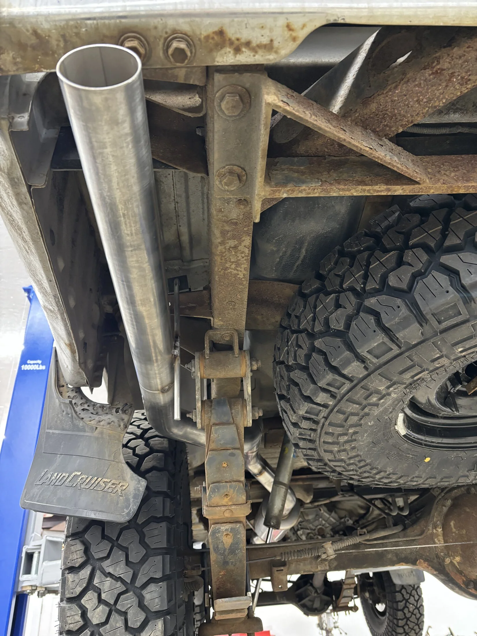

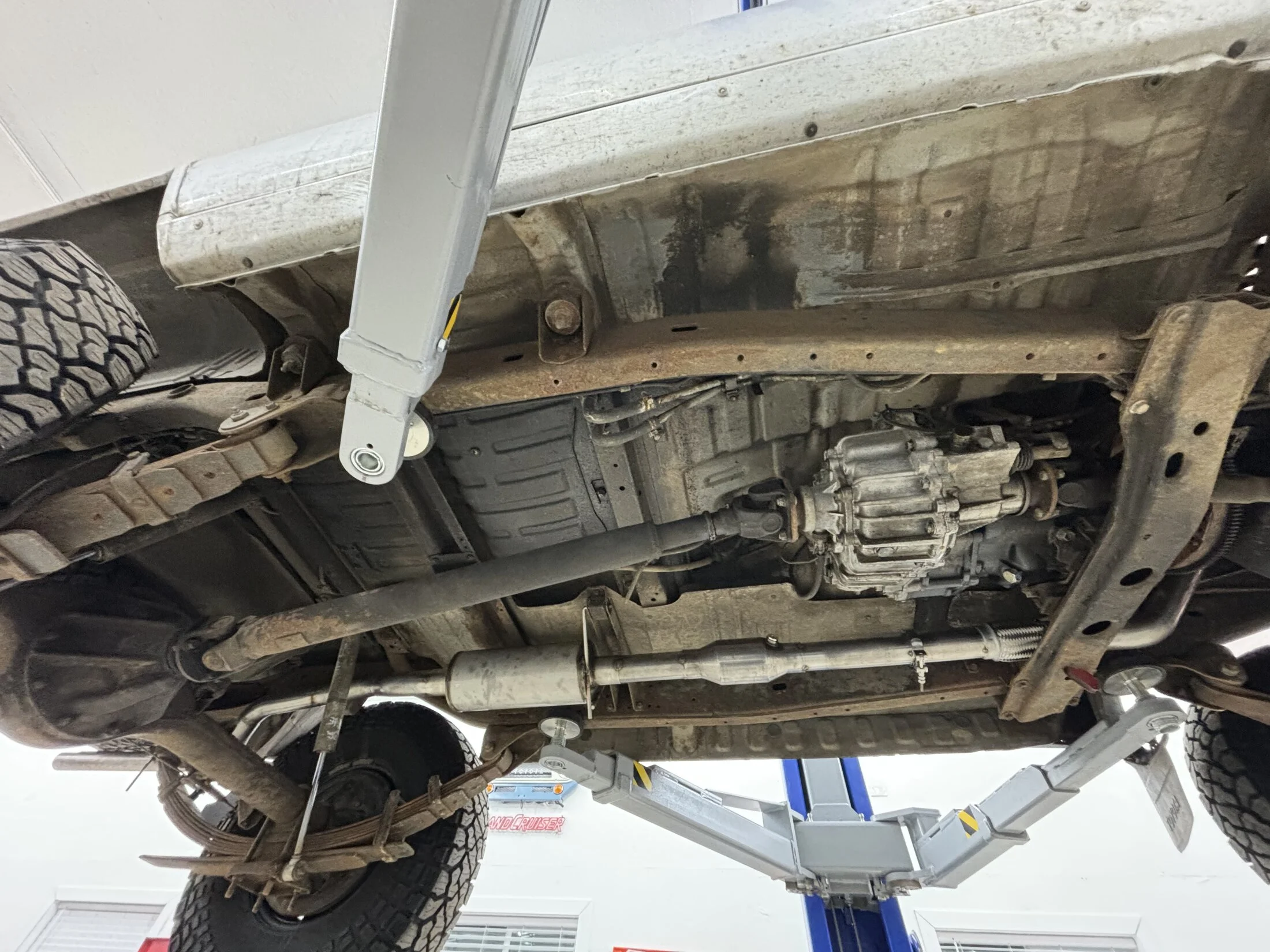

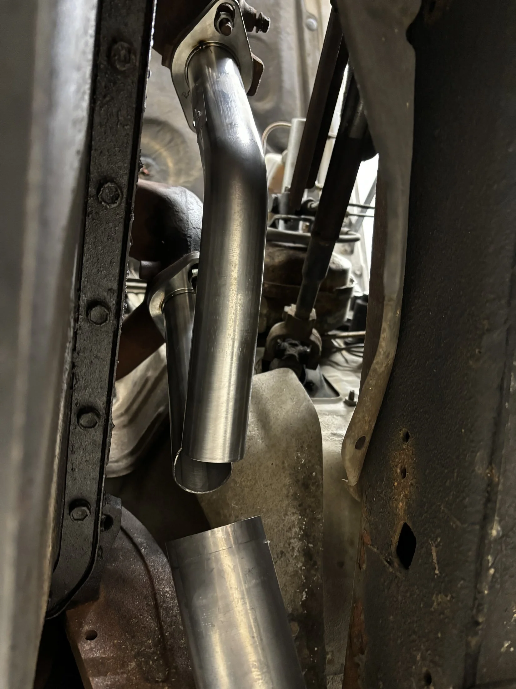

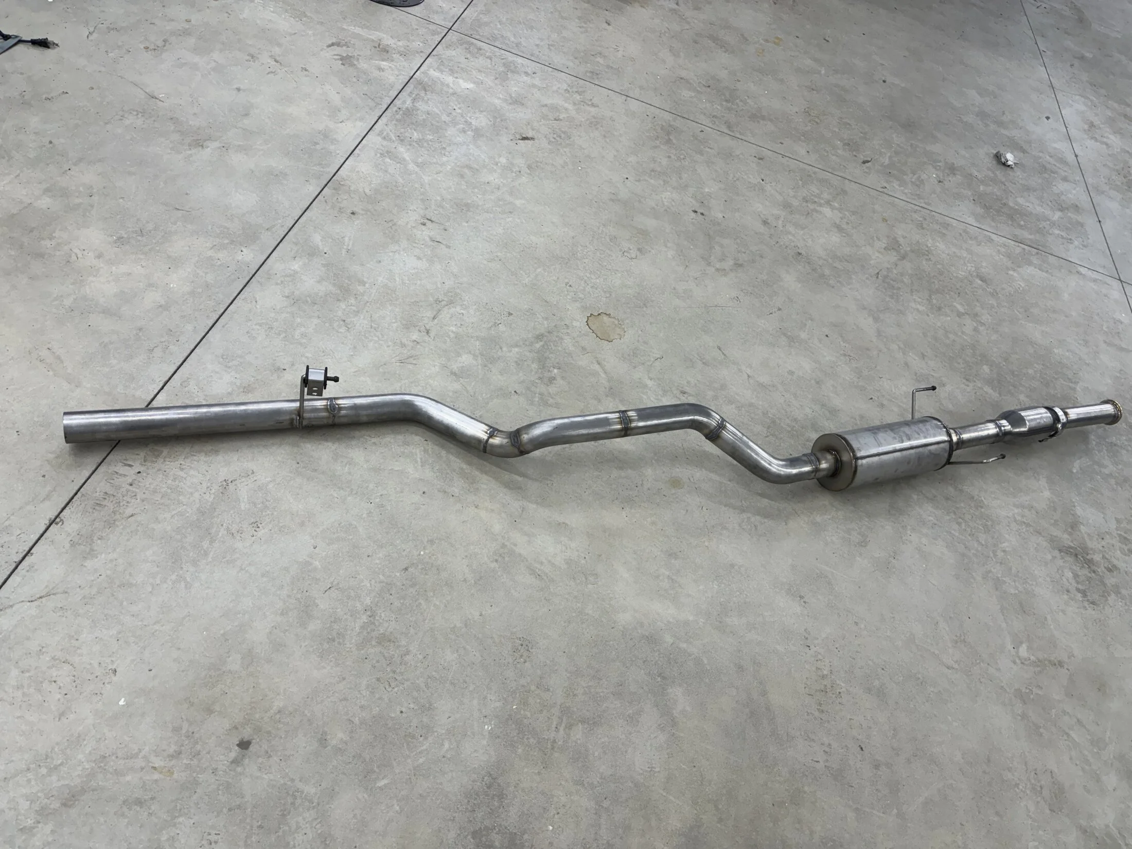

Getting there. Need to build the transition Y piece from the head pipes to the single pipe. Then take it out and finish welding it all up. Set it on the ground and all the suspension clears the exhaust with plenty of room.
Finished up the Y and finish welded the rest of the exhaust up today. I haven’t welded a ton of stainless but it usually looks better than most of this! I was having a hell of a time getting consistent welds. Finally figured out my hose had a hole and the power cable inside was mostly severed and also blocking flow. Did a band aid fix and it got better but still not great. I’ll wire brush it up and it’ll be fine. Happy it’s done. LOTS of welding, refitting, remove, weld, refit, repeat. Everything fits and I know a couple things I’d do different next time…..

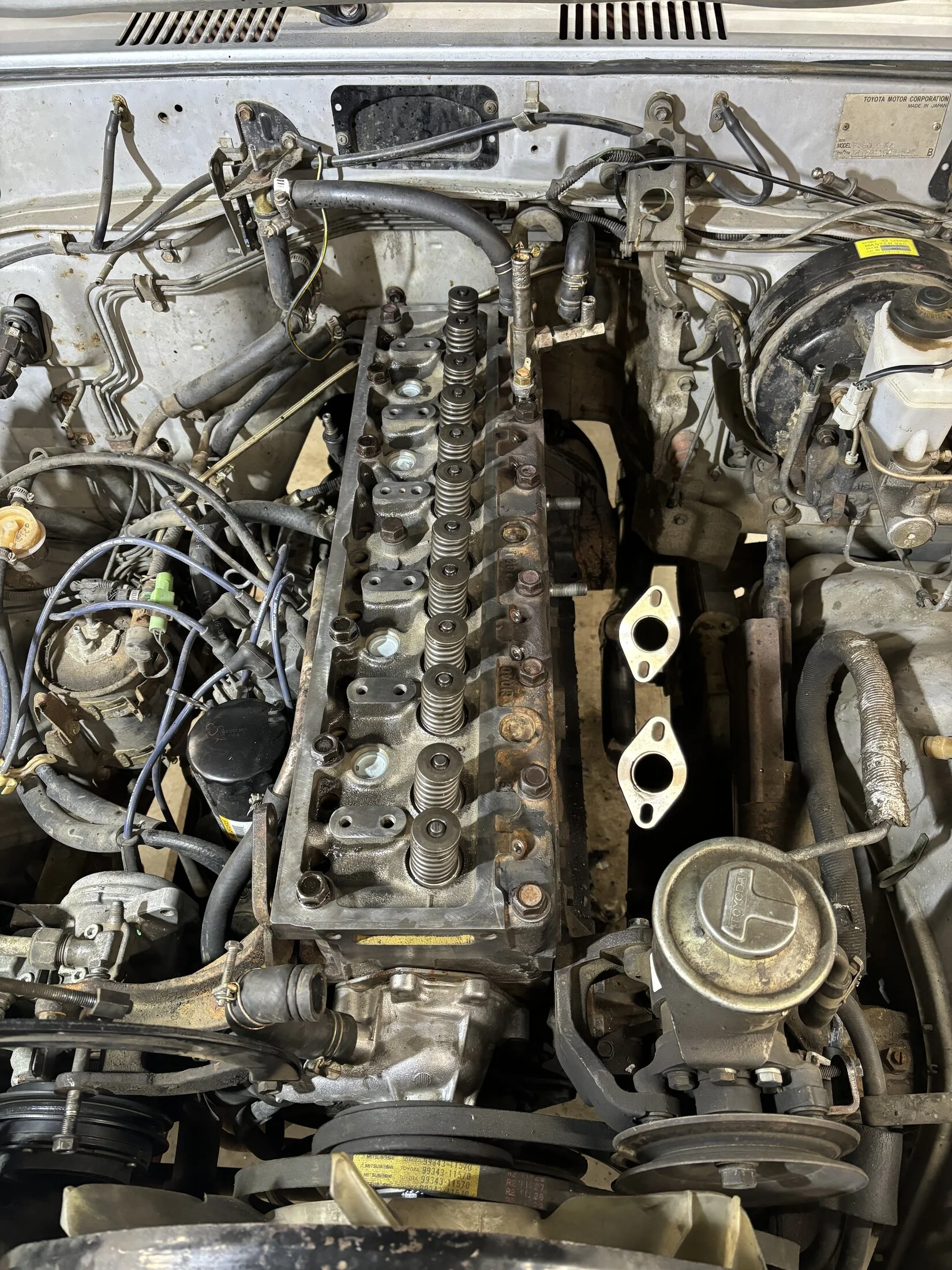

Spare head came back from the machine shop yesterday and all looked good. Lapped the valves, put in the air rail delete plugs and did the oil galley plug fix today and got the head bolted on. Should be able to button it up and start it tomorrow.

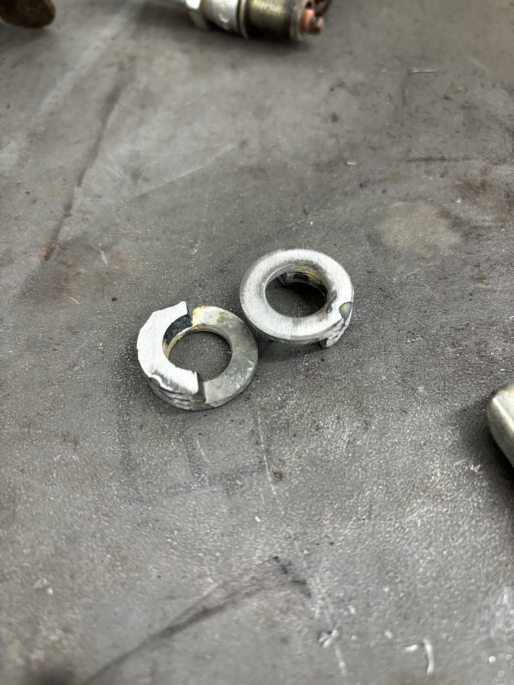

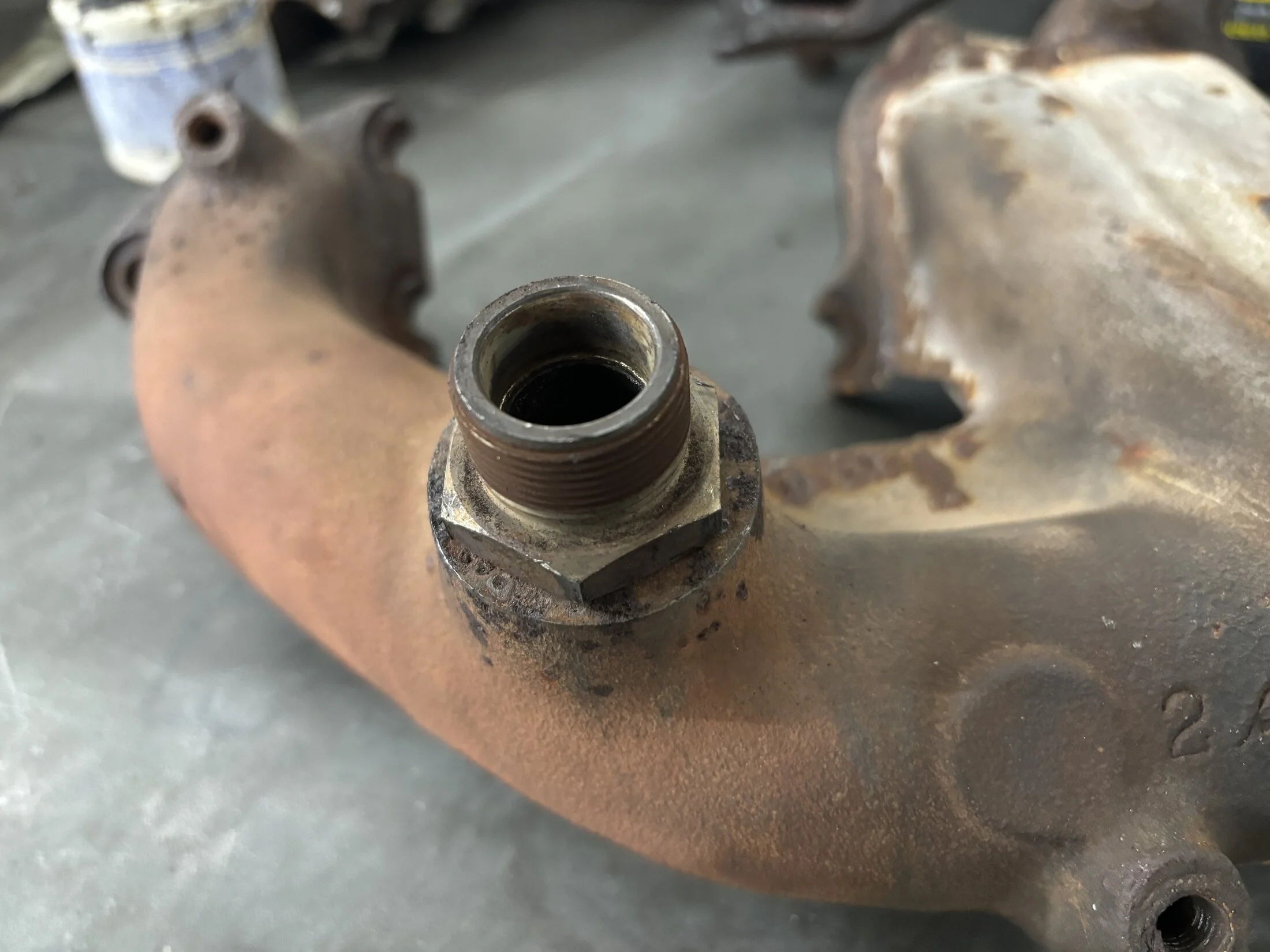

Forgot the 3FE exhaust manifold flanges are thicker then the 2F so had to make some spacer washers. Also bought a plug to put in the EGR port on the exhaust manifold but that thing was not coming out, so capped it instead.

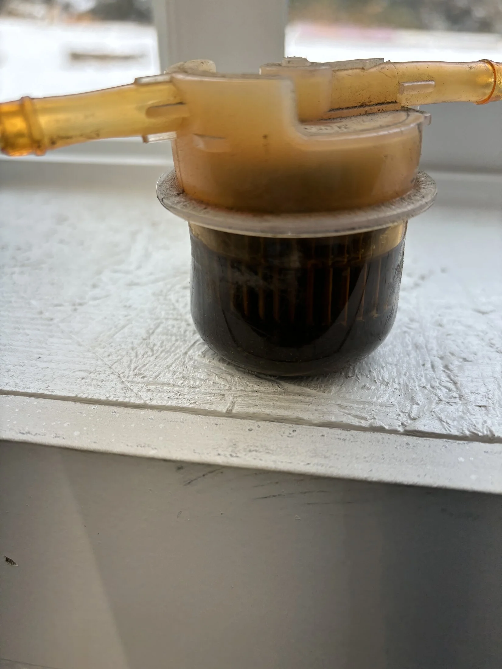

Changed the fuel filter. This one was from September of 23, about 12-15k miles.

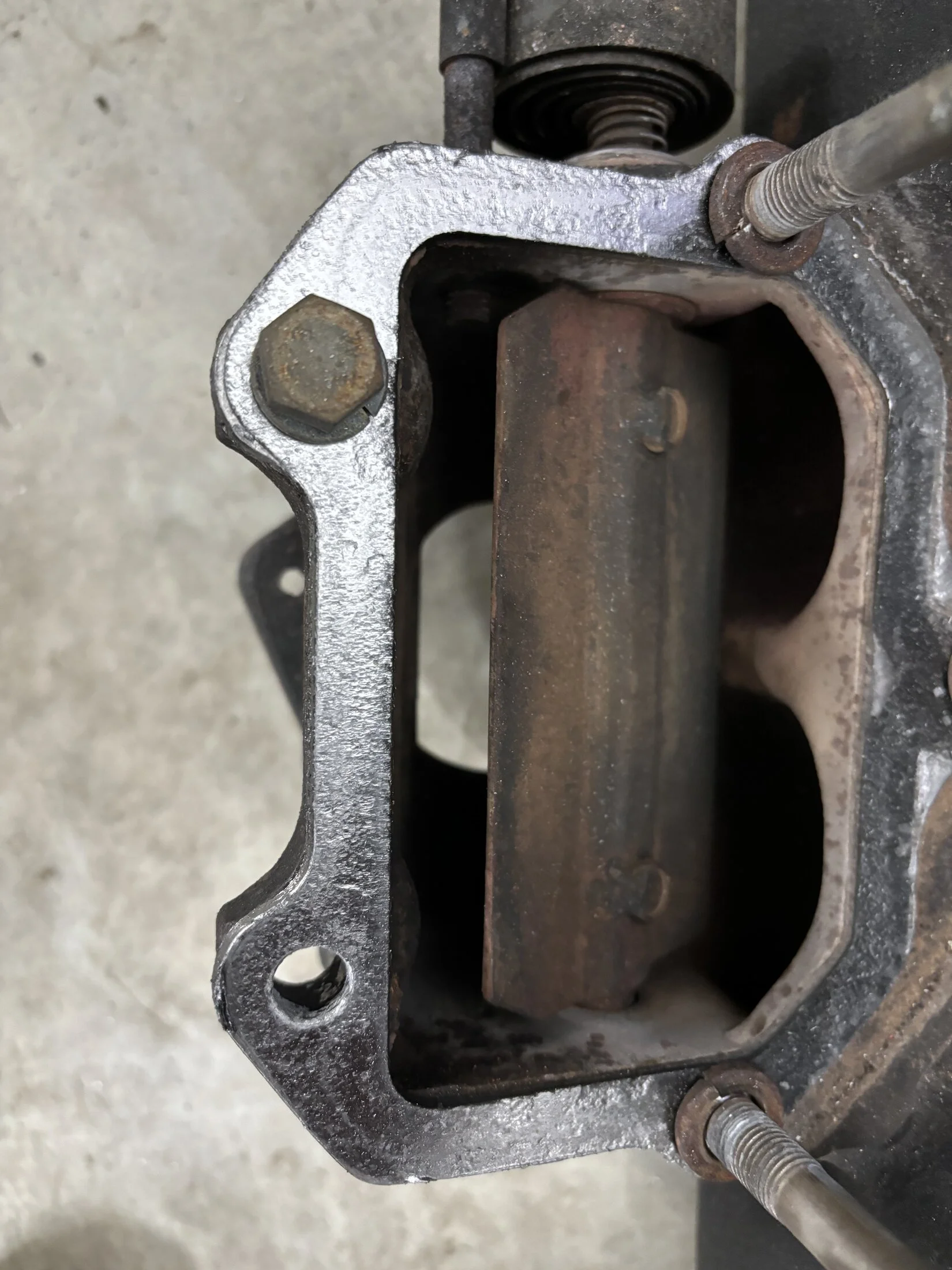

The exhaust flapper in the stock manifold moved freely, however the thermal spring did nothing. Hit it with my torch and the spring moved a little then nothing. So it appears that flapper was stuck closed at all times, severely restricting the exhaust. I’m guessing this played a part in the pinging and sluggishness. I need to measure the old head but I’m also curious if it’s been milled before I got it or if when I had it done they took out too much and really bumped compression up.
Pic of flapper because, why not.

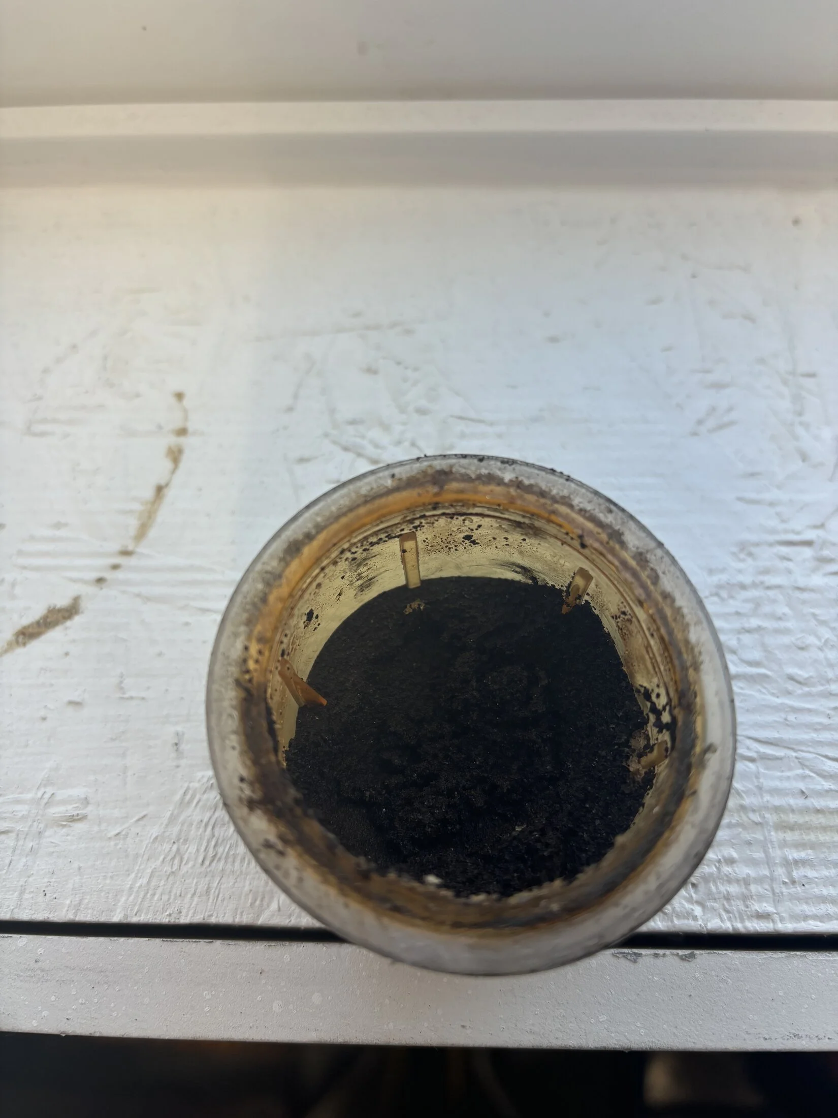

Out of curiosity, I cut the fuel filter open. I guess one of my next projects will be dropping the tank. This one had the recall done.

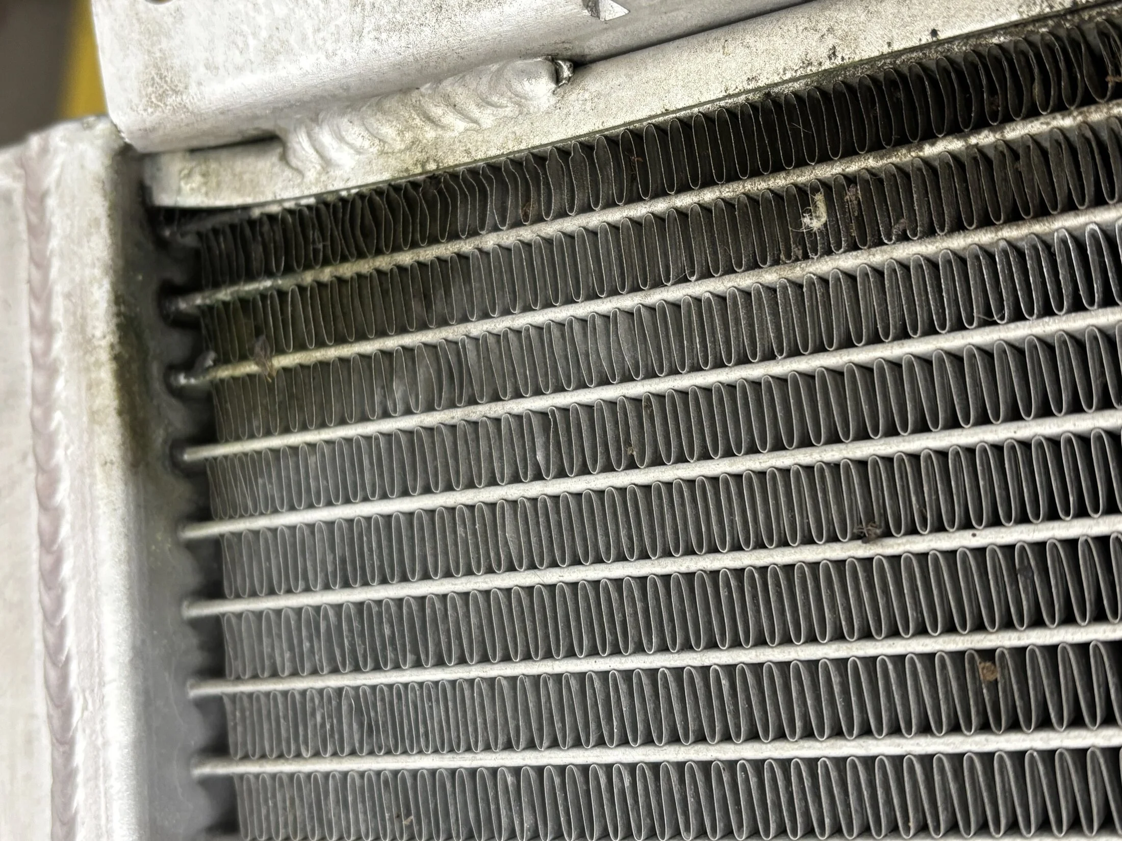

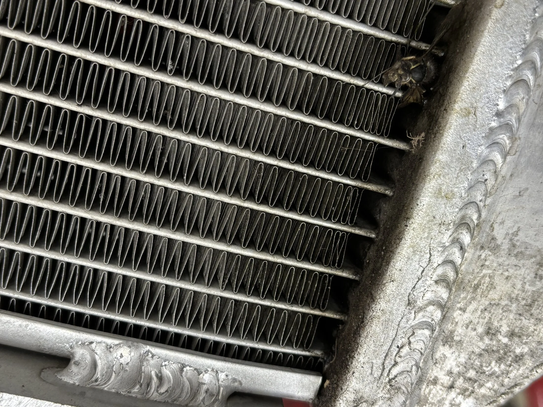

Also noticed my Mishimoto radiator has a small leak. Will see how their warranty is.
I just went through the warranty process for my Mishimoto on my 83 FJ 60 with them ( only 3 years old). Was pleasantly surprised with how easy and quick it was, send in a few pics of leak, copy of receipt and one week later new radiator was shipped. So hopefully yours goes as quick and easy as mine.
I bought this one new, but from someone that didn’t use it so don’t have the original purchase receipt. I called and they said at best they’ll replace it free, at worst the replacement will be steeply discounted. Waiting to hear back after I sent pics.
Mishimoto will cover half the replacement cost of new, ends up about $375 for me to get the replacement. Pretty sure I’ll go through with it, then try to get this one fixed so I have a spare.

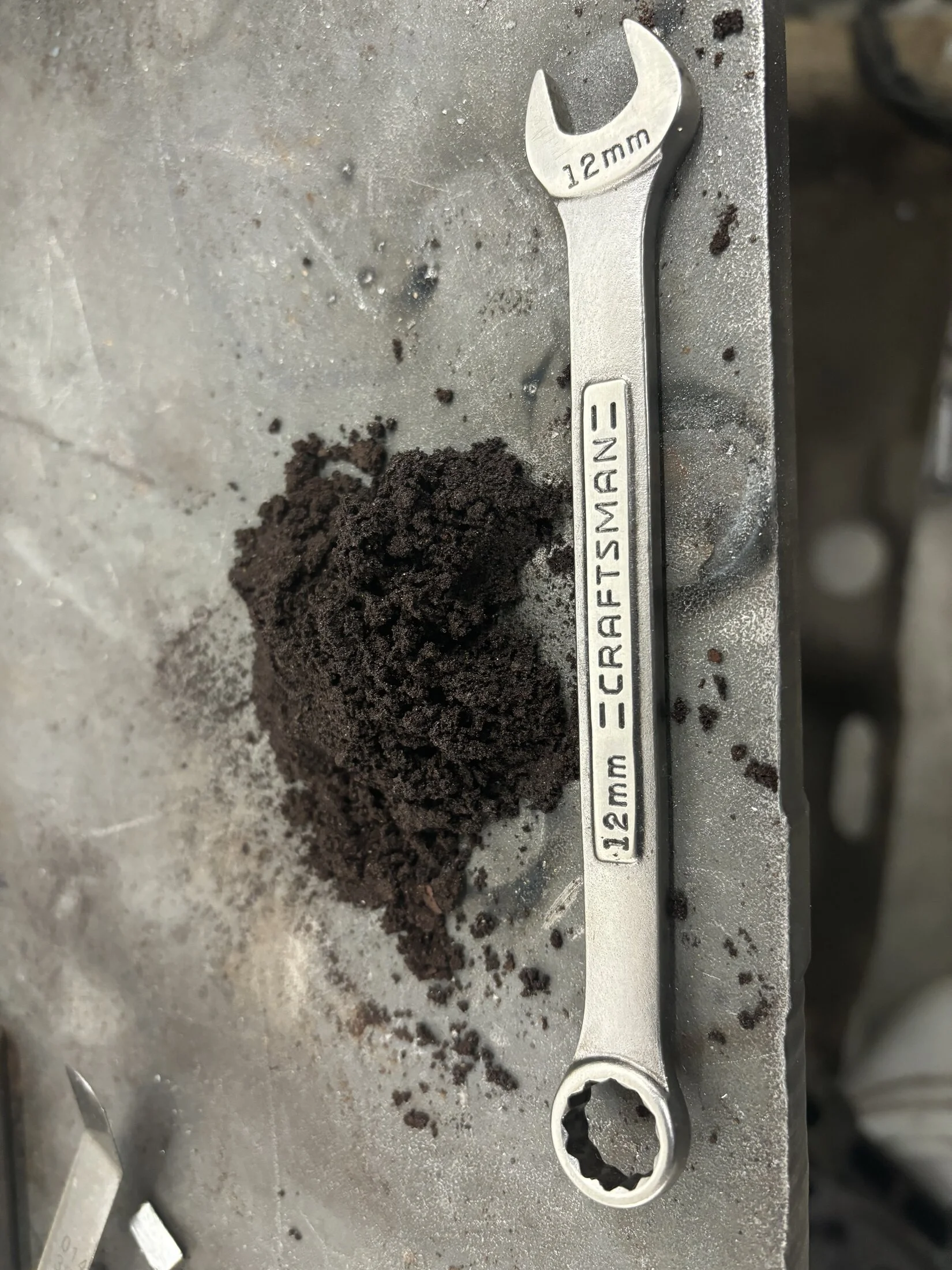

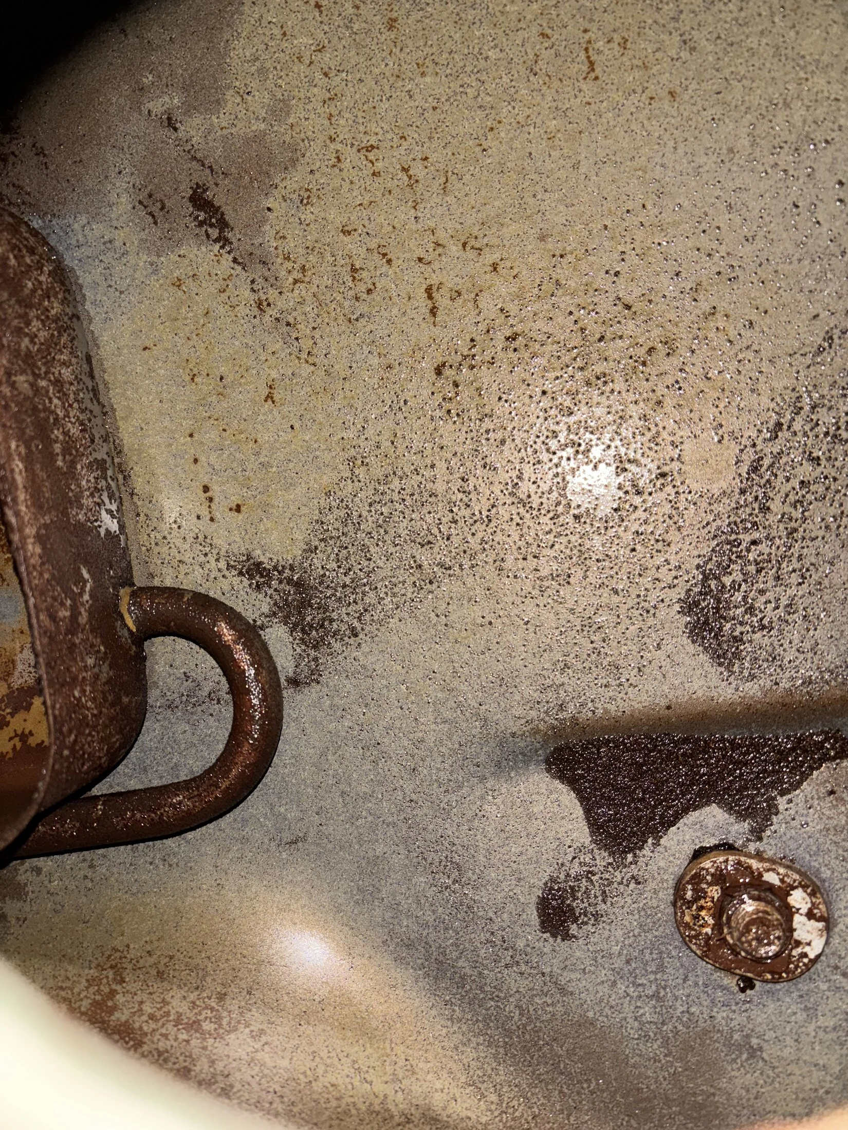

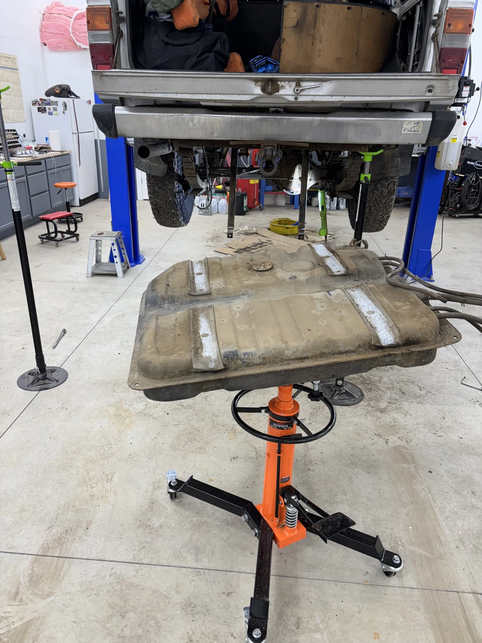

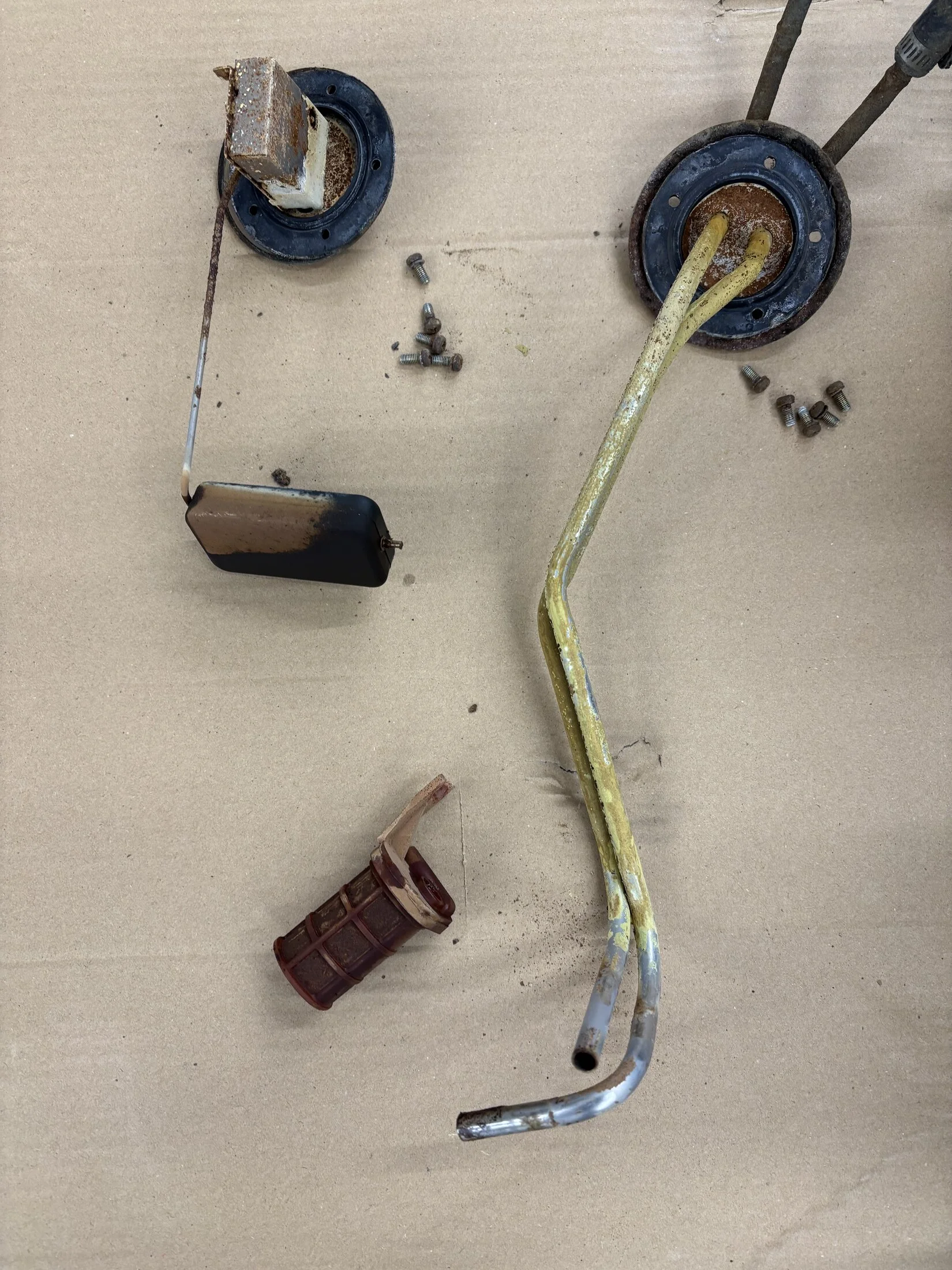

Got the tank out and there’s a lot of sediment in there. This did sit for more than a decade with 1/4 tank of gas.

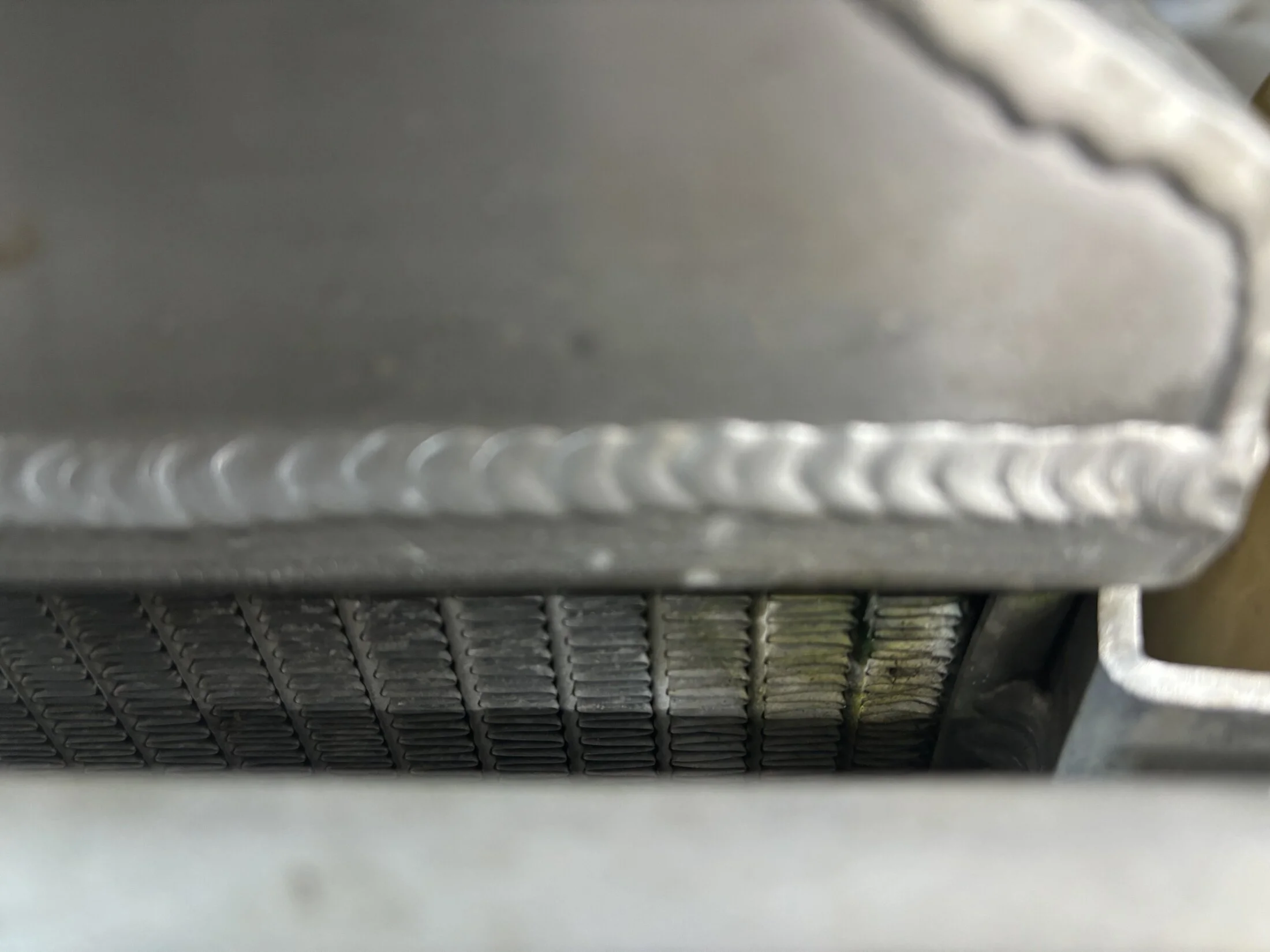

Radiator is out and new one ready to go in. Looks like maybe 2-3 leaks where the tubes meet the top tank.

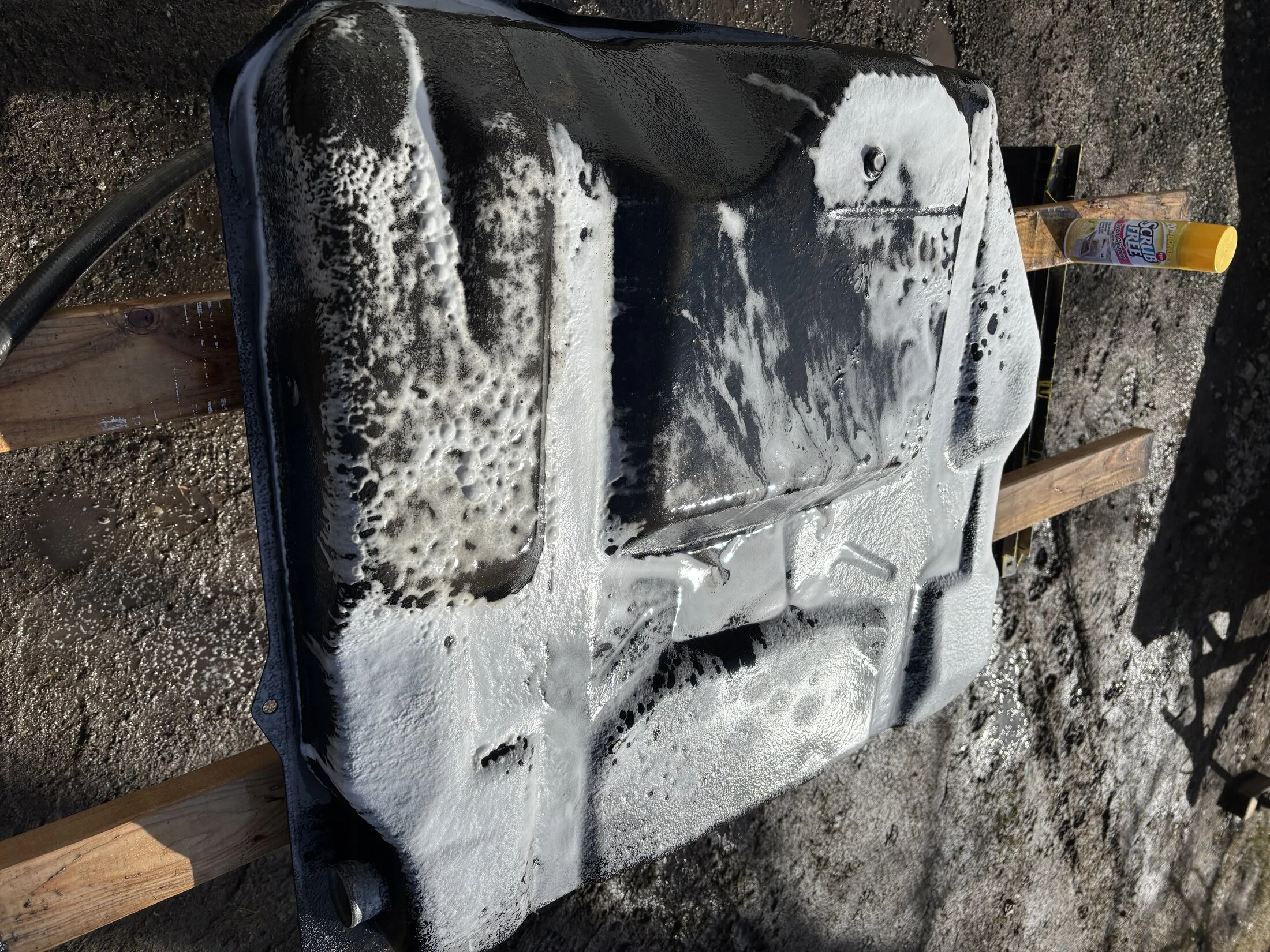

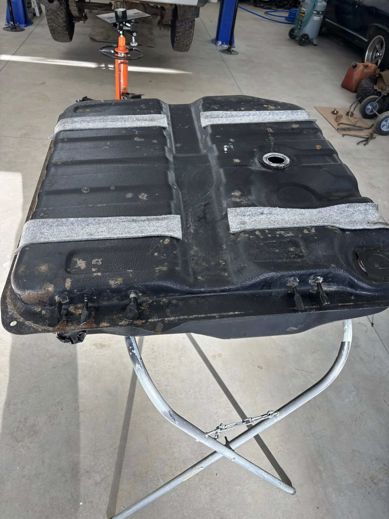

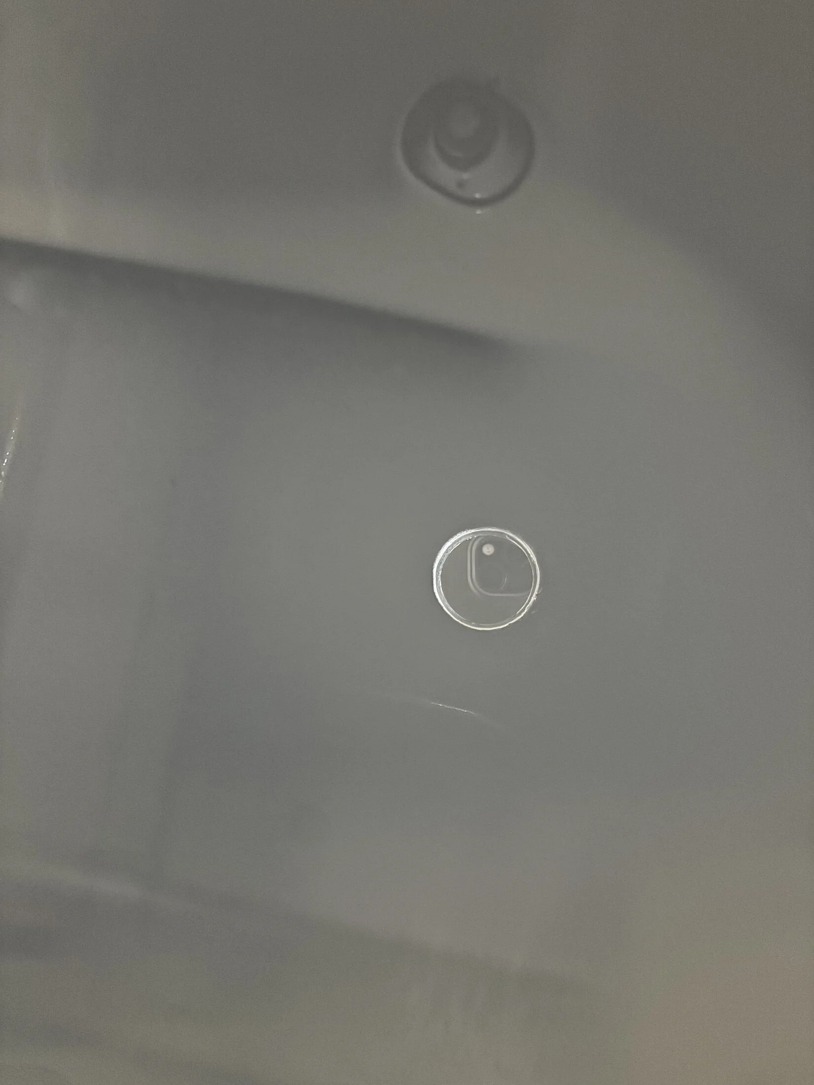

Today I did the Eastwood tank sealer kit for the gas tank. Took a big chunk of the day but it’s done. I’ll get the tank back in next week. Some nasty stuff came out of there. @helimech came by and supervised while we discussed how his Viking ancestry must’ve come from a taller part of Norway than mine.
Cleaned the outside of the tank with the best oven cleaner the dollar store carries!

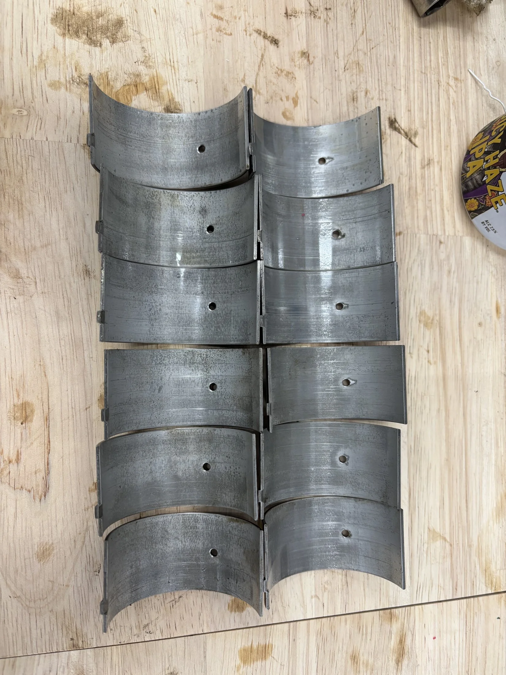

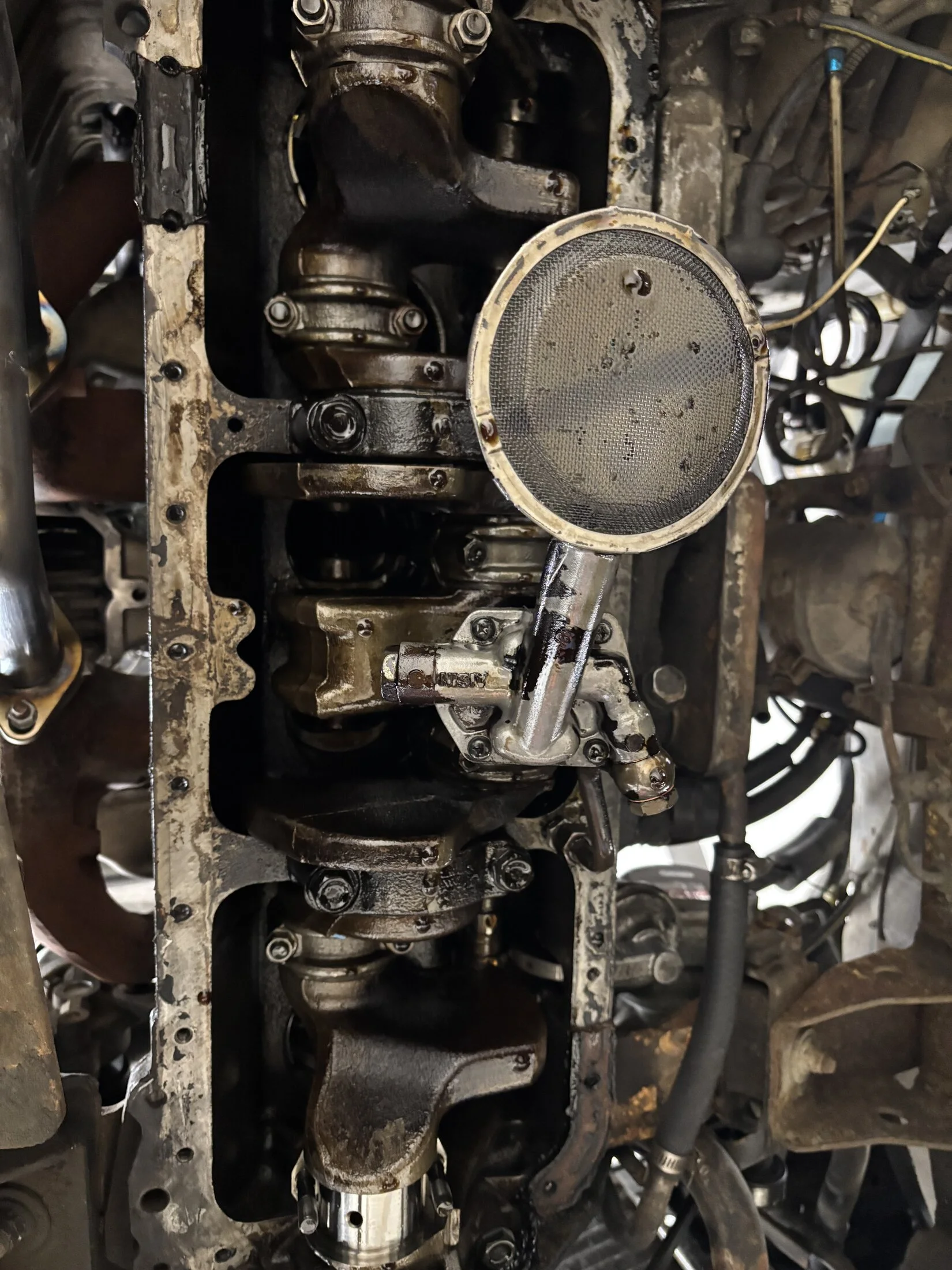

Since I did my head gasket I’ve heard an extra little rattle in the engine. Adjusting the valves again quieted most of it but at partial load there’s just a little tick that wasn’t there before. I pulled the pan and one rod cap to measure my journals then saw @Pitter Patter had some stock rod bearings for sale so I snatched those up and swapped out all the bearings. None look “bad”, but they don’t look great. None of the crank journals had noticeable wear/scarring. Checked all 6 with plastigage and they were all still on the tighter end of spec. I just need this thing to keep living until fall when I plan on swapping in my 2FE I’m building. If the noise is still there I’ll surmise it’s fine: been over 1000 miles with it and it hasn’t changed.
This pan has been off before I owned it and there was so much rtv on the gasket. Big globs of it were in the oil pan along with lots of sludge. Cleaned all that and hammered the flange straight and ball peened all the bolt holes back from being recessed toward the block.

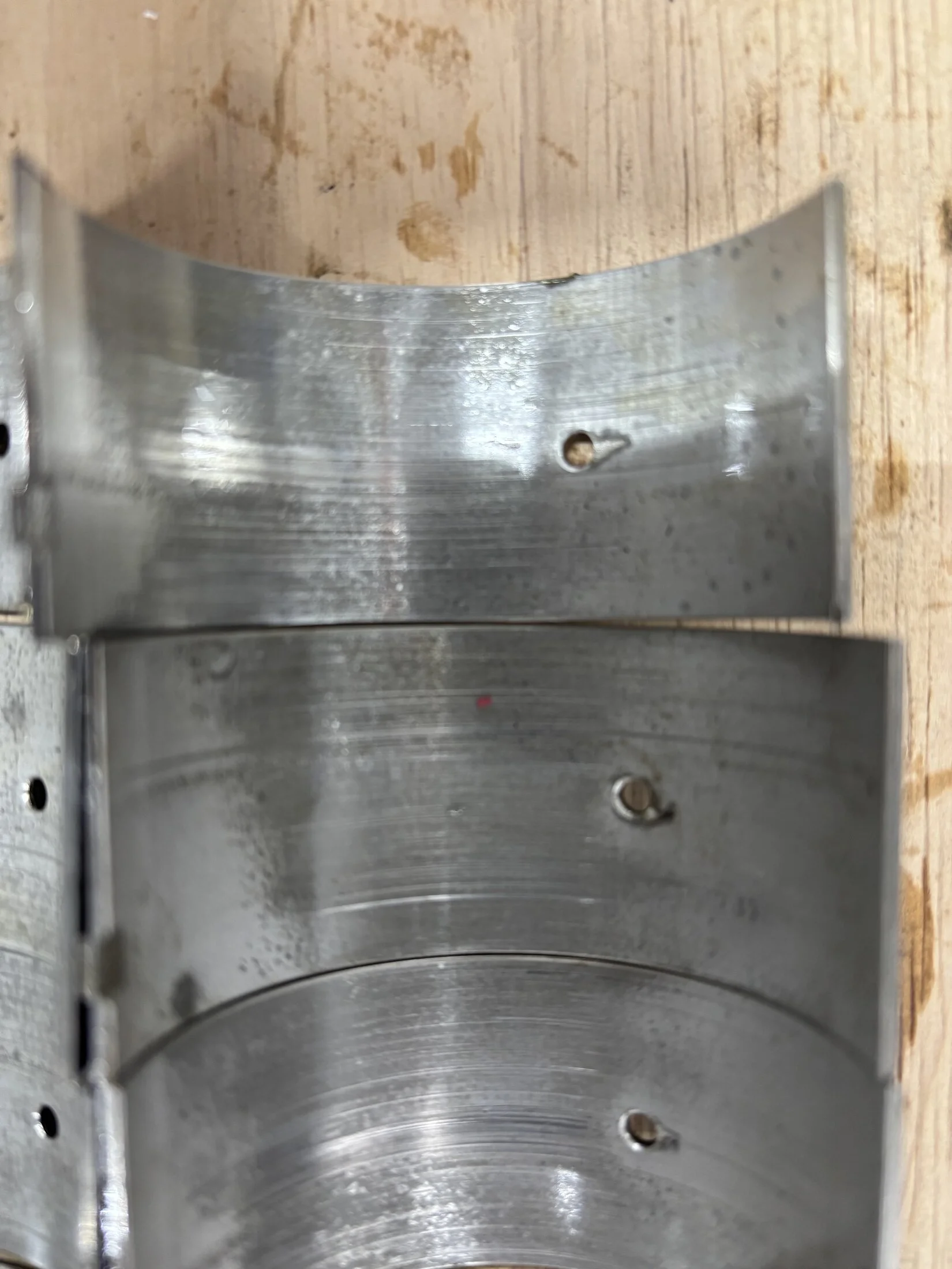

All the rod side bearings had this point at the oil hole where bearing material was gone. Most of the cap sides looked really good with wear concentrated on the rod side.
