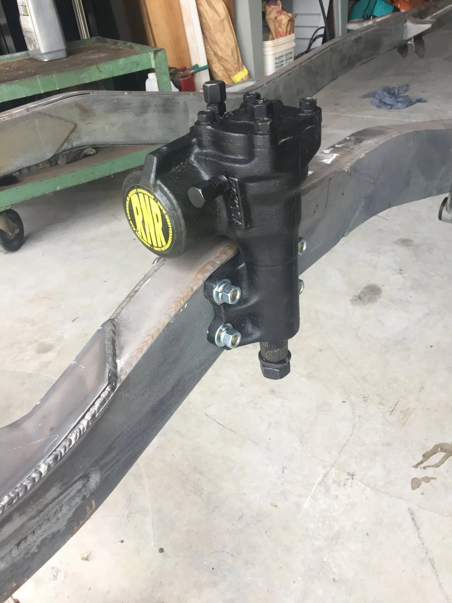

Got my 60 box from West Texas Offroad and mounted today with new hardware, very good service and quick with sending it way south. Had it rebuilt and ported for hydraulic assist later. Was going to get the springs mounted and found out I will need to get some bushing machined from my friend Gerald a small job but while it is apart need to do it right. The 60 box looks good sitting there things are finally moving forward.

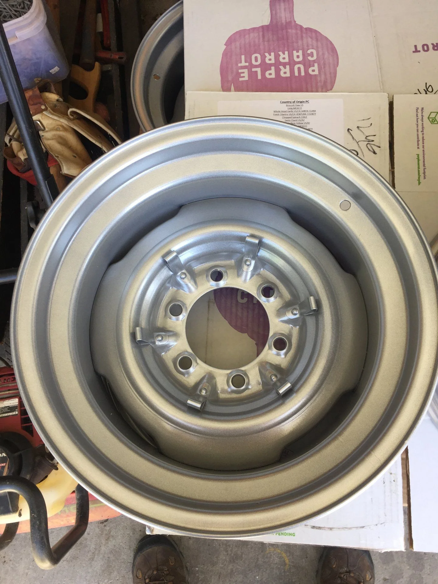

Got my 2 set of 5 wheels today. One set are 17” and that is for my 35. The other set are 16’s and are for my 45. Both were done in gray metallic and from the color chip it was a close match to the Toyota gray however it had a bit more silver metallic than I hoped for.
Anyhow the job is top drawer and fits the bill just fine for me. Check off another thing done. The first rim has a 17” barrel center is from split rims, the second is 16” barrel and will go on my 45. Now the job of deciding on tires another job in it self. 33” on the 45 and 35”s on the 35 both will be narrow, I like the look.

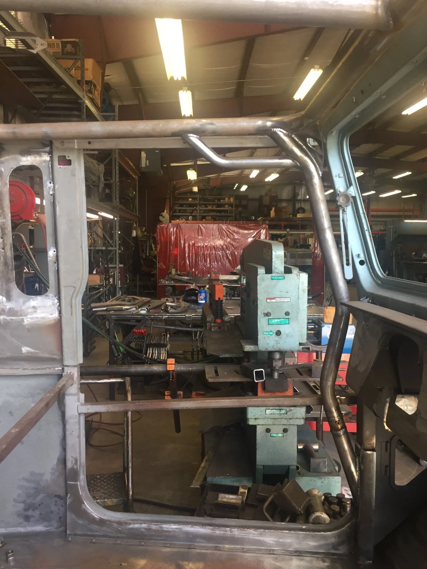

Roll cage is coming along nicely, will need to get my seats before we can complete it. Tubing will will need to be constructed to support the seats however you get the idea of what it is going to look like.
Looks great Skip, had a cage in my big green 45 with the same grab bars! They are so nice to have getting in and out, and a great oh s*** bar!!

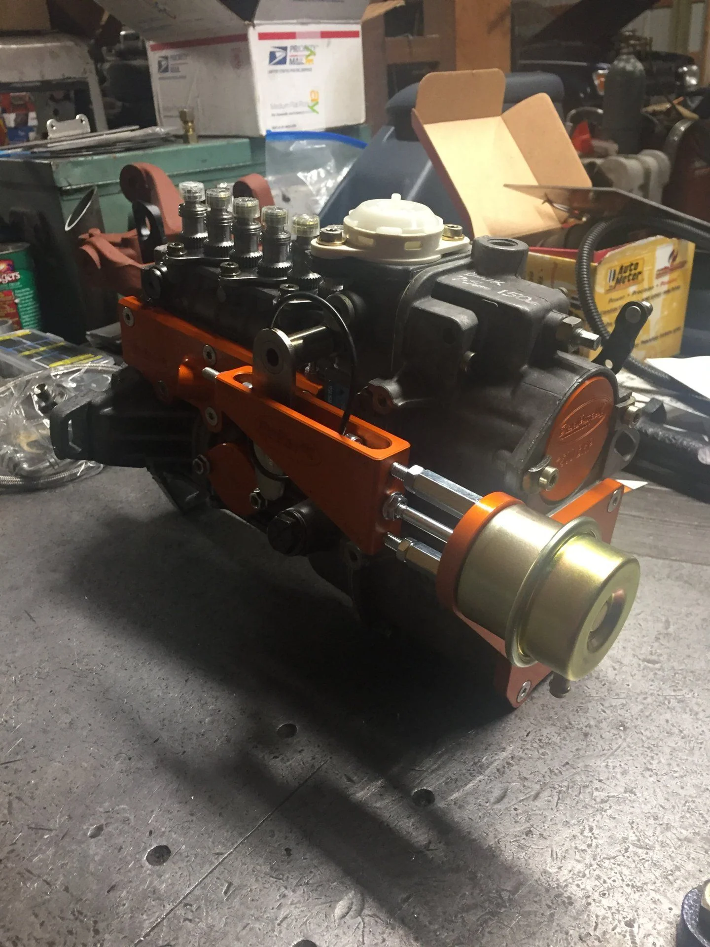

In the above pic is my M 303 pump. It will go on my 606 it has 7.5 MM elements along with the

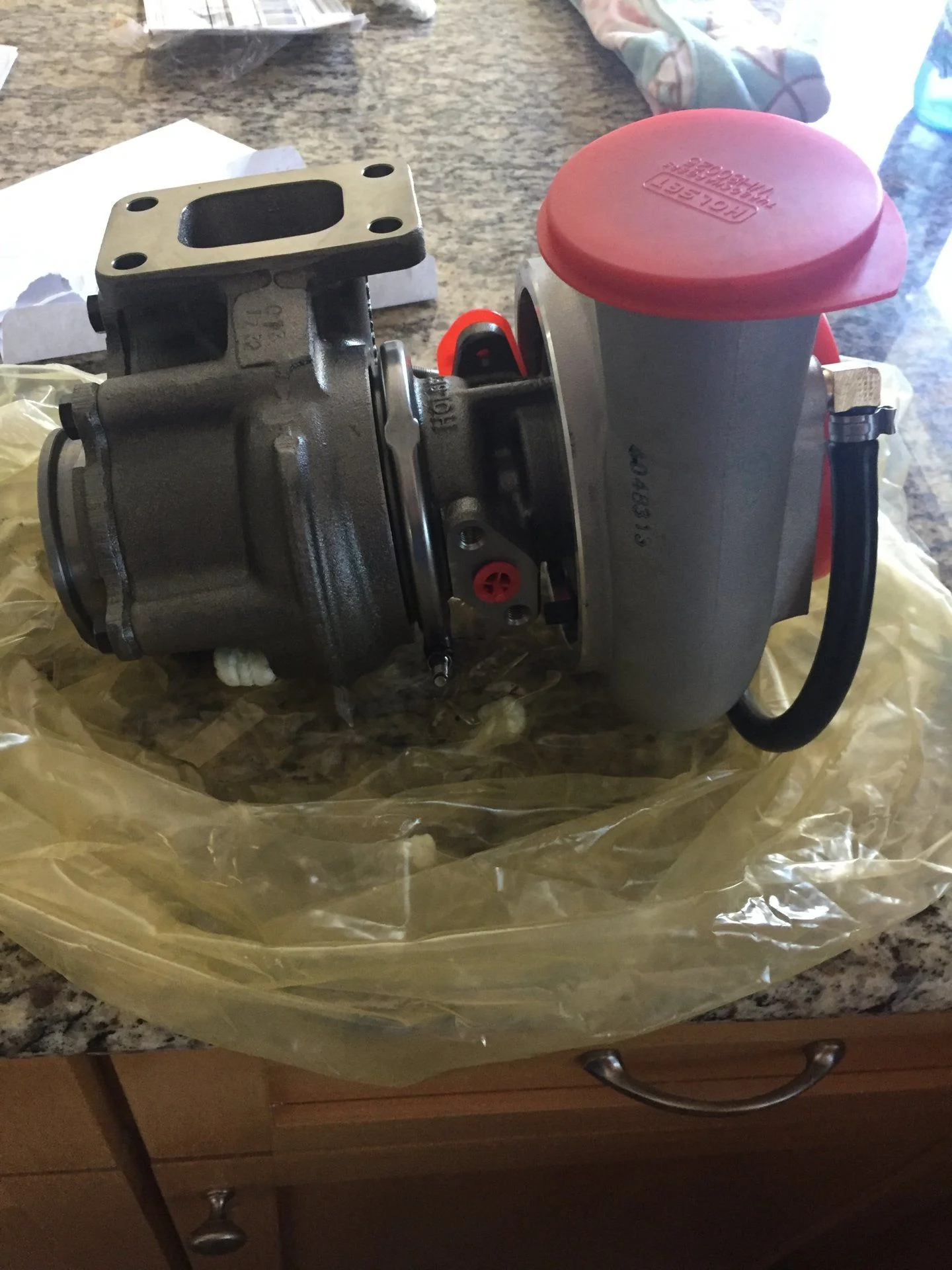

EU diesel pump who also rebuilt it. Great people to deal with across the pond. He uses Diesel Meken custom elements. Also coming is a super HX30W a quick spooling turbo well into its boost at 1600 rpm, great for us rock crawlers. As soon as it comes in I will post pics and go into it deeper. This turbo is hard to find and it came out of Canada.

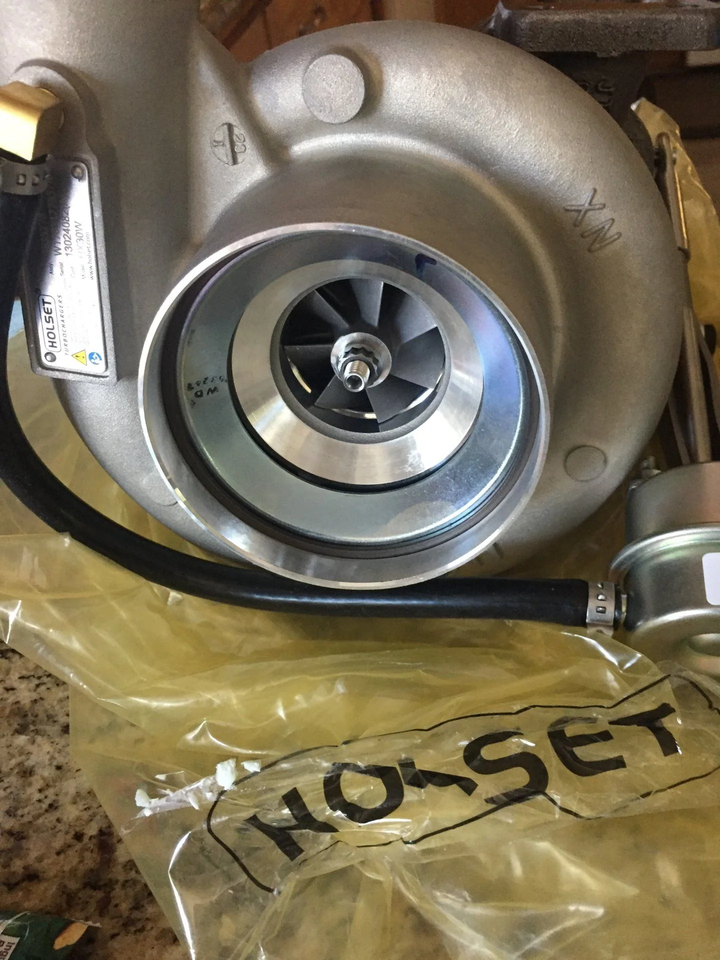

Yes it is a Holset Hx30W a mid range puffer to give me an honest 275-300 wheel HP things are coming together. In the next few days I go get the tub from Luke at 4x4 Labs here we go.

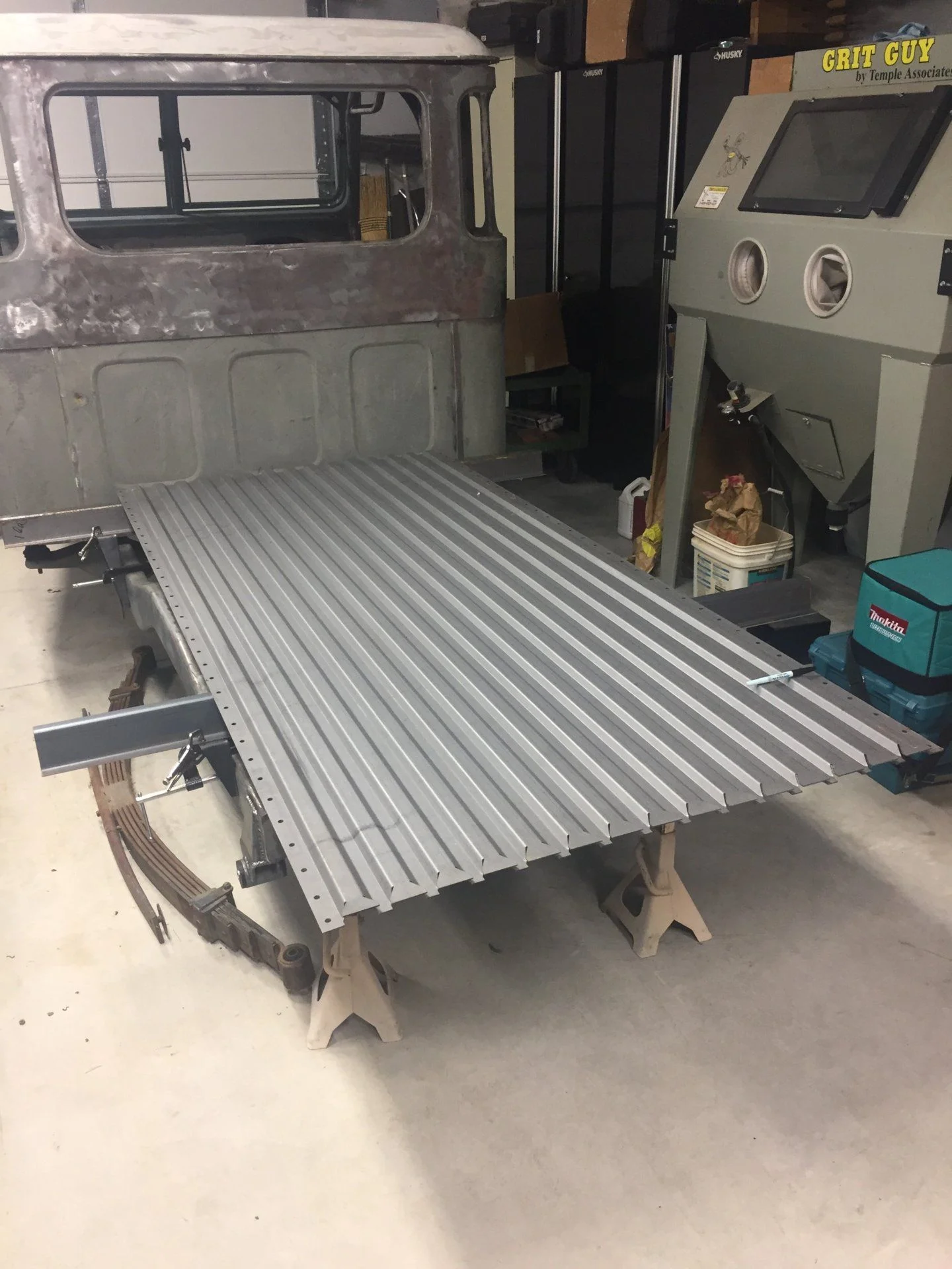

View attachment 1724266 Starting to lay out and get measurements for the floor. First need to get the right height as it sets now I am about 1.5” low easy fix as the brackets below are not welded yet. However need to get the foundation right or no cegar to coming out right. Bed will be aprox 68” long and stock all other measurements.
I just put an HX35 on my 6.5 diesel Suburban - did you know that if you remove the intake ring, you get more whistle. I know, to someone who's a grownup that doesn't mean much; but there are some to whom that whistle is sweet, sweet noise.
Ya I do like the whistle whine complement’s a 3” exhaust throaty roar, do we ever grow up.
