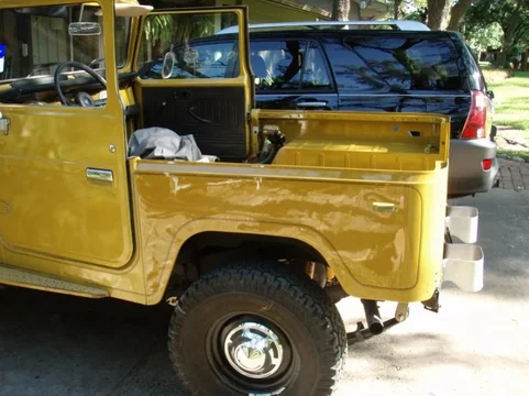

Here is my tub and rear quarters after sill replacement using PPG single malt, I mean stage. The color was so much richer than the original that I'm locked into doing the whole truck now. Just need to finish a couple of things to clear space in the garage, hoping to do a lot of the disassembly and prep to cut the cost.

Thanks Mustard that looks amazing actually...as if it is a polished two stage.
What sort of work will be involved keeping it that rich? Do you foresee more upkeep in contrast to a 2 stage job?
Single stage has come a long way.

I'm told it should be no more that the occational wax. The paint was not as opaque as expected when it went on so it took several shots to get the coverage, but I think that is part of what adds to the appearance. I took it to a custom shop around the corner and can find out what PPG single stage paint it is if you need it.

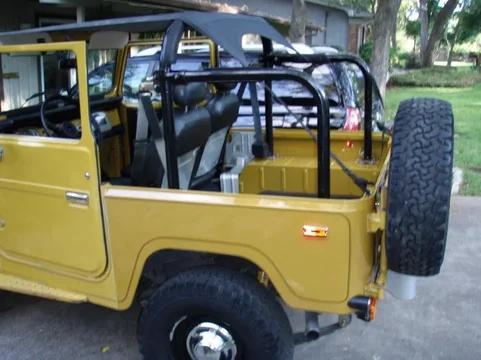

I just sprayed Nason's Ful-Thane on my '78 40 and am pretty impressed with it. I've always used base/clear coats in the past, this is my first project with a single stage urethane. This stuff lays down easy and covers great.
hopefully the attached photo will load..

Interesting, and thanks for the pic fj40mike.
