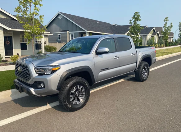

Much to @gnob's despise of model; we have a Toyota again :P
Had 10miles on it, but the :princess: had to buy and pick it up in KFalls ;)

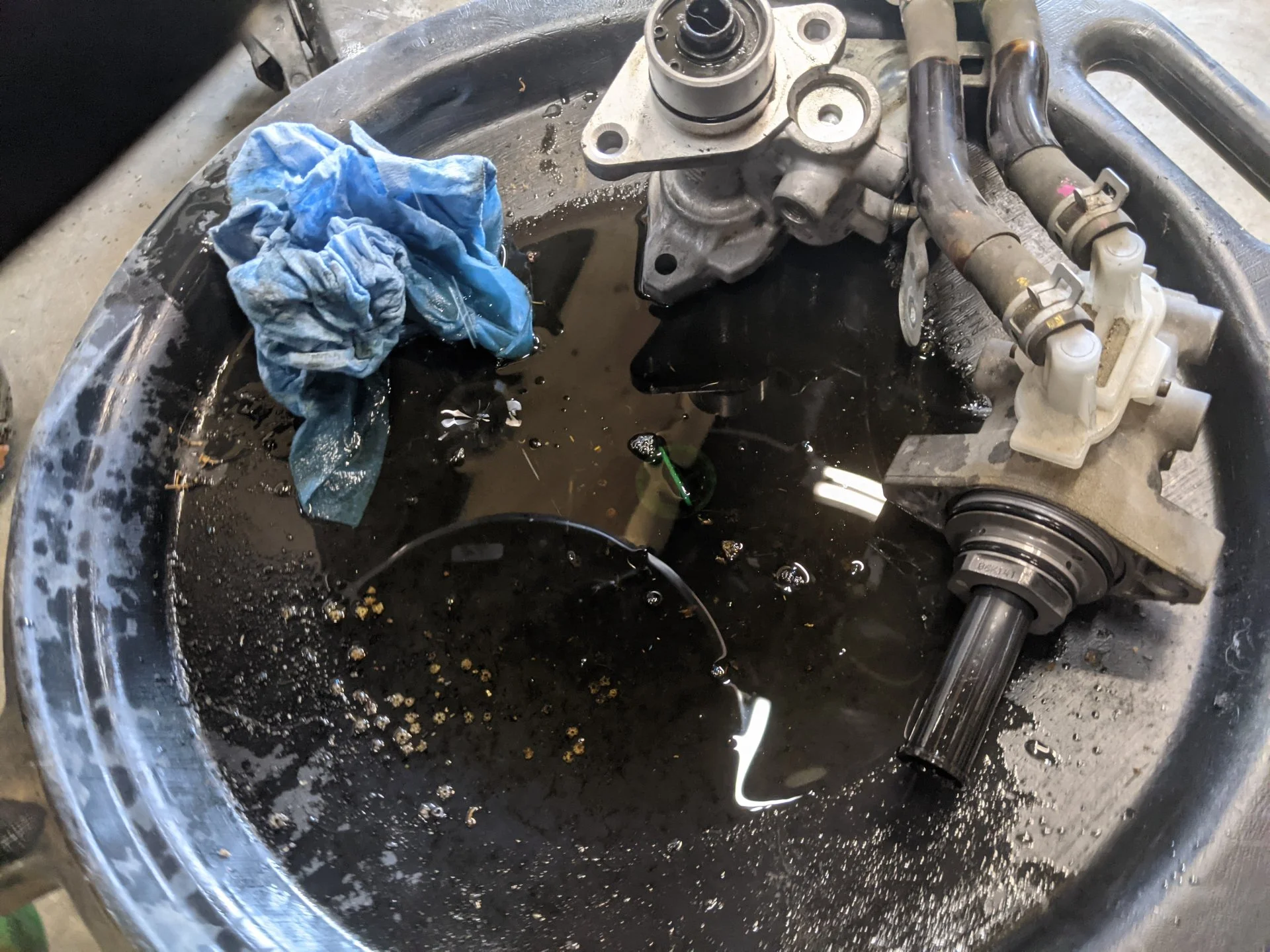

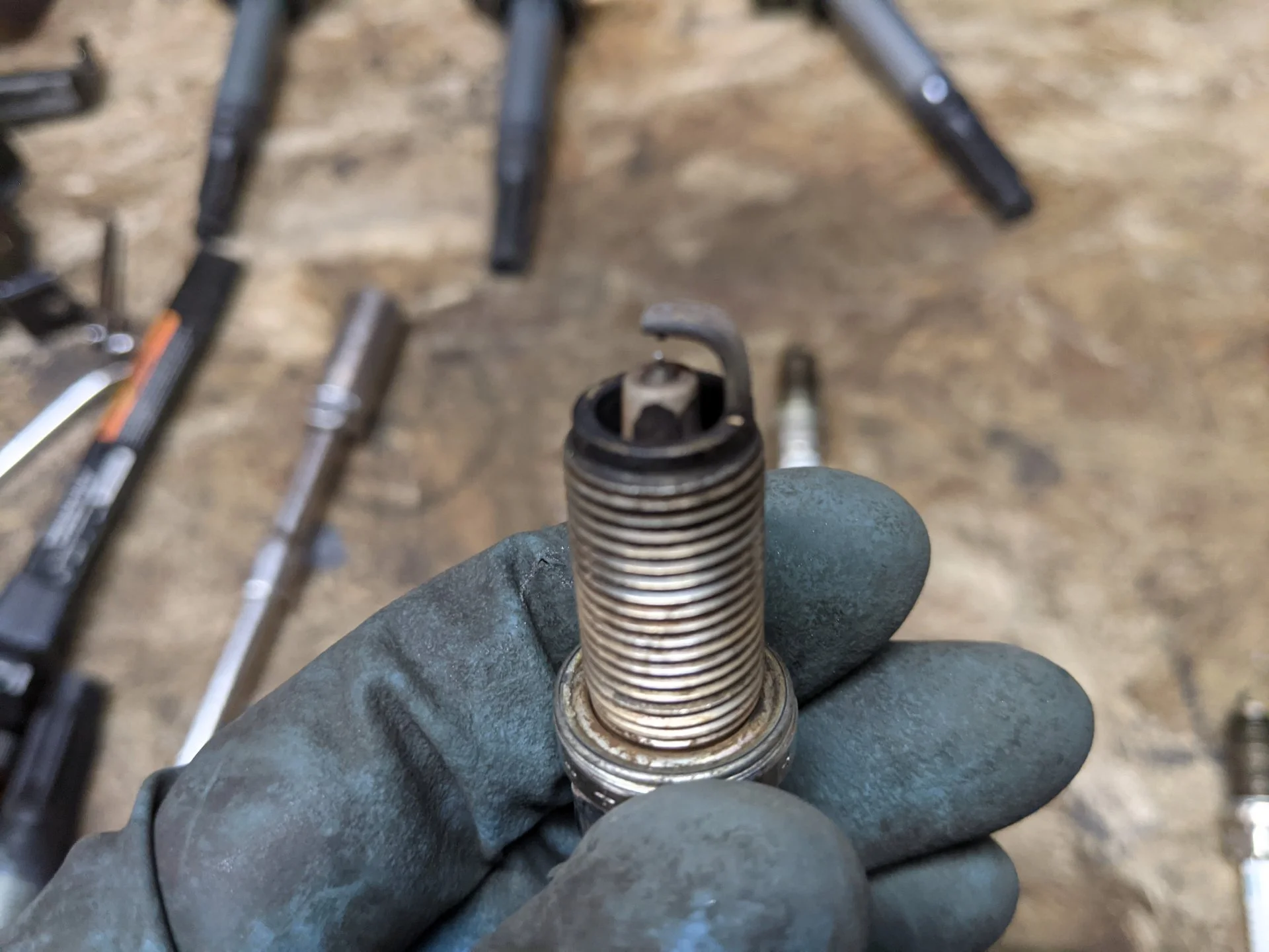

This is for the sake of people who actually search. My 2007 sienna van has had a misfire issue since before i bought it. Previous owner and several shops threw a bunch of parts at it including an ecu.
It also has had shyt brake pedal feel. I finally decided to try and fix the issues. Brake bleed did some weird stuff. Did spark plugs and found some contamination on one.
After the brake bleed i noticed an unexpected drop in brake fluid. No external leak. I did not think much of it and refilled the reservoir. Fast forward a couple weeks, ive driven the van a handful of times without issue.
Go to drive it the other day. Brake light on, brake res is almost empty.
Tear down today found bad booster and master had been pulling brake fluid into the engine causing the misfires.
So if you have a toyota sienna with unexplained misfire check out the booster.
And in my typical luck, i have to eat oem cheddar because the MC is actually two pieces and only one is available aftermarket.
Failed brake booster and master cylinder causing engine misfires. This is likely on MZ powered siennas as well. 2GR-FE misfire
Nice job figuring that one out. Strange for sure. Is that your gold pan? Seems you do well out panning 😆

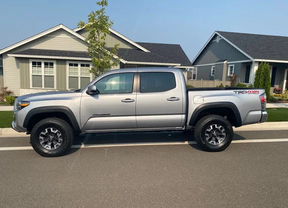

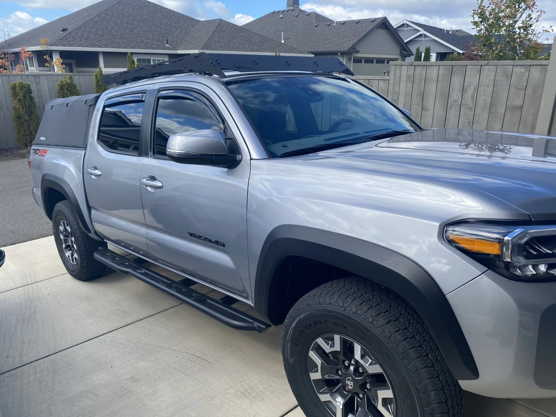

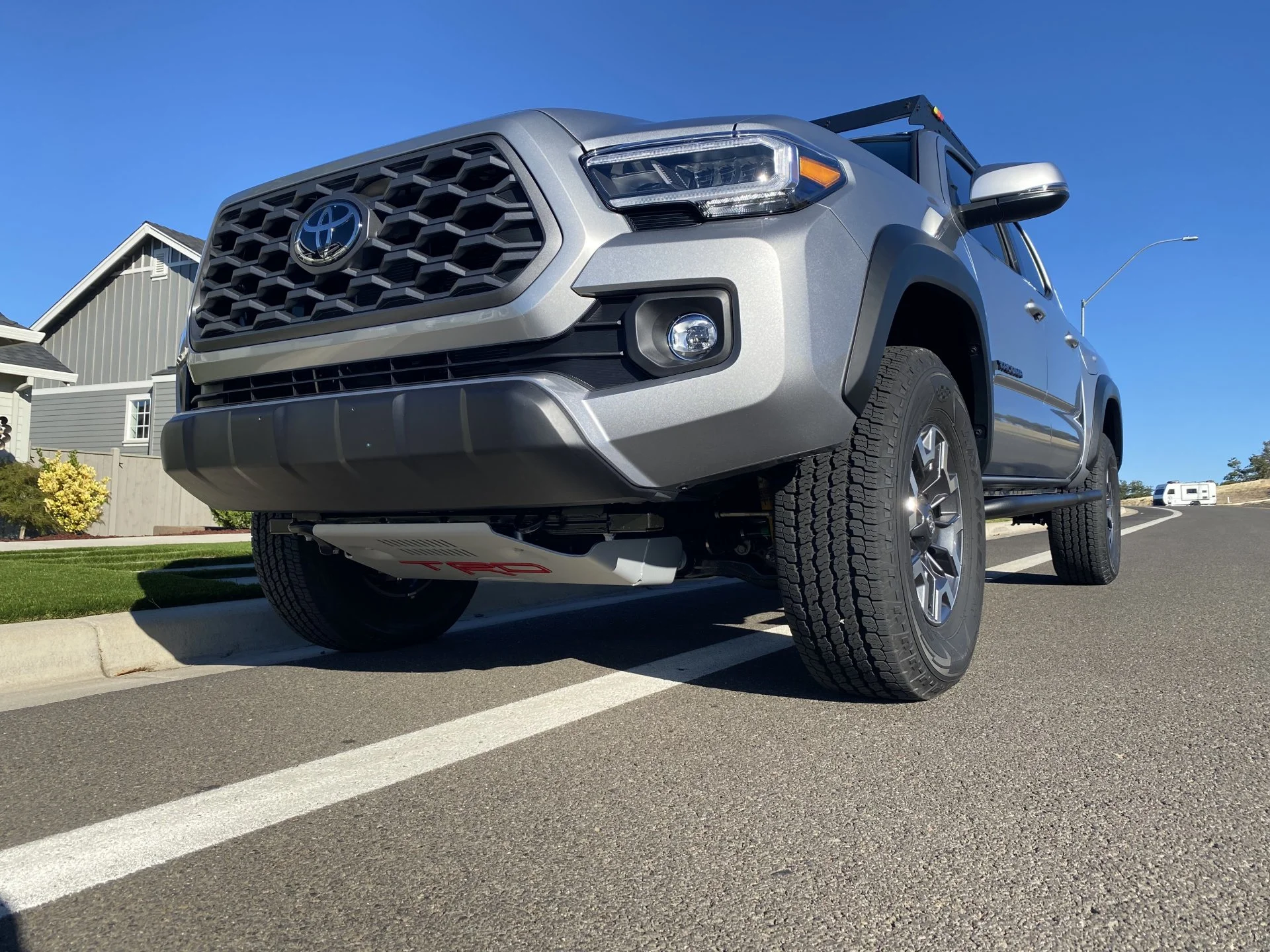

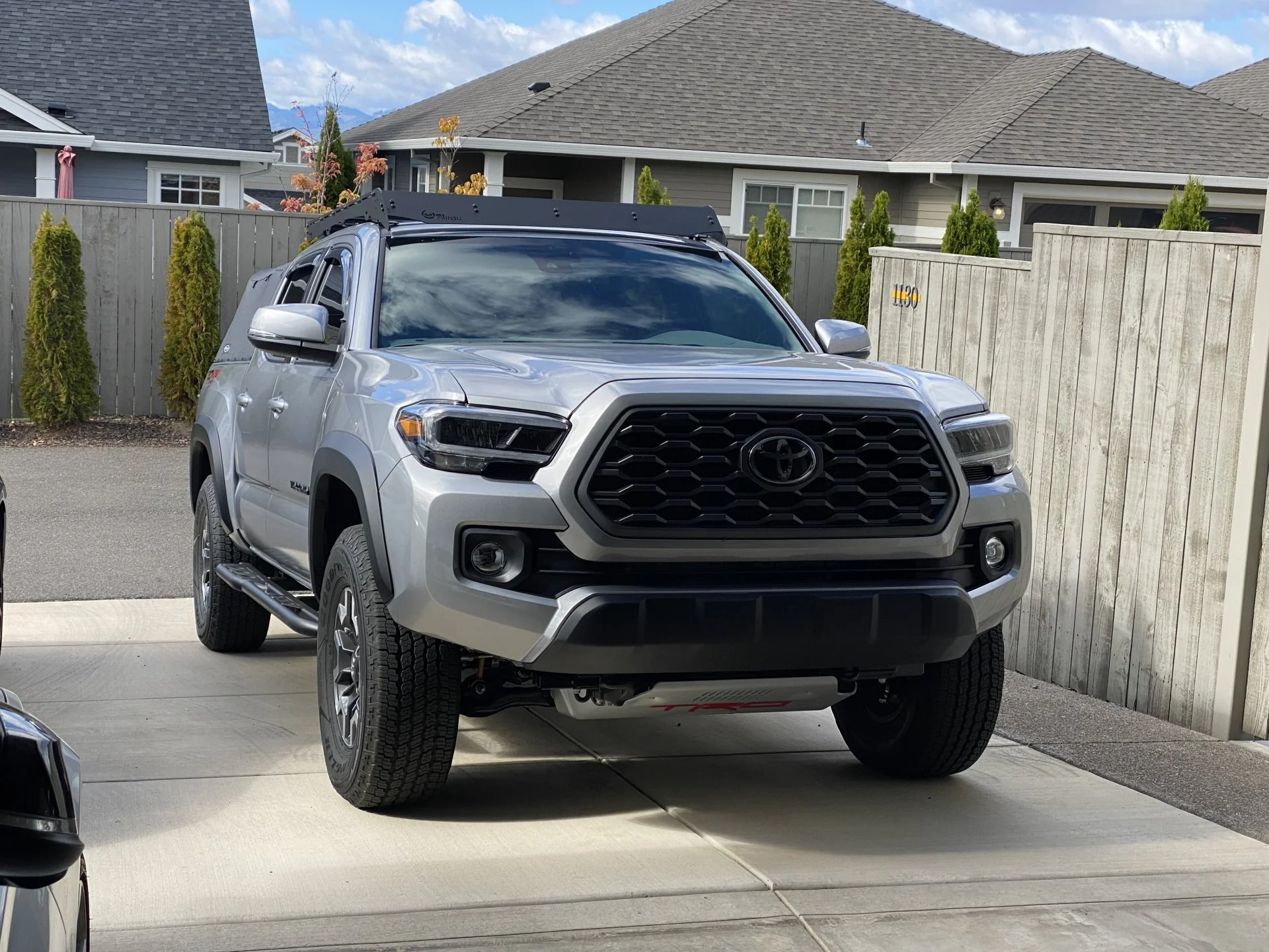

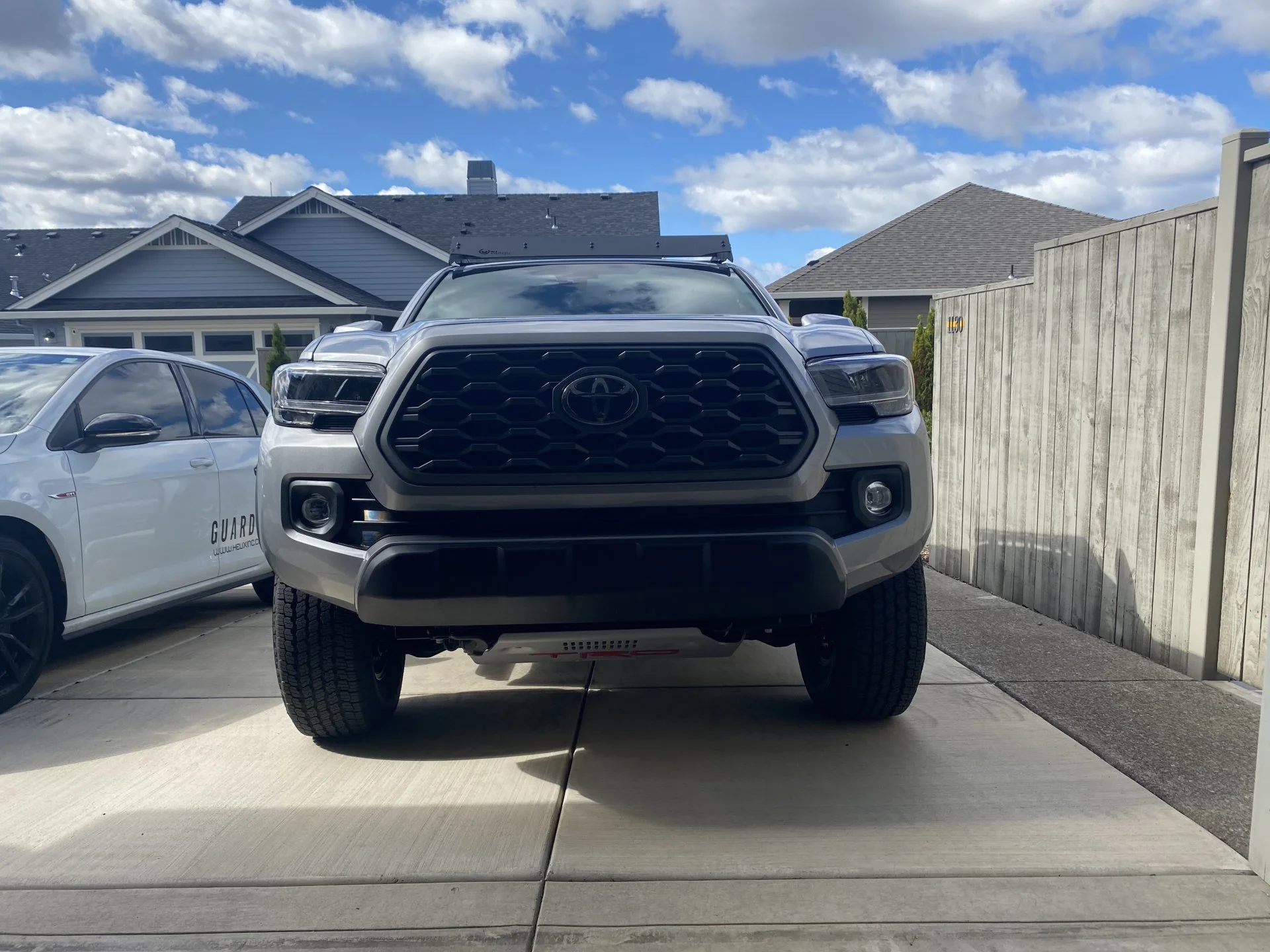

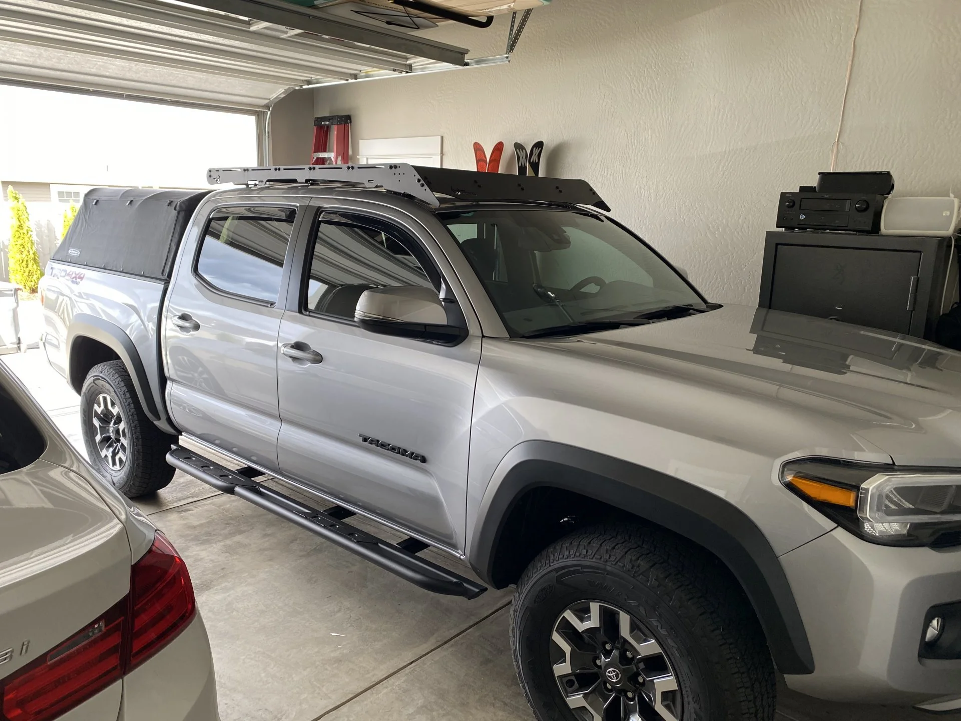

Nice, congrats (little late I know). Let me know if you want any of the looking into add ons. I've done a minimalist winch bumper and still debating the roof rack but done a bunch of little things.
Got some basics done. 2/1 lift is the last thing for now. :) and tyres.
MetalTech sliders
Prinsu rack
AVS rain thingies
Softopper
Clear protect and ceramic coating
OEM TRD skid.
