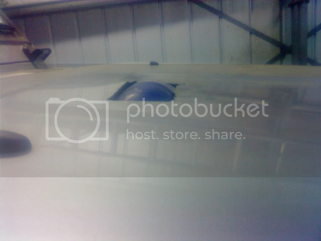

Can clock it to anywhere, that was the best position I found, the barrel could not be clocked down any more, hits the rocker cover. As it turned out this position worked pretty well, the waste gate bolted pretty much straight up.

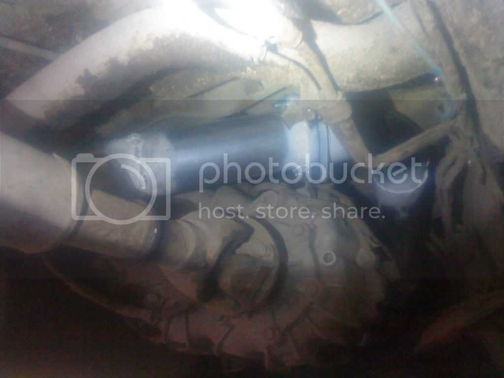

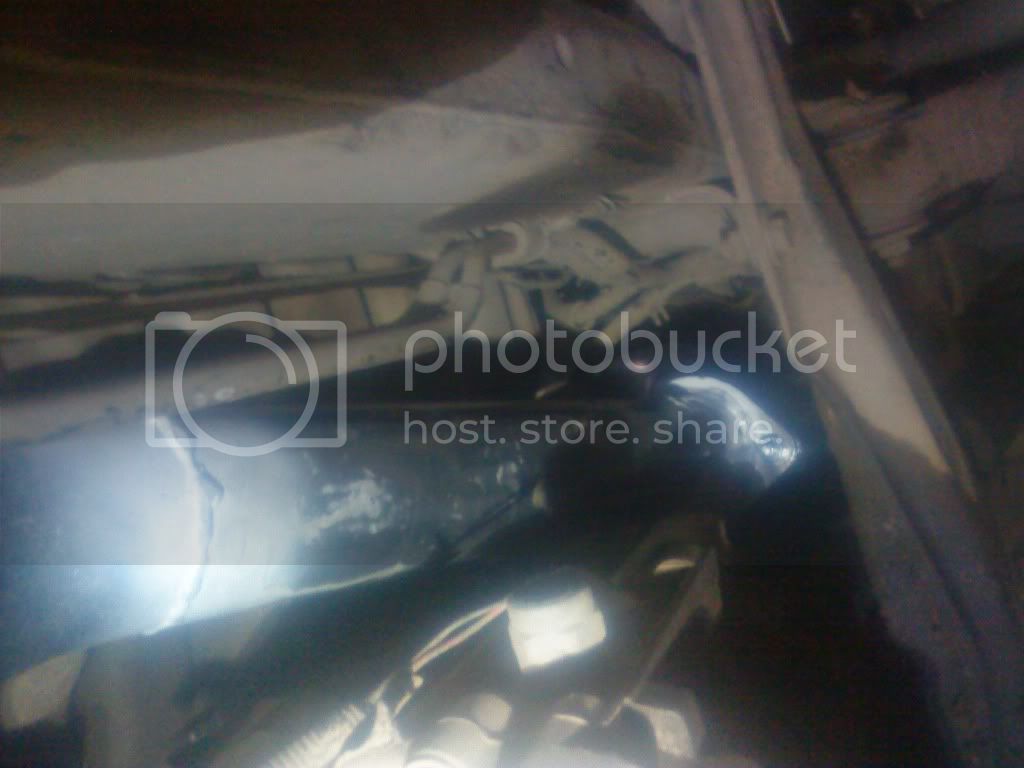

Cooler is mounted, waiting on pump to arrive and need to order a radiator. Exhaust and some heat shielding is done, have driven about 100km with no problems or melting of stuff. With the 3'' system the car feels more responsive and boosts harder up top. Previiously I would only get the overboost light coming on in 3rd gear at 3000+rpm with my 35''s tyres on, full load and up a BIG hill, and it would only flicker on. Now I can get it glowing full on in 3rd-4th gear easily on the street with 33'' tyres on. Some pics, it only is JUST out of the bonnet, have tidied it up now with some pinchweld do seal against.

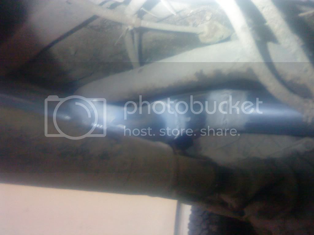

Was the first exhaust system I have made and I am really pleased with the result, was tricky getting the welds right though, not pretty but the work, best ones are holding the muffler on.
Hey mate the exhaust and cooler are looking sh!t hot.
