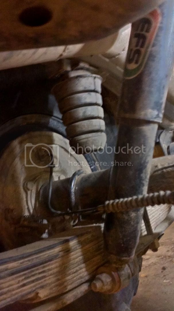

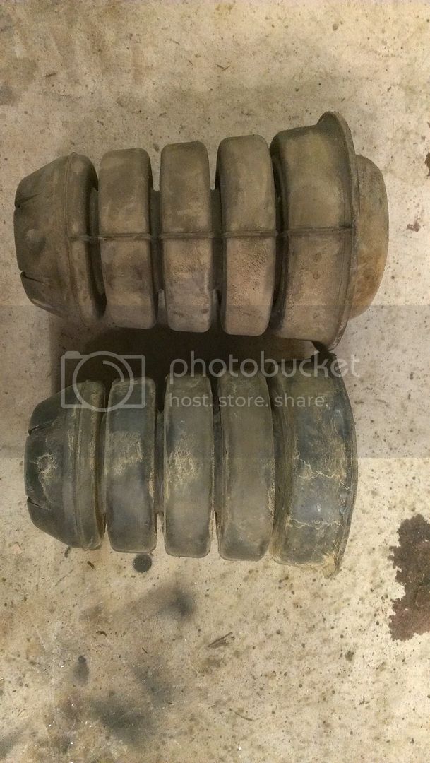

In between all the drives I do alot of work on the car to keep it reliable and go faster....... Being playing with the rear suspension, changed out the late model 80 series bump stops for some early ones. The early ones are longer but softer rubber, hoping they are slightly more progressive.

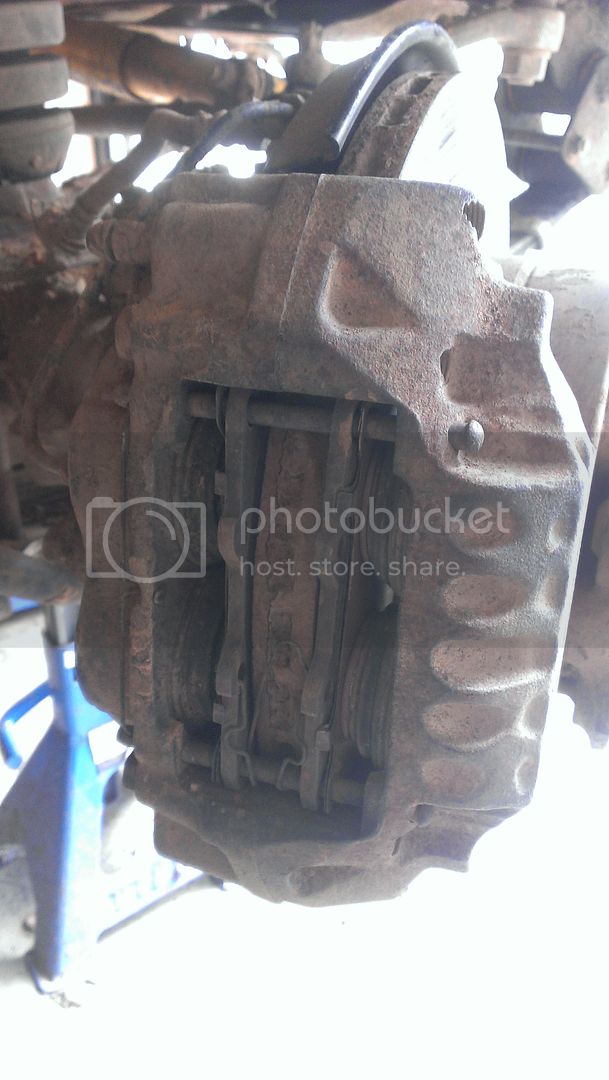

Got my moneys worth out of the old pads, discs still measure in spec so in for a new set. Trying these, which are GTR Skyline pads, according to my mate who owns a brake shop they should work well to higher temps and with more bite than my old bendix 4x4 pads.
Will do, I am not expecting them to last a long time, but hopefully have more initial bite and high temp/prolonged stopping power. Last set of Bendix only lasted 5000km. Next trip is the end of this month, had to fix the suspension, brakes and a pair of new batteries.
