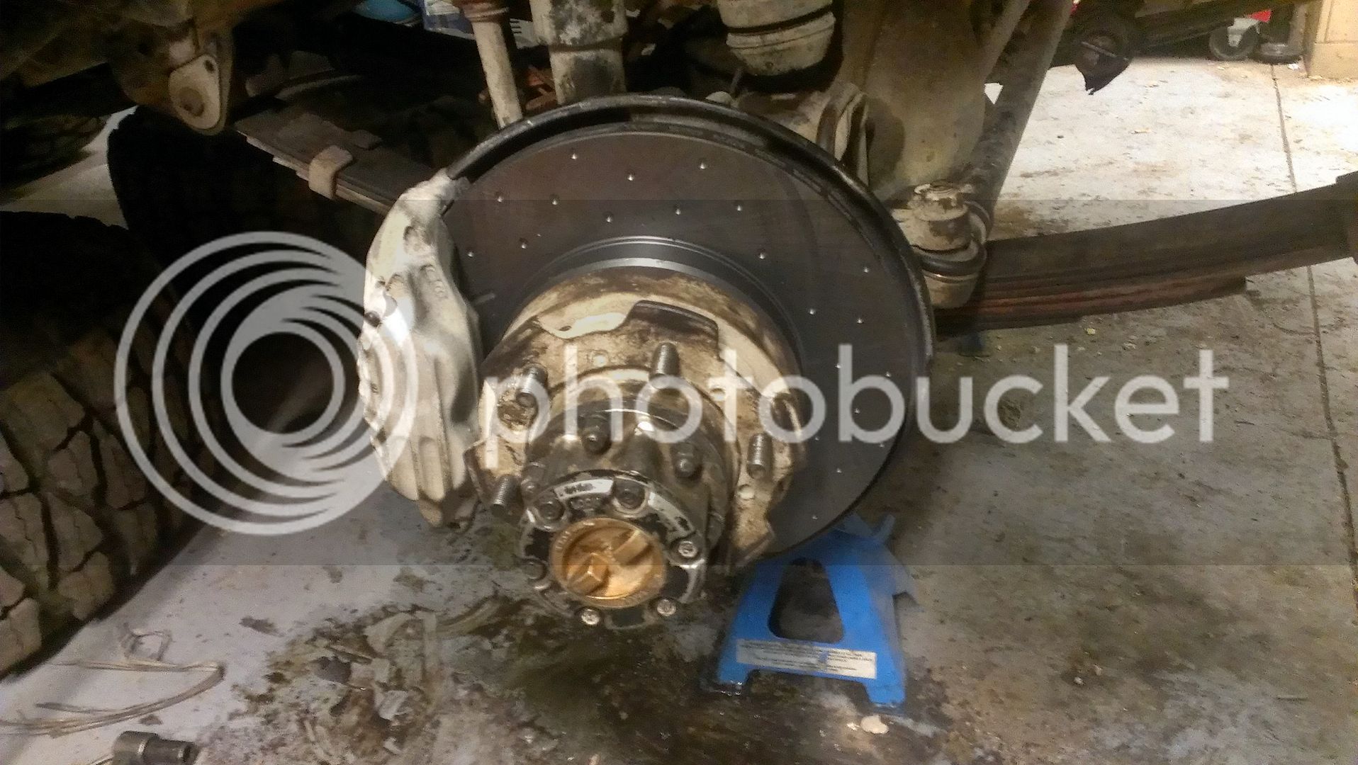

A bit of maintenance after the last trip, I noticed the brakes were not so good, needing a pump or two to work. I knew the wheel bearings were probably a bit tired, had been in there ~70,000km, I had greased them a few times. Started pulling things apart, hmm there was a lot of movement in the kingpins. Started checking stuff out, everything was pretty much at the end of its life before failure, nearly all the bearings fell apart when removed, brake rotors had just gone undersize and steering rod end needed adjustment.
Just last night finished rebuilding everything with new grooved and slotted rotors. Was pretty happy with the life of my kingpin bearings, lasted ~160,000km (was the diff assembly out of my old red middy that I first assembled in 2008). Bearings still functioned just very worn, felts and rubbers were still fine, no contamination of the swivel housing at all, grease was still fine which is great news since I run 35''s all the time with -57 offset.

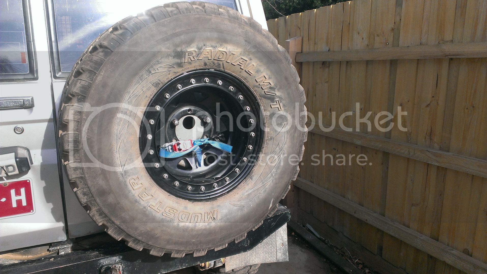

My daily has done a head gasket so is coming off the road to repaid, middy will be the temporary daily so I have given it a wash. Also got a new spare, old one was a 15'' non bead locked tyre which was a bit suss, picked up a cheap muddy to do on my spare rim. Normally have a 1.5kg gas bottle in the middle for my cooker.
