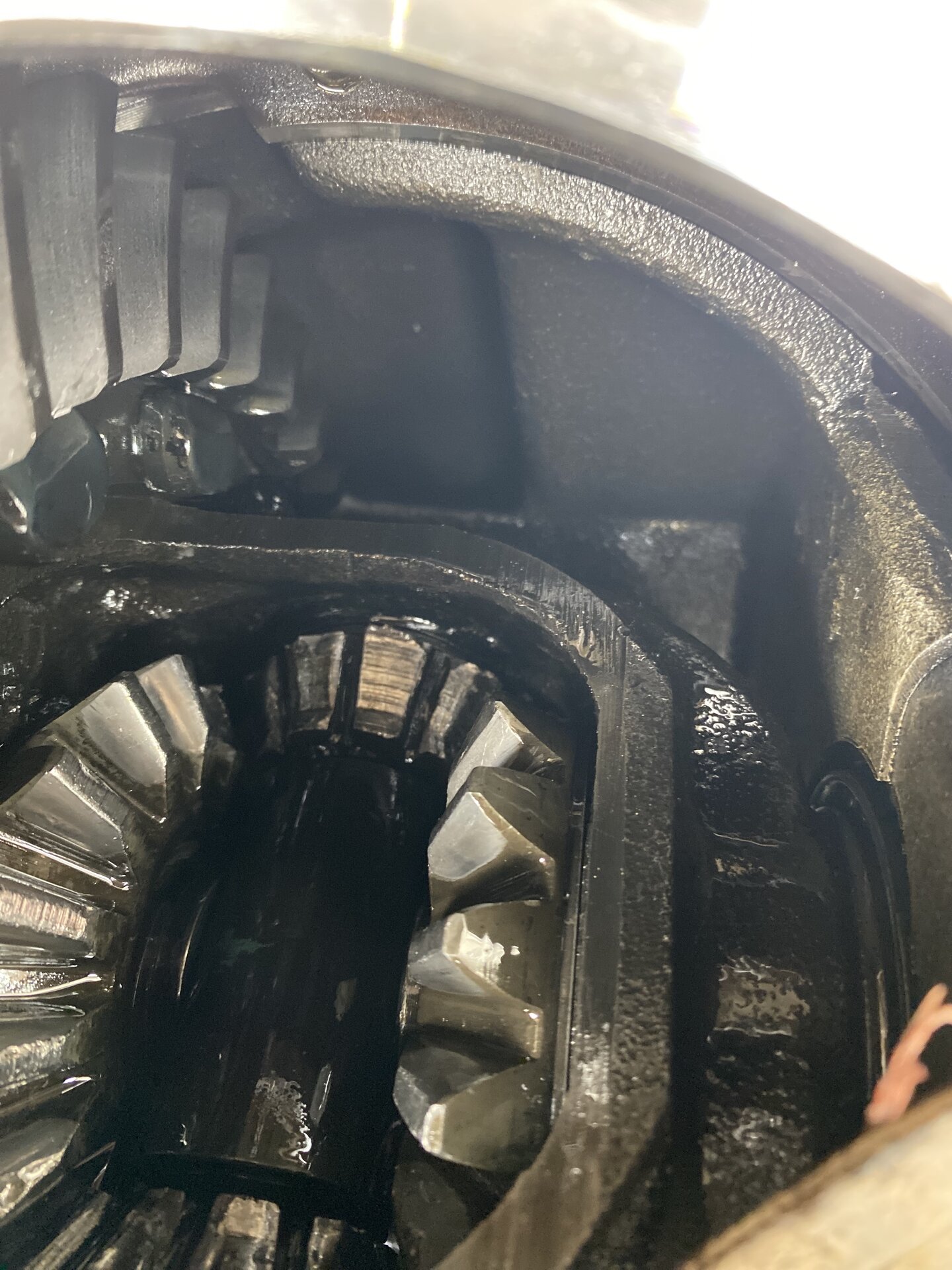

Soooo.... I shredded these up pretty good 🙈
Short of the story for an 1984 Fj60:
- LS v8 swap putting out 550 HP
- H55F swap (5 speed)
- 33in wheels
- Stock front and rear diffs (3.73)
Knowing this, do I rebuild/throw 3.70's in again? Replace front and rear with 4.10s? Something else? Who would you be buying from? WYD?
- 33in wheels

With your drivetrain, I don't suspect you want for power in high range... thus sticking with the factory gear ratio probably makes the most sense and simplifies the repair. A full carrier replacement such as ARB is going to be significantly stronger however as you broke the spider/side gearset versus a R&P resulting from carrier deflection, I'd lean towards just rebuilding with a clean used differential gearset and new cross-shaft unless you need/want the locking diffential.

buy a good used drop in diff, just north of you and get the rig back on the road while coming up with a long term plan.
Appreciate all the thoughts. Cleaned it out today, everything except the washers and gears look fine TMK. Will just replace the gearset and pinon shaft so I can get back on the road indeed 🤘 @3_puppies
