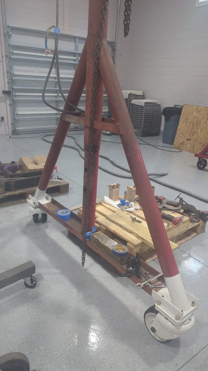

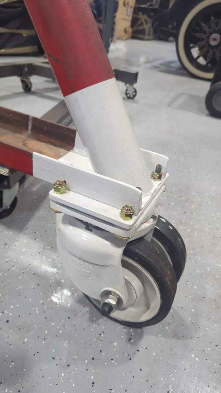

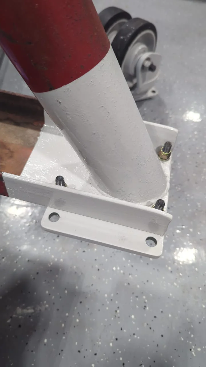

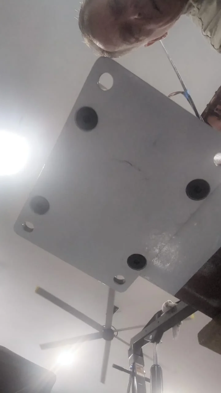

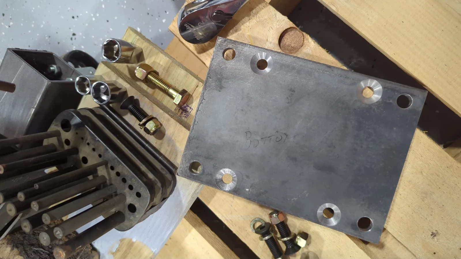

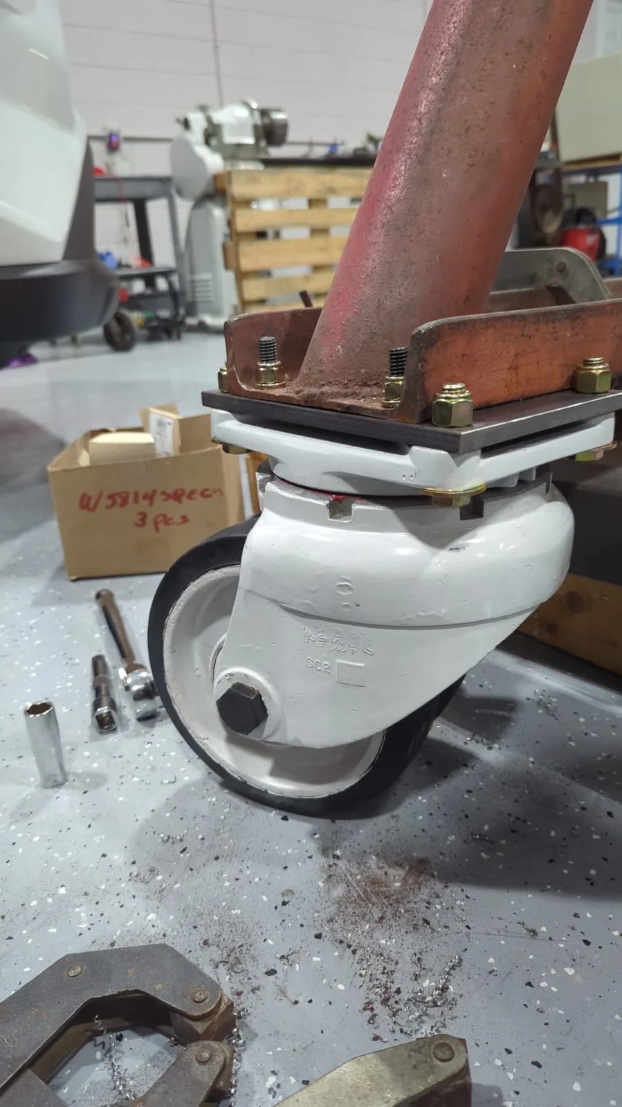

Then I had to make some adapter plates out of 3/8" cold rolled
The dry fit worked out
And I was satisfied that this would be much stronger than the original

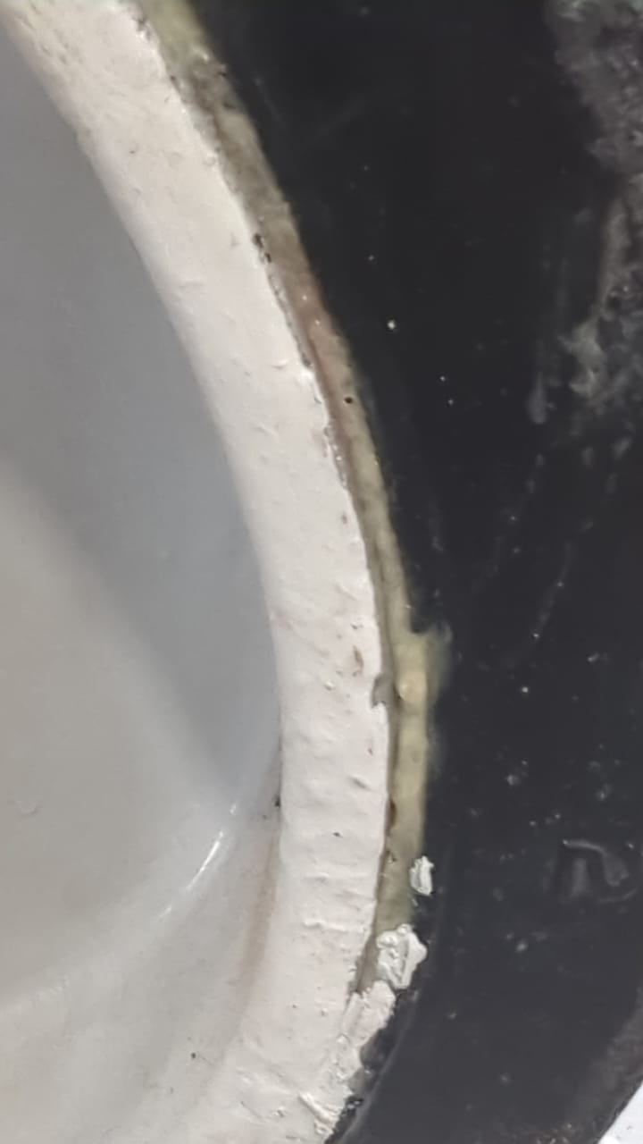

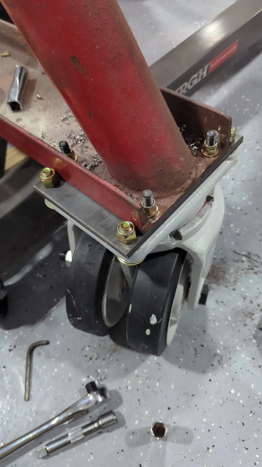

What was the process to get the tire back on?

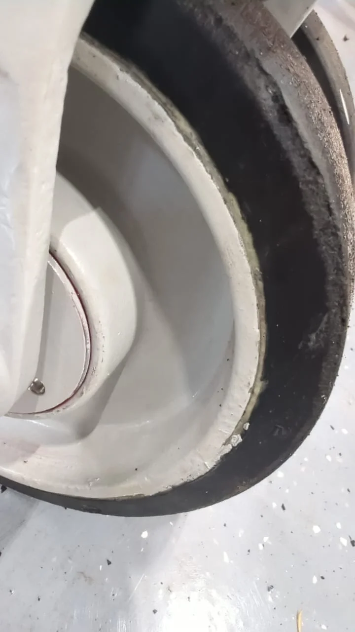

The repeated heat cycles had degraded the rubber and detached it right where it met the cast aluminum hub. It was easy enough to detach the areas still holding and then sand off the degraded rubber down to good rubber. Then I used a high-grade construction adhesive spread on both sides to put the tire back on. My past experience with construction adhesive is that it is very tough stuff. I think it should be ok. Here are a couple of photos:

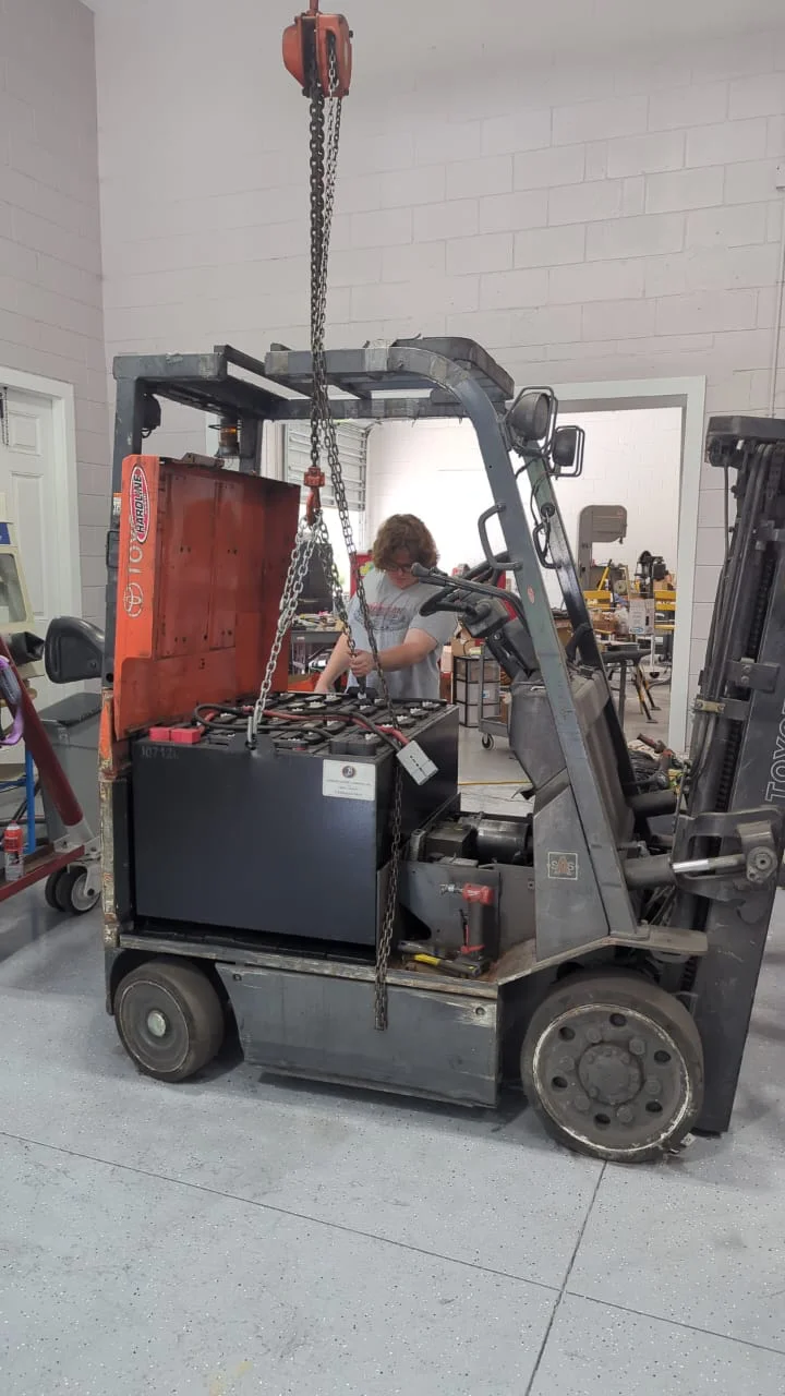

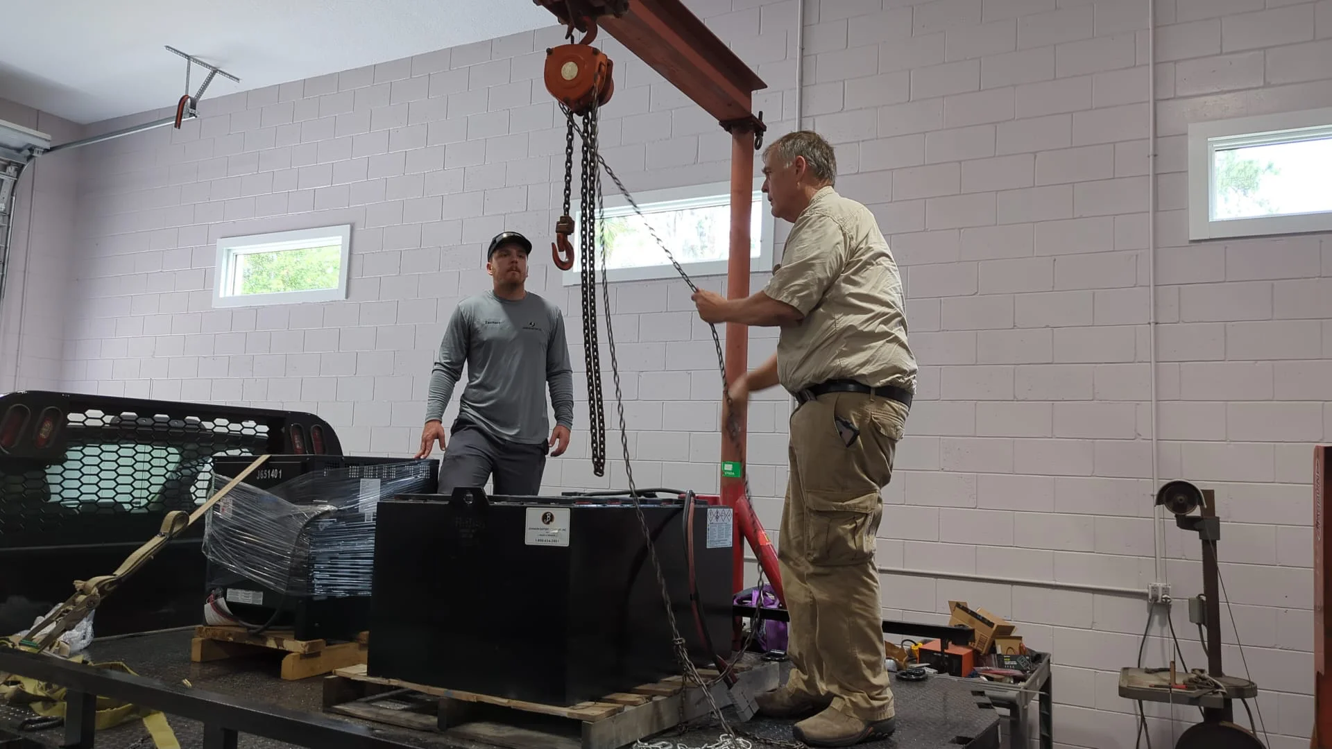

So I'm told that the replacement battery for the forklift will arrive tomorrow. I've just been cleaning up the forklift. I just did not want to put the 'new' battery (it is refurbished with a 6 month warranty) in the rust and dust.

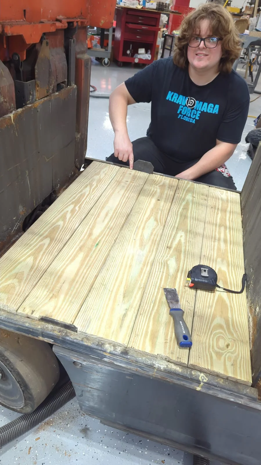

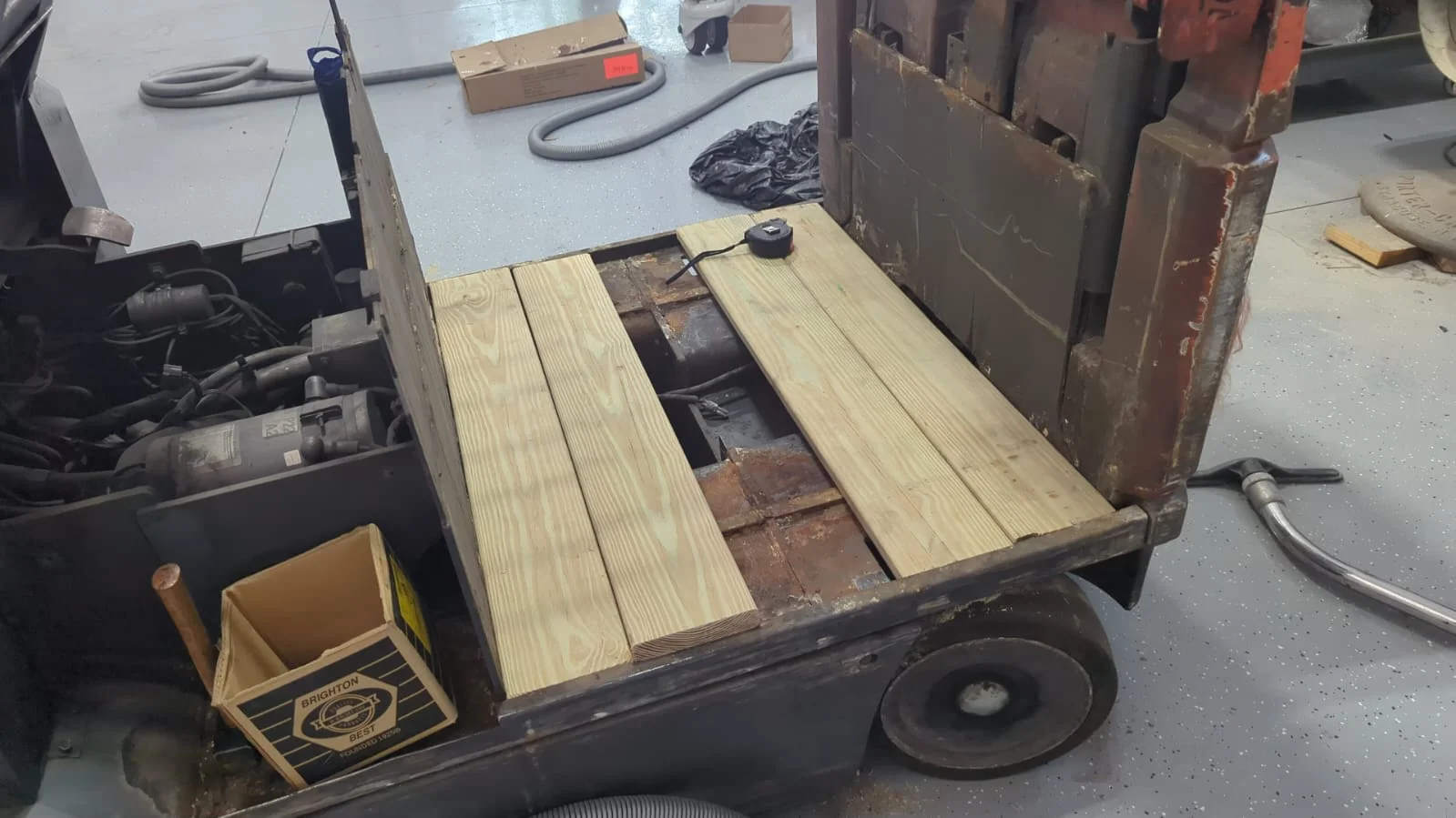

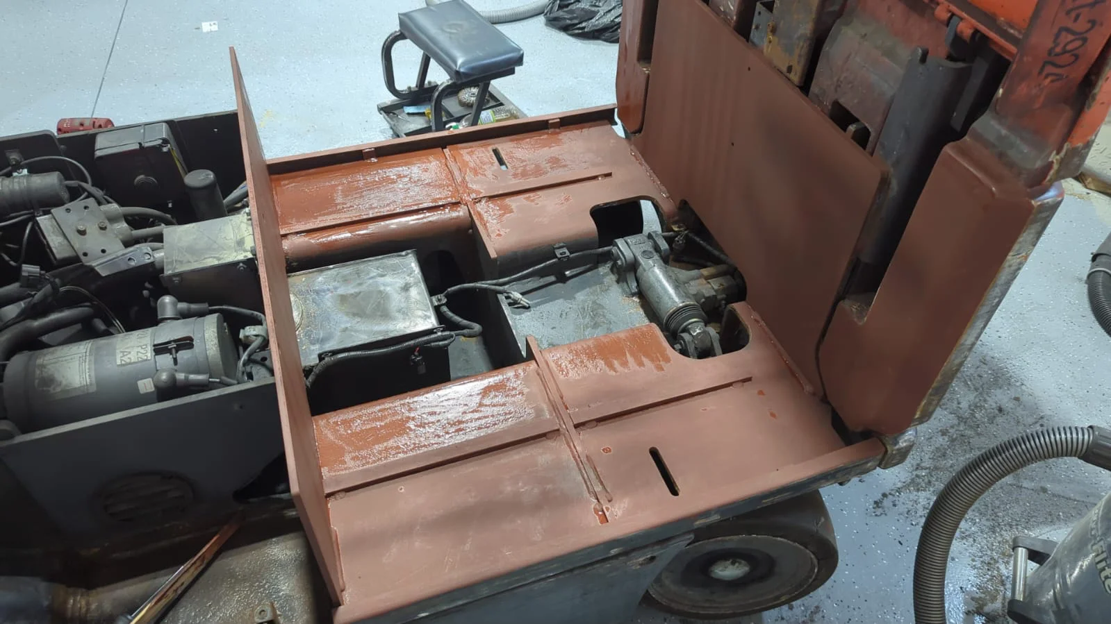

I decided to put a lick of black rustoleum on it so a bit of rusty metal primer seemed like a good idea
There was a decaying sheet of plywood under the battery when I took it out and I decided to replace it with pressure treated planks instead.

So the refurbished battery did arrive today!

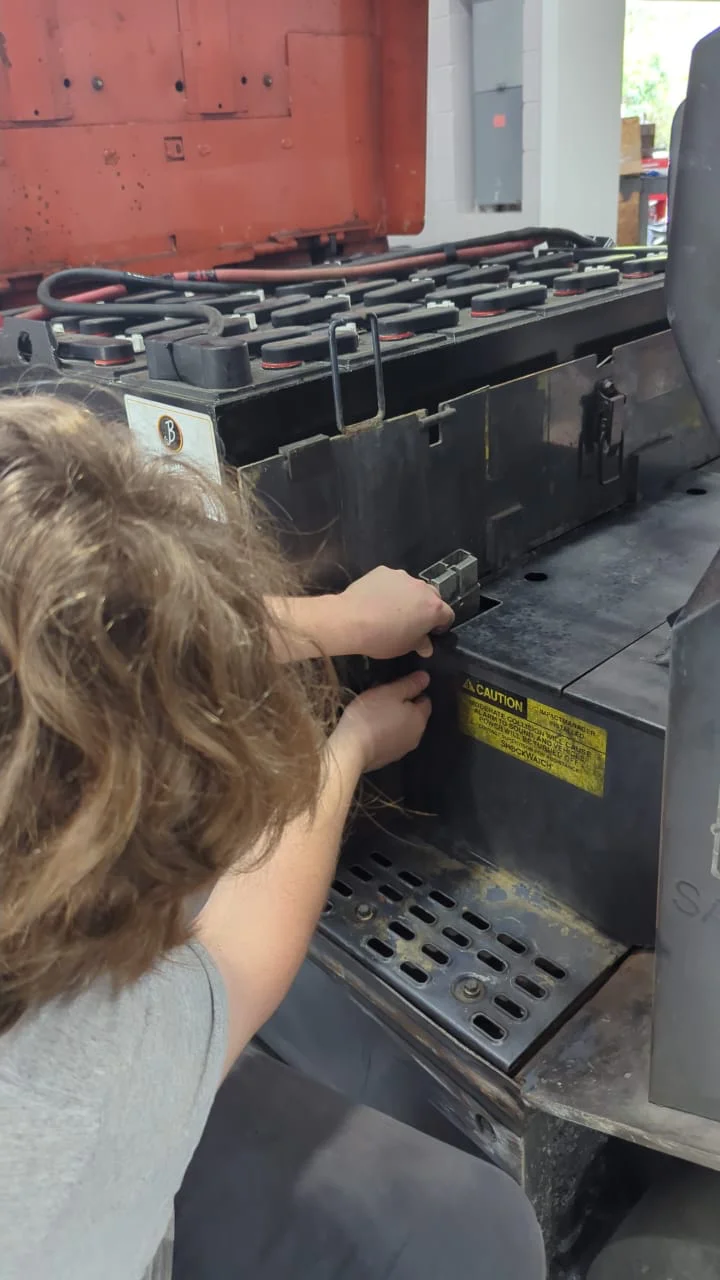

And it went in relatively easily
I’ve never been exposed to this kind of battery service before….how long will this battery be in service for before needing this again?
Well, that's an interesting question. I need to ponder that.
But I expect to get several years. Our use is only occasional. The big question is how often and how long to charge the battery. I was able to buy what I think may be a high end charger from the forklift seller, but need to research it.
