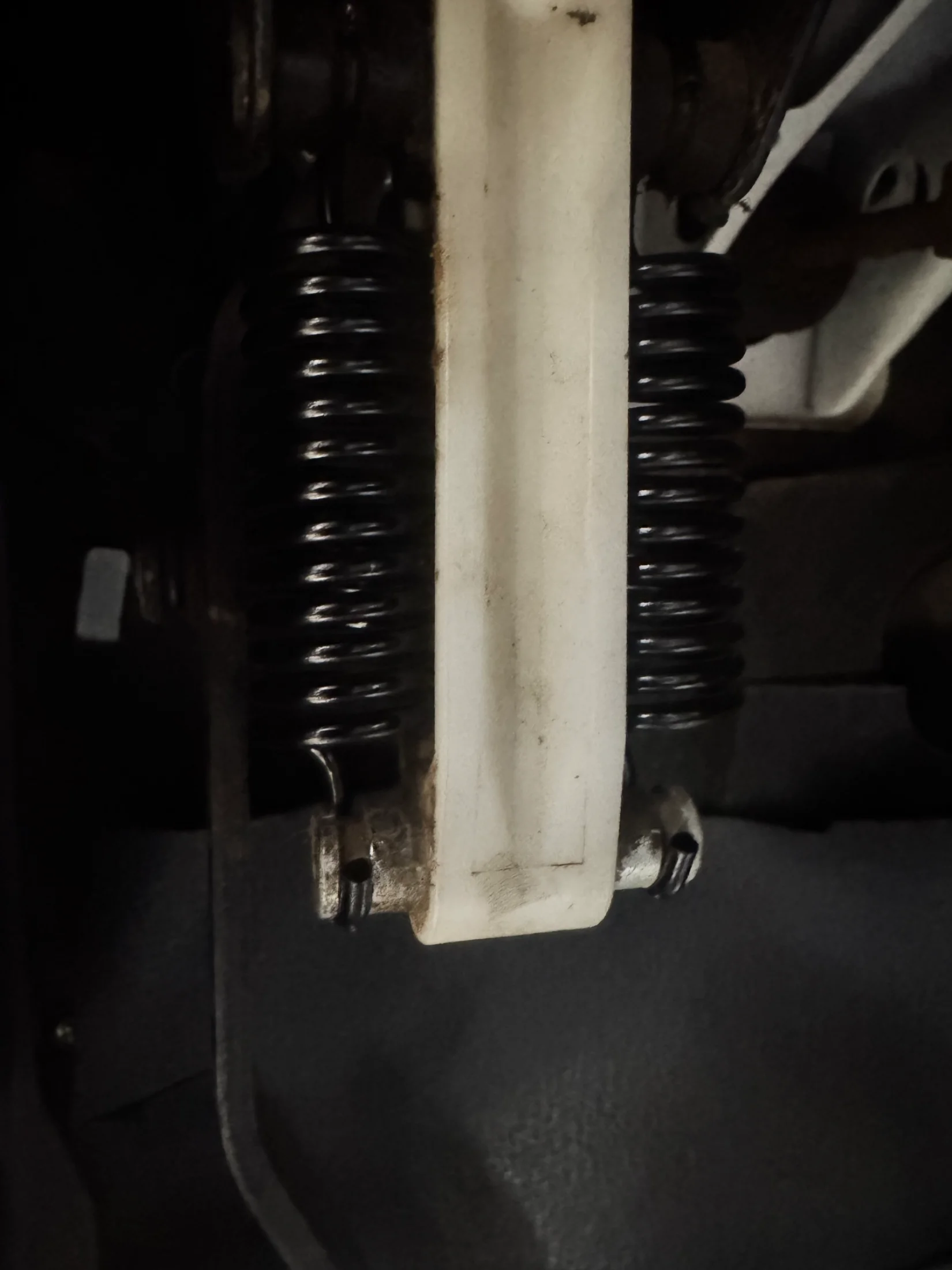

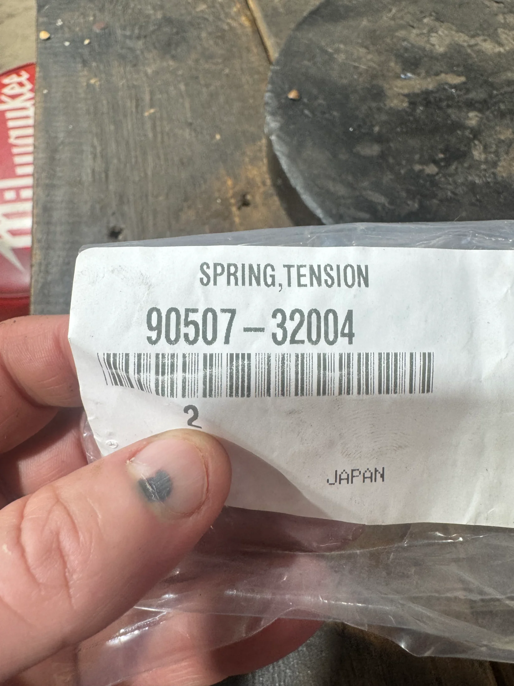

The clutch springs were worn. Done.

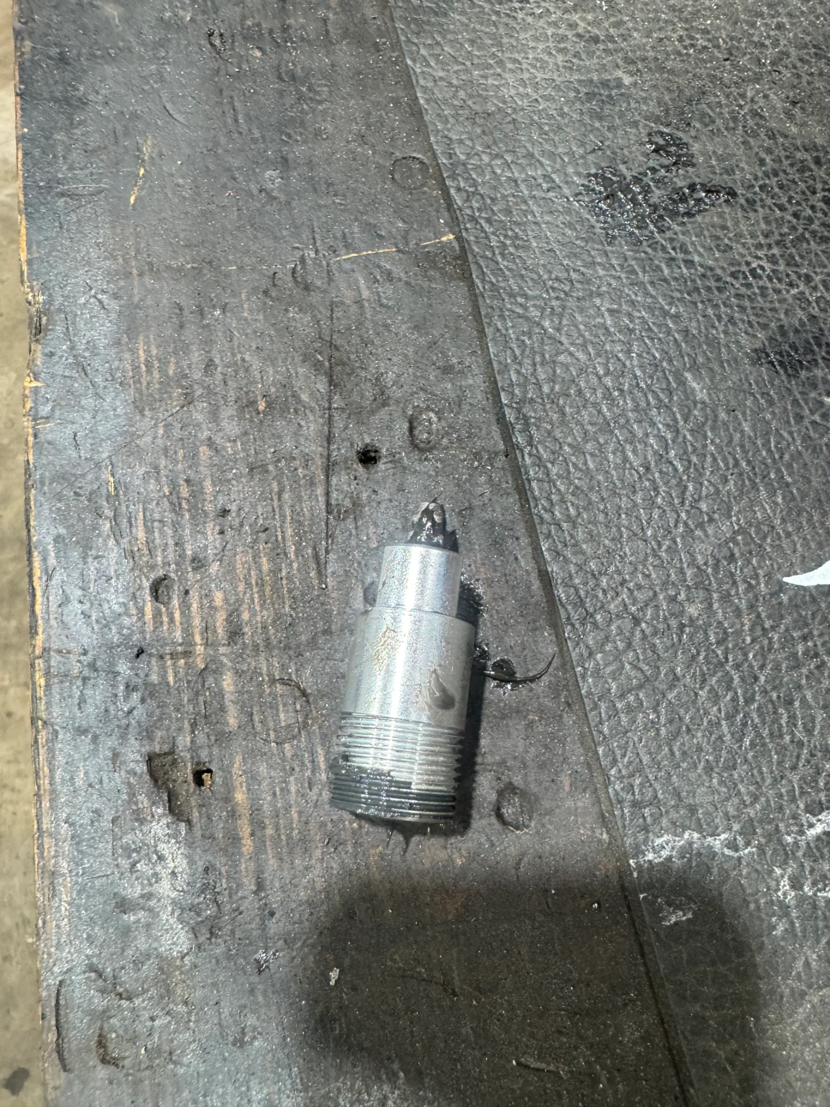

The speedometer cable would make loud noises when it was cold so I bought a Delta adapter that shoots grease into it to shut it up.
That did not work. The tip blew apart under the pressure. Luckily I had a cable here in case the grease didn't.

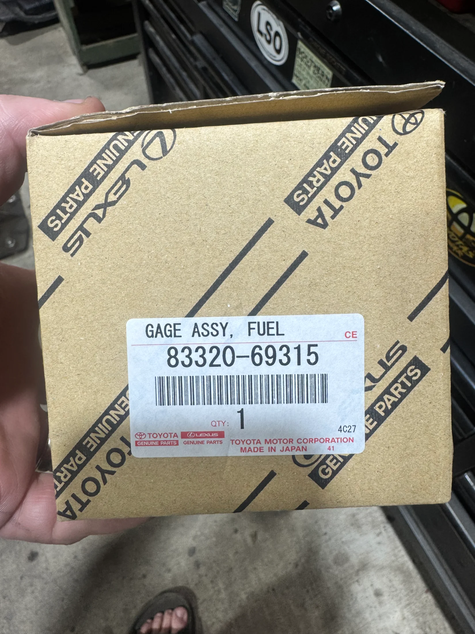

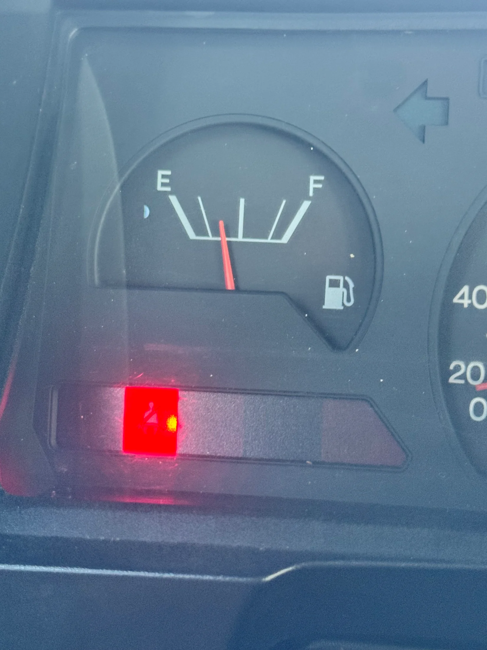

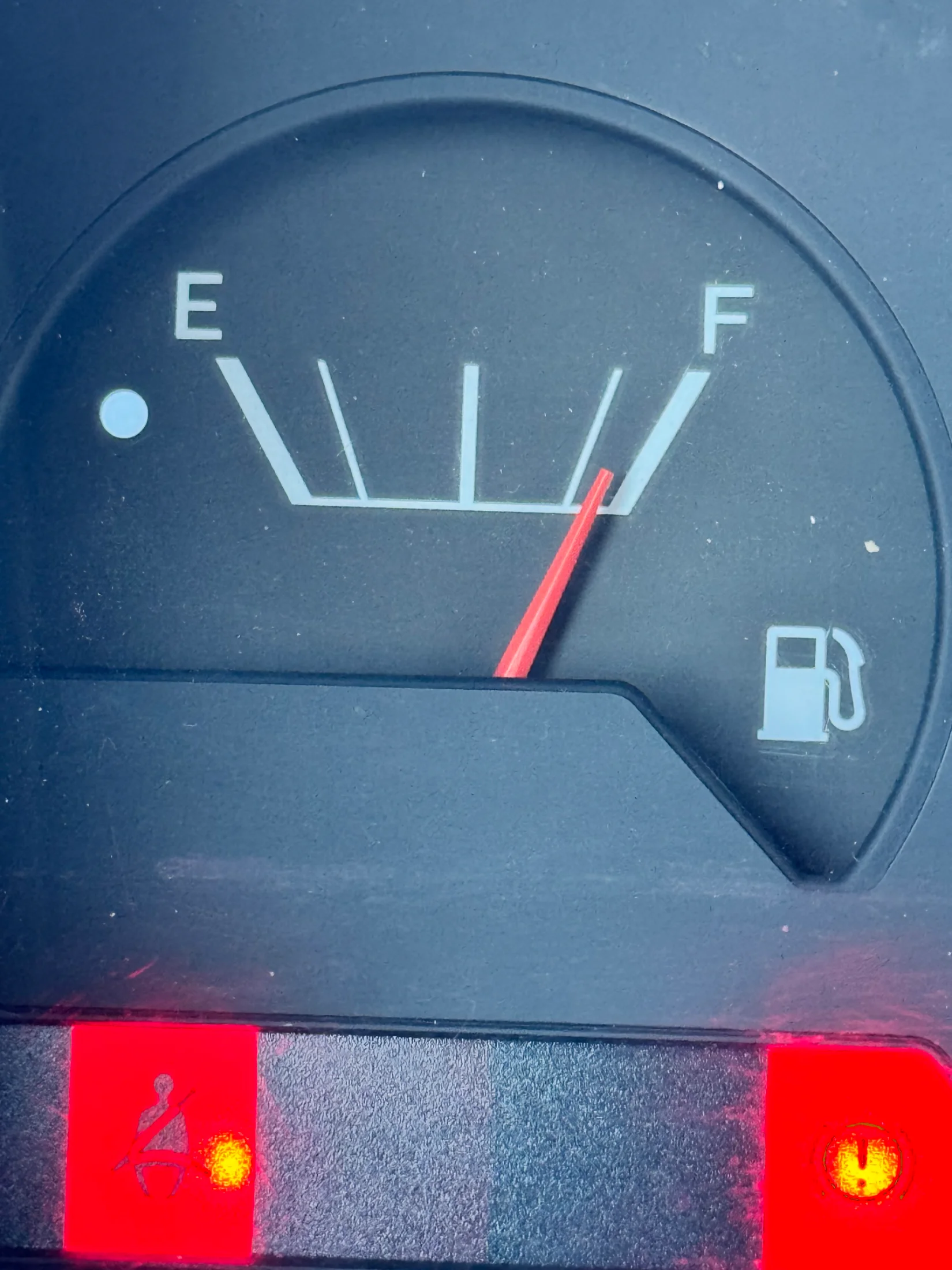

Lastly, my fuel gauge went out. The reserve light works so I assumed the sweep died.
Well s***, that did not fix it. s*** job because I had to remove the Dobinsons drawers to swap out the sender
I sent a message to Yemen and he had a new gauge. A mere $350 shipped.

How did the clutch springs behave (misbehave) that indicated that they needed to be replaced?
Ours has displayed an odd tendency for the clutch pedal to remain partially down like the clutch master and/or slave are developing issues, but I have never encountered a pedal like this one before. So could there be similarities to what you have encountered ...
It would do that. My master and slave are good so I'm thinking weak springs. New ones feel nice and tight

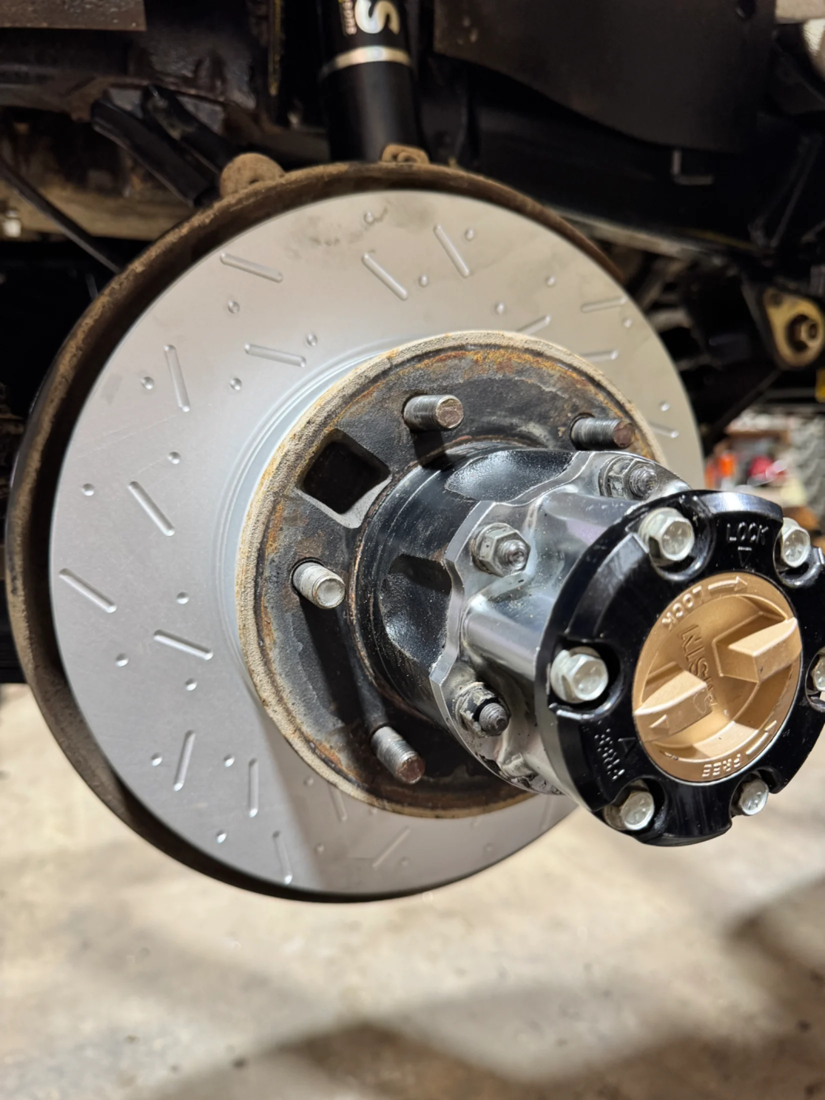

One thing I never did on this one was front brakes. They were getting kinda low so I took that off the table. Terrain Tamer stuff. Nice.

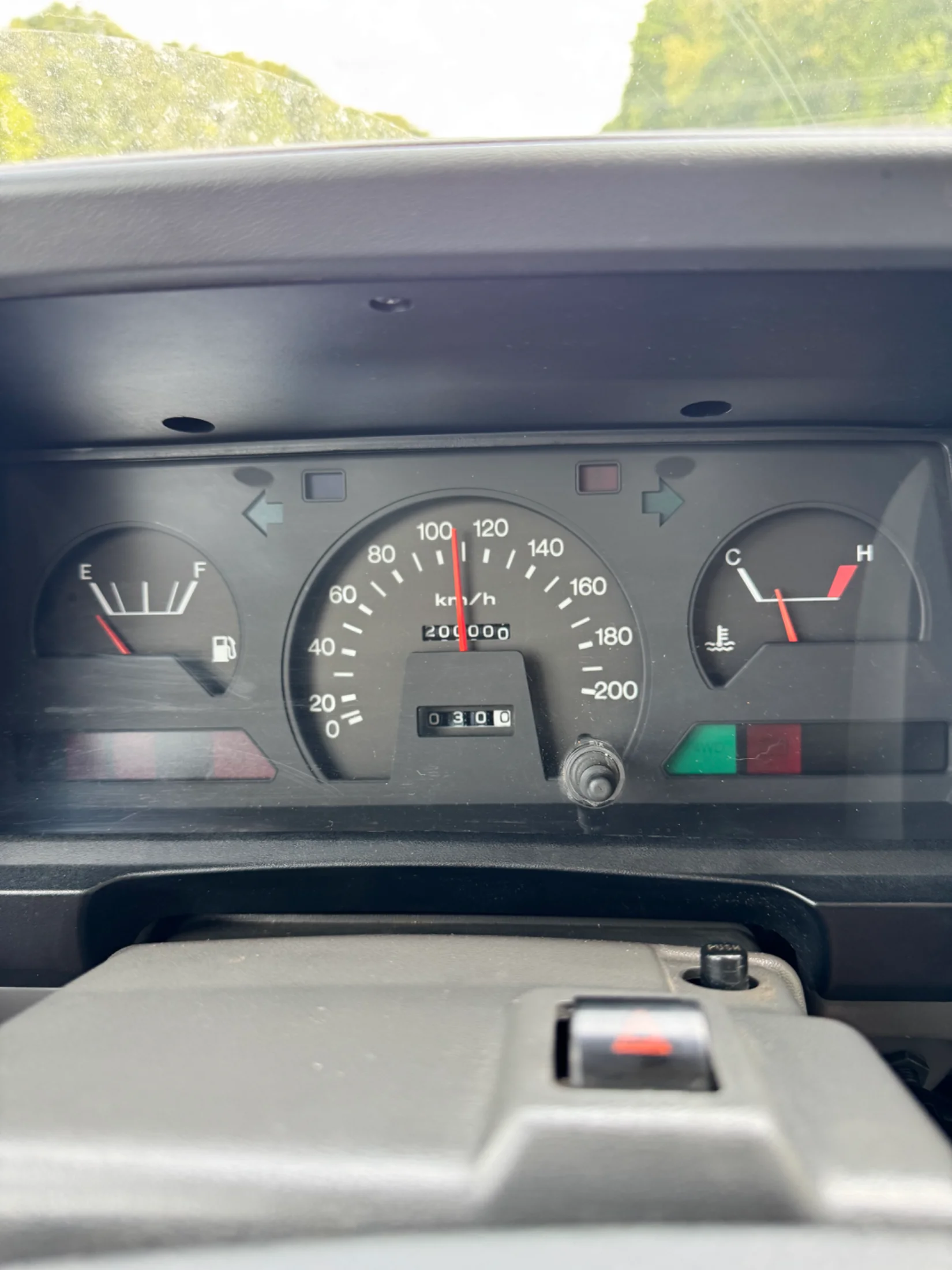

Light came on last night on the way home from the club meeting. I pushed it all the way back to town because I had a $1 off fuel points I needed to use.
28 miles after the light came on I still had 1.5 gallons left It took 22.5 gallons 🤓
Turns out my fuel gauge works! I was just low on gas.
