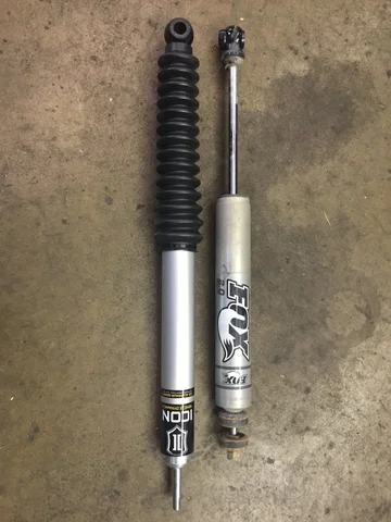

Side by side of Icon VS 2.0 rear and Fox 2.0. Roughly 2" longer in overall legnth. Going in now but will report back with more info. Thanks to MetalTech for the 20% off cyber Monday sale!

I'd love to hear what you think. I just ordered some Icons and UCAs! I hope to have them next week.
In the 10 miles I've driven it, they're awesome.
I paired them with some OME 2864's to help better carry the hefty load I have in the back (BIOR bumper swing out with Hi-lift, 250lbs of drawers, fridge, etc)
I'm going to post up in my build thread with more info on this progression, but so far so good.
