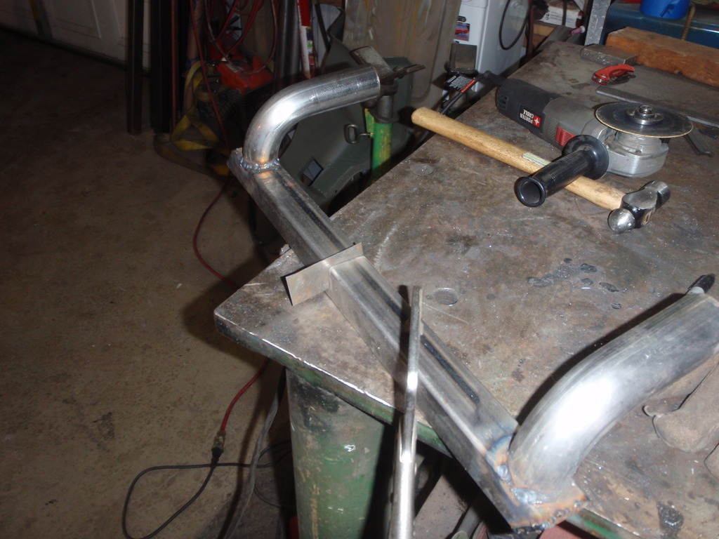

this is what's under the windshield frame. I replumbed the system to create room for the electronics box in the dash.
