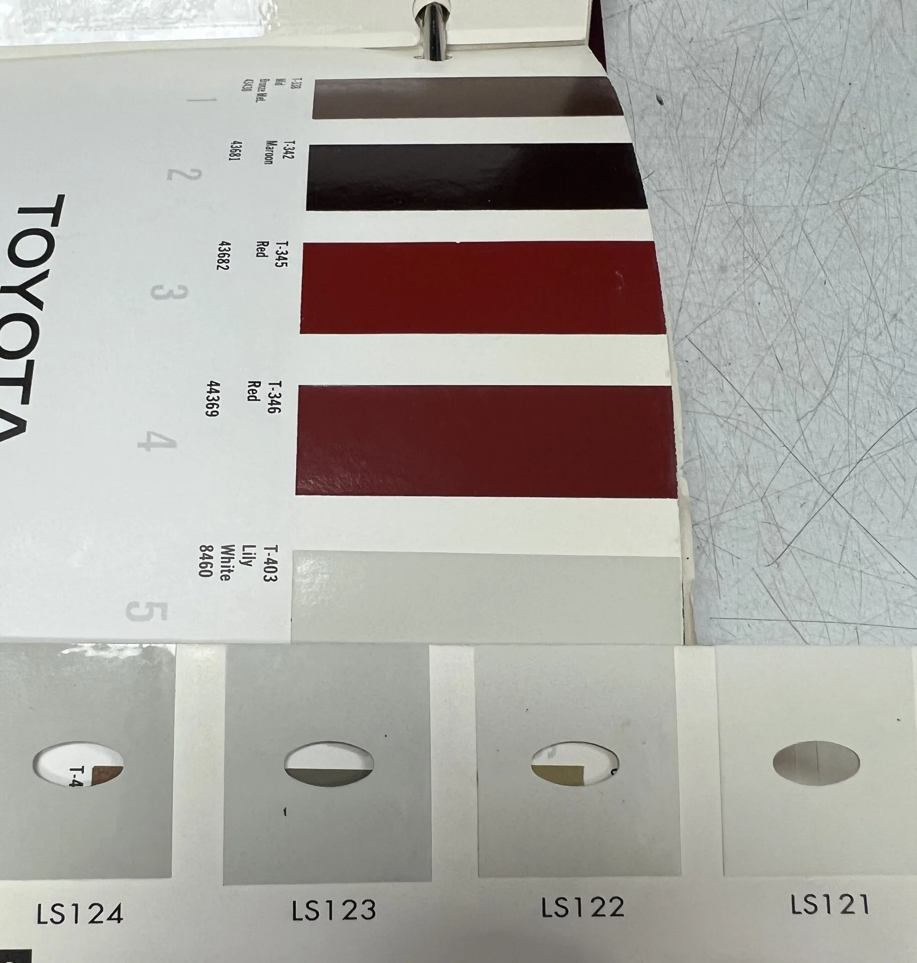

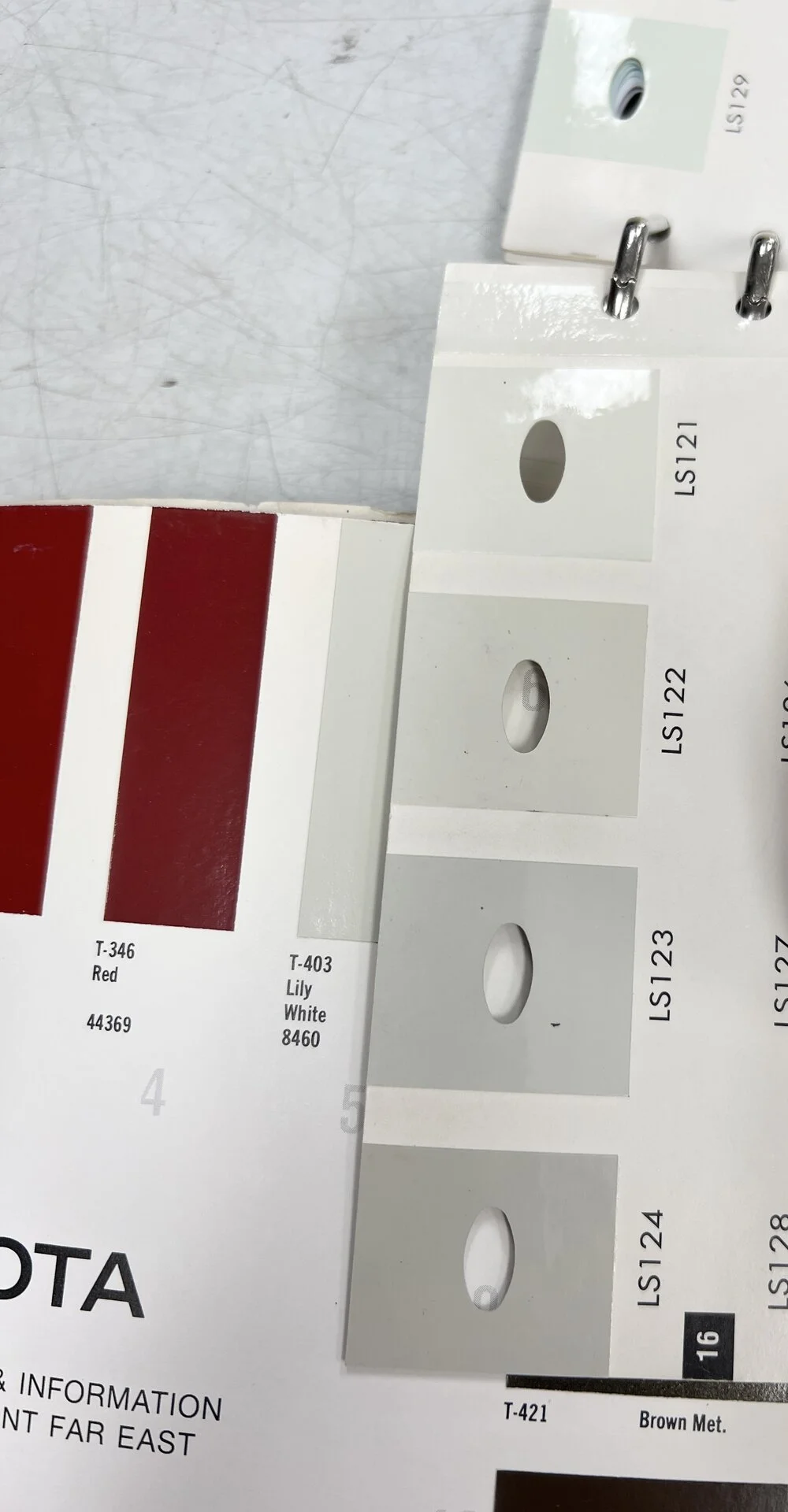

I would trust Toyota before I trusted sherwin Williams. Toyota says it’s shell ivory. I suspect the formula you have for shell ivory is bad. Use the DuPont LS123 formula. Regardless of paint names, ls123 matches what was actually used.

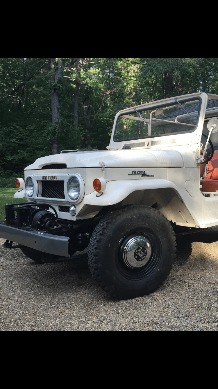

It’s impossible to match a paint from a photo on your computer or phone, but this photo shows the difference between a shell ivory bezel and what people refer to as a lily white body color. I call it lily white with caution because everybody seems to think the earliest. (Pre 1964) White was lily white, but I don’t think there’s any documentation to support that and the existing lily white formulas don’t match the very early white that was actually painted on these trucks. I’ve owned 3 pre-1964 white cruisers that were all the exact same white and the existing lily white formulas don’t match the factory applied color. Bezel is DuPont LS123 (match for shell ivory) and body is a custom formula made to match the factory white.

A match was made with the ls123 paint chip and an original part by somebody on this forum and I verified it at my local paint shop.
