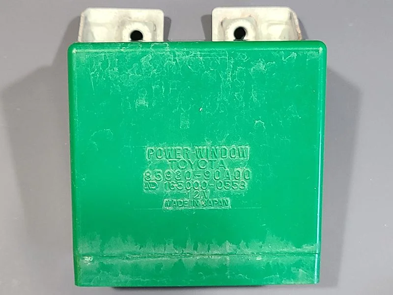

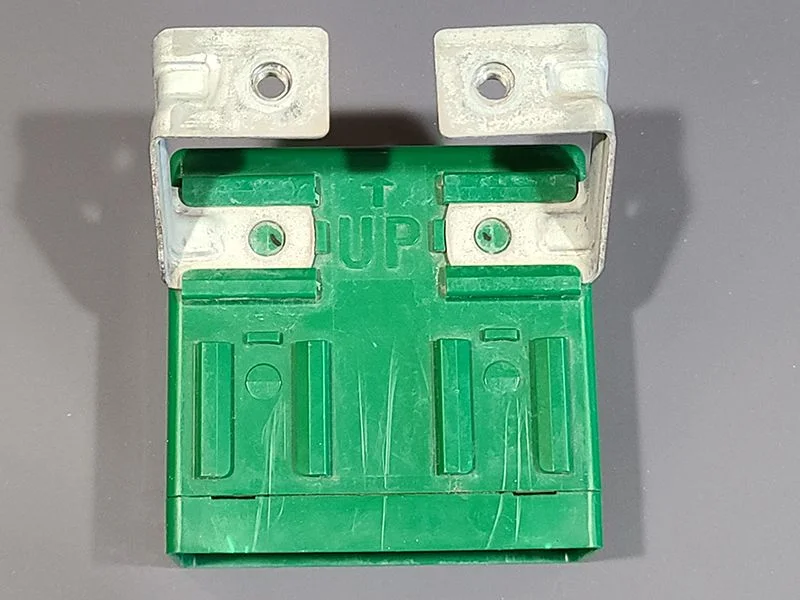

The part as I received it. Considering its age, very clean and no corrosion that I could see on the mounting brackets. To be expected in either a dry climate or if the vapor barriers were never removed from the doors (mine were years ago and my own mounting brackets have some surface rust).

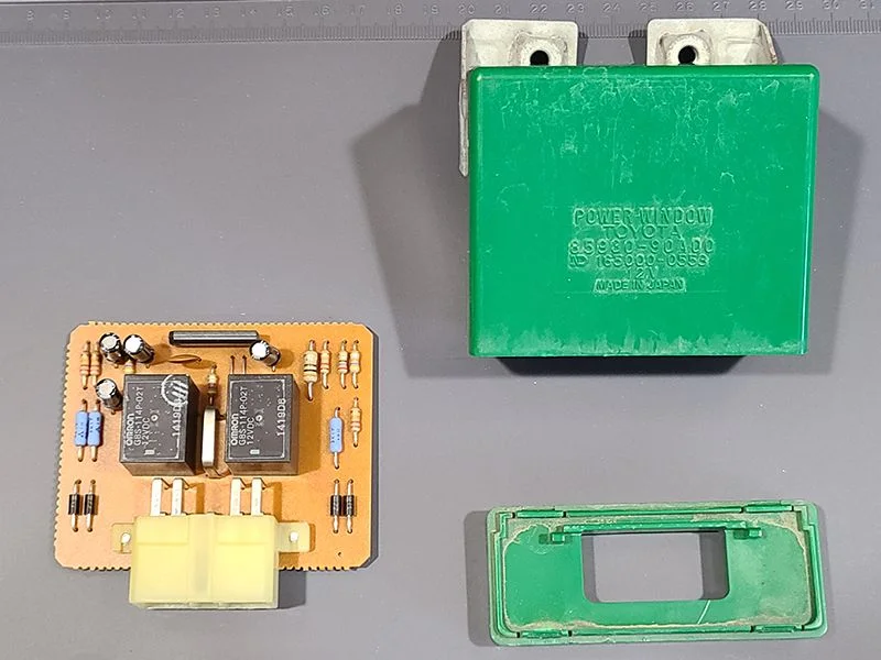

The assembly immediately after dismantling. The plastic box is made of ABS. While working this one I was able to figure out a way to remove the "cap" while minimizing risk of damaging the plastic. Though only a couple of the tabs on his required repair, my own didn't fare so well; but I keep a supply of ABS solvent cement that makes for a perfect repair of ABS plastic. Rather than being a simple adhesive, it chemically fuses the plastic together. The cure time is three days for full strength, but the repair is just as strong as new plastic. With this I'm able to repair any breaks or cracks in ABS as long as there are not MISSING parts. 4Cruisers's and my own part repaired beautifully with using an insulin syringe as an applicator to avoid mess.

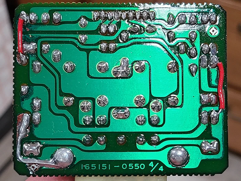

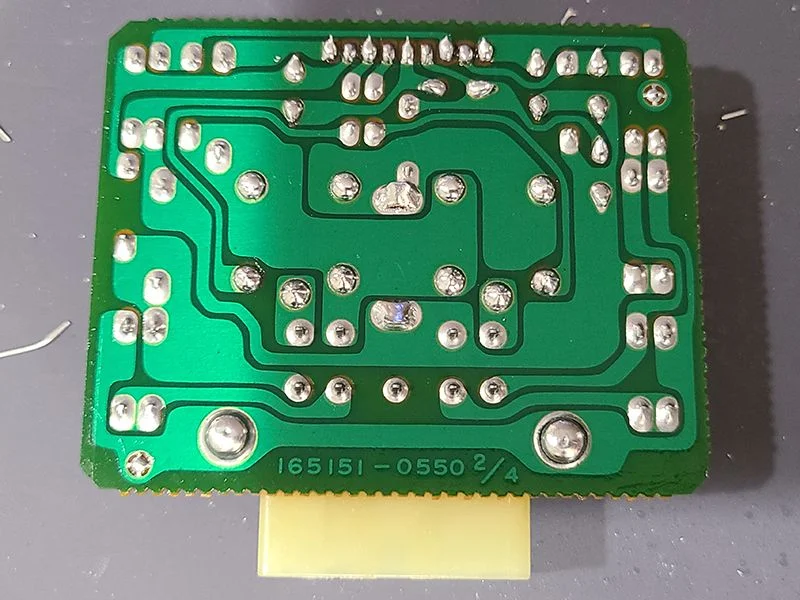

The backside of an as yet untouched PCB. These circuits are very simple. Though I didn't make it as far as the circuit analysis class in my electronics engineering course (divorce at the time and wasn't about to put myself in a position where my GI Bill could possibly be usurped from me), I'm confident that if I sit down and take the time to pore over the specs of each component and trace the current paths, it wouldn't take me long to break it down.

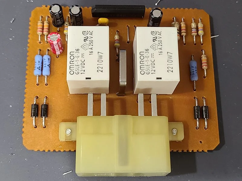

Continuing from my first post, here we see the meat and potatoes of an unmodified window relay board. Like I said before, this is a very simple circuit and the components prone to wear were easily identified.

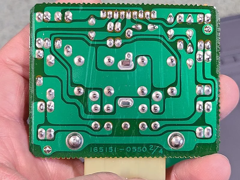

Since I had all the parts already available (save for the resistor array; the long black component at the top of the pic, which tested good, but more on that shortly), I depopulated the board. Resistors don't typically wear out unless there's damage, which I saw none in this case nor on my own part, but in the event I find an unserviceable one, I do have spares for those as well. You'll see I still removed the resistor array and tested each pin. What's interesting is that his was much more consistent than my own, save for pins 5 and 9. All others pins on his were consistent in readings to pin 1. Mine, oddly enough, were all over the place. Yet both units still worked perfectly after repair; HOWEVER, when testing 4Cruisers's part in my door my window actually raised and lowered slightly faster than with my own part. This is why I would like to more thoroughly analyze the circuit so that I can determine what exactly is affecting the current allowed to pass to the window motors. Regardless, testing his resistor array allowed me to source a proper, long lasting replacement that's already on its way should I come across any that are as out of whack as my own or actually damaged.

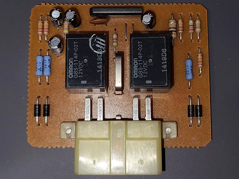

Here is the completed and refurbished board. All capacitors and the relays have been replaced and the resistor array reinstalled. Also, before and after working, the PCB was thoroughly cleaned, first with plastic safe (for the connector) contact cleaner, and then after soldering with 99% isopropanol to remove excess flux. Like I said before, any resistors (and diodes) I find damaged can be replaced as well. Given the large holes in the PCB, I can also use larger wattage capacity resistors so as to avoid any possible heat issues in warmer climates (honestly doubt that's ever been an issue anywhere, but hey, why not?).

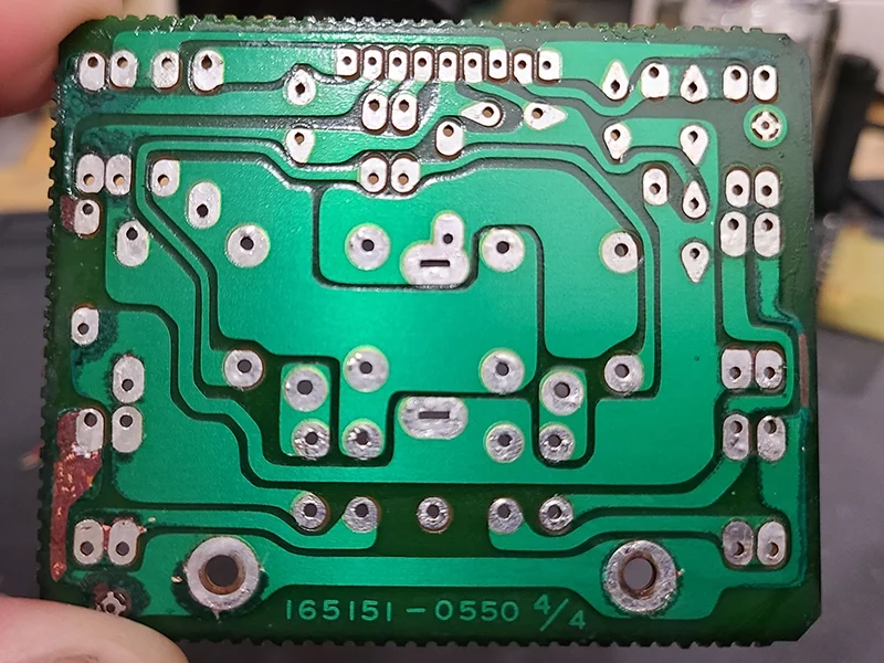

On the backside now you can see the nice new solder joints. I use old school lead based solder, which to my experience is much more durable and longer lasting than ROHS compliant solders. I also beefed up the connection points on the small bus bar that runs between the relays. What's interesting is that my part had considerably more solder in place to begin with than 4Cruisers's. Wish I would've taken a picture of my own for comparison. I attribute this to variations in the manufacturing process from the late 80s. Nothing wrong with correcting it now, huh?

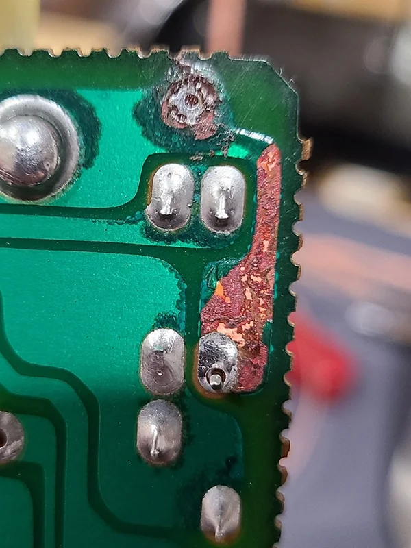

Just recently finished a box refub for a Mudder in Canada. This was a challenge given that there were a few spots where the PCB itself was damaged to the point of causing several opens in the circuit. So the PCB had to be completely depopulated, scrubbed with water and baking soda (to neutralize any acids that might've been contributing to the corrosion), then cleaned with isopropyl alcohol. Then the largest spot had a jumper wire laid over it, was coated with flux and then flooded with solder to create an effective repair to the trace. The other two were remedied with simple jumper wire and didn't require flood soldering. After the PCB was repopulated and tested to ensure it works again, I coated the trace side with urethane conformal coating to seal it and prevent any further corrosion. It's all reassembled and on its way back. Yet another refurbished part for our aging 62s!

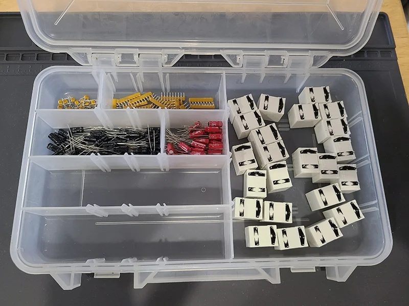

And finally some organization! Cleaned out one of my component totes to use for these boxes. Still have to take the new resistors off the tape strips and put them in but now I have convenient access to my supplies when I do a relay box.
