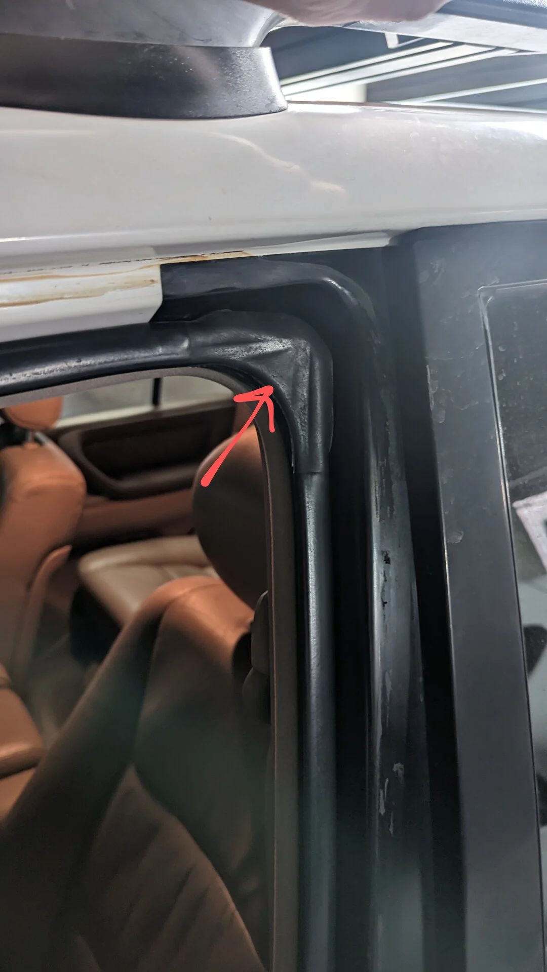

One thing to note, that upper door frames will get bent outwards on occasion. This is especially true if you have a truck that somebody has called a locksmith for to unlock, they will wedge the door top to get to the lock and bend it out a bit. I found mine had had this done, I rolled the window down and gently shoved the top of the door frame inwards a couple of times. It was pretty noisy beforehand, and this tightened it up so it seated better.
